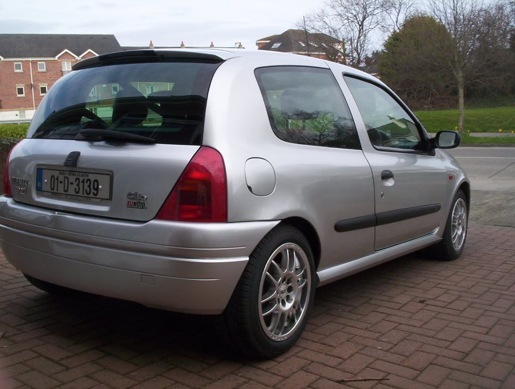

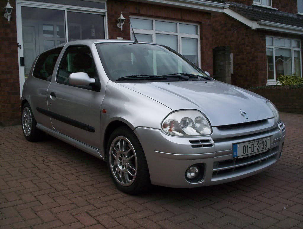

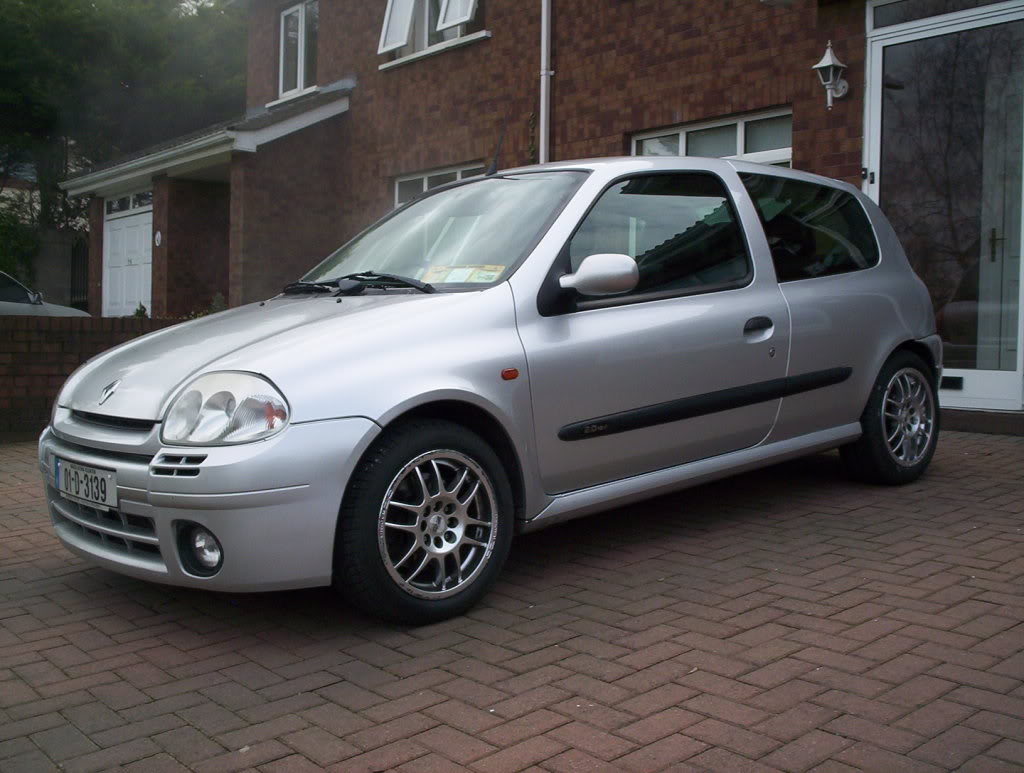

After a lot of messing around in cars I wasn't really mad about because I didn't think I could insure a 172, I finally got a quote I was happy to pay and snapped up a bargain of a clio. Being a bargain it was a little rough around the edges to start with, but sure thats what gives it character;)
Got it at 64k miles with the most important bit, all the belts changed at 55k. Standard bar a k&n panel filter and a remap, and a set of aftermarket OZ f1's that are in need of a bit of tlc.

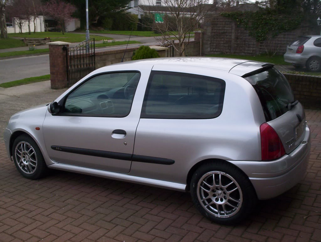

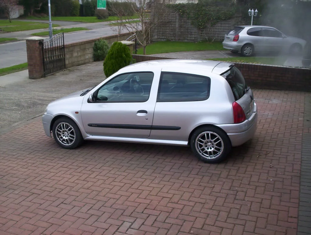

Some pics...

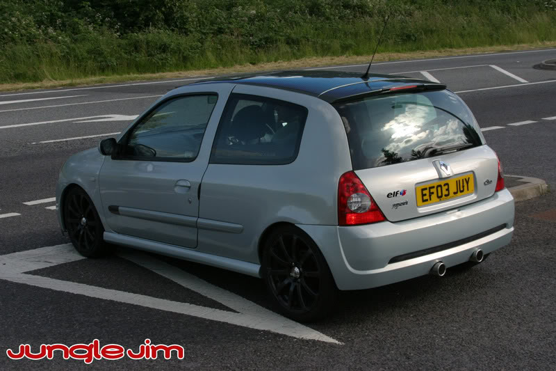

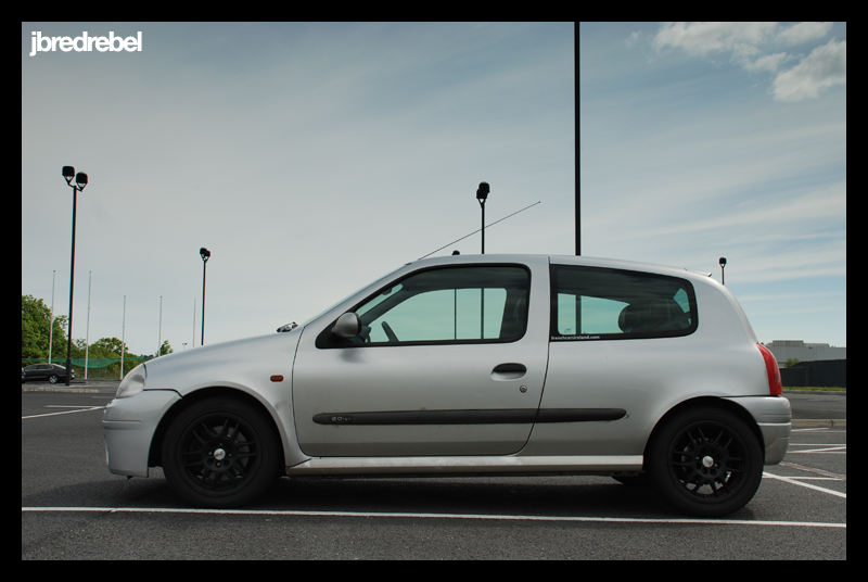

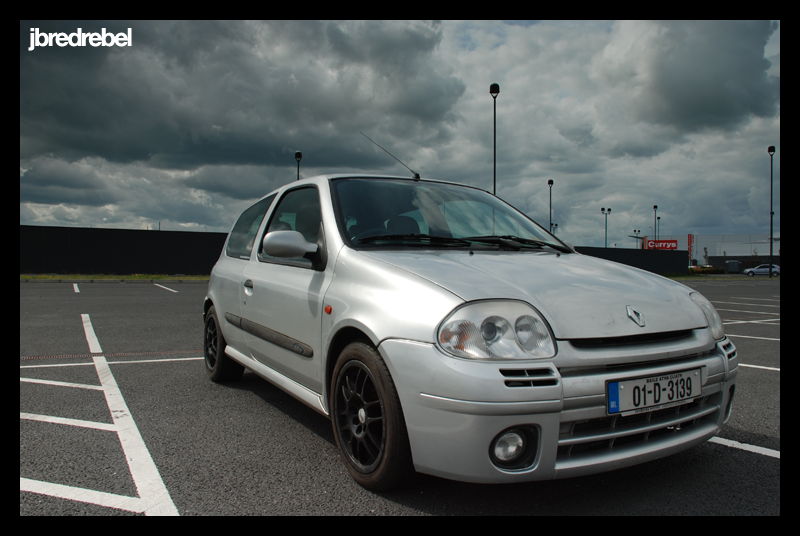

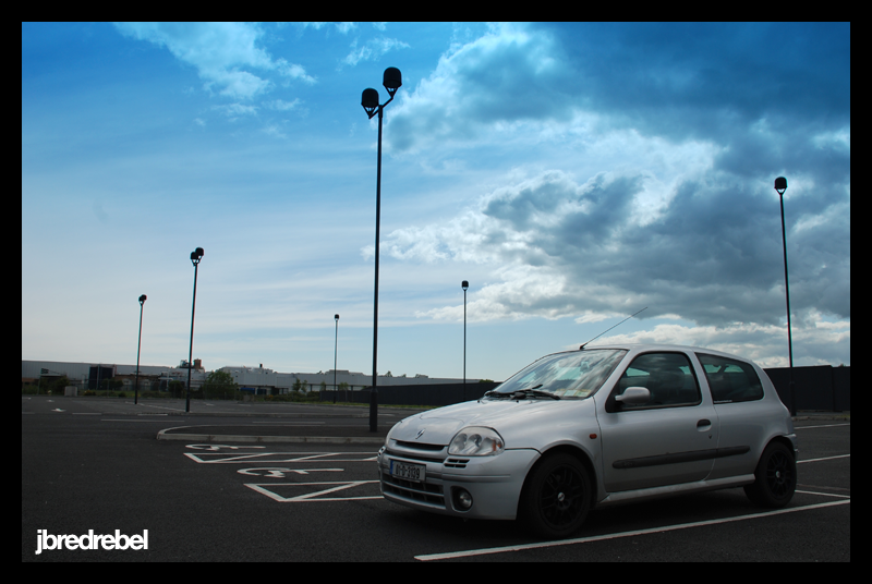

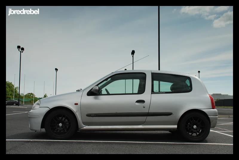

Some pics of it at yesterday's frenchcarsireland meet, courtesy of jbredrebel and shorty (please excuse the dirt, hasn't been washed in over a month:eek:)

Just back from a 550 mile round trip to french car show in rockingham raceway. The standard of cars over there is unreal and would put a lot of irish cars to shame. Every clio is on throttle bodies, turbocharged or supercharged and pushing out 250bhp! Got plenty of inspiration for my own aswel:D
Had the car out for a 15 minute track session on rockingham raceway, my first time out on a track in the clio, and i was well impressed considering my front allignment is way out and i was running old front OEM pads and brake fluid. Plan is to get the allignment sorted, and fit a set of ferodo ds2500's, OEM discs, and possibly braided lines, along with fresh dot 5.1 fluid. Wasn't too impressed with the toyo px4's, so may look into changing them soon enough too.
Lookswise, I've decided i want to get a ph2 172 rear bumper, lights, a cup spoiler and possibly colour coded ph2 rubstrips. Also want to get a new bonnet and get my bumper touched up, but these aren't a huge priority just yet.

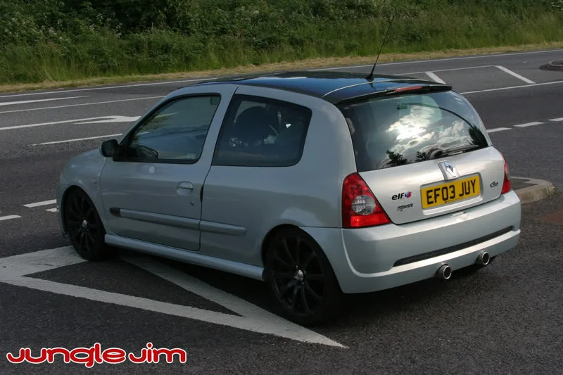

Here's the pic that made me want the black roof..
Hope to get a set of ph2 rear lights and a ph2 bumper like the ones in that pic, and also a cup spoiler, but they're a bit expensive right now:eek:
