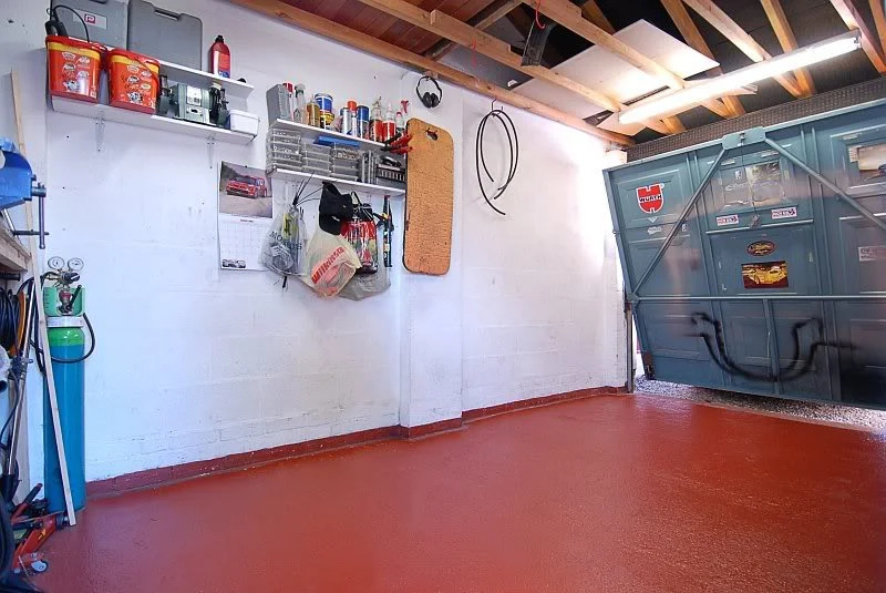

I repainted my garage floor very quickly in preperation for some new tyres

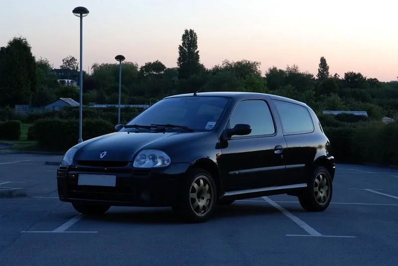

Now for pics of the car, see how many pics down it takes to realise whose it is/ was, this is how I pretty much picked it up

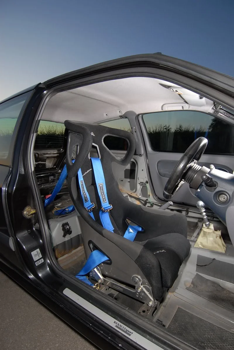

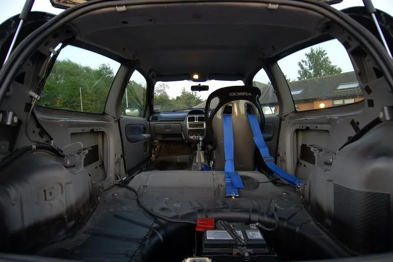

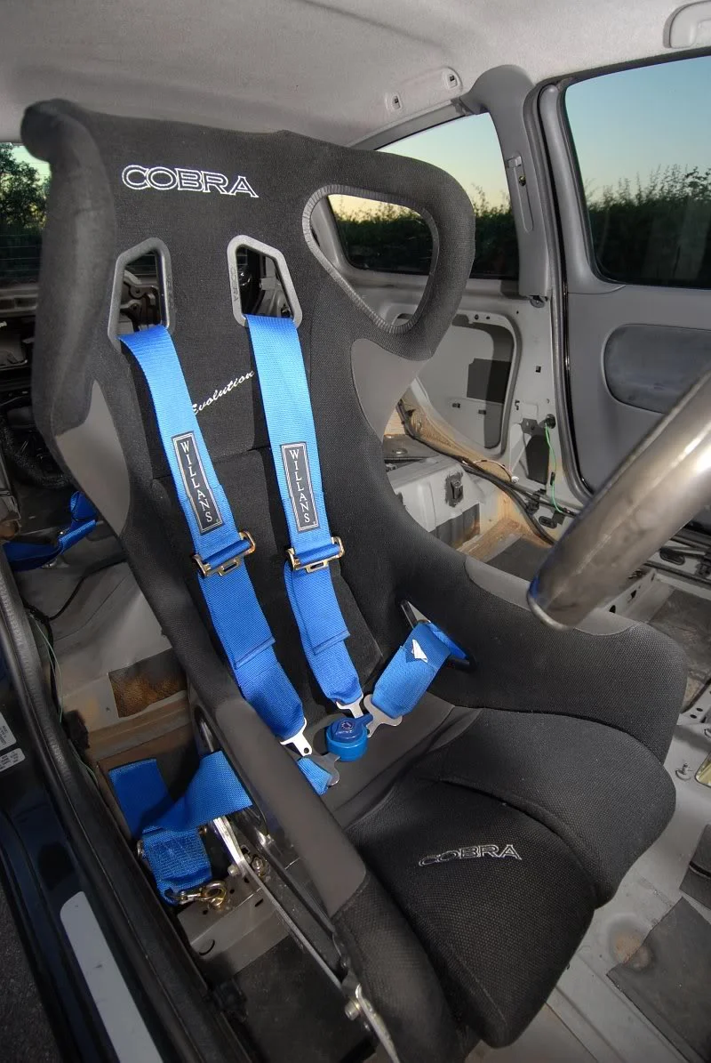

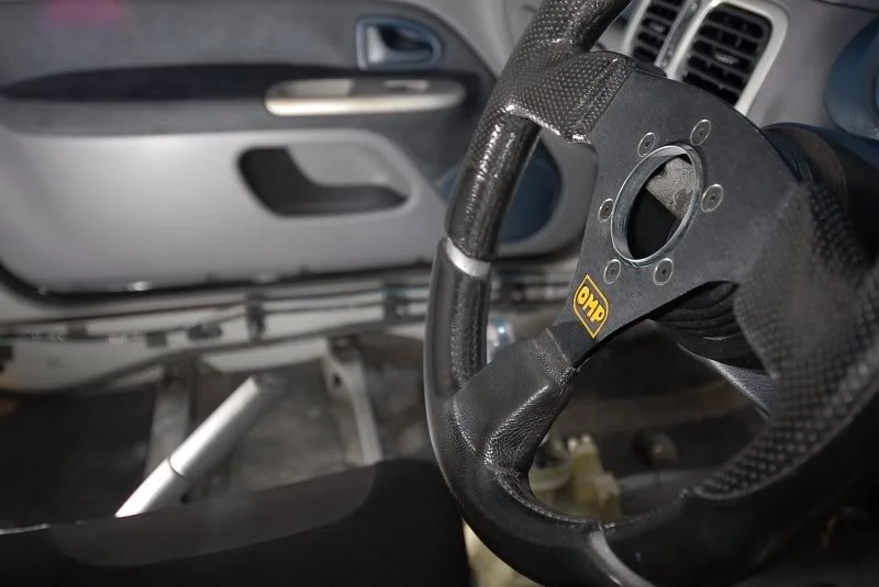

Interior has been semi-stripped, with the addition of a Cobra Evolution bucket seat...
Along with a pair of 3" 4 point Willans harnesses
It has a OMP 320mm steering wheel, complete with no horn lol
Still guessing?

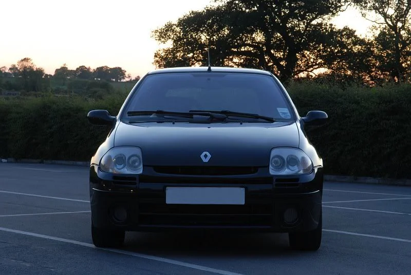

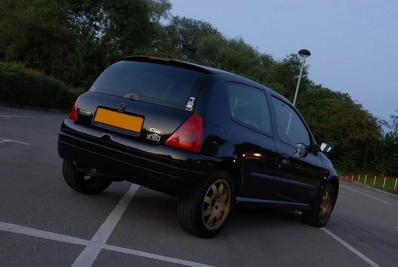

Uh ho! Yup, Rexe's old Ph1 RS Clio 172, paintwork is alreet
So it's:
2001 RenaultSport Clio 172
2.0 16v

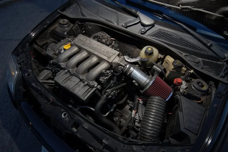

Max Powahhhh Induction kit, with CADs instead of fogs
Cobra Evolution seat
2x Willans 3" 4pt harnesses
YozzaSport Exhaust system with decat
Brembomax disks, with Ferrodo DS2500 pads
HIDs
Rosejointed Quickshift
Willams alloys
and also got a alloy bonnet, which is uber light thrown in aswell.
First impressions, I must say, are that I don't know why I didn't do one sooner, they pretty much perform from out of the box, very little been done to it, and I'm very chuffed.
On the shopping list that isn't allowed to be, so far, is a set of decent coilovers, and a diff :)
Your thoughts would be nice, however it probably looks just like everyone elses pretty much lol
