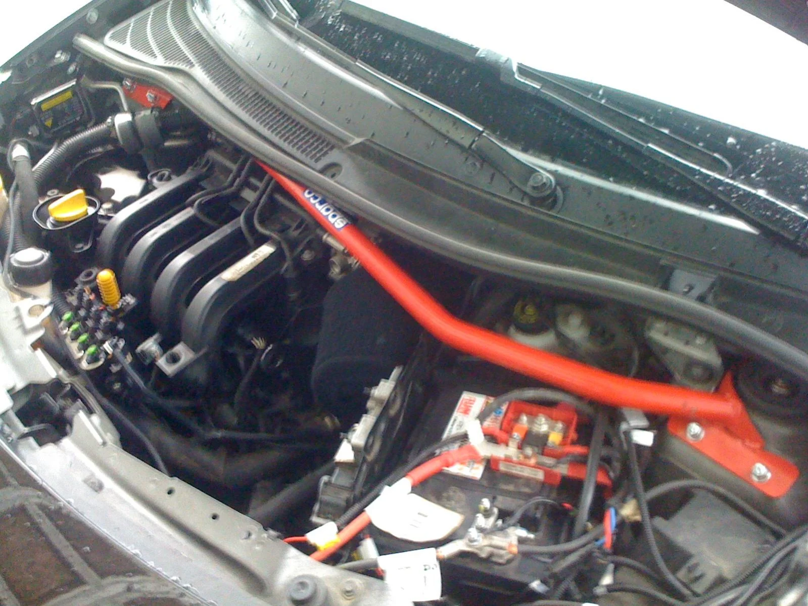

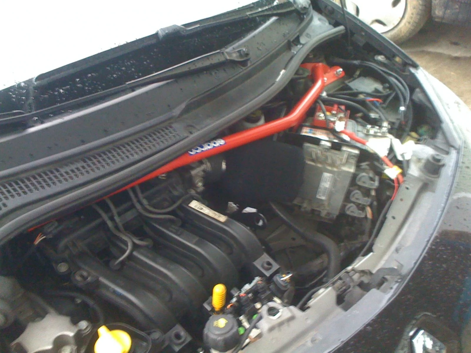

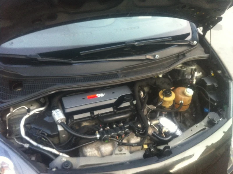

Pics of strut brace. :D

2 Danny:
It's from Clio II 1.6 16V. :)
Lots of modifications to fit.

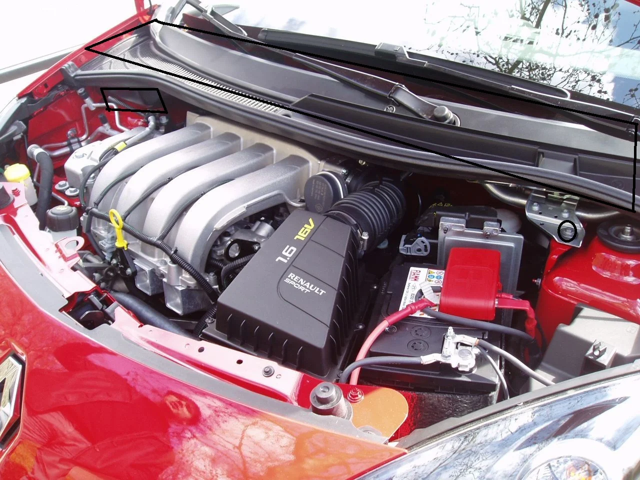

Marked parts going out. You have filter and battery on good place so your's dont going out. I must have "sport" filter and no battery cover on my 1.2. :)
edit:
Buy sturt brace for Clio Sport... Easyer to fit.

On left side you have box for air condition. You must cut a bit of it.
Everything else fit without problems I think.
Something like this will do the job. :D :D

This shape is best for Twingo II. It's from Clio 1.2/1.4 I think.
