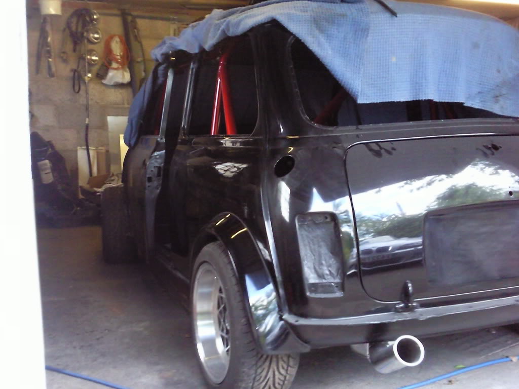

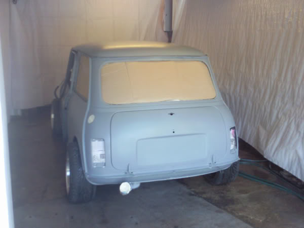

Right guys, had a good few weeks prep'in and painting the car.... 5 coats of gloss black and hours of rubbing!!...

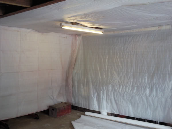

This is the paint booth I constructed to minimise dust and insects..

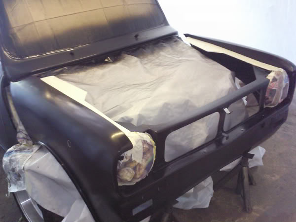

All masked up ready for a few coats!

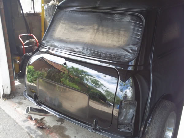

This is after 3 coats of gloss, rubbed back and ready for more!

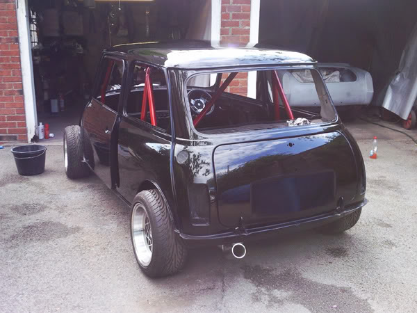

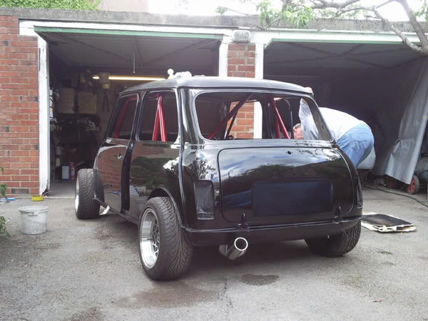

Finally after 5 coats it was time to start the finishing process - 1000 grit, 1500 grit, then course, medium and fine compounds, finally polish and buff....
Still got loads to do but you get the idea!!...

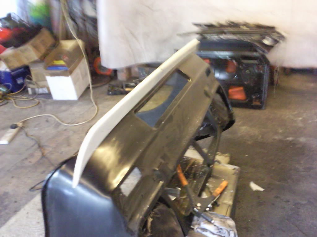

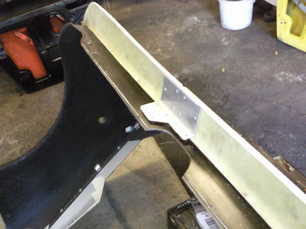

Little progress, started fitting the rear arches and blending my bib spoiler into the front end.
hopefully get a fair bit done tomorrow!!...
