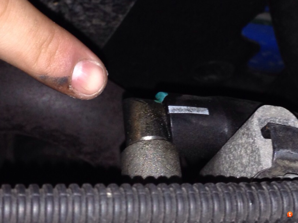

Turns out this little fecker had fallen out:
Question is, what is it? Would I have damaged anything?
Cheers!
  Many.

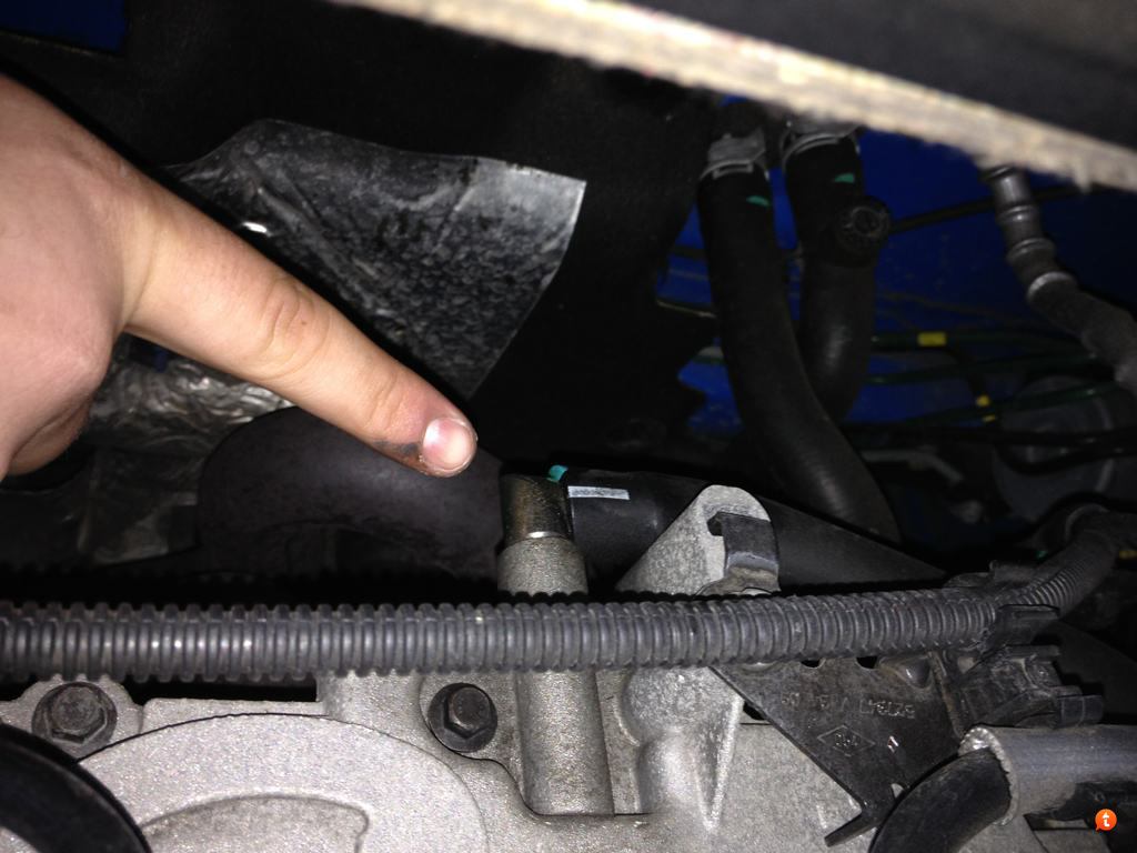

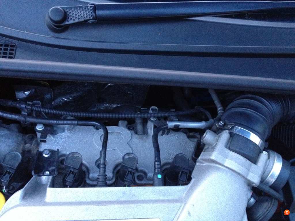

The metal elbow out of the rocker cover?
Its for the oil breather, not a huge issue, but it shouldn't have come out of the rocker, or had the pipe come off the elbow?
  Golf 7.5R & Clio 200
Excuse the rank finger.
But the whole thing was disconnected. Pipe still in the plug, it just wasn't plugged in. Took a good shove to get it back in too, I knd of guessed where it went :eek:
Mr R.
  A special one.
Id say put a black cable tie around it.
Pipe just gone a little loose.
  Fiesta ST-2 Finsport
Ry I'm struggling to understand, the rubber hose has come away from the metal elbow or the metal elbow has come away from the engine? (Lol)
Metal came unplugged from the engine, was just loose in the bay. Plugged it back in and all good, but it came unplugged again today.
the metal is in the tube solid, just wont stay in the engine
Ok got ya! That's unusual, I assume the noise was extra induction noise.
As below it will need to be glued back in with araldite/liquid metal.
wont cause any problems it could just spray a bit of oil mist
