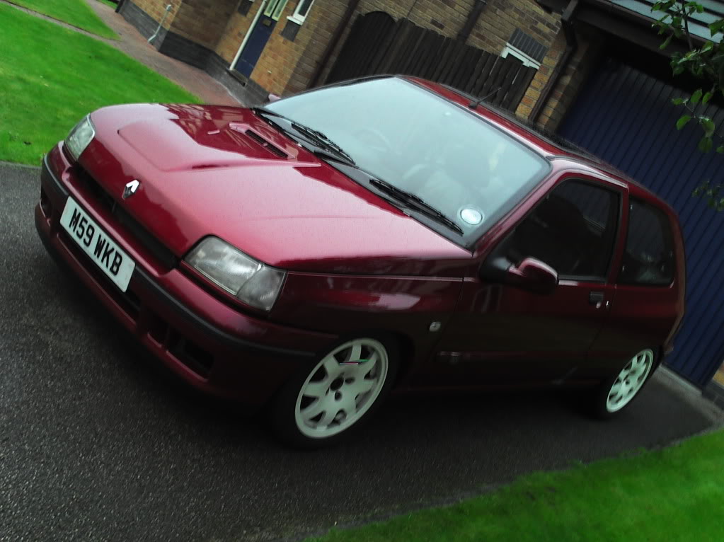

Bought myself a naples red mk1 clio 1.8 16v on monday 31 August 09. There are some bad points to the car and some good ones but for the age of the car its in ok condition.
Good points..
Williams wheels
Williams spoiler
Big brake conversion, so ive been told
Black leather trim
Immobiliser
Bad points..
Few dints
some little patches of rust
valve stem seals are going
wheels are fading
Realy just needs a good tidy up and then ill add my touch to it

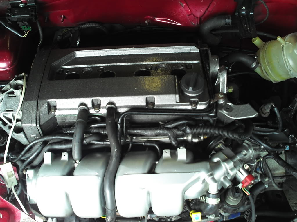

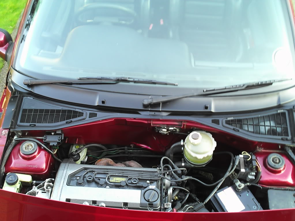

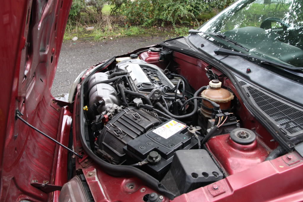

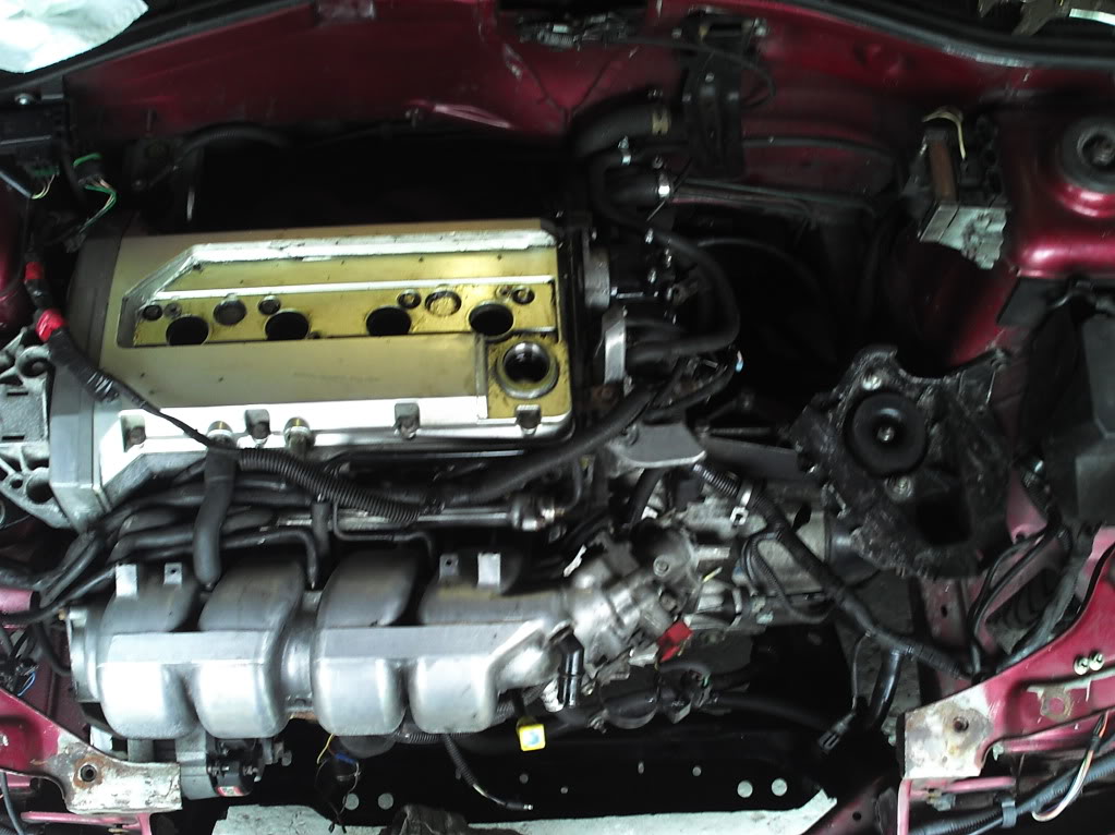

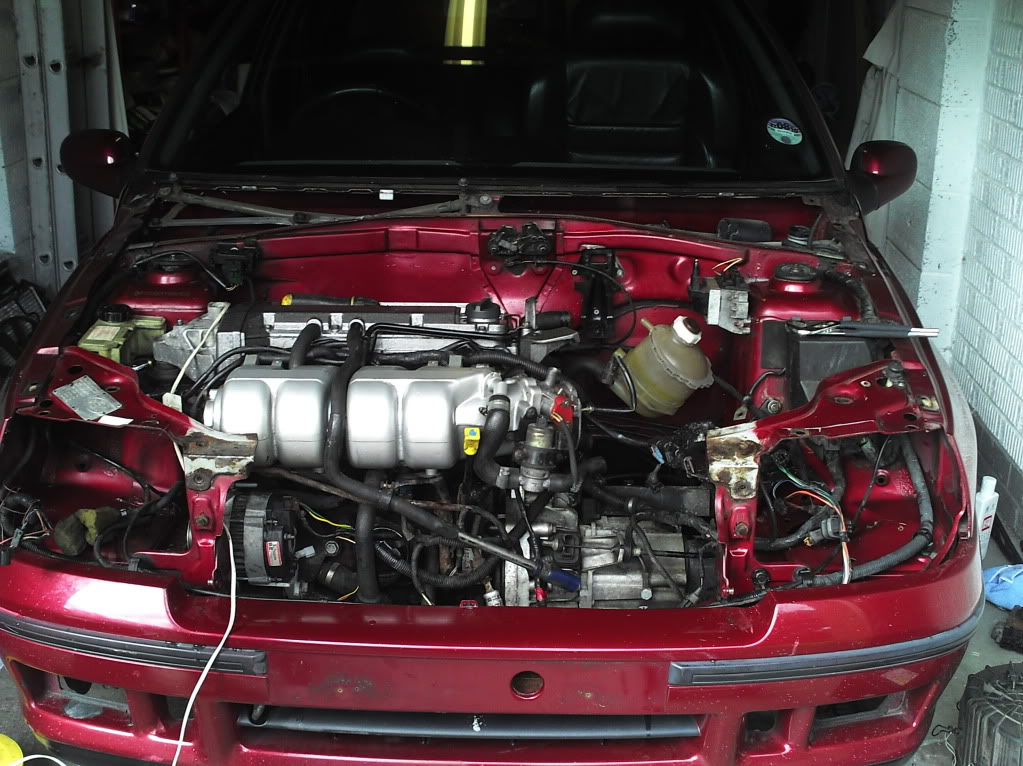

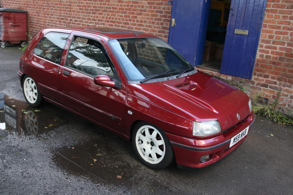

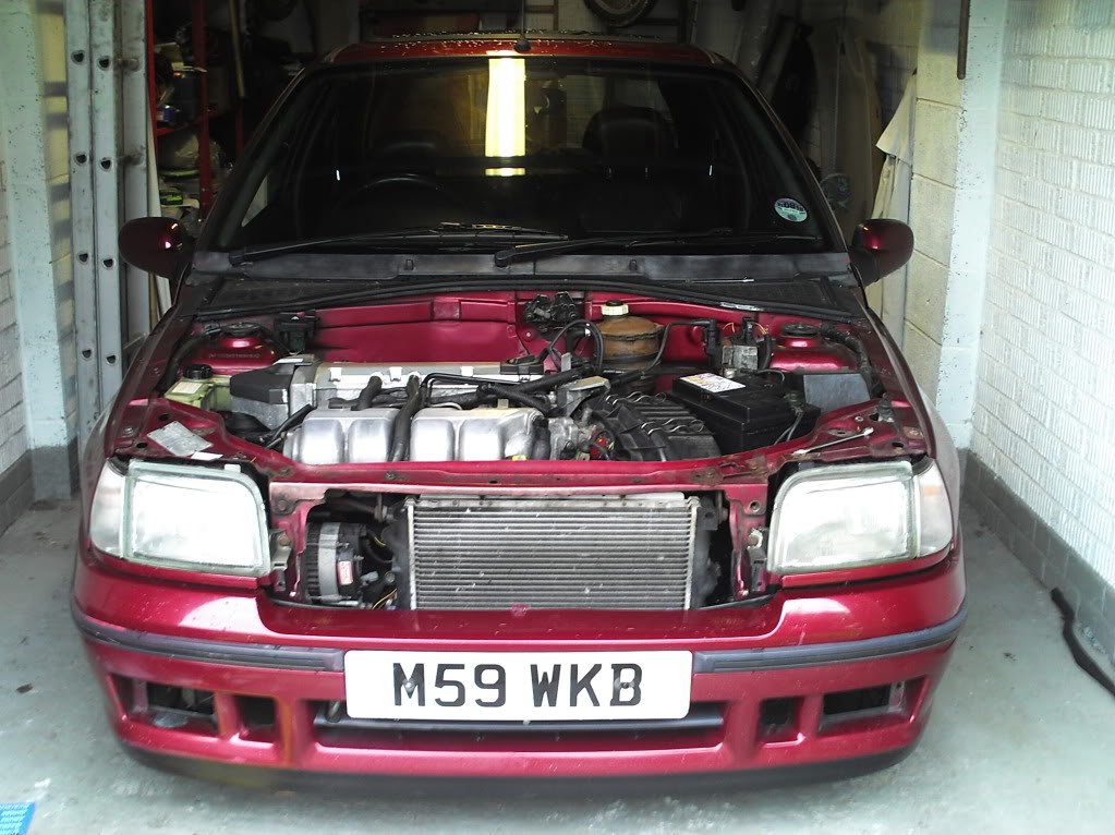

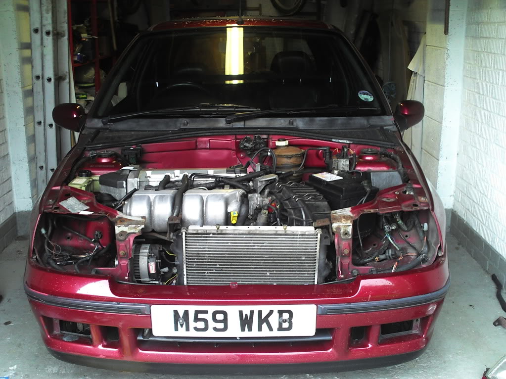

If you look in the second pic the car is on full lock as MARK ONE said and then the pic of the engine bay was taken at the same time. The firts pic was take 10 mins before i started to take some grills out of the front and move the car around
aye liking that laddie! height looks good too, think im gonna cheap out on springs for now before i can afford coilies.
i like the colour coded vent thing, thought it would look abit too smooth but i like, better than my bright orange one anyways lol

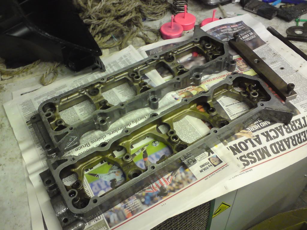

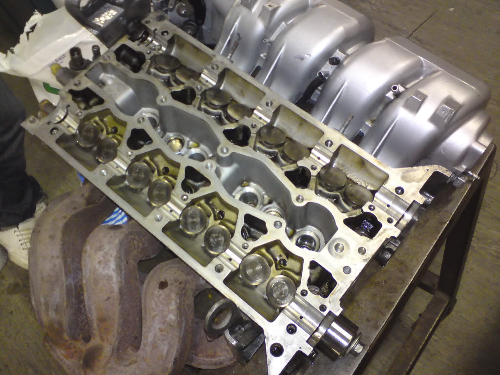

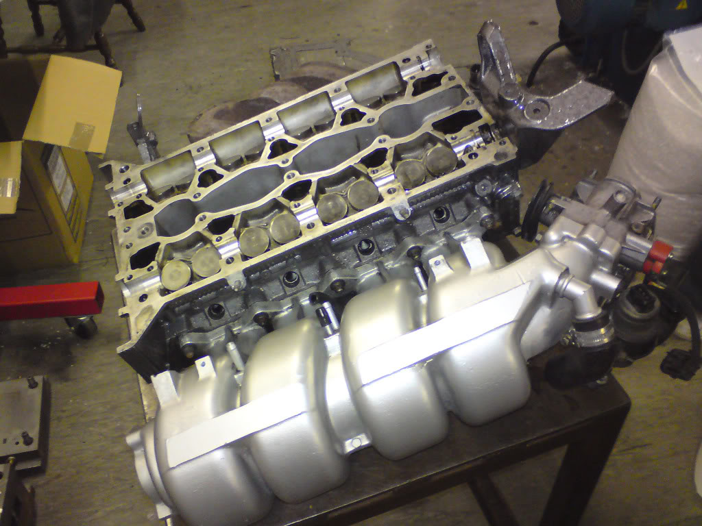

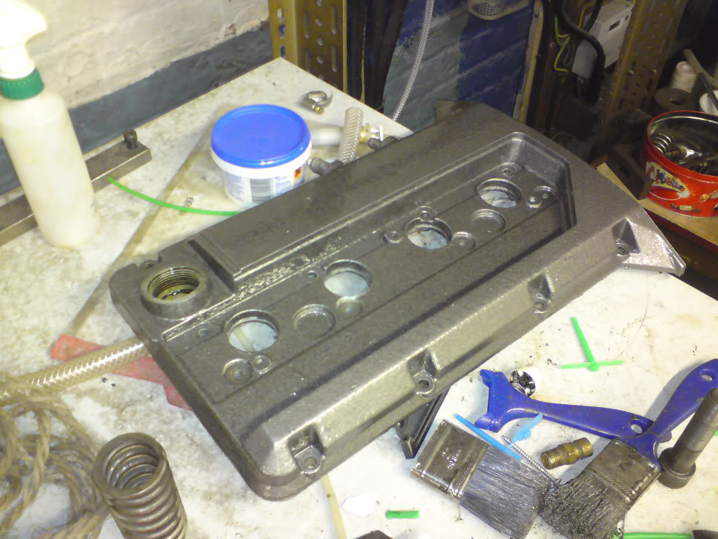

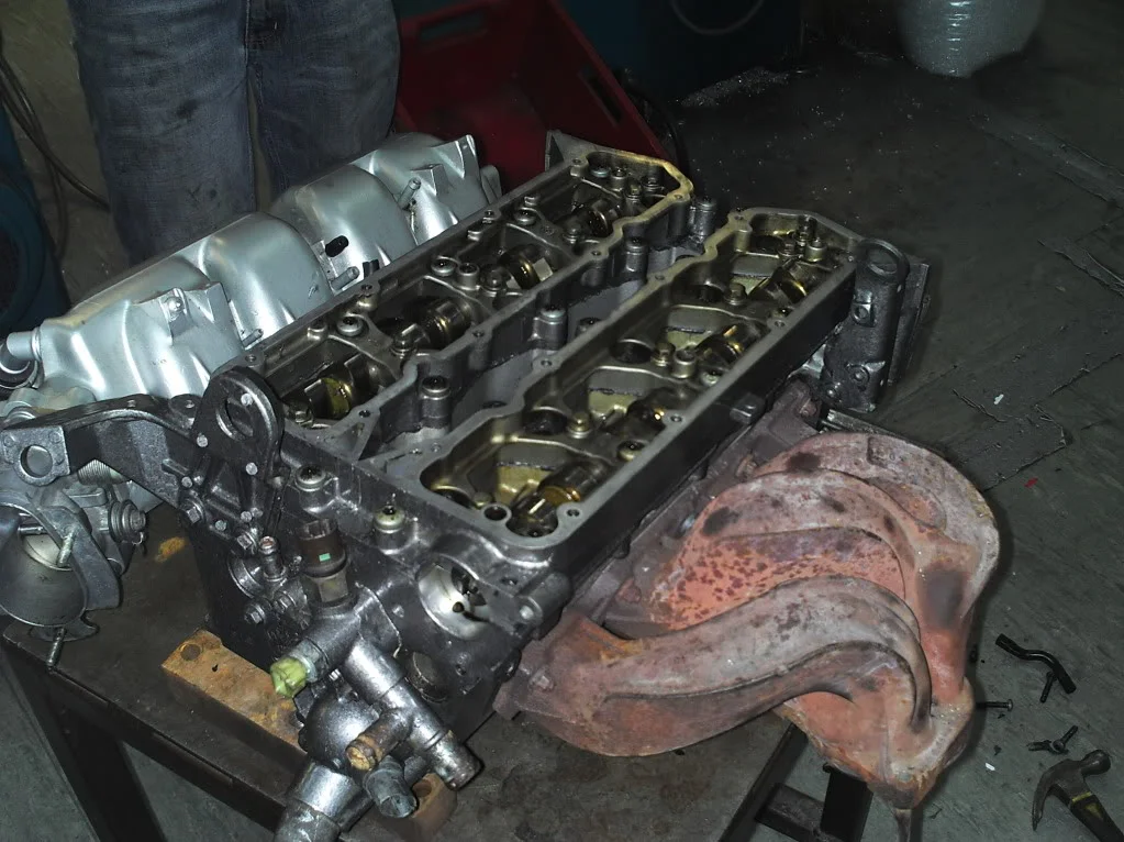

This is what has been happening the last few days, been sorting the new head out to put on the car today. Thanks to f0xy once again

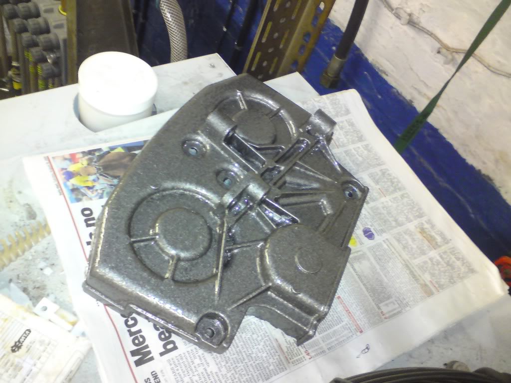

Started by cleaning up the head, rocker cover,cam belt cover and the plates that hold the cams after drying them we started to paint it all up in a silver hammered hammerite.
This is wot they look like now
Going to go and put the cams in and seal it all up then i can bring it home and put it in the car

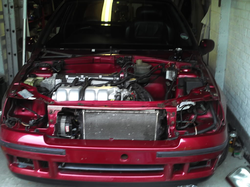

Well wot a 3 days working on the car its been, somethings went smoothley and other things whent wrong
The stem seals needed replacing as it was smoking from the back luckily f0xy had a head that was rebuilt 20,000 miles ago

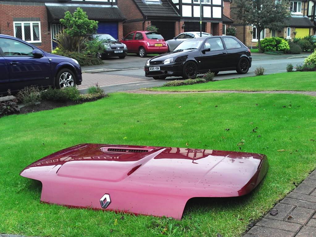

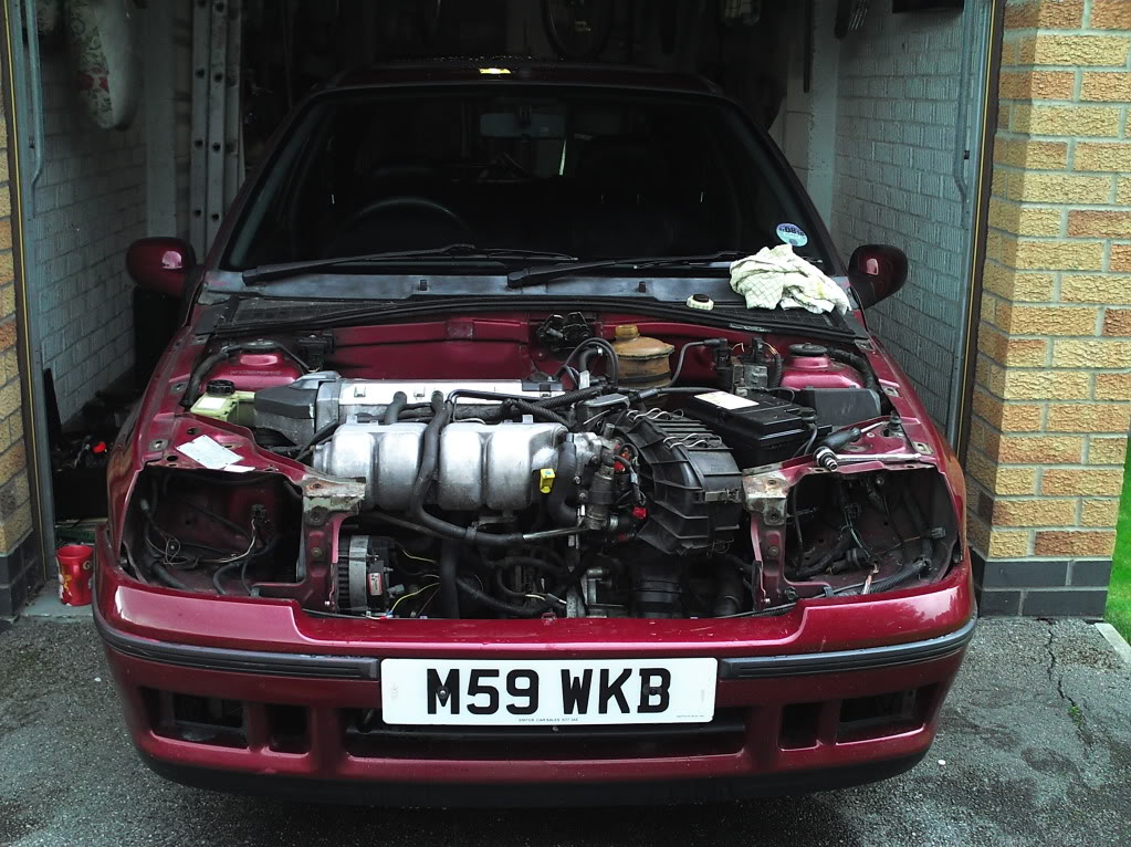

Started off early saturday mornning by taking the bonnet off, didnt realise how much thay weigh.
Wot a state the engine bay was in dust, muck and cobwebs everywhere

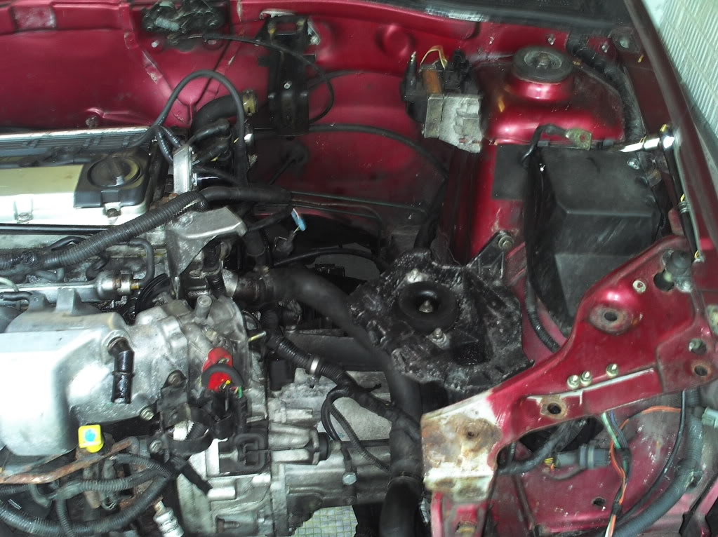

The next thing i did was to disconnect the battery and taking out the front lights along withe the slam panel

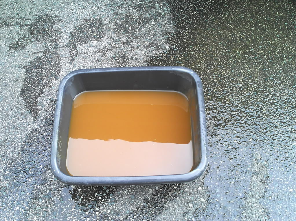

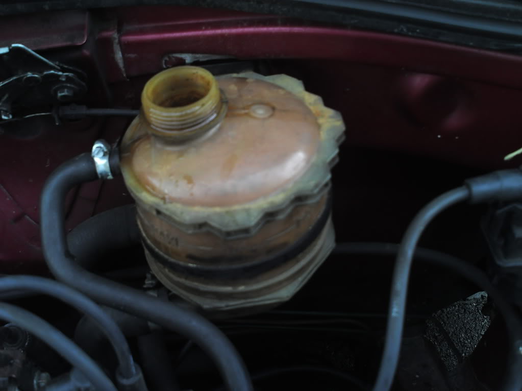

I then rolled the car out of the garage slightly to to remove the radiator and the old coolant that was full of crap (looked like T)
This was the state of the old coolant bottle

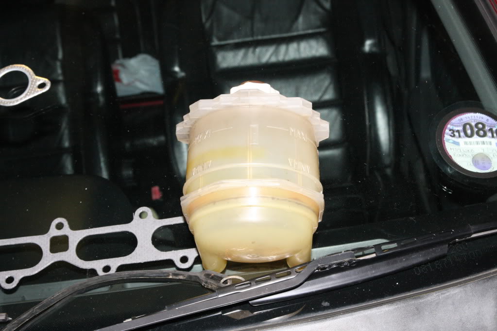

it looked like it had done its time so decided to get another one off f0xy
looks so much better with this one on
Pushed the car back into the garage, wot a struggle that was uphill lol
Started to disconnect the water hoses, wires and pipes off the engine and remove that horrible coolant bottle and also the air box
out cam the spark plug cover and off came the dizzy cap

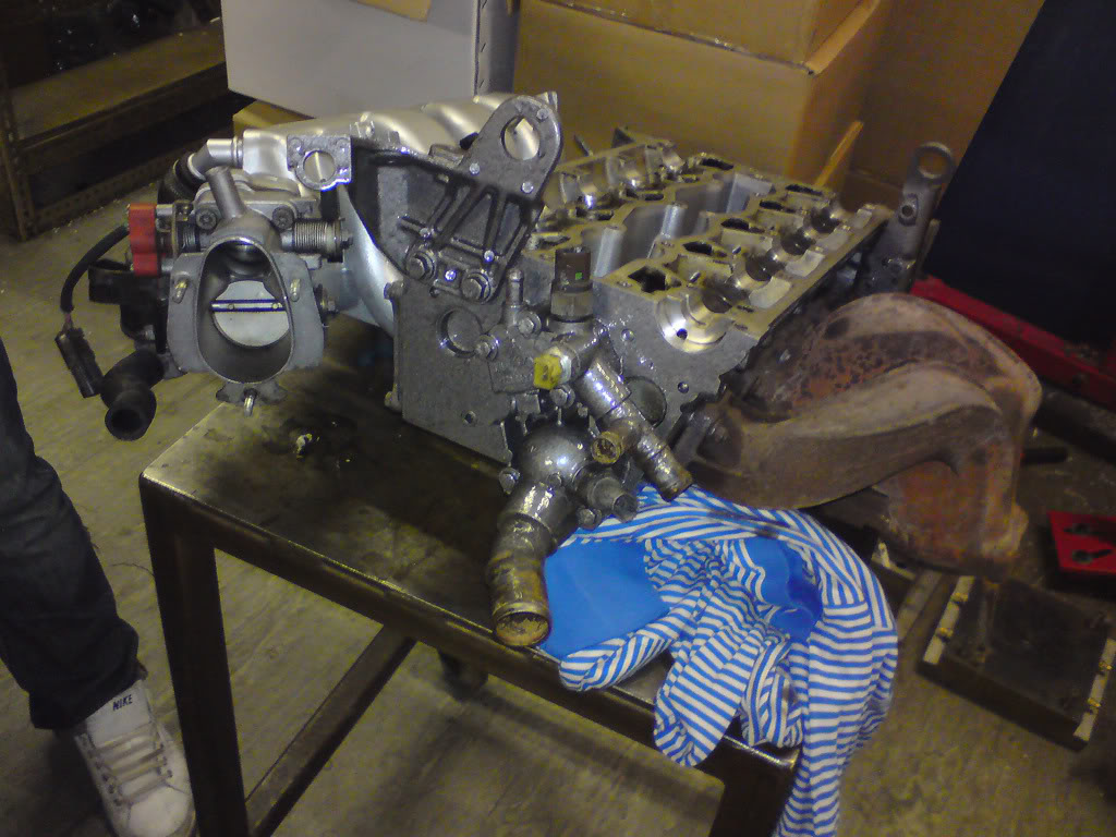

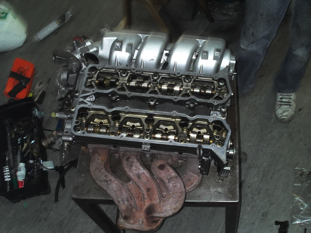

at about 4 me and f0xy went to the factory to build the new head up
more to come ...
  Mk1 F4R

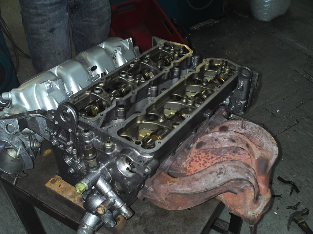

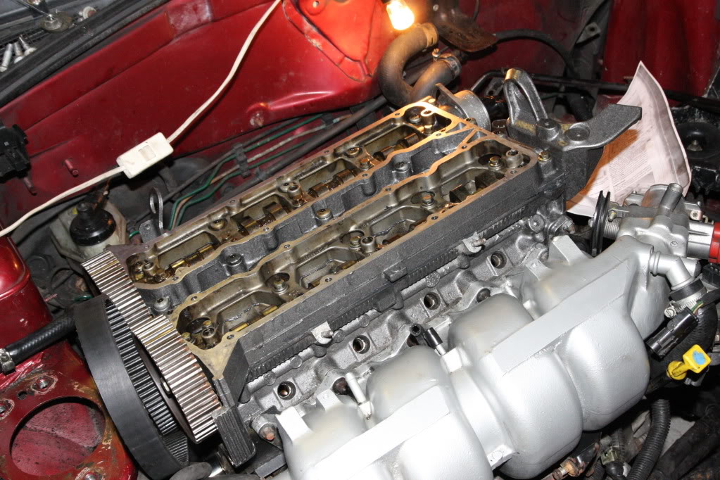

At the factory we needed to put the cams into the head and then put the cam carriers on top with the cam seals 40mm , once this was done we put it into the back of the car and took it back to my house

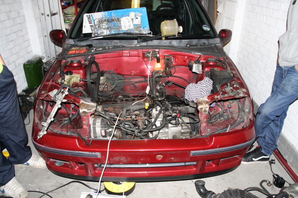

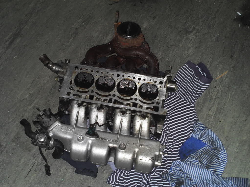

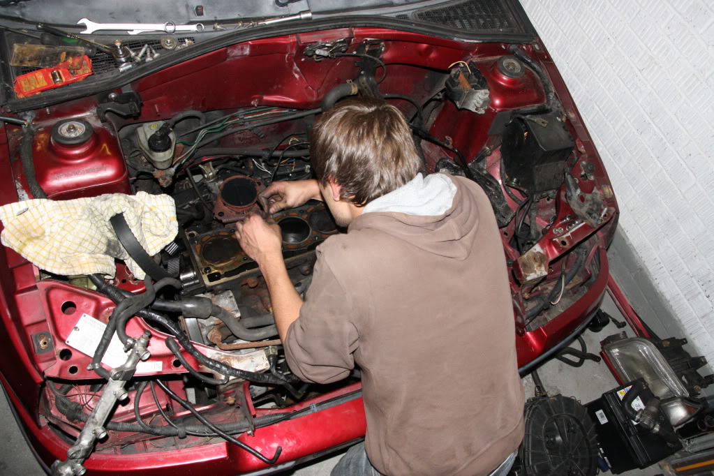

got back to mine quite late on about 8 ish and started to take the old head off, once f0xy was with me helping thing started to go a bit quiker

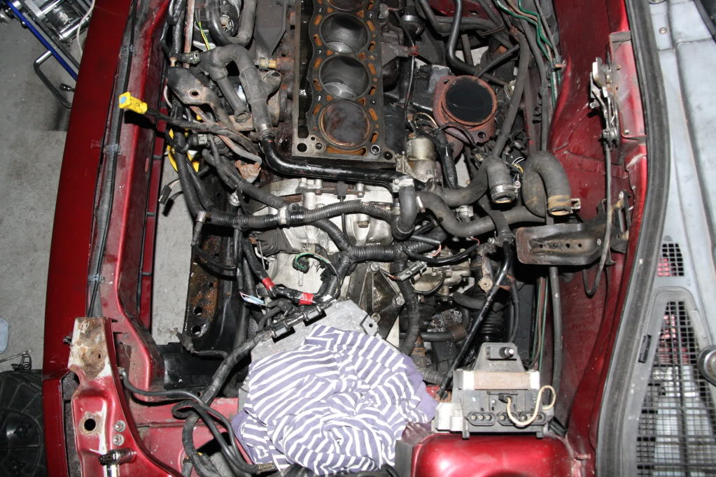

Head came off quite easy when you know wot you are doing, cambelt, injectors, pulleys that sort of thing
One of f0xy scraping the old gasket off

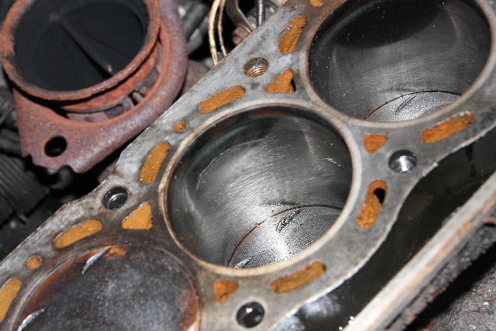

whilst we had the head off we noticed a marking/scoring in one of the
cylinders, didnt seem too bad
The new gasket was fitted and the new head was put on, second time lucky as we left a pin in the bottom of the head and these things arnt the lightest of things to hold for along time
It was bolted down and the pulleys put on, then the rocker cover put back on.
I then let f0xy work his magic with the timing

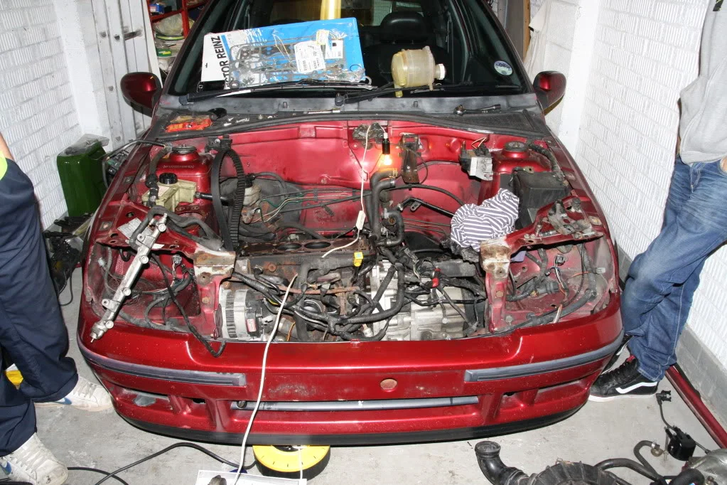

Everything was now back in wires, pipes, manifold bolted back on and the radiator was put back in.
These were also swapped while the head was out crank sensor, idle control valve, throttle position sensor and coil
All the engine bay has been cleaned and srp'd and looks a lot better now
Everything was then put back on the car and it started up firSt time.
Turned it off after 20 mins then tried to start it again and this is when the problems started it would start then cut straight out again. This is when we started checking everything possible that f0xy knew of and it took us till 10pm on monday to figure out what it was and there was two little plastic granules in the vacume holes on the inlet,pesonally i think it was a guy at f0xys dads work being an idiot like usual messing with things but who knows, anyway we got a soldering iron and burned through them and the car works fine

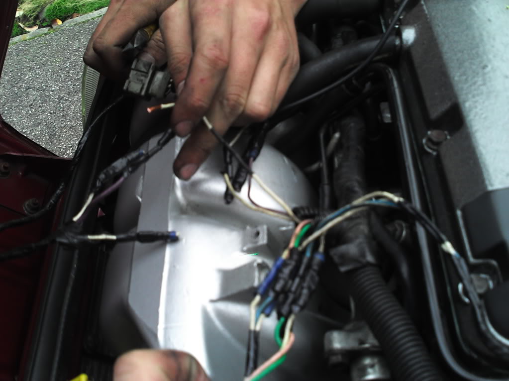

We also changed alot of the wiring and is now miles better
This is the old wiring we soldered it all up

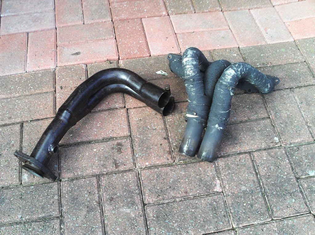

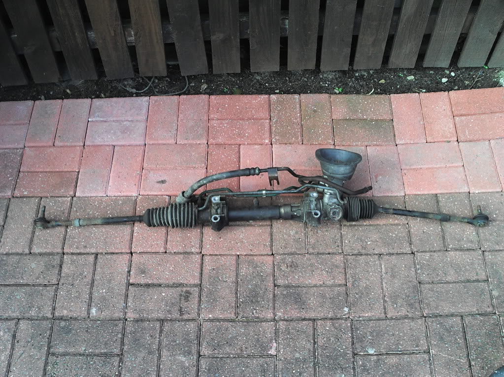

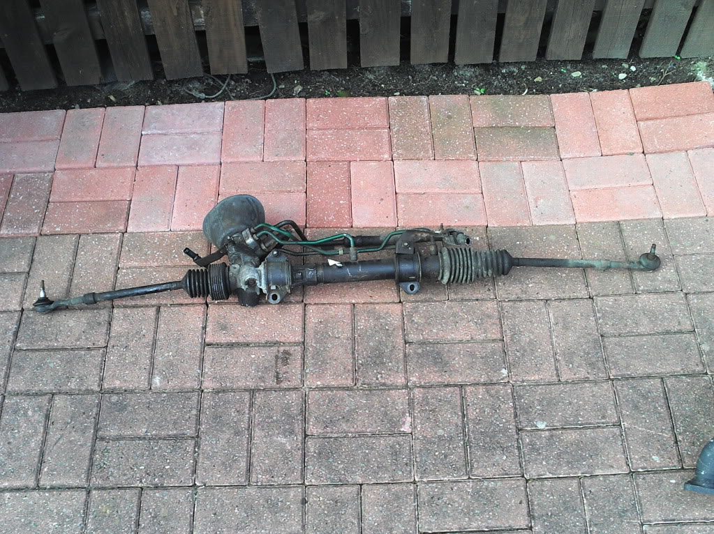

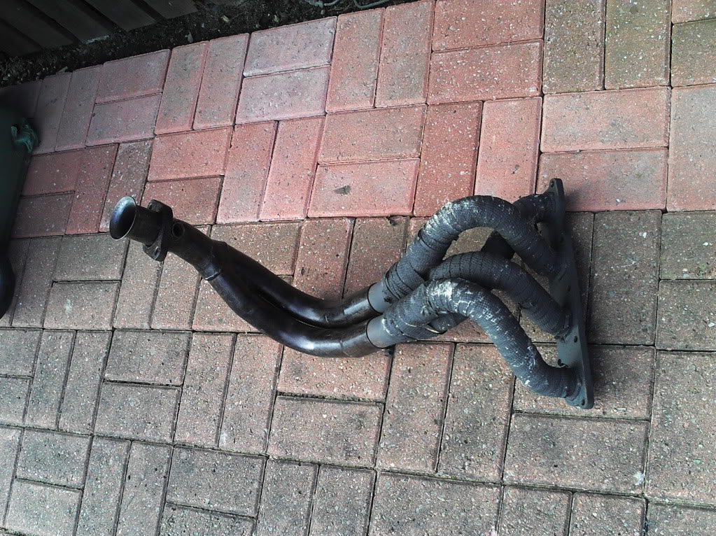

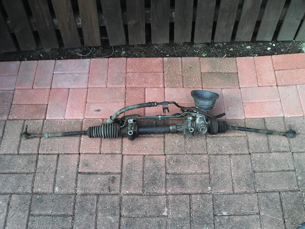

Yesterday went on a 50mile round trip to pick up 2 new items, the first one was a williams steering rack from coops and then from coops parents house nr warrington it was on to winstons house to pick up a 4-2-1 supersprint manifold and its wraped too.
Decided to do the 172 wide track
Williams steering rack for the 172 wide track
supersprint manifold 4-2-1

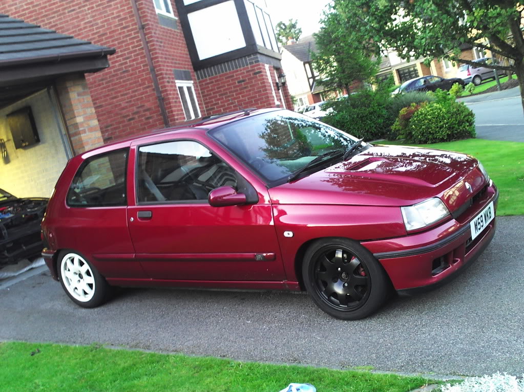

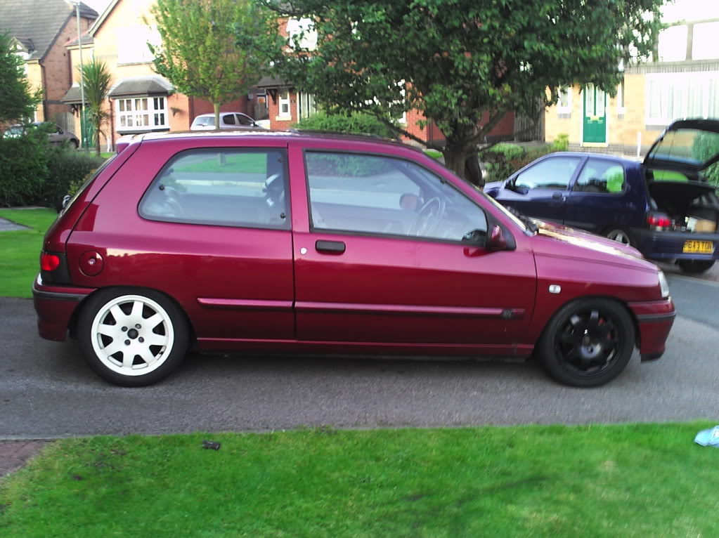

tried one of f0xys wheels before for when i get my wheels refurbed but cant make my minde up wether black or white
Wot do people think

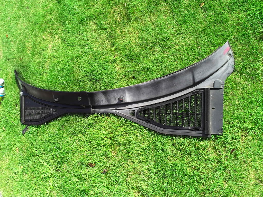

Also sprayed the scuttle panel in black as it was fading

I think either colour wheels look good tbh, white is more rare than black these days but will get covered in shiiiit and baked on brake dust on track?

looks sweet. im thinking i prefer the white on red look more.

black wheels all the way, its what i had on my naples a few years back.
Might get giddy with some black paint later and if they look good in black ill get them powder coated soon and then they will look even better with 172 widetrack
