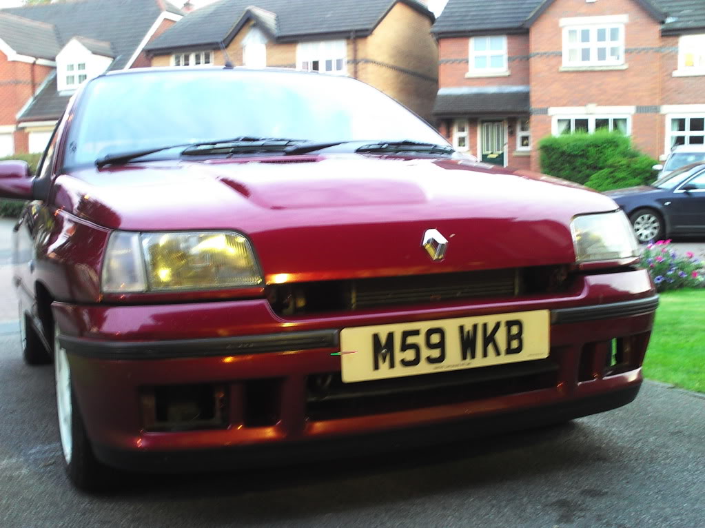

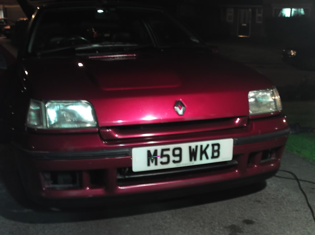

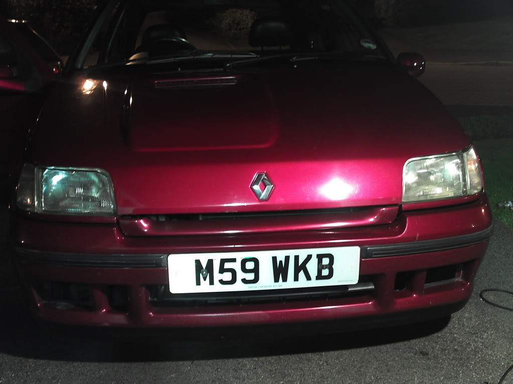

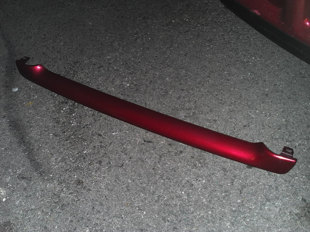

Grill arrived the other day and is now fitted
Before
After
Looks alot better with the grill in

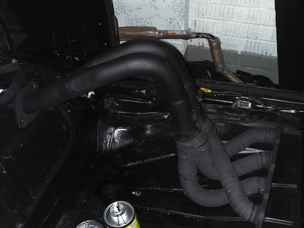

and last of all sprayed the manifold with high temp paint to tidy it up

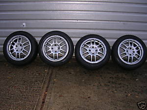

Excellent project this, naples red with gunmetal grey wheels allt he way.
Might have to get my self some cans of paint Black,gunmetal grey and maybe another colour to see wot looks the best, Then get them powdercoated

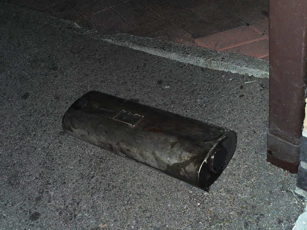

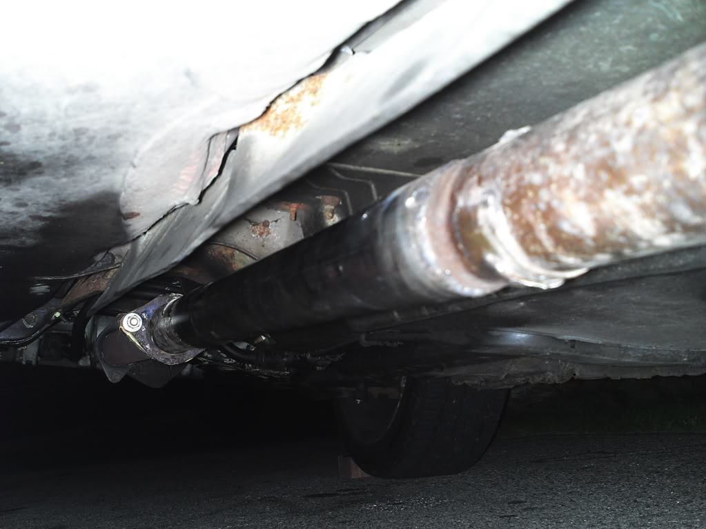

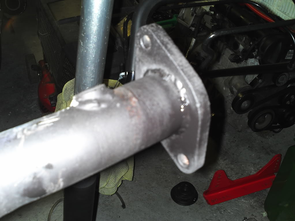

Decided to take the center silencer out on friday and swap it with a straight length of stainless steel that i bought from pipewerx, Lathom nr wigan £10 for half a metre and then got the ends oppend out to slide onto the existing pipe, then went to a friend who welded the center section up along with the manifold flange as it twisted so it would fit other exhausts.
We then cut the excess on the end to make it flat and fit to the decat
I then took it home to fit it back to the standart manifold, It was slightly longer then it was before which was good as the taile pipe was out of the bumper as it was flush with the it before

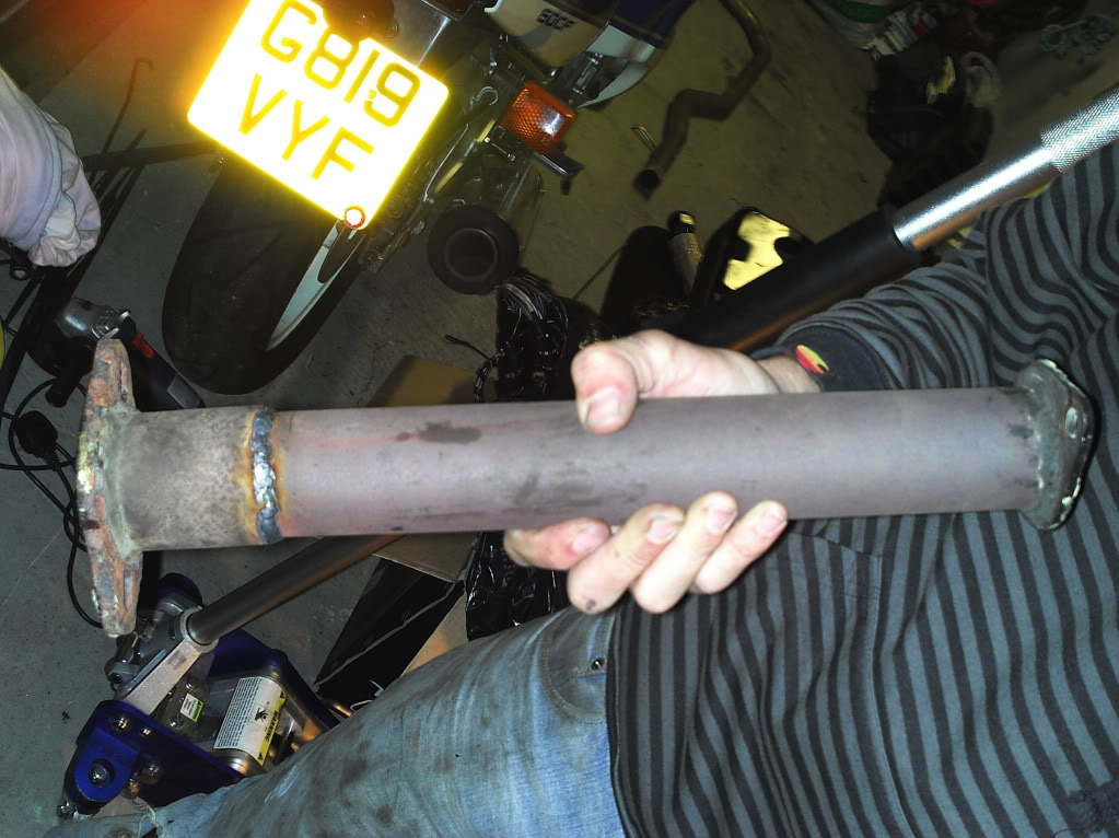

This is wot was cut out the old silencer

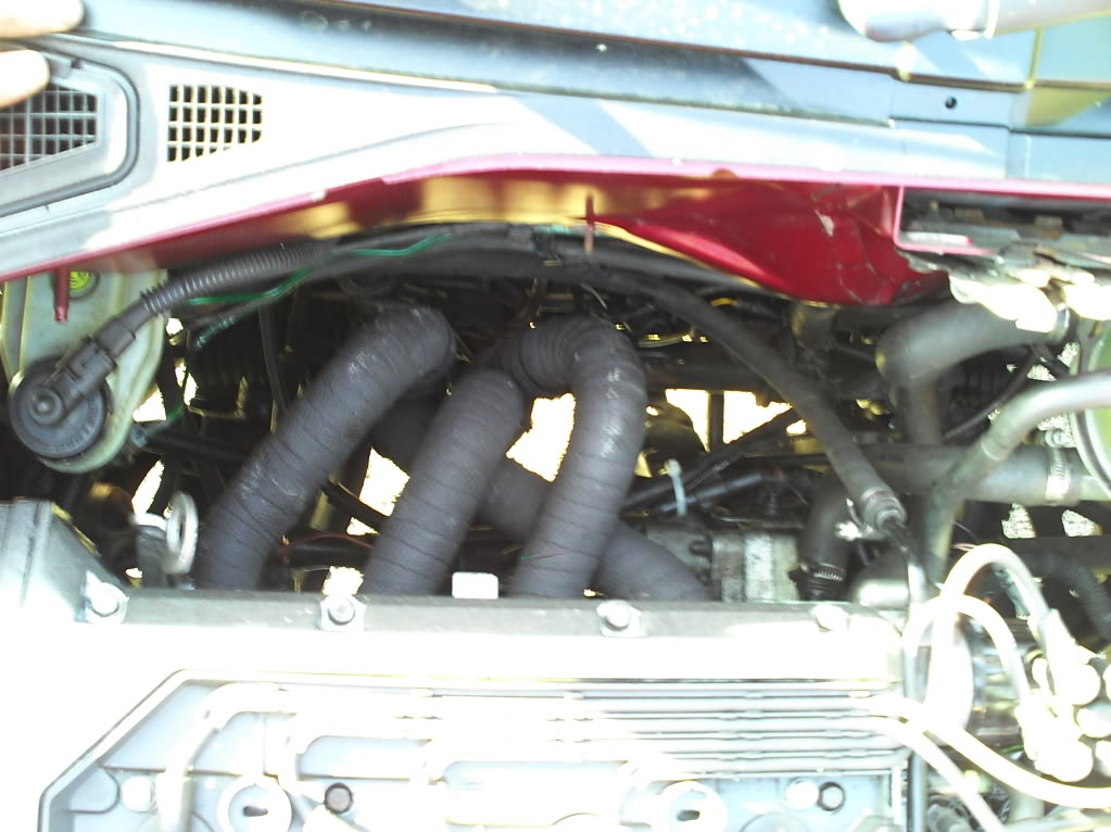

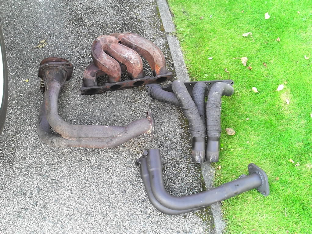

On saturday started to fit the supersprint manifold

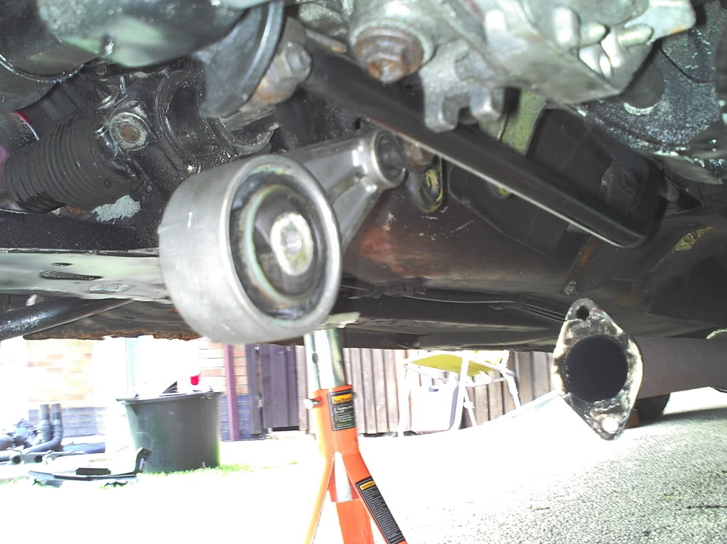

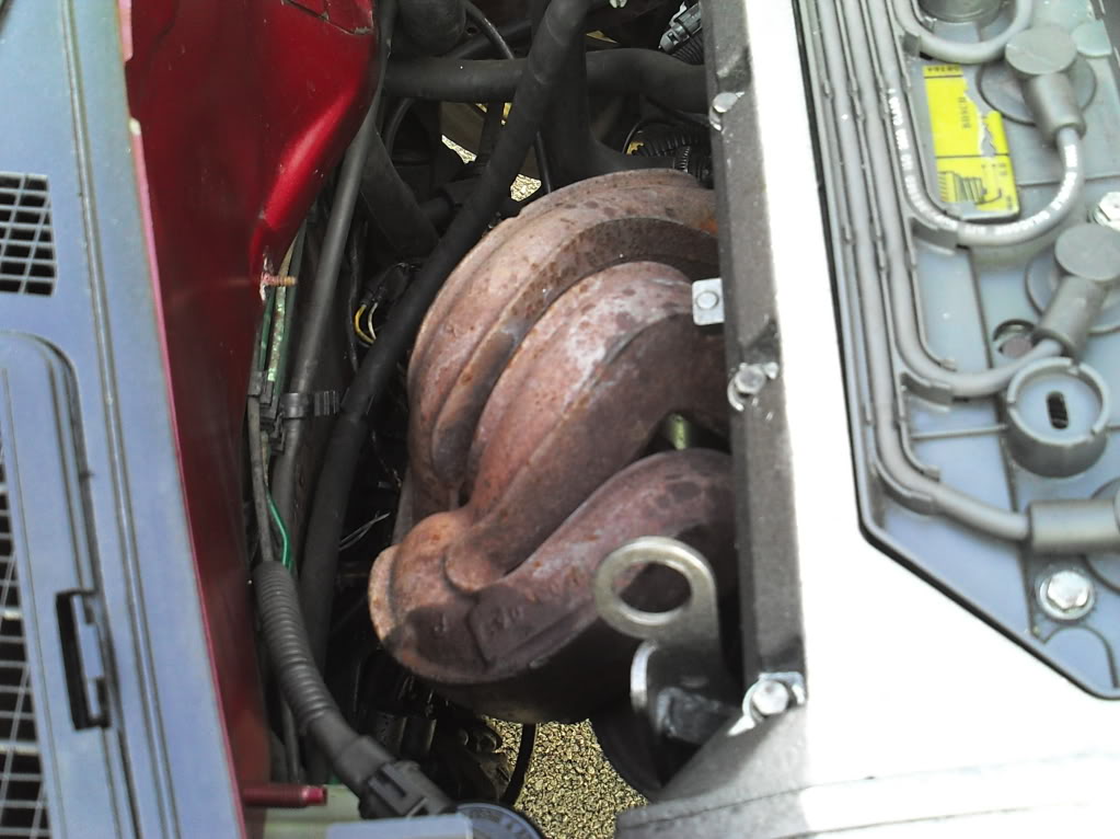

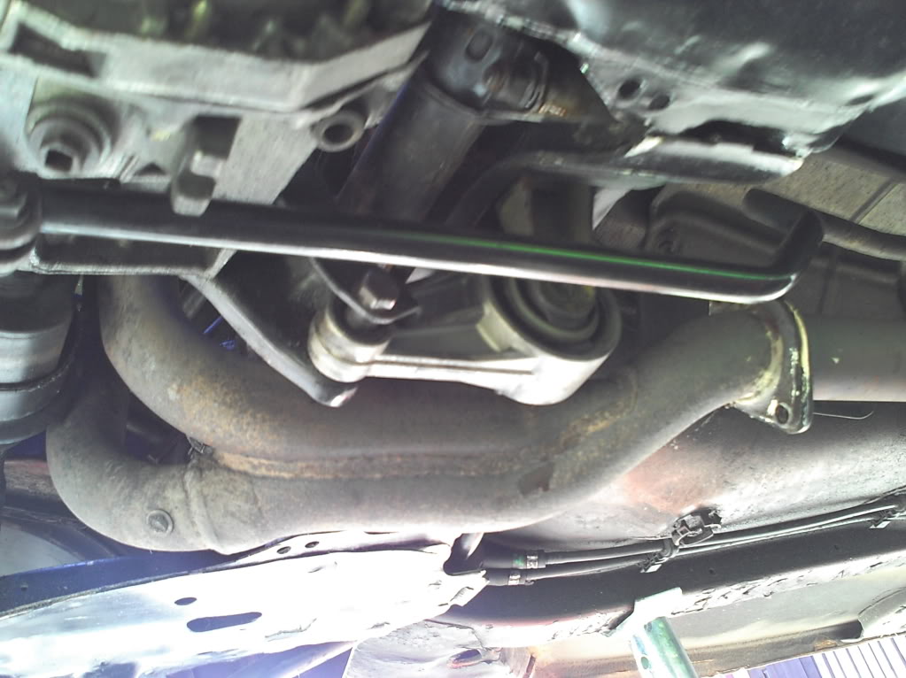

Started by taking off the old downpipe off and it gat stuck between the driveshafts and the back of the engine bay, so i thought if i took the dogbone mount off to let the engine swing, it dropped out with ease.
I then had the challenge of taking the manifold out, as i was told the old bolt maybe stuck on and maybe hard to get off, sprayed the bolts with WD40 and left it for 5 mins, they came out pritty easy tbh, didnt realise they weigh that much.
The size difference and weight are so different
New one fitted

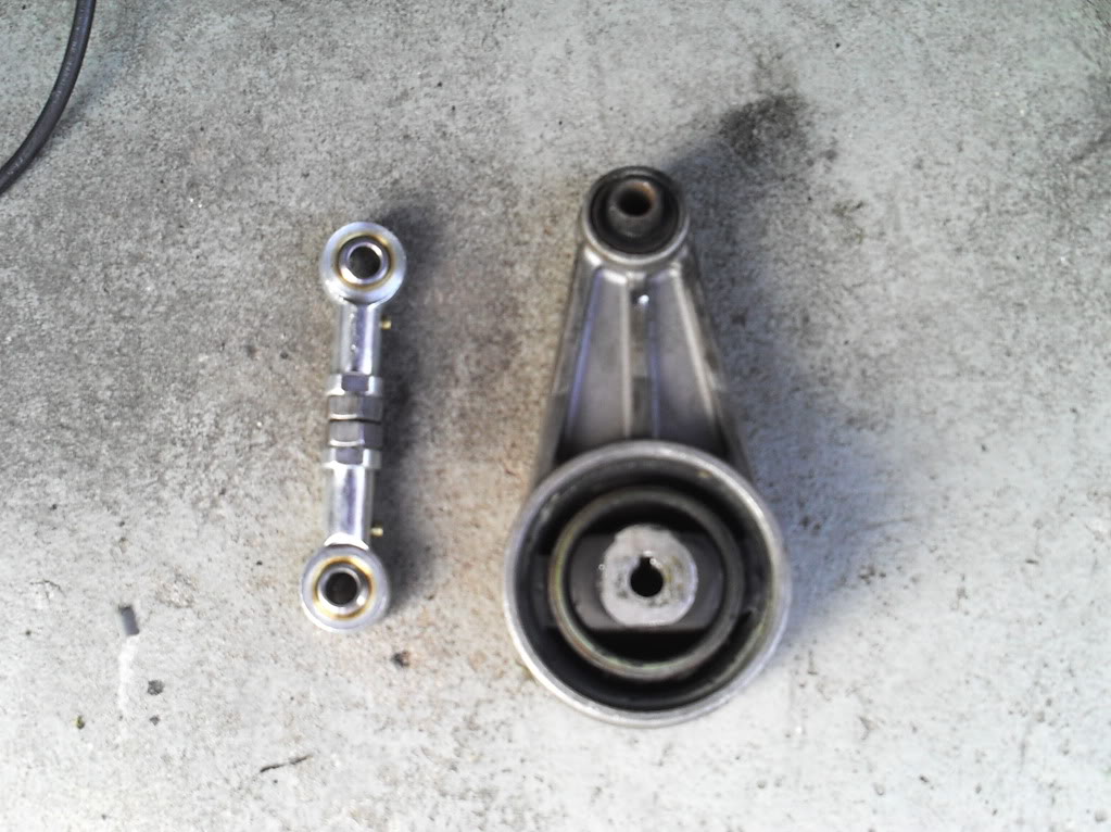

I then took the old dogbone mount off and replaced it with a coops solid one, it makes so much difference he said a little vibration, feels like my face is being shaken off lol

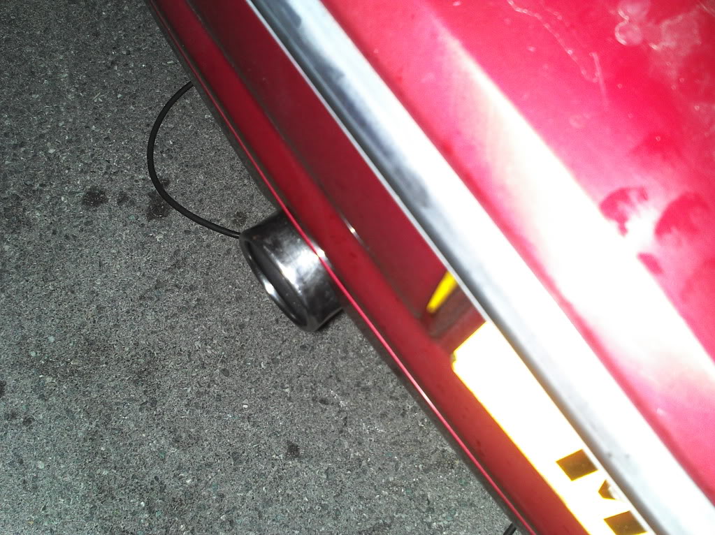

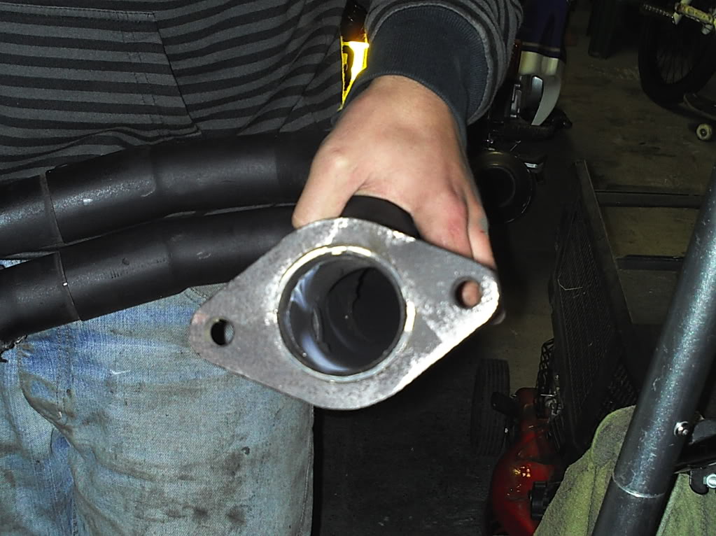

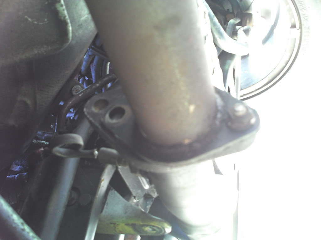

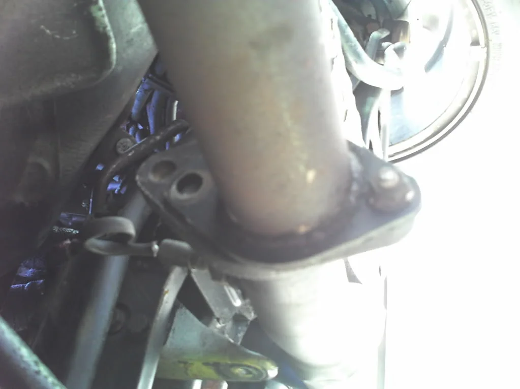

After putting the dobone mount back on i then put the down pipe back on and then realised there was a problem, the decat flange and the downpipe flange wasnt the same size
This was fixed by going back to my mates who does the welding and f0xy kindly donated the right size flange with a bit of pipe still on the end and it was the right size to fit over the 2" decat pipe this was then welded back up an inch and a half sorter, this was a bad idea as the tail pipe is now back in the bumper
Its all on now and its blowing a little bit but easly sorted, the only other problem i have is the way we have done the flanges on the decat and down pipe as it hangs an inch or so from the floor not too sure wot to do about it yet

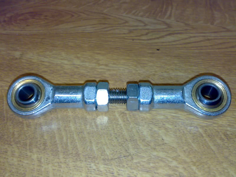

This is the the one i made for mine, worked but the vibrations annoyed me, so took it off, been sat in my bedroom ever since lol
  Mk1 F4R
That is exactly the same as the one i have from coops
how much did you pay for the bits in total
im not to bothered about the vibrations as the car is going to be a track car

I hope it does, i've never been out with someone following behind but hopefully will sometime soon. Still got the centre section in mine aswell and the exhust is hanging really low. Can't go over speedbumps, so that'll need sorting before marham, I remember yours last year scrapeing going in.
  Mk1 F4R
Yours is hanging low jams, mine is about an inch from the floor as we welded the flange on the decat/manifold the wrong way lol need to sort it soon

And parts i got from work, so just made it up, never looked to see how much one was to buy...,anyone want a solid dogbone for £10? lol!!

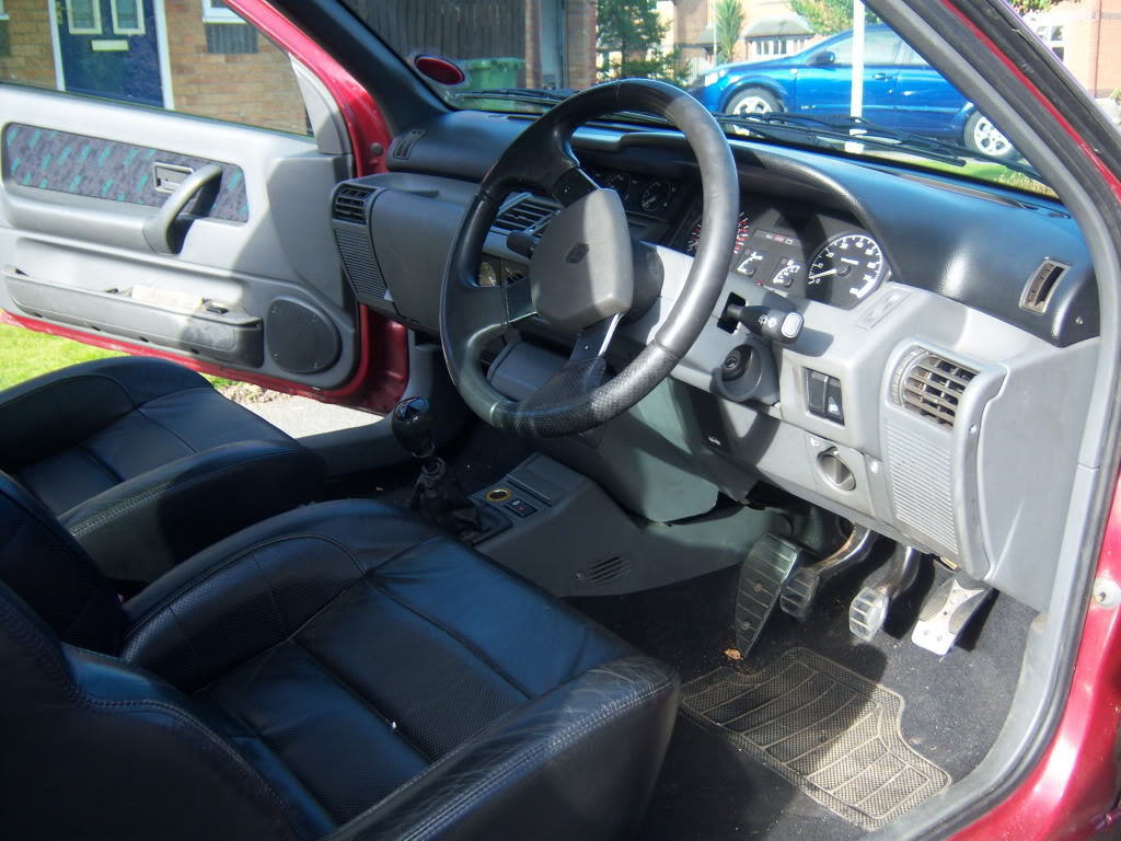

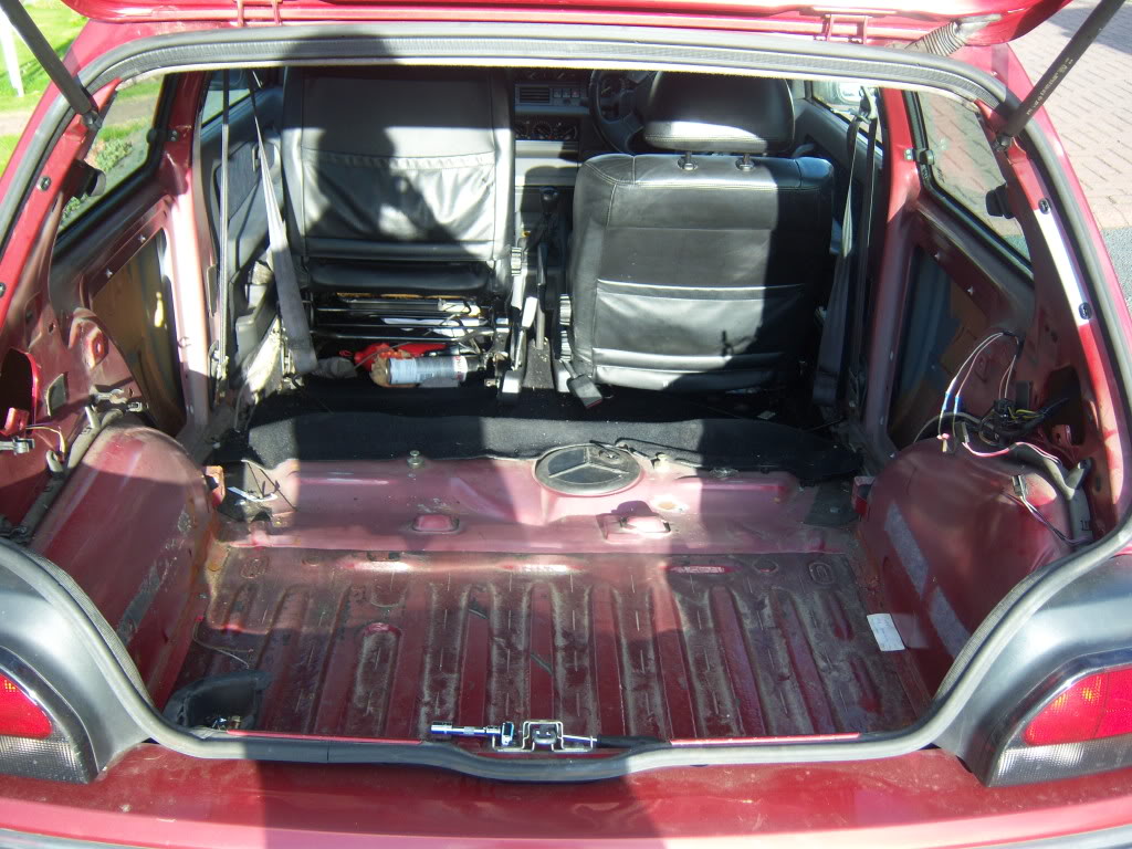

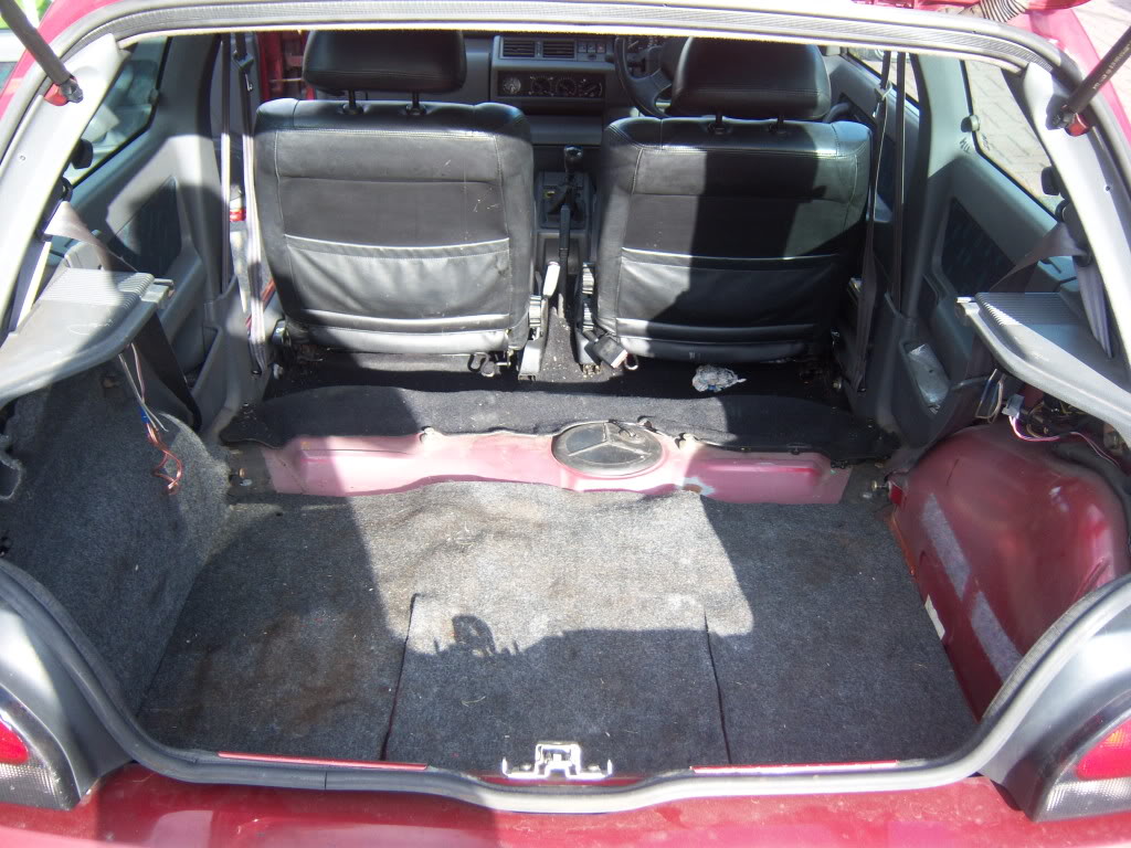

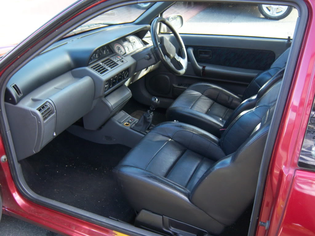

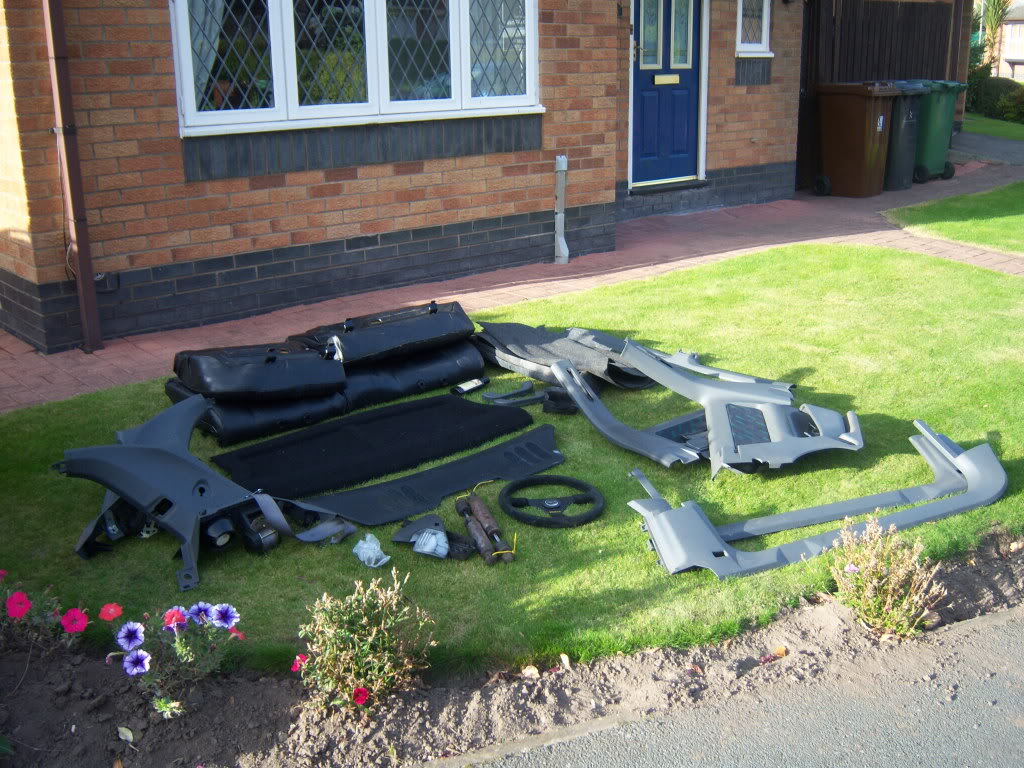

Started to strip the car today, was abit worried abot wot i would find when i started to remove things but all is ok, few liitle bits of rust but nothing major
There is quite abit of stuff to remove and still quite abit more

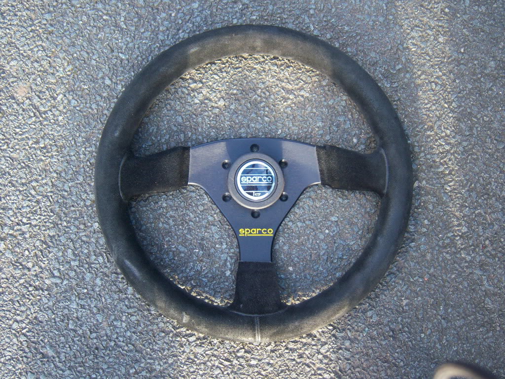

This is the steering wheel i will be putting on, saved it from my last car

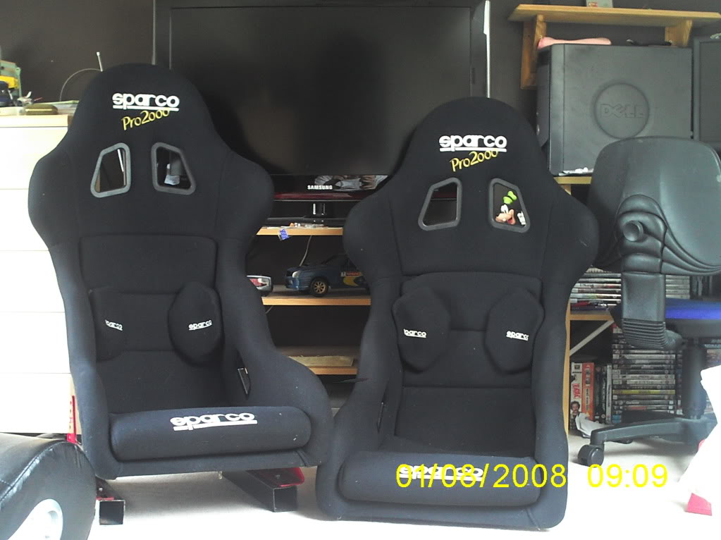

Tomorrow i will be getting some bars for welding so i can put my bucket seats in they are Sparco pro 2000 also from previous car
also tomorrow i will be striping the rest of the car out. The things that are left, carpet, few little bits of trim, roof liner remove seats for bars to be welded in
