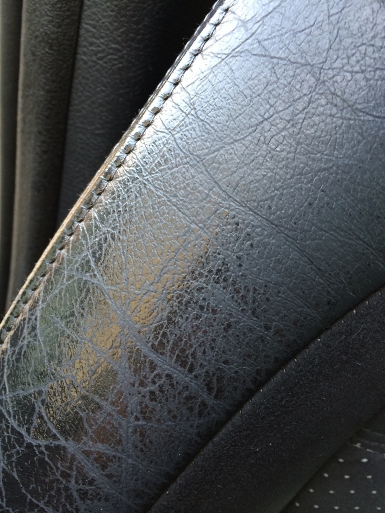

Hi all, when I bought my seats they were really black on the leather I assumes this was the meguiars cleaner the seller had said so thought nothing of it, now they've been on the car for a while and in the cracks of the leather the real grey of the seats is starting to come through, so this must be some sort of sealant/coating?!
But what? I've tried to get it off with AF Hide cleanser and it's taken me about 30 mins just to clean up the bit in the picture... Any ideas how I can get it off? What products and technique?

Someone's used leather 'dye' on it but sadly, you cannot dye leather. Effectively, it's just been painted.
Your only option would be to speak to someone more qualified than me. You could use a harsh cleaner (TFR works wonders!) but prolonged use and/or scrubbing it can result in ruining the leather for good.
Or you could buy a black 'connolising kit' and re do it yourself? But in time it will crack again. Although done properly, i've seen it last years and years!
Either way, it's fixable so don't panic.

Cheers Dan, where can I get some TFR from? And what is connolising kit lol!

When I bought my seats someone had put so e whit sealant s**t on one of the bolsters, a mixture of claying and apc, eraser and warm damp microfibre sorted it. If not you'll have to redo the leather yourself as Dan said there's a fair few kits out there.

Like a clay bar? Sorry what's apc?

Yep clay bay, apc is all purpose cleaner. Start of diluted and then slowly drop the ratio until it starts to work.
