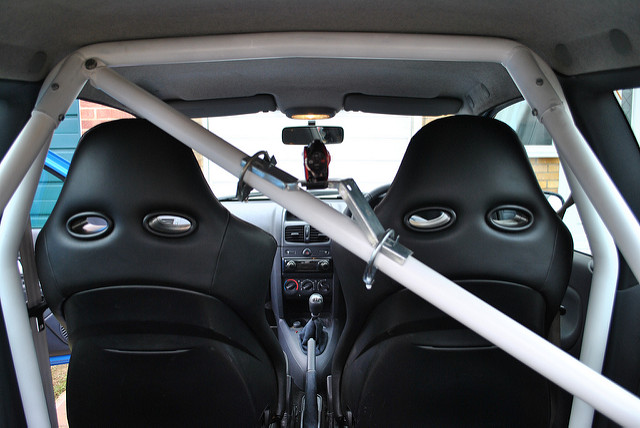

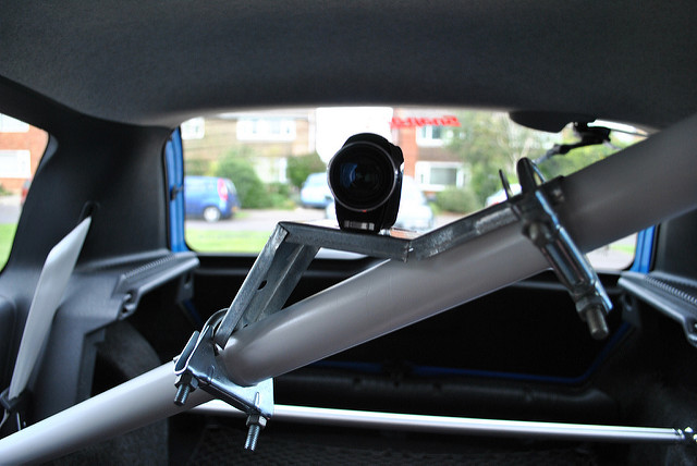

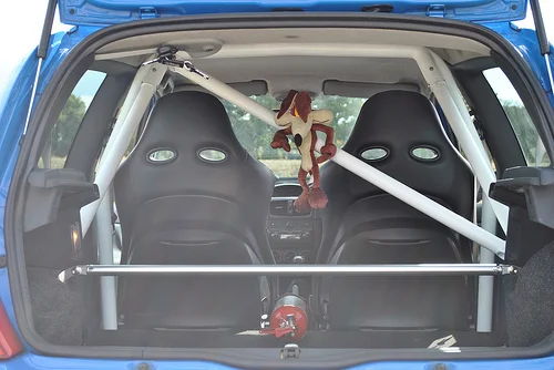

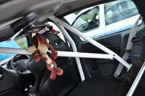

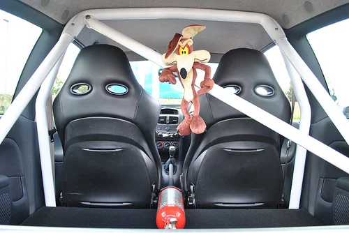

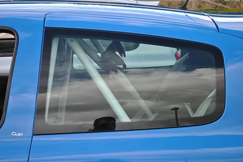

The cage went in yesterday. Started by getting it all in and constructed with the crossbar in, that helped push the hoop apart. Drilled through the floor of the car first, sprayed a bit of paint over the holes then bolted it down. Same with the wheel arches but put the bolts through the arch in to the car so the thread would never puncher the tyres. Put all the false floor in and gave it a good clean. Today gave Fletcher a hand with his car and then went for some pictures.
