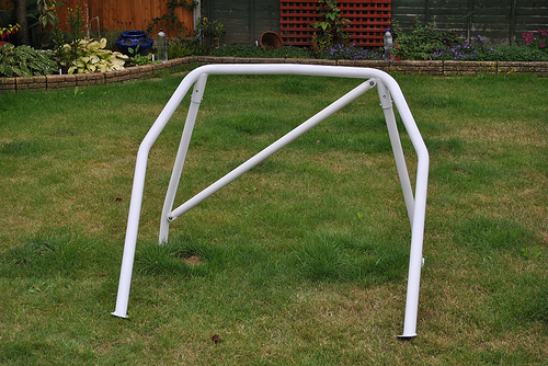

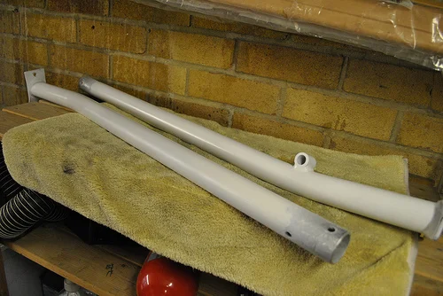

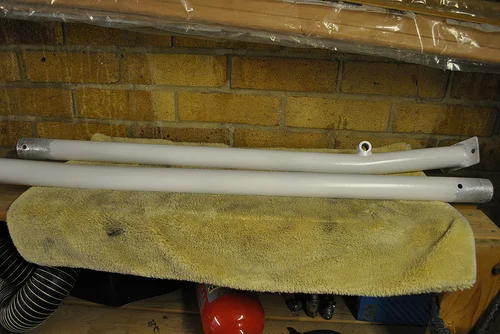

Well its not getting sanded down to the bare metal (apart form the bits its reacting on) but its close, the legs came out ok. Il post some pics up later of the finish.
Christopher.
South Central-South Coast

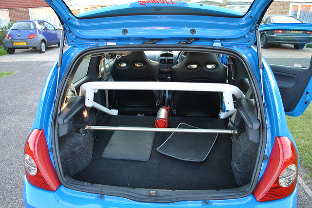

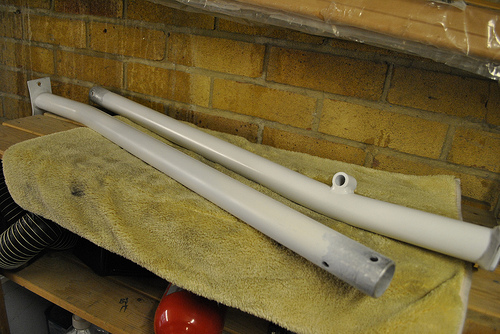

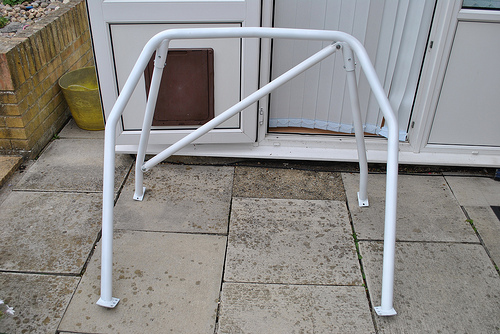

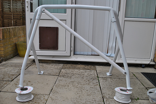

The legs and cross bar are now finished. As said not the best finish in the world but meh. Should have a good amount of the hoop done tomorrow as iv got the day off for an interview for a new job in the morning:S
Legs
Crossbar

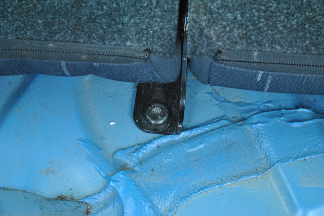

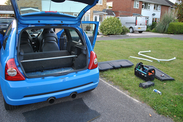

Progress hampered by a bloody T40 bit :mad:. Got most of the rear seats out and all the rest of the gubbins. Also tried getting the hoop in about a thousand different ways and found that once the passenger seat is out it will be going through the drivers door. Should be relatively easy :)
What i was able to get out

Jekyll
why is it that "that" torx bolt is always a right sh!t to take off!!
the brake ducts was ok, but it looks much better with standard fog inserts and no fogs imo. :)
after looking at yours and one i saw over the weekend i think im going to follow suit :)
TimR26
South Central- West Berks
I had trouble with that one, ended up getting Tom at JMS to remove it (no charge as well :)).
He used loads of WD40 and an electric screwdriver, then kept loosening and tightening to get WD40 down to threads, after about 10 minutes it freed up enough to be removed.

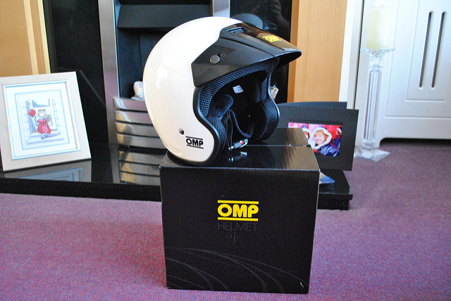

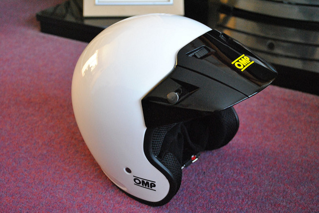

My OMP helmet turned up today. Am very impressed with it and a bargain for £50

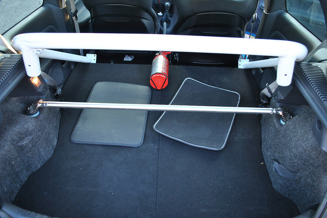

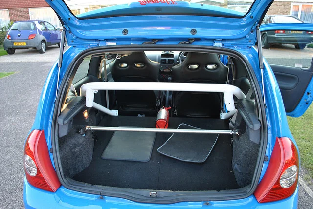

Also with my mate coming round with his T40 bit we got the rest of the bench out. He also found my T40 bit and a wheel bolt rattling around :) As he was there had a crack at getting the hoop in and with a bit of force and moving the seats every which way we got it in :D We also put the false floor in and left it at that. Not to sure on having the fire extinguisher in there if i did have a crash, don't fancy that flying around the cabin ! Maybe i will fix it down a bit better.
