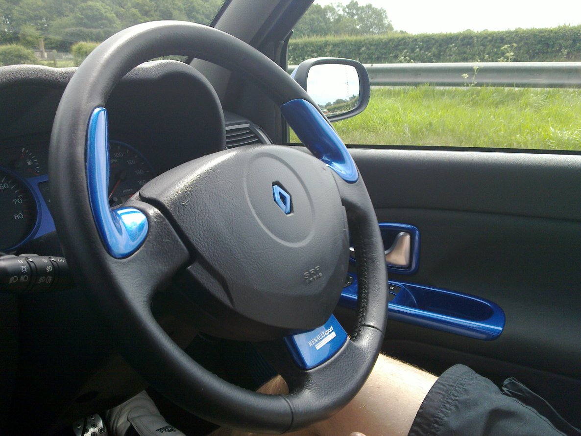

Had a few messages so just a quick update about what I did with the steering wheel
First up I got myself a cheap knackered steering wheel from on here to experiment with. It was melted in the usual way and the thumb grips were dead so I literally pulled these off. I found the fiberglass thumb grips on here also, not sure who made them though. The seller didn't either.
I bought myself some of this stuff http://furnitureclinic.co.uk/Leather_Prep.php to strip the existing leather dye (this is what runs/melts on the wheel), this is really messy so have some gloves and lots of newspaper on standby!
Eventually you will end up with a much smoother looking steering wheel, any areas that are still raised you will need to sand. I probably sanded mine a bit too much and lost the leather effect on the top. Ah well, still looks loads better IMO.
It will currently look pretty naff so we need to dye it, the stuff i used is here http://www.dynamixdyes.com/buy_dyes.php (edit, new link http://www.dynamixdyes.com/car-leather-dyes-99-c.asp) , 65ml is plenty (edit, they now do 30ml which will be enough easily), still have a load left from mine, I gave it three coats which is probably excessive.
They don't do the exact colour though so take your pick, i had Porsche black but there are lots of grey coloured ones too.
Am pleased to report it's still in the same condition it was there too (it hasn't re-melted)

I'm such a sheep with a 197 wheel in my 182, 99% of 182s have them fitted iirc.
Medal on it's way.... :S
On a serious note you do realise they are of the same construction and will also melt don't you? (PS, that's rhetorical, please don't reply) At least I have contributed something to this thread instead of meaningless negativity, if you don't have anything constructive to contribute may I suggest you troll elsewhere as there are some people reading this thread who may actually be interested in a solution to a common issue. 99% of people can see that iirc (ironically enough the same percentage of statistics are made up, go figure!). The fact I chose to paint parts on my OWN car is somewhat irrelevant in any case, that wasn't even the question the OP asked...
