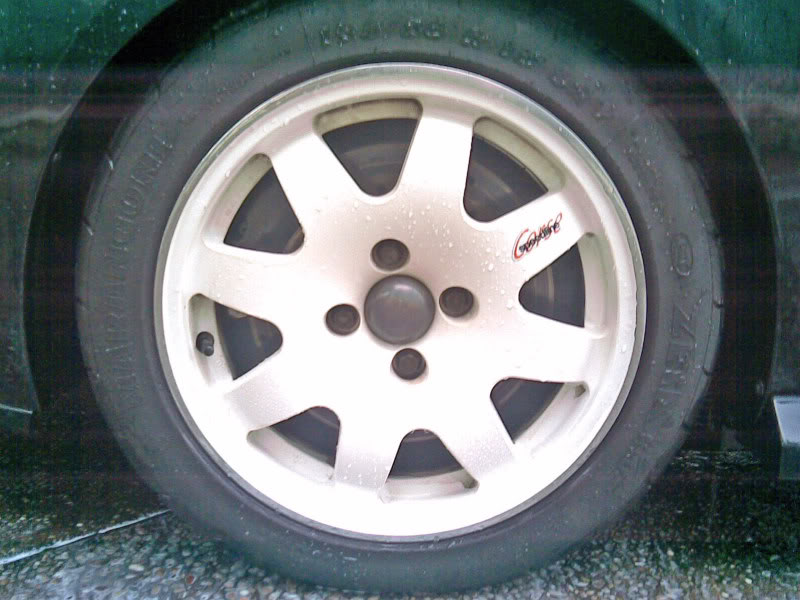

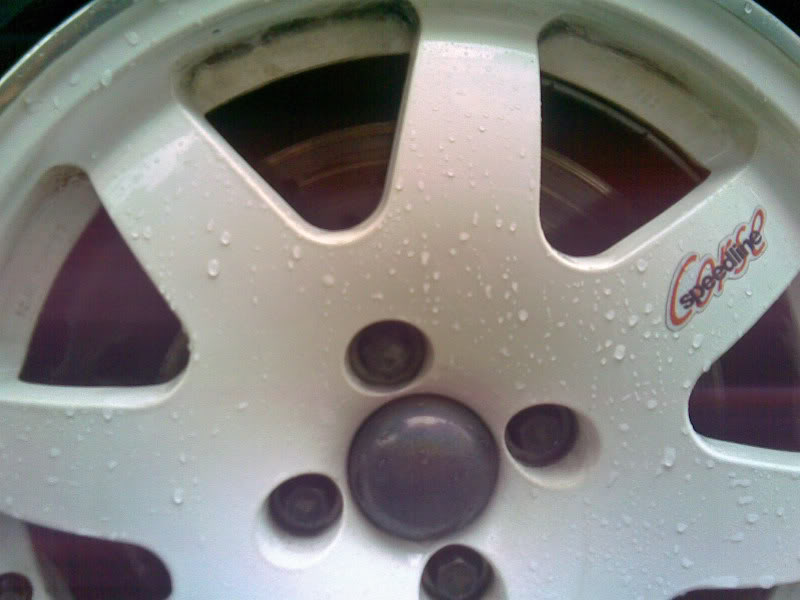

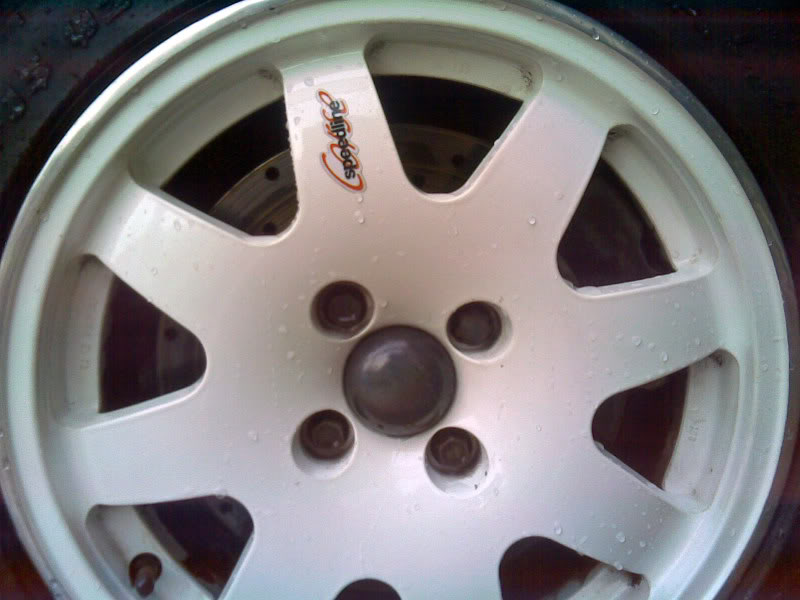

Big thanks to edde, he thoroughly deserved his 20 stella :D Not very good pics as they're a bit dark, but tried my best. Bought the k tec 285mm big brake conversion brackets and discs off edde and then went for some ferodo pads. Still not 100% fiished as the caliper fouls the wheel weight used to balance the wheel (edde, told you so ;)) but defo an improvement on standard so well worth the money, especially at eddes bargain basement prices! lick of paint going on in the next week or so (gloss black) so should look nice and new then. discs look rusty cos they've just been washed at the jet wash lol

Have you managed to clean the disks up yet?

stop your compaining youth :rolleyes: that stella cost money you know! Discs havent cleaned up yet, as you can from the pics but not really hammered em yet due to my balancing etc. all is good so far though, preparing her for the track :approve:

thanks giles :) need to get a better pick really with a flash cant see shag all on that pic

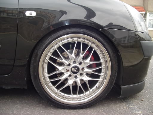

^ dont think they'll fit behind your rims matey. I know winston had to put smaller discs on his valver to fit on his 13's

glad to see your not thinking about getting bigger wheels, the R5 ones look minty mint :approve:

cheers, there gettin wrapped in some new yoko's this week... along with a refurb!!!!!!
oh, and 20mm spacers.. euro.. ever so slightly :)
