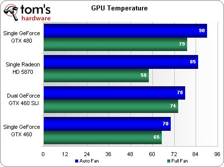

I would SLi two 460s...
Yep - if you have the budget and want instant power/performance gratification then the SLI'd 460's are *currently* where it's at (unless you are talking silly money and uber-HPC rigs). However, the 480GTX or HD5970 offer a little more in terms of future-proofing and future performance scaling.

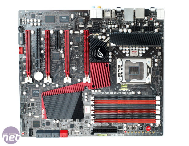

Rampage III Extreme or you're gay.
lol, I know, the board I've specified so far is too cheap with not enough features. At the moment I'm waiting for the new 6000 series GPUs to come out then I'll spec a better M/Board and buy all the kit.

If I'm spending £2000+ on a system i'm going to spend more than £150 on the M/Board though.
