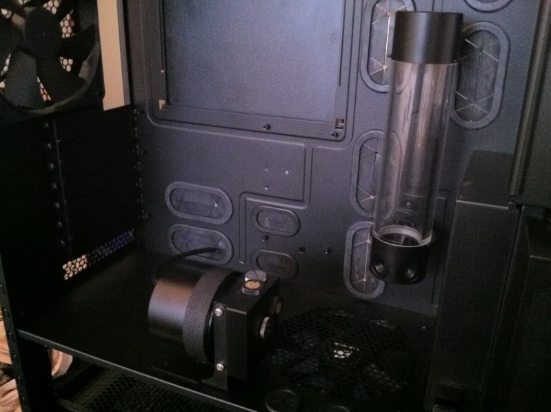

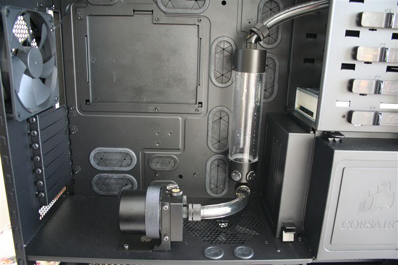

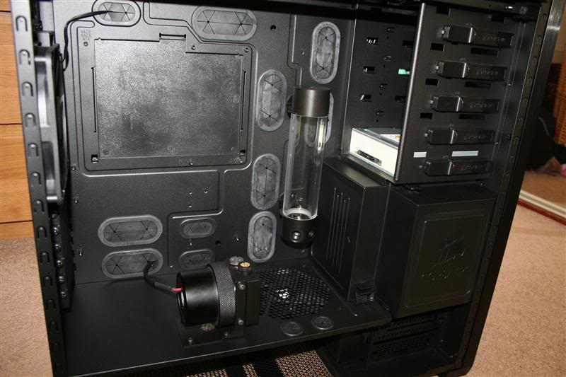

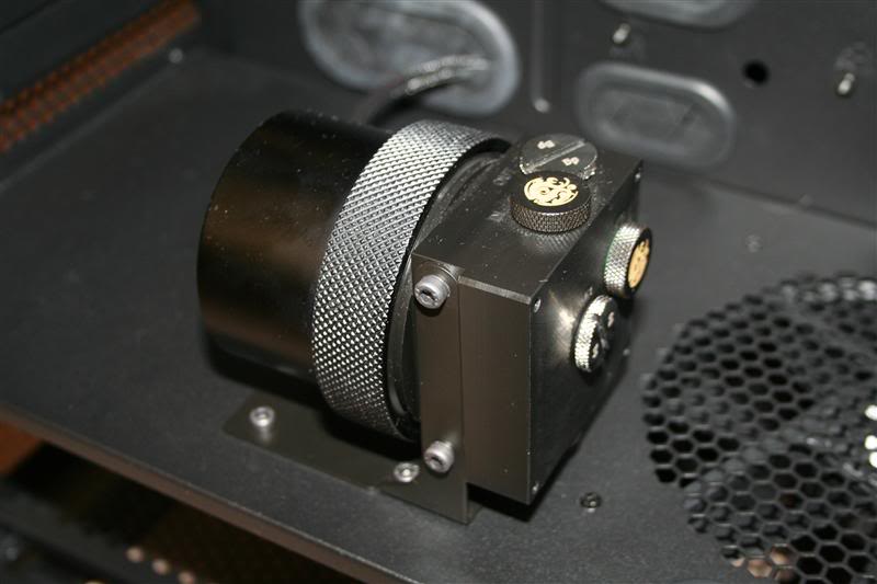

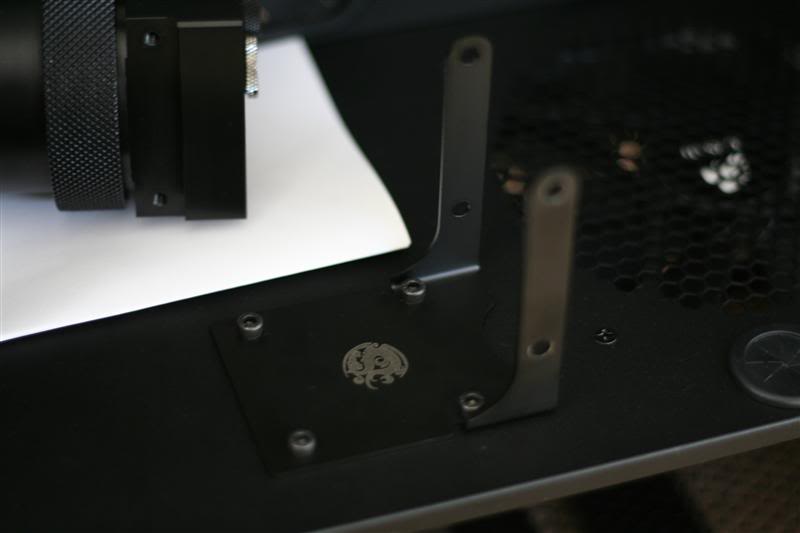

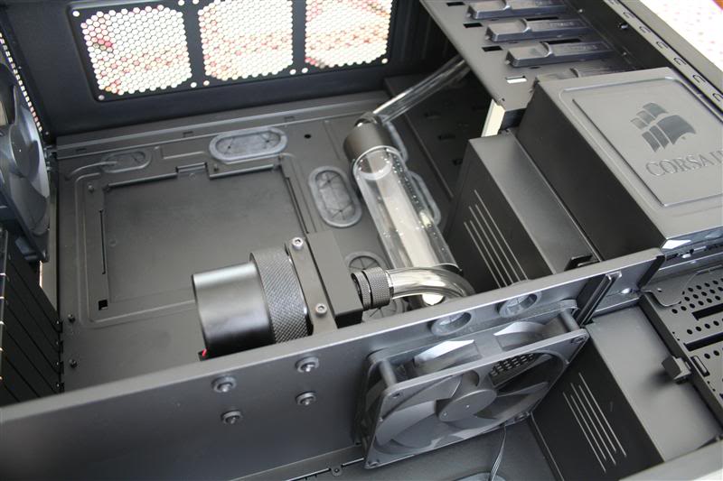

more progress on the new build tonight, I'll try and take some better pictures over the weekend. But I've drilled the fittings for the reservoir and test fitted the radiator and pump:

Another small update.

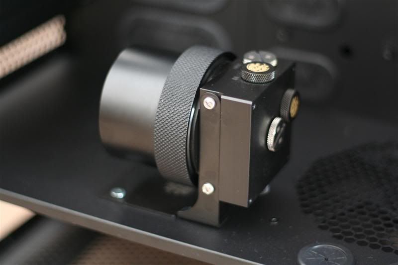

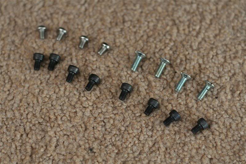

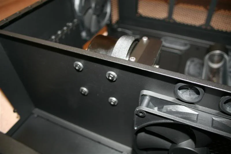

The mission was simple, to replace all the screws that were silver for black items. One problem was the M4 nuts (on the pump base & reservoir clamps), as it seems to be impossible to buy them from anywhere in black so I ended up spraying them myself, pretty pleased with the results:
Ignore the silver Bitspower stops on the pump, they are just there temporarily!

Yeah I was going for the 6990 but have realised I'm probably not going to fit one in due to the reservoir! So will have to opt for something else. I presume the 580 will be a lot smaller? It's either that route or 2 x 6890s etc
  Evo 5 RS
There are no official dimensions mate, it's all NDA too so nobody will give me an official launch date. 'Legally bound' n all that. Wet farts..
It does look a lot shorter than AMDS 6890. 470GTX ish

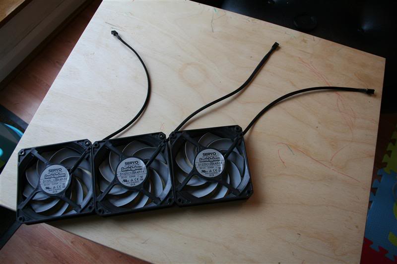

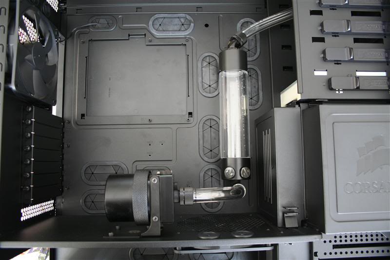

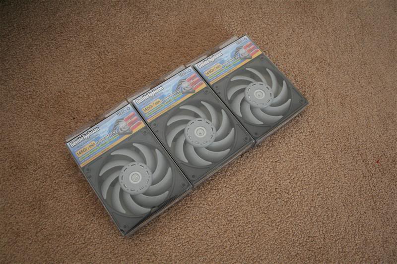

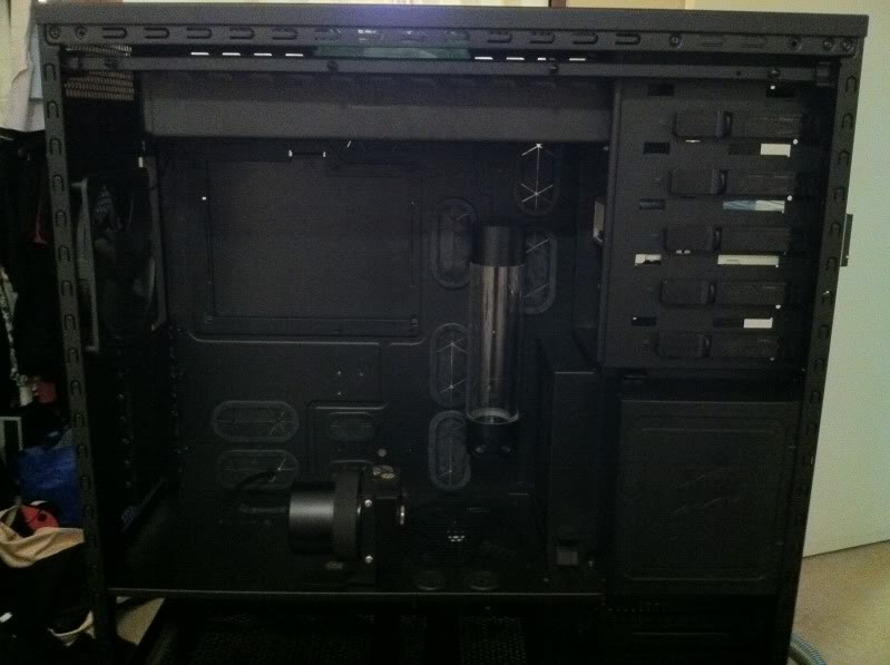

Another update, I've now fitted the first parts of the tubing (fillport > reservoir & reservoir > pump) I've also finally bought all the fittings required and the Gentle Typhoon 120mm fans (1450rpm) for the radiator, these need to be sleeved and possibly sprayed before being fitted though.

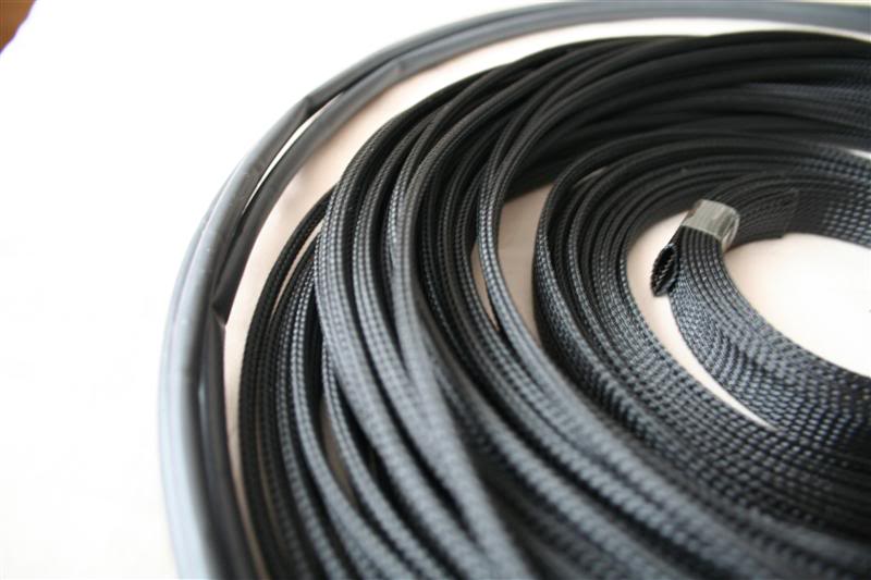

I've also ordered pretty much everything from MDPC-X ( http://en.mdpc-x.com/ ) which I should hopefully receive soon and then I'll be busy sleeving all the cables up.

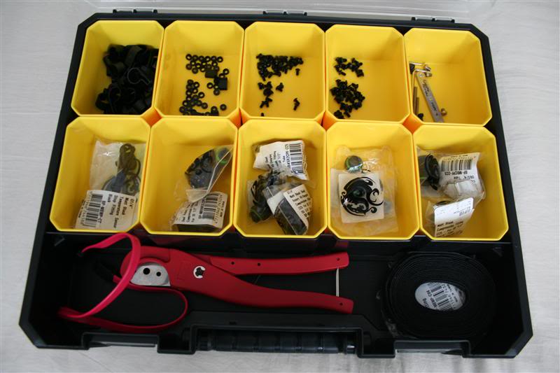

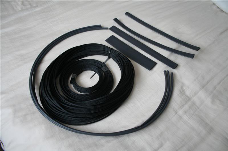

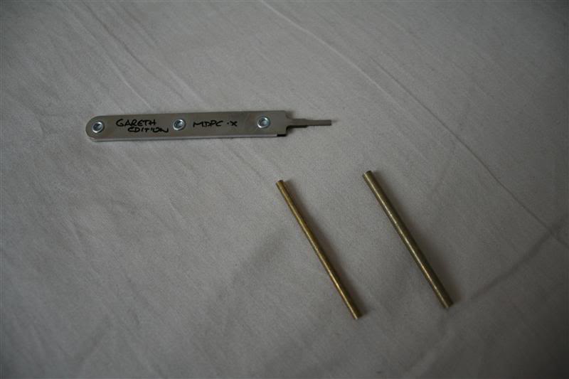

Another delivery, this time from a well respected PC Builder/Modder from Germany.
MDPC-X
MDPC-X Tools
PC Building Tool Kit (Bitspower fittings, various black screws, washers, fan connectors & cable clips
Sleeving & Shrink
Sleeving
Got a lot of work to do now! ;)

Just one question. Have you had the motherboard in with the res?, also will the GPU fit ok?
  Turbo'd MX-5 MK4
No not yet ( none of the components have been bought yet, I'm waiting to see what happens with Sandy Bridge and the CORE i7 CPUs ), but the motherboard will definitely clear the reservoir. The original plan was to go for an ATI 6990 but I'm pretty sure unless they are shorter than the 5970 series it won't fit, but by the looks of it the EVGA 580 GTX looks very good and is 10.5" long, so the plan is to get the water-cooled version ( comes out towards the end of the month ) how much room do I have? 11"s LOL!!

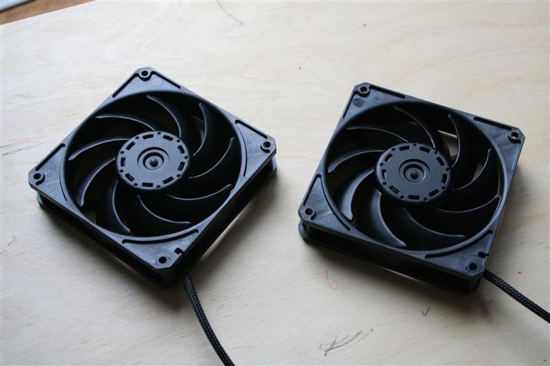

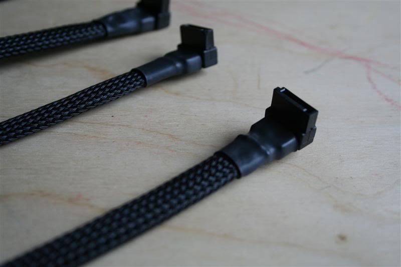

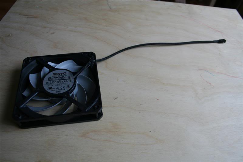

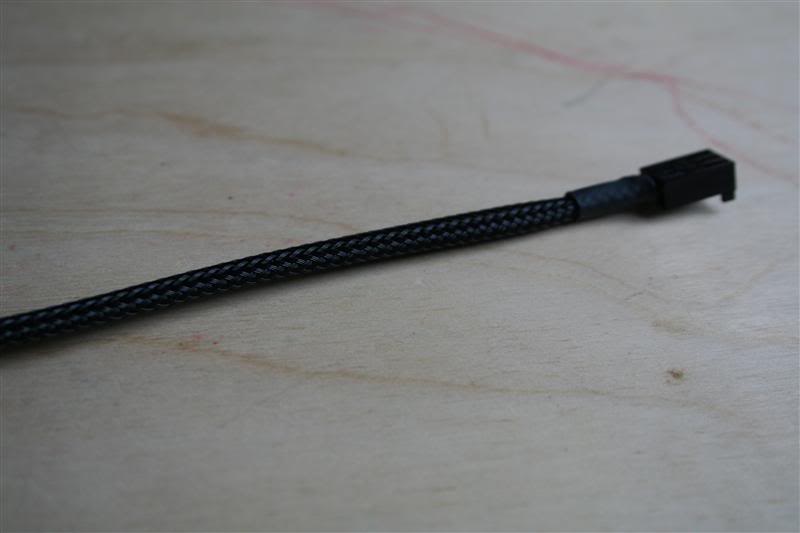

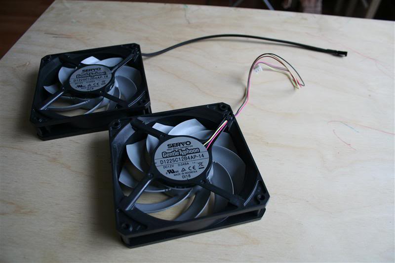

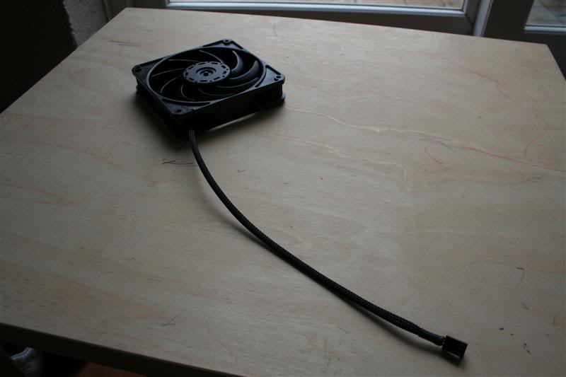

Another Update, the results from the sleeving I've managed to get done this weekend, made good progress considering I've never done it before and thankfully didn't make too many mistakes.
Fans Before & After :
I've also done 2 out of 3 of the standard Corsair fans but have no pics of them.

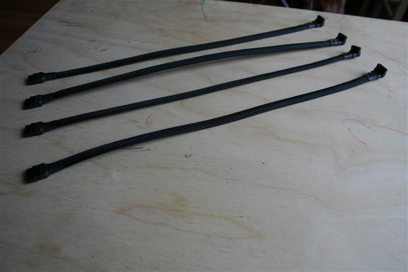

SATA cables:
I've still got 2 more of these to do.

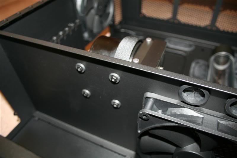

In addition to this I've also fitted the fans and radiator into the case, but due to lack of daylight don't have any pics of that so far.

  Monaro VXR
You might get better temps with them exhausting air out. As pulling in means you only have 1 exhaust at the rear of the case. Also got the heat rises thing.
Have to try it out when it is all running.
  Tesla MP3 2021
Yeah thats what I thought as it will be pulling hot air from inside the case through the rad. The ideal setup would be push>rad>pull, but you need to room to have that many fans involved, thats why mines on the outside of the case.
It may be better turning the fans round and putting them inside the case so that they are pushing cold air into the rad.
  Turbo'd MX-5 MK4
Ok yeah, appears I've been given duff advice:
I'll re-think this, but I'll either fit more fans underneath or just fit them underneath going up into the radiator.

Yeah so you would have been coming out with the hotest water temps, as I say, and the graph agrees, the best results would be a push>pull setup, with shrouds helping even further.
  Turbo'd MX-5 MK4
For the time being I'm going to spray the fans matt black and go with them underneath, I may later on add more fans to the top to pull but will see.

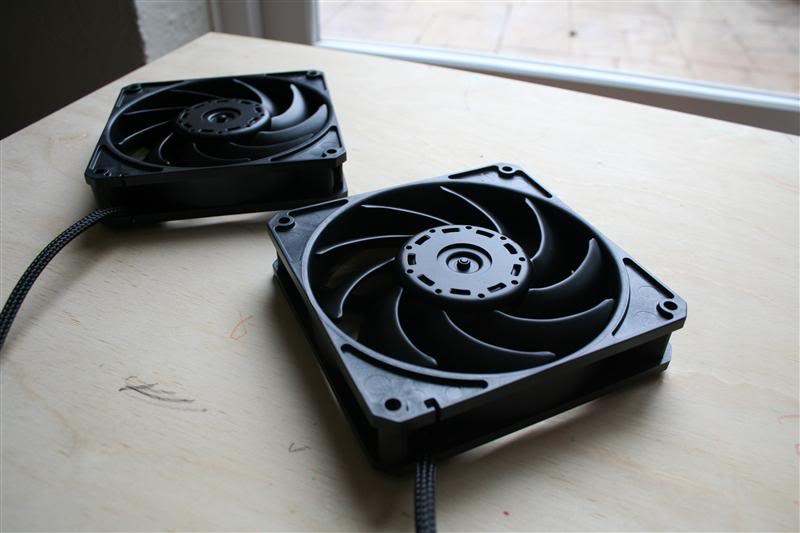

I've finished spraying them matt black, one of them is already fitted (don't have time now to take pics) but here they are painted:
They look 100% better IMHO
