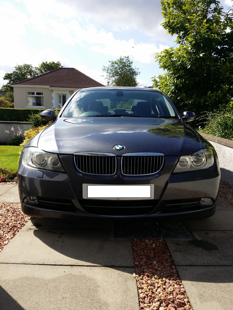

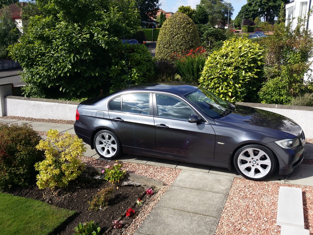

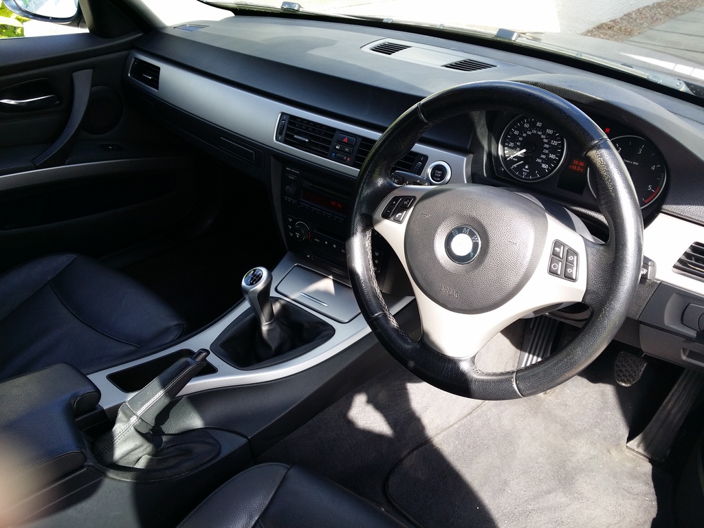

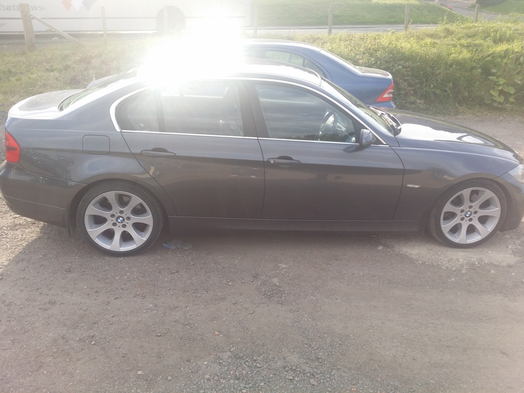

New car thread (With Pictures)

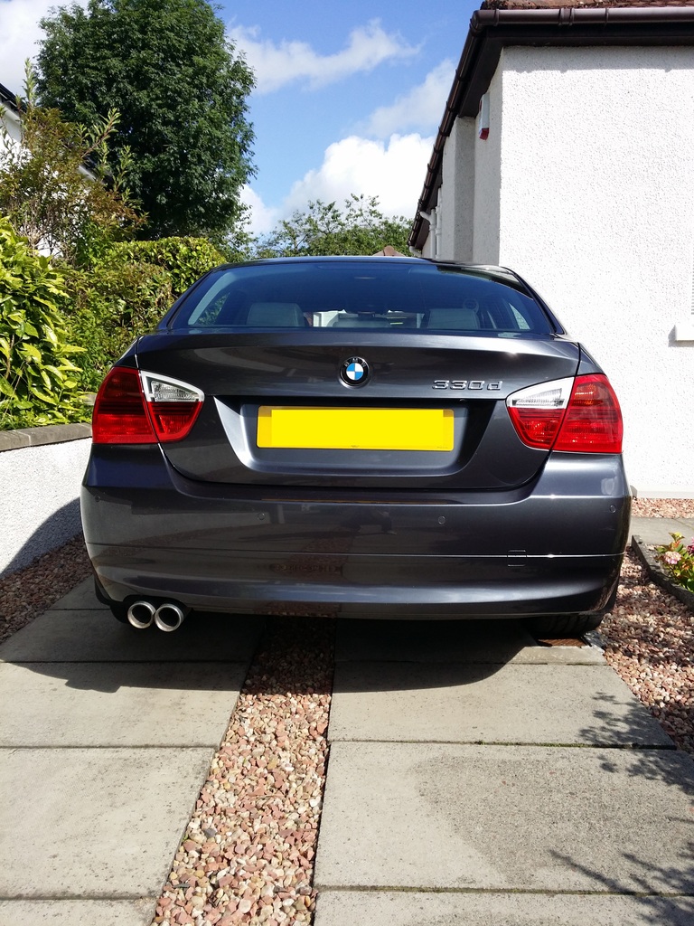

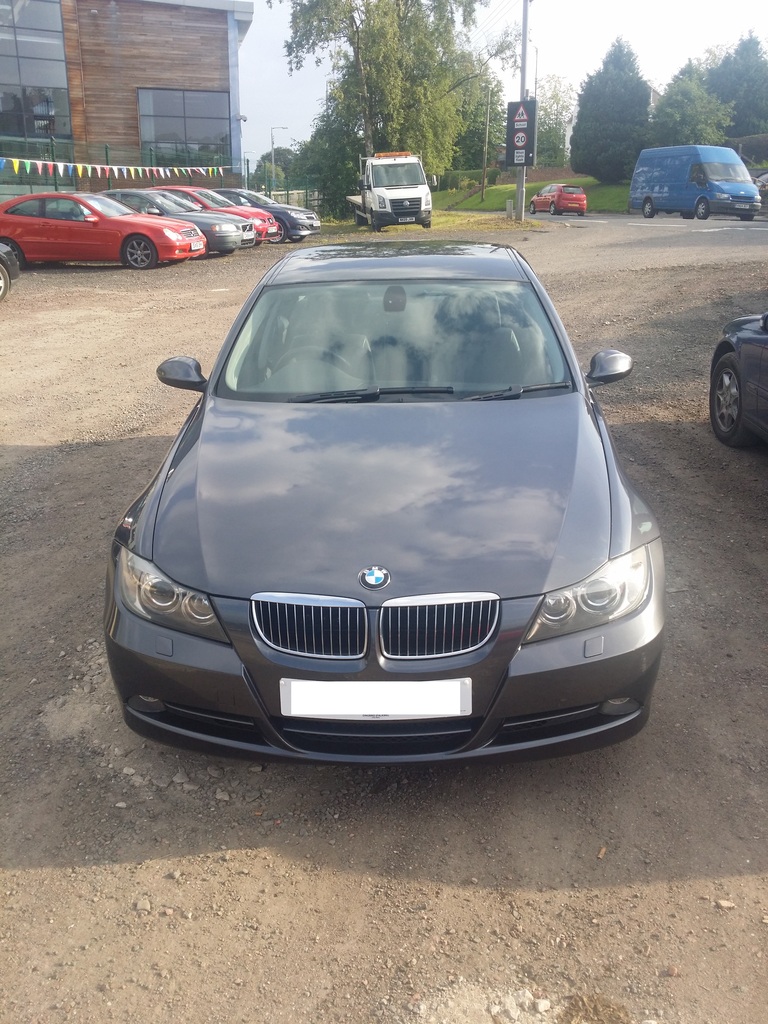

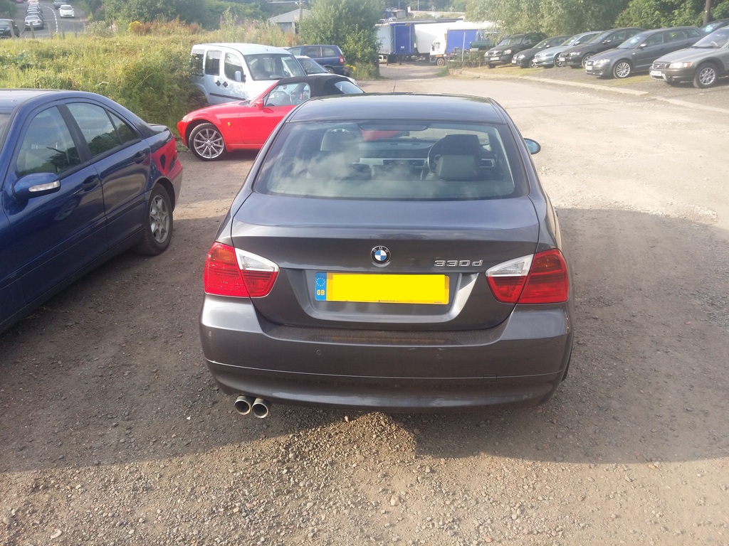

I managed to sell my Mazda 2 Privately for way more than I was being offered in trade in so I thought I would buy this to replace it...
Its a 2006 BMW e90 330d se with 96k miles on it.
On the advert it said it had 90k on it but I turned up at the independent dealership to find it had another 6k (which the dealer said was a typo....):confused:
Anyway, its fully HPI clear, full bmw service history and he agreed to put 6 months tax on it.
It also came with a 3 month Bronze Warranty Wise warranty on it but I managed to get him to put a 1 year Gold warranty on it as well...
Anyway I quite like the colour and the spec of the car,
It comes with xenons, cruise control, front and rear parking sensors, heated leather seats, extended lighting package, bluetooth etc.. No idrive but i wasn't too bothered as the older idrive isn't great...
It also came with the 18" wheels which I think look good. In addition the guy put on a full new set of Bridgestone run flats all round and gave the car a full service.
The car is generally very clean, no dents and a couple of tiny scratches on the outside but he said he would polish them out before I picked it up.
I also noticed that the airbag and seatbelt warning lights were on but he said he would sort that out too...
Anyway here are some pictures..
Opinions welcome!

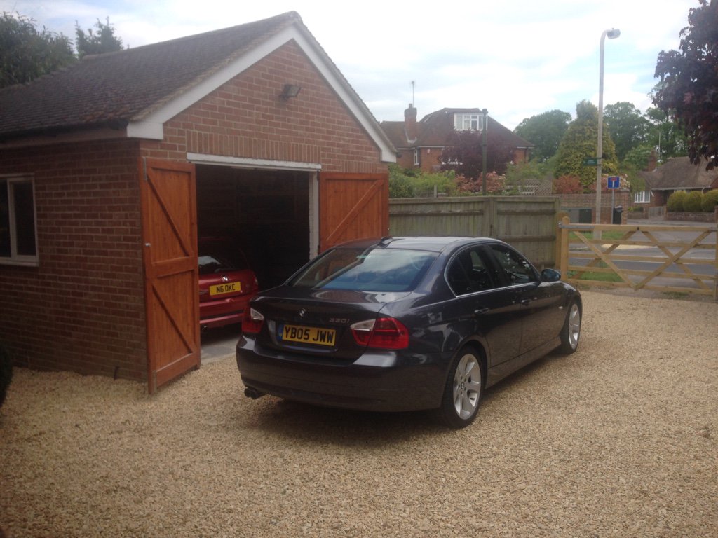

Spec is virtually identical to yours, but has the idrive unit with sat nav. Mine doesn't have heated seats though.
I'd have preferred the derv but I got offered this petrol one for crazy money, so I snapped it up.
It's done 111k now and I absolutely love it. Does everything I need it to with refinement and comfort and it goes pretty well too.
Gearbox - mine is fine 2nd to 3rd, but the gearbox is very precise and notchy, as on all BM's. Good buy! :)

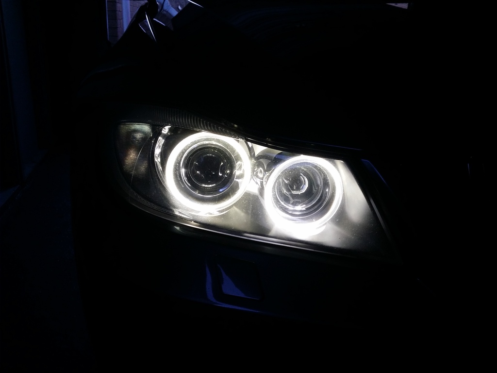

Just bought some led angel eyes to freshen up the front end.

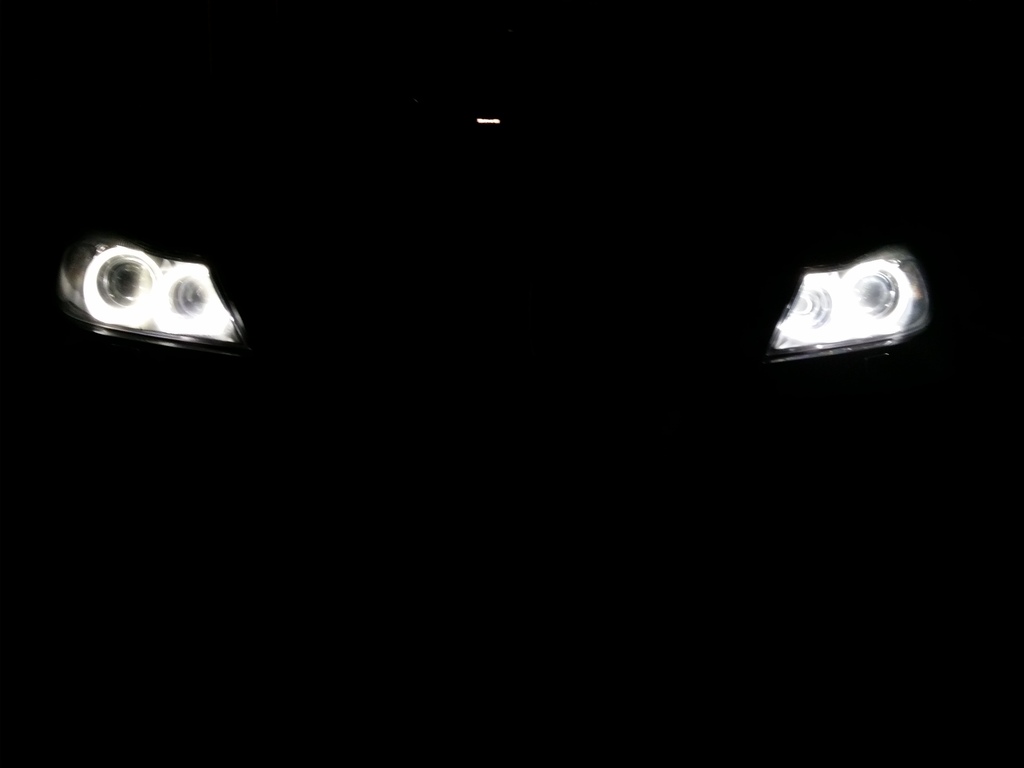

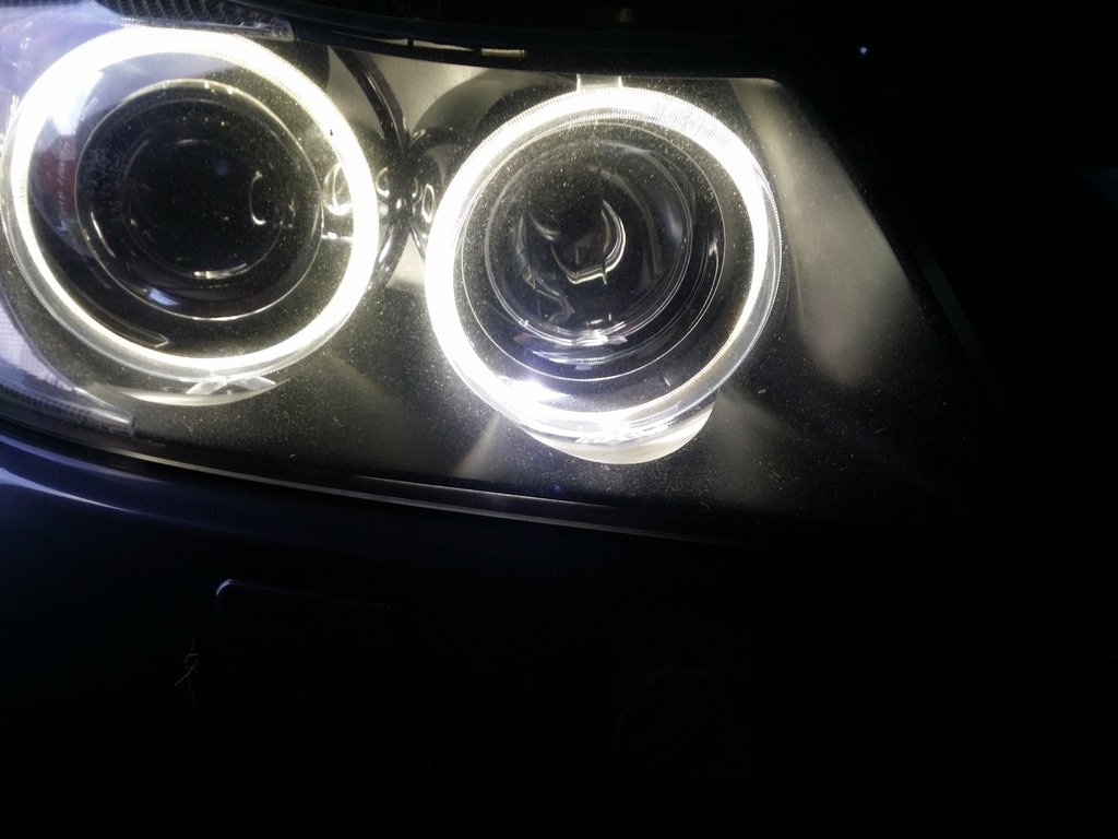

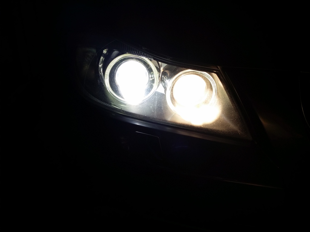

Received new angel eye bulbs after waiting nearly a week for them. (Supposed to be next day delivery) Didn't come with instructions but it did come with all the tools needed to remove the arch liners and the bulbs.
Didn't start very well when I took them out of the box. Found that the bulbs were too wide for the plastic covers!
So I had to hacksaw the ends off as they were obviously for another model of bmw... (Not impressed) (£40 for two of them...)
Took about 30 mins per side to remove liners, old bulb and put new one in and put it all back together.
Its definitely made a difference from the yellow angel eyes to a bright white to match the xenons inside the rings.
However i've noticed that one of them is whiter than the other which is either down to the fact that I found that one of the headlights has been replaced recently and the other hasn't, or there is a difference in colour between the bulbs. (I may swap them over to rule this out).
Anyway here are the pics. Comments welcome!

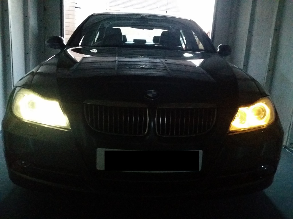

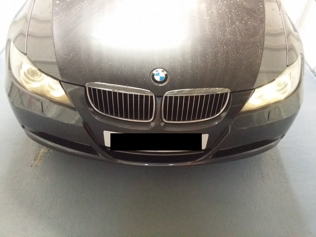

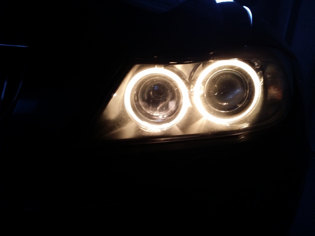

Halogens before

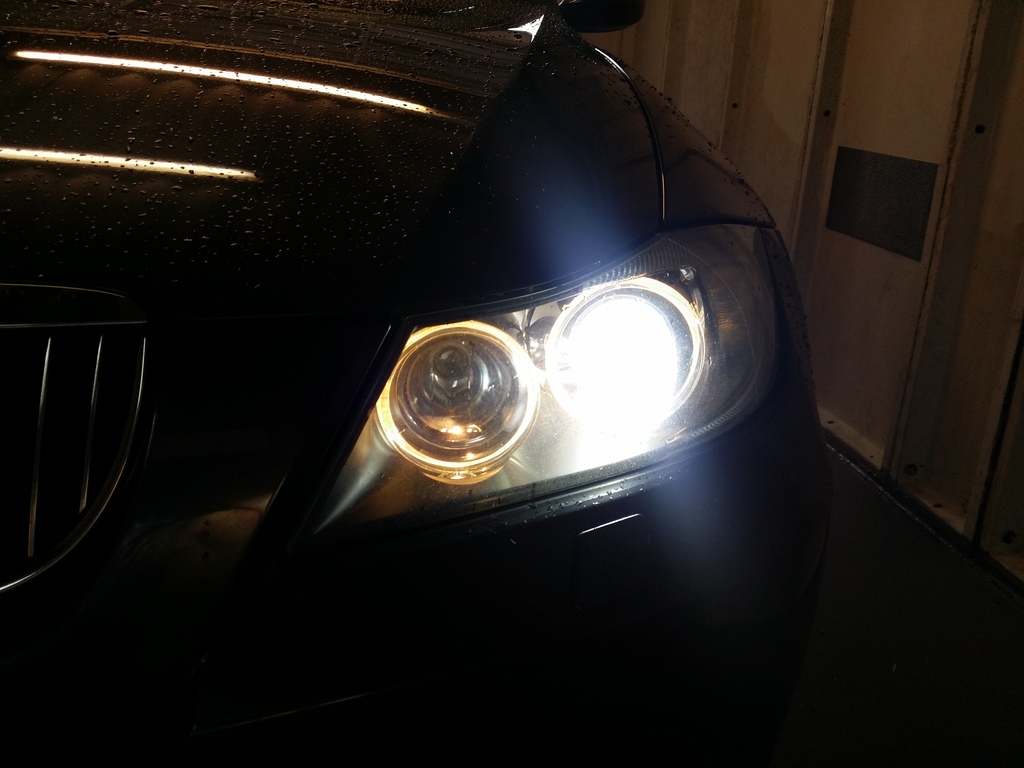

Halogen ring with xenon on
Std Halogen rings
Led fitted
Before and after
Led fitted
Leds with xenon and full beam (still halogen)
Both lights upgraded (May be able to see that left light isnt as bright...)

If you look at where the bulb goes you'll see the 2 cut off ends of the rings facing you, the LED shines into these edges and the light travels through the rings.
The edges have a little ledge on them that sit into a grove on the inner headlight, it's very easy to knock them and cause them to sit further into the headlight and therefore further away from the LED, causing that one to be a lot dimmer.
Had same on my 335d, it was doing my head in till i realised!
They are sending out a proper set to fit my car. Thanks for the advice I'll recheck how they are mounted when I get them in.
No bother.
Put two fingers in and nip the ends they'll probably wiggle a bit, if you gently pull them towards you and down you'll feel them locate.

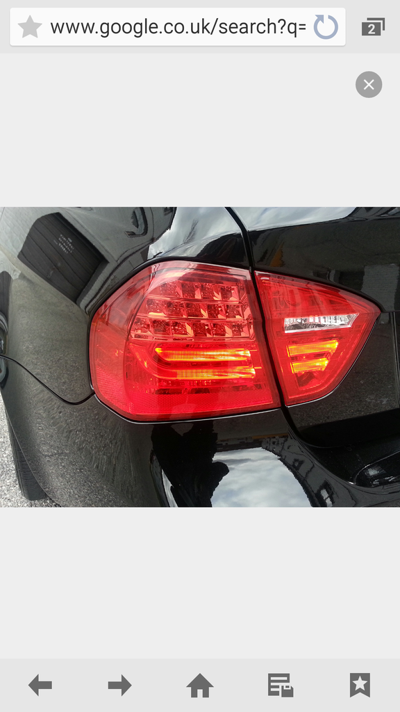

I've bought a private plate to hide the age of the car and I've also ordered these which I like and they modernise the rear end of the car to make it look like the lci facelift... (Only 150 quid for them too...)

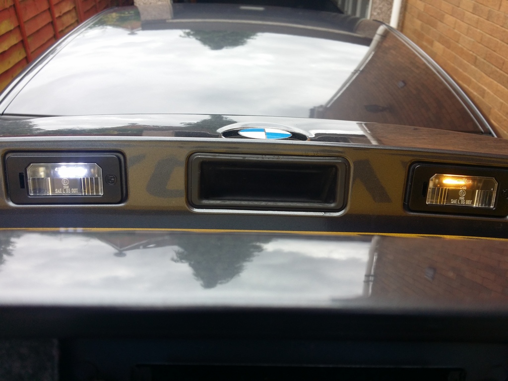

Also ordered led numberplate bulbs to replace the old yellow halogens. Not bad for £2!

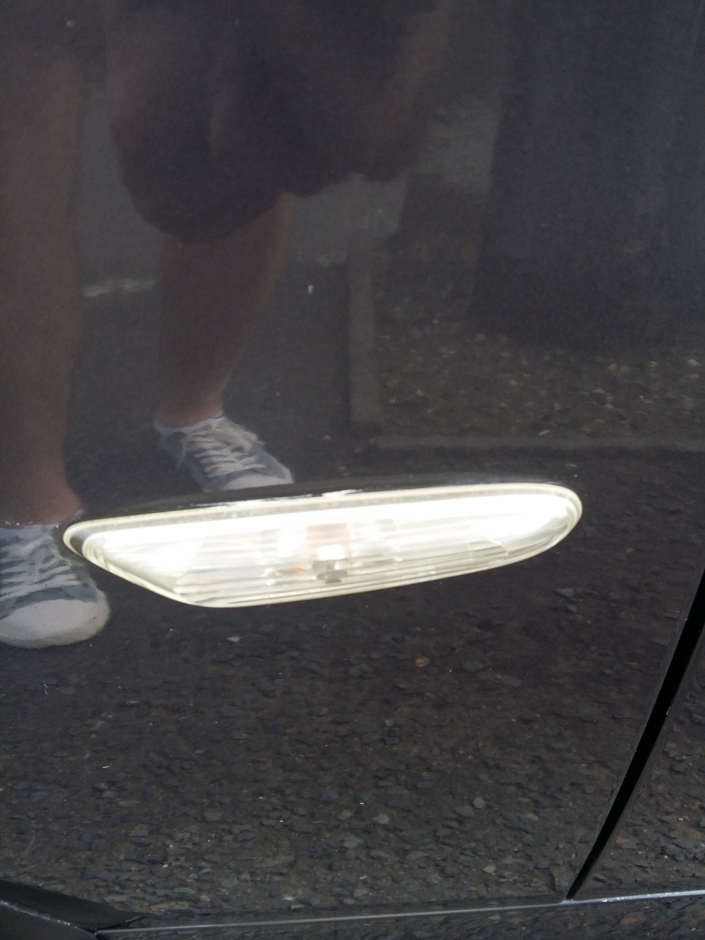

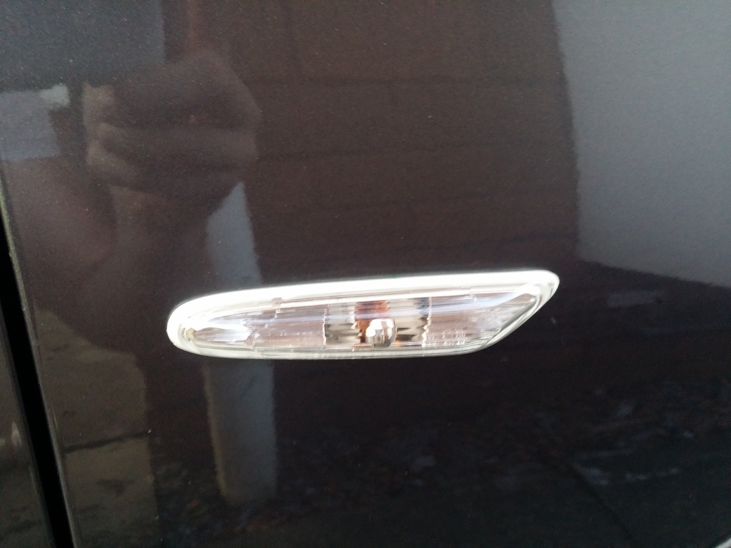

Bought a set of replacement side indicator covers as the originals were brittle and yellow..
Before
After

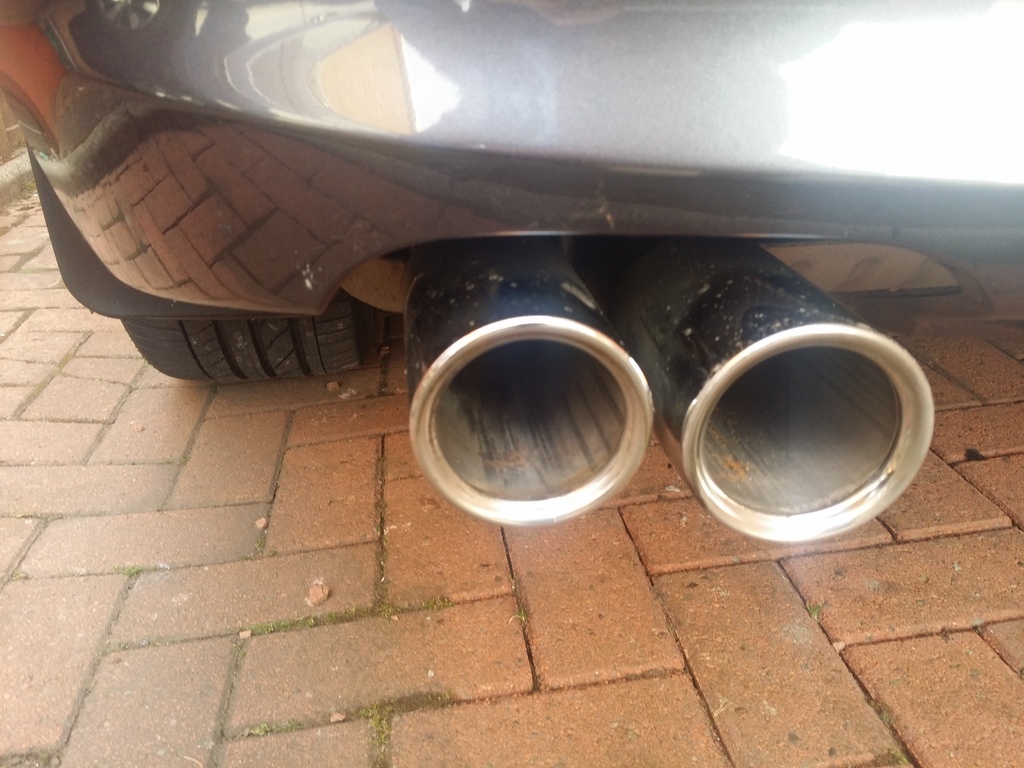

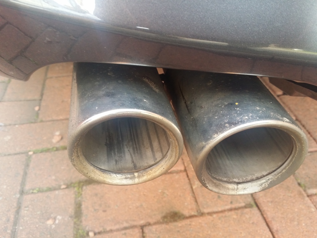

And finally I gave my pipes a quick polish as they were annoying me...
I'll spend some proper time on them at the weekend..
Before
After

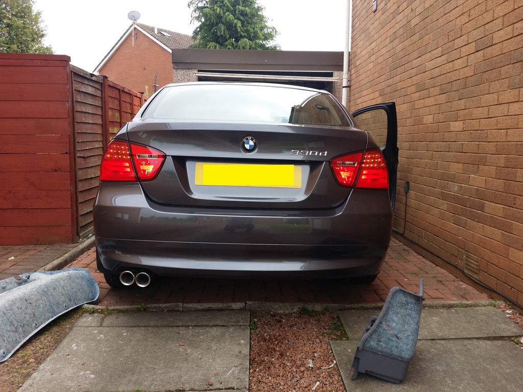

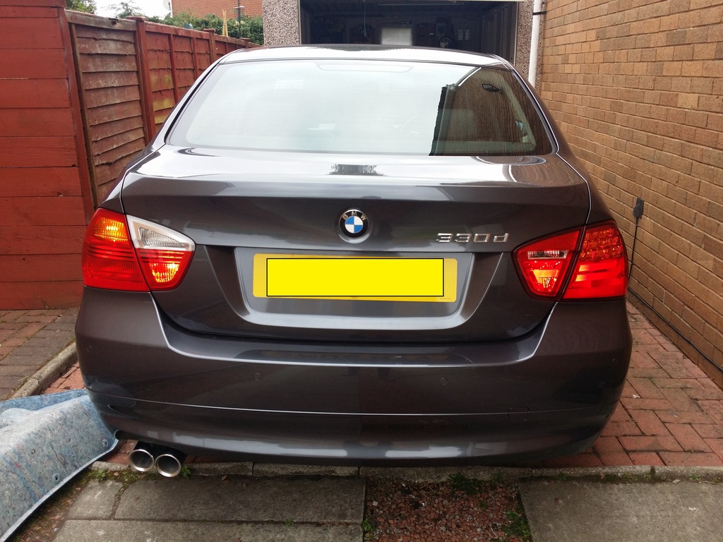

Managed to fit the new rear lights this afternoon which only took about 30 mins!
They are the same style of the lci facelift lights although the bootlid lights are a slightly different shape.
Quite impressed with them for the price I paid and I think it really freshens up the back of the car...
Before
Half done
Finished!
Just need to put the private plate on now!
Comments welcome!!

Thanks mate I'm quite impressed with the rear lights for only 150 quid. One of the angel eye leds isnt as bright but I've been sent out a replacement set.
