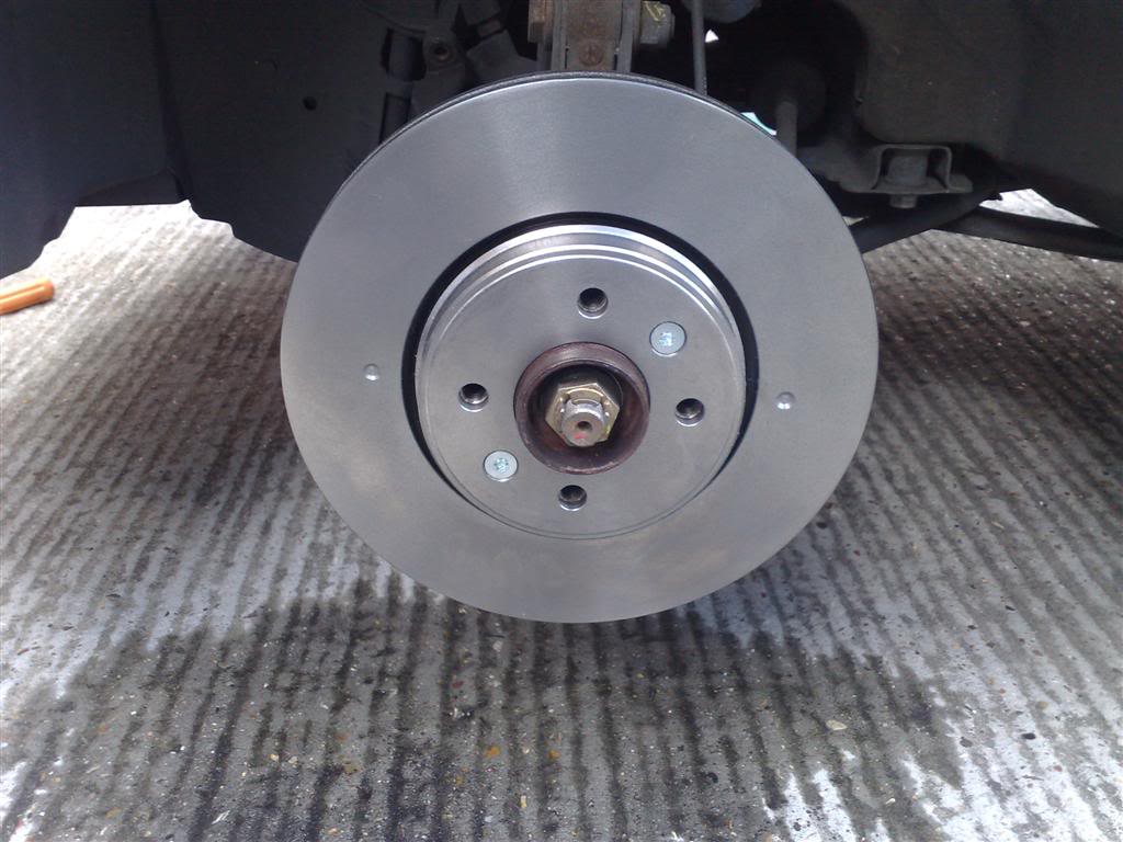

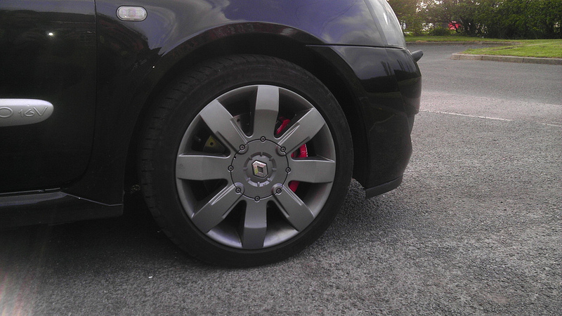

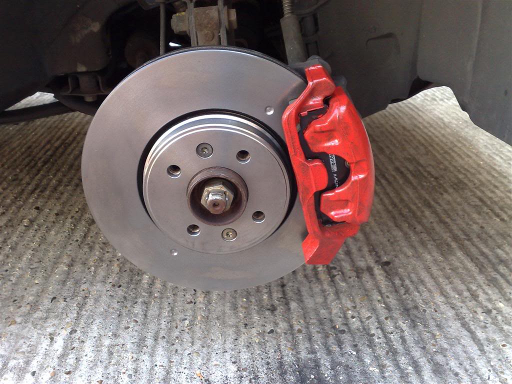

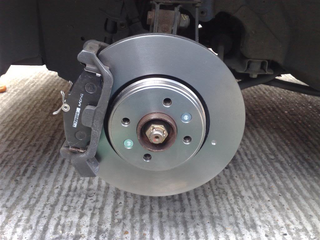

New disks, pads and painted calipers on the 182
Andy_con
  clio 182
all went very well, except the shitty Ferodo DS pads which didnt fit properly and i have to get the bench grinder out to file the edges to get them to fit.
there was a good 1-1.5mm needed to be removed, not impressed.
also painted the calipers whilst i was there

Yep, I made your mistake previously with Pagid Blues. Fitted DS2500 a few weeks back and without the squeal plates they slot in with no fuss.

Iv found most Ferodo pads need grinded off we get a few sets tht fit fine but thats only when were lucky lol.
Looks much better now
  ibiza cupra
very nice mate. thinking of doing this to m9ne but mot sure if the red will go with the black car and white wheels. might haveto get a photoshop on the go

indeed, they could really do with a thrd coat but ran out of time as the rain come.

I took out my shims and needed to file down the edges of the backing plates too when fitting my DS2500's - good combo though :)
