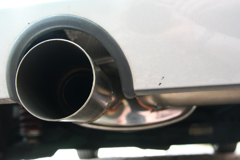

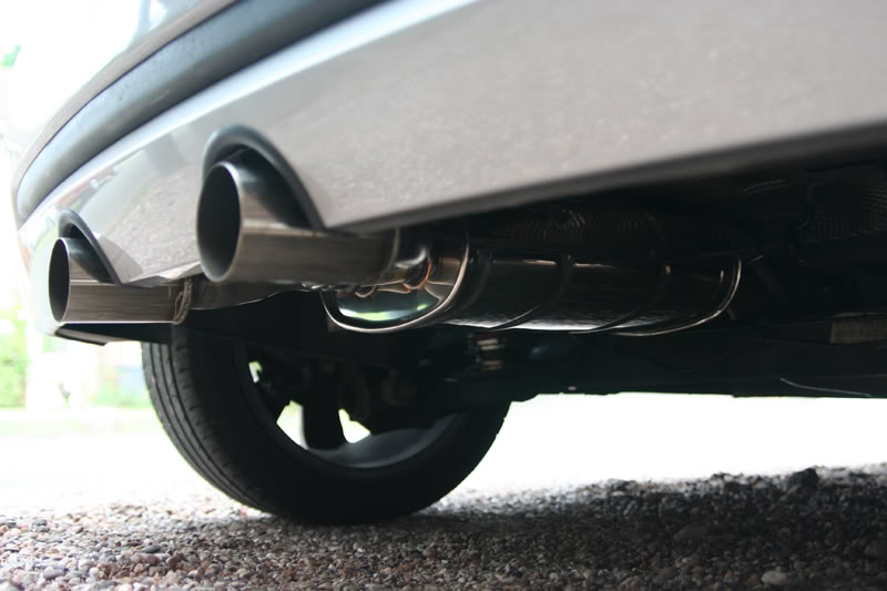

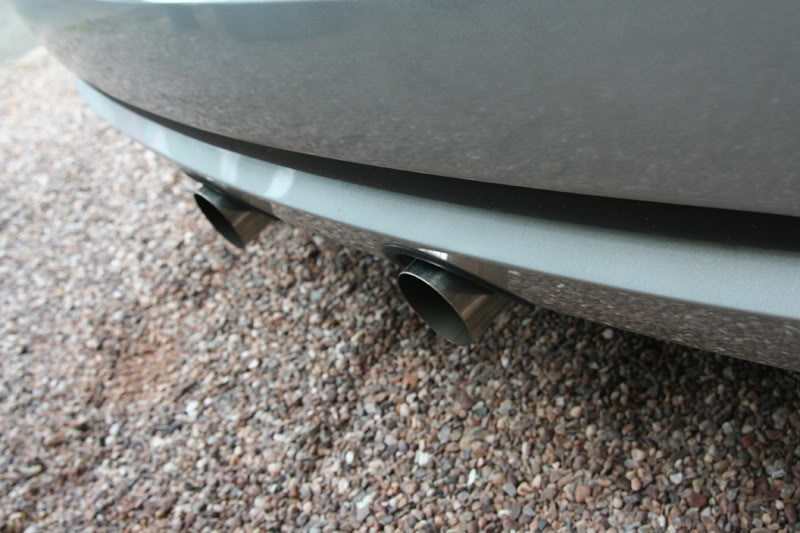

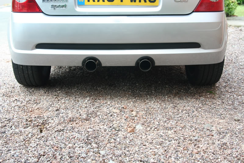

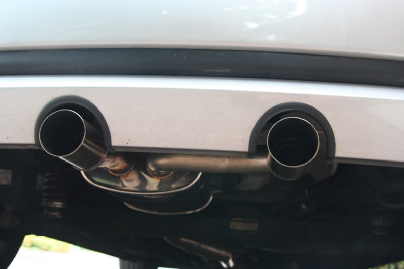

This is my 3rd custom exhaust :eek: and the best one so far :)
I was going to wait and get an AWT but couldnt justify the cost really so got a custom one done based on the Orbisoud, at a fraction of the price. Not 100% how I wanted it, I would have preferred the silencer centralised but the brackets dont allow it. You cant see the silencer so its not to bad.
It is 2.5" into the silencer then twin 2" out and 3" tail pipes. If anything it is a bit quiet but sounds nice and deep. None of the boomy sound you get with the twin backbox system either.

nice one mark, looks a bit more balanced on the eye from the rear view compared to the single exit one you had :)
  Lux'd Glacier White R26
Much better Mark.. That certainly is a fraction of the cost of the orbisoud one!! Looks great. You had it on the rollers?
Tyson.
Its nice to get the twin tailpipes back the single exit did look s**t.

I like the way marks/orbisound's is set tbh. One silencer so none of the boom or other issues you get with the y section. Plus the way the pipework enters and exits means there are no nasty sharp bends like alot of the other single silencer systems.
