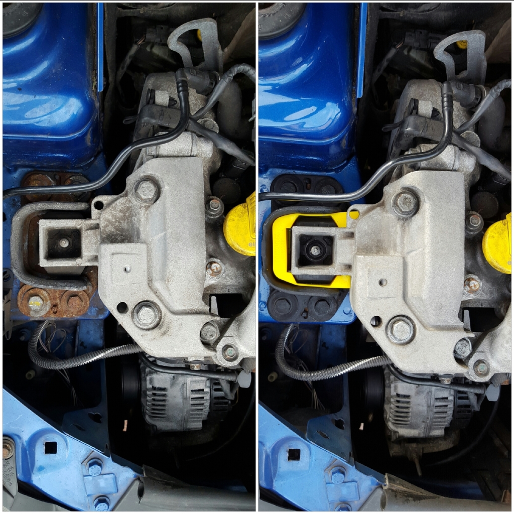

Got mine fitted too......and, well......I don't know if I did it wrong, but Christ the night.....my car is like a dildo now......lol.
Srs vibrations. I expected a bit but holy god :|
Everyone else like that?

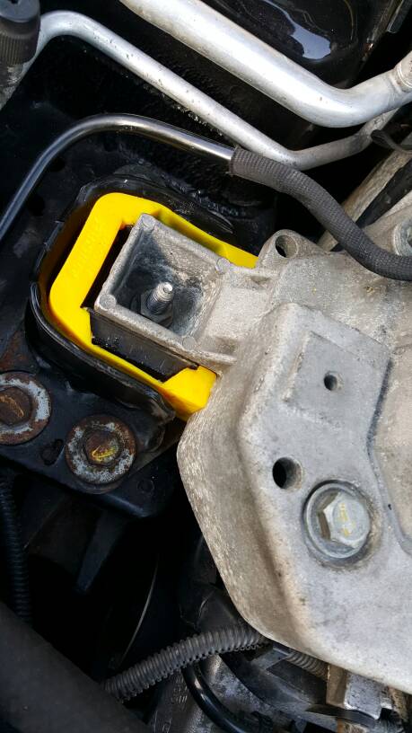

On another note......when removing one of the 3 engine mount bolts (the top ones) one of them was just spinning :(
This courtesy of the dealership that did the timing belt nearly 5 years ago now so I have absolutely no come back. In the pics above, its the lower left bolt. I managed to get it out slowly with a flat spanner underneath and it is nipped hand tight with a small spanner, but I guess my question is....what are my options?

Yeah so I fitted this today. Just can't feel f**king any difference whatsoever basically haha! Don't get these vibrations or anything lol. Already does vibrate a bit with the polybushed dogbone so I suppose could be that!
