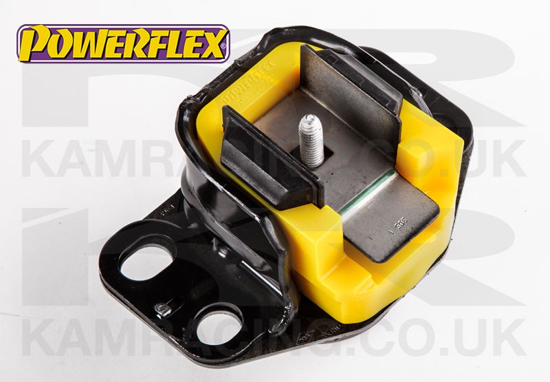

I'm stuck between keeping the stock engine mount bushes (upper OSF and dogbone) and putting the poly bush inserts in.
Fortunately, the mounts in the car are already in good condition...
Just need more opinions and people's experience with having installed.

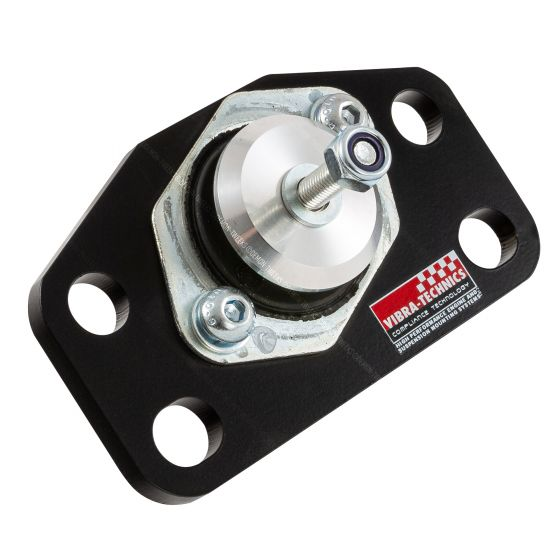

Gotcha. Well mines already had the polybushes done on the exhaust, the big boys at the back and the smaller one for the center section/resonator pipe.
DaveDreads
If it's these then they're near identical to Vibratechnics.
DaveDreads
I doubt you'll feel any increased vibration with that setup, i've never used the insert but the general consensus is it's the softer of the two options, but still a worthwhile upgrade.

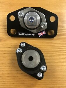

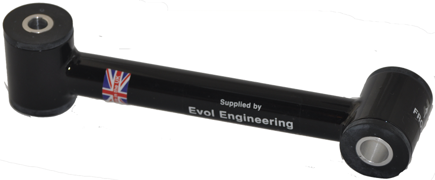

I have some kind of solid dogbone mount, not sure if it's Evol or not, certainly looks the same though.
That was already on the car when I bought it.
Because of the dogbone mount there was a lot of vibration already, the Evol race mounts added some more but not much in the scale of things.
Prior to the Evol mounts I used the powerflex Bush, worked pretty well and didn't vibrate as much.
My favourite thing with the Evol mounts is how good and quick a gear change can be/feel now due to the engine not rocking.
That's interesting as that would make a good combo with the Evol dogbone and the powerflex engine mount insert. Cheers 👍
