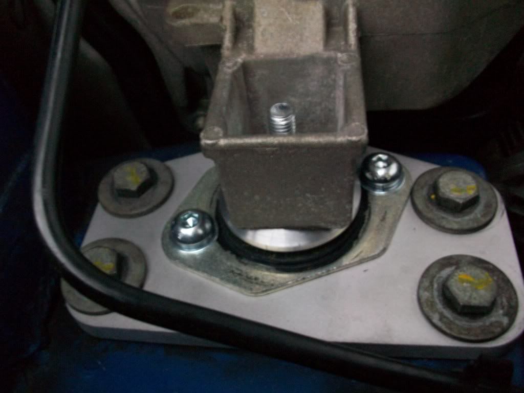

Got myself the drivers side uprated mount through today seems pretty solid gonna fit it tomorrow. Think i should of bought gbox mount to even out the stresses aswell but i have only recently replaced that one.
Well fitted my drivers side mount today and it seems to have helped the knocking i was suffering. The decat i have has quite a large flange so since fitting it i have always suffered some knocking noises on acceleration.
Also the engine movement the car has had when lifting off has virtually gone hence making the car feel better through the box. I suffered a bit of knock in first on a damp road earlier but thats it. Overall im impressed the only downside is that there is more vibration through the car any creaks etc are now louder and the rear view mirror vibrates a bit at speed.
One last thing is that i Think i will end up changing the gearbox mount as when you rev the engine the engine does now not shift near the new mount but flexs by the gearbox side a lot more. So i dont think the box mount has a long life to look forward to.

Fitted one of these mounts today. Again, I suppose I'll reiterate what has been said above. There's more vibration through the car but it's something that you only feel while stationary, it's masked in most all other occasions by road vibrations etc.
Again, some minor vibration in the mirror at speed. Lastly, the engine note seems to be louder (maybe I'm just imagining this though :rolleyes:).
Plus sides, car feels better. Feels tighter, and feels like it picks up better. The new mount has completely eradicated any knocking I was getting.
Worth it, I don't know. I'll reserve judgment until I have a bit of spirited driving in the car. Did 170 miles in it this evening but they were bored, uninspired roads. At the moment, thumbs up. :)
Ridiculously easy to fit. Much easier than the bloody ARB bushes I did today ... :dead:
Done a few miles with it fitted now and the only downside is the vibration its only noticeable for ten mins when cold my dash rattles like a b**ch. Also the increased idle of rs tuner doesn't help.
I have managed to dampen it down with some thick rubber that I cut to shape and fitted under the mount and this has helped.
But again i get no knocking at all now which was a prob, as i have a decat with quite a large flange so there is minimal clearance and it used to knock all the time. Also got to agree with the car feeling tighter to drive and has a nicer feel when you put your foot down.
