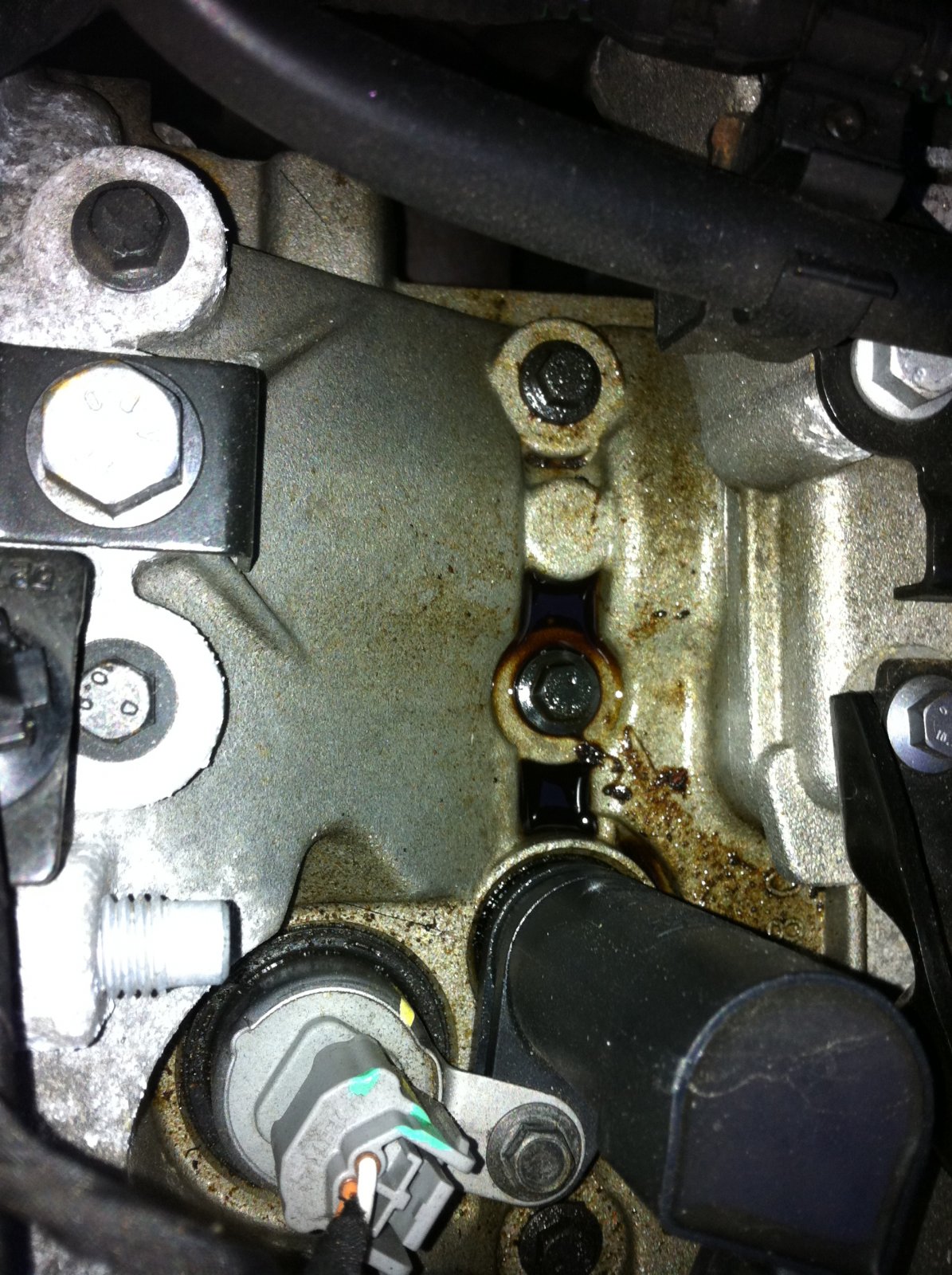

As for the faults Christopher covered most of the big ones.
The only other ones I had apart from the ones already mentioned was oil leaking from the rocker cover, simple fix with a little sealant.
