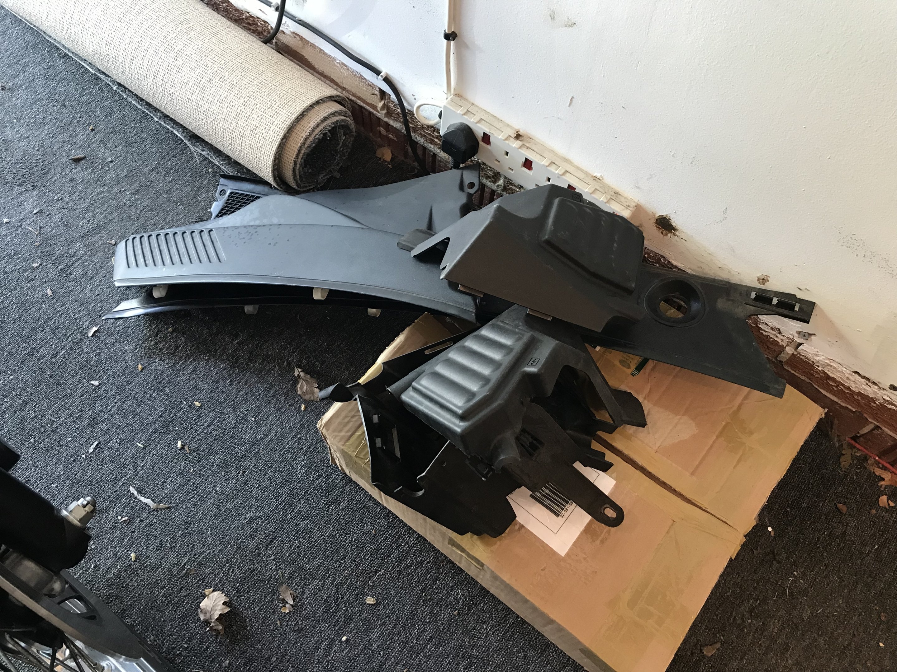

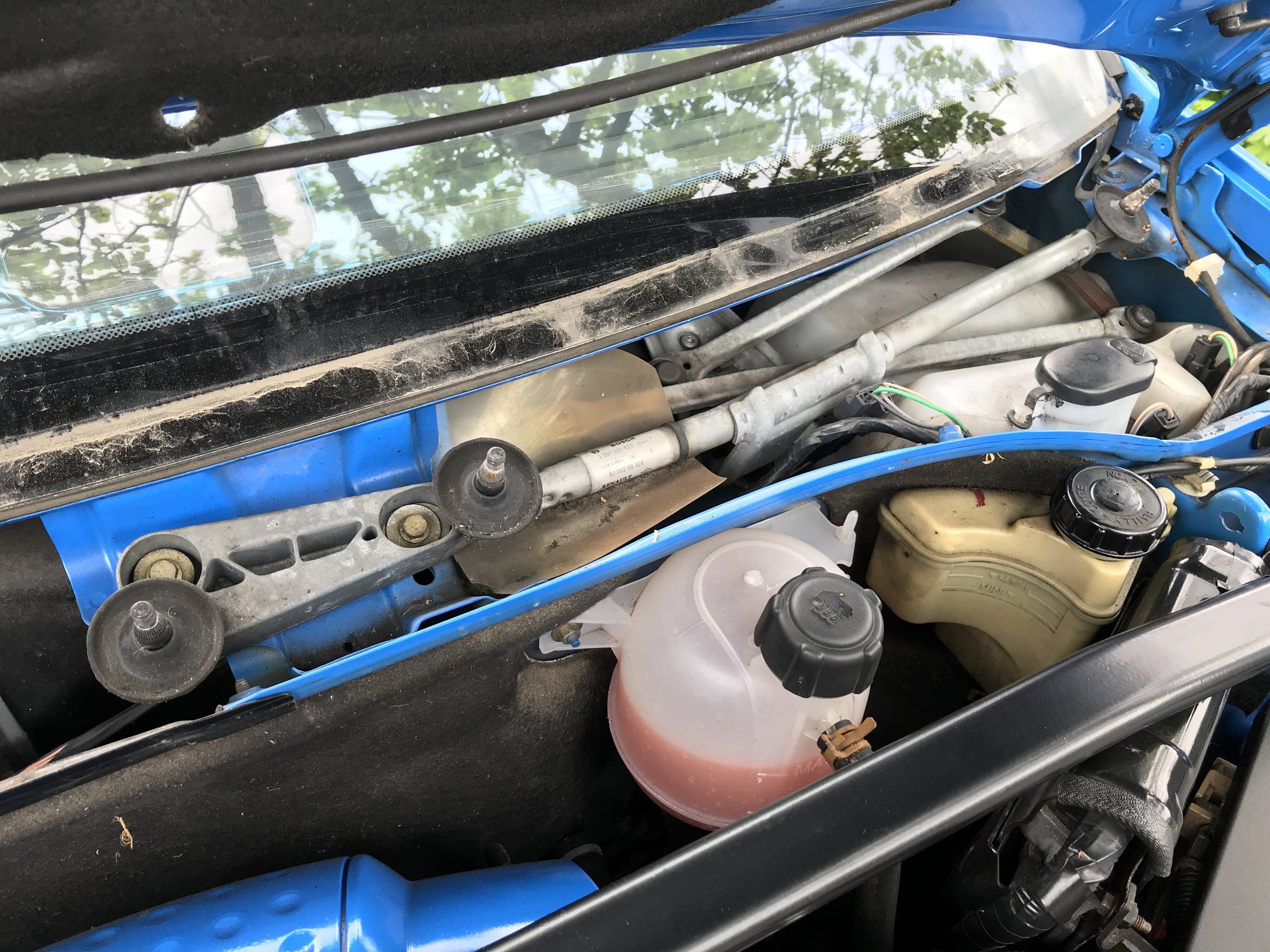

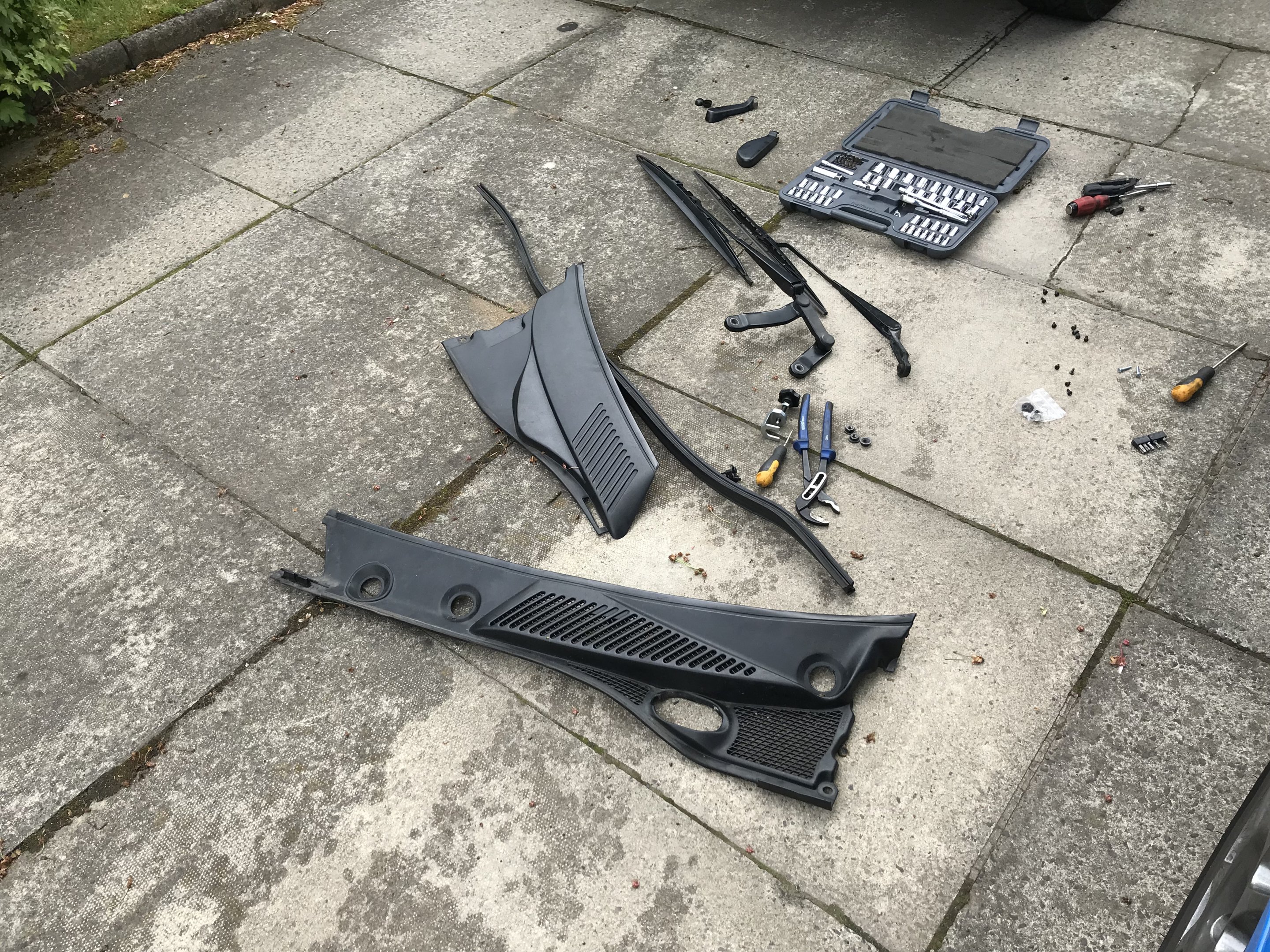

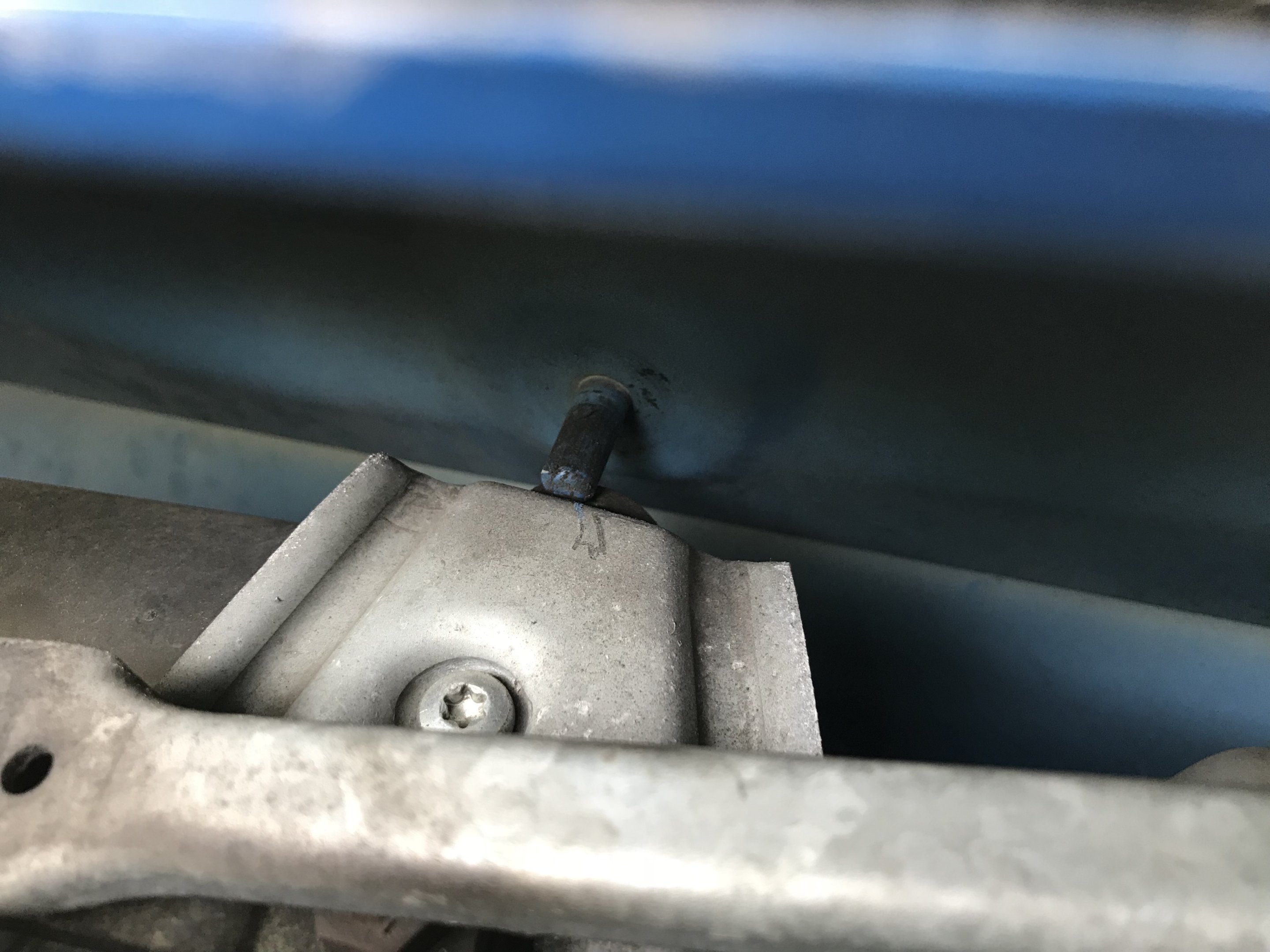

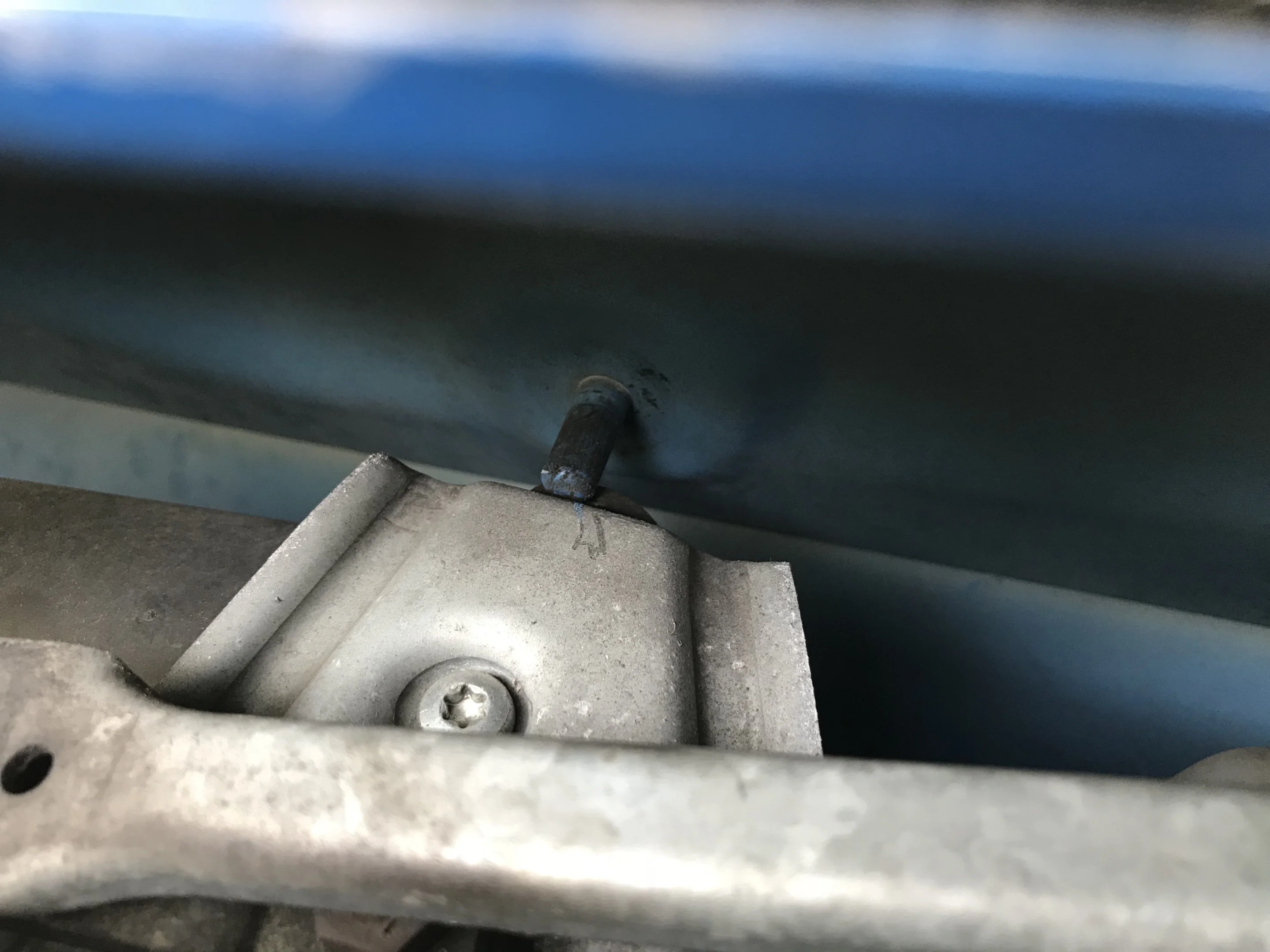

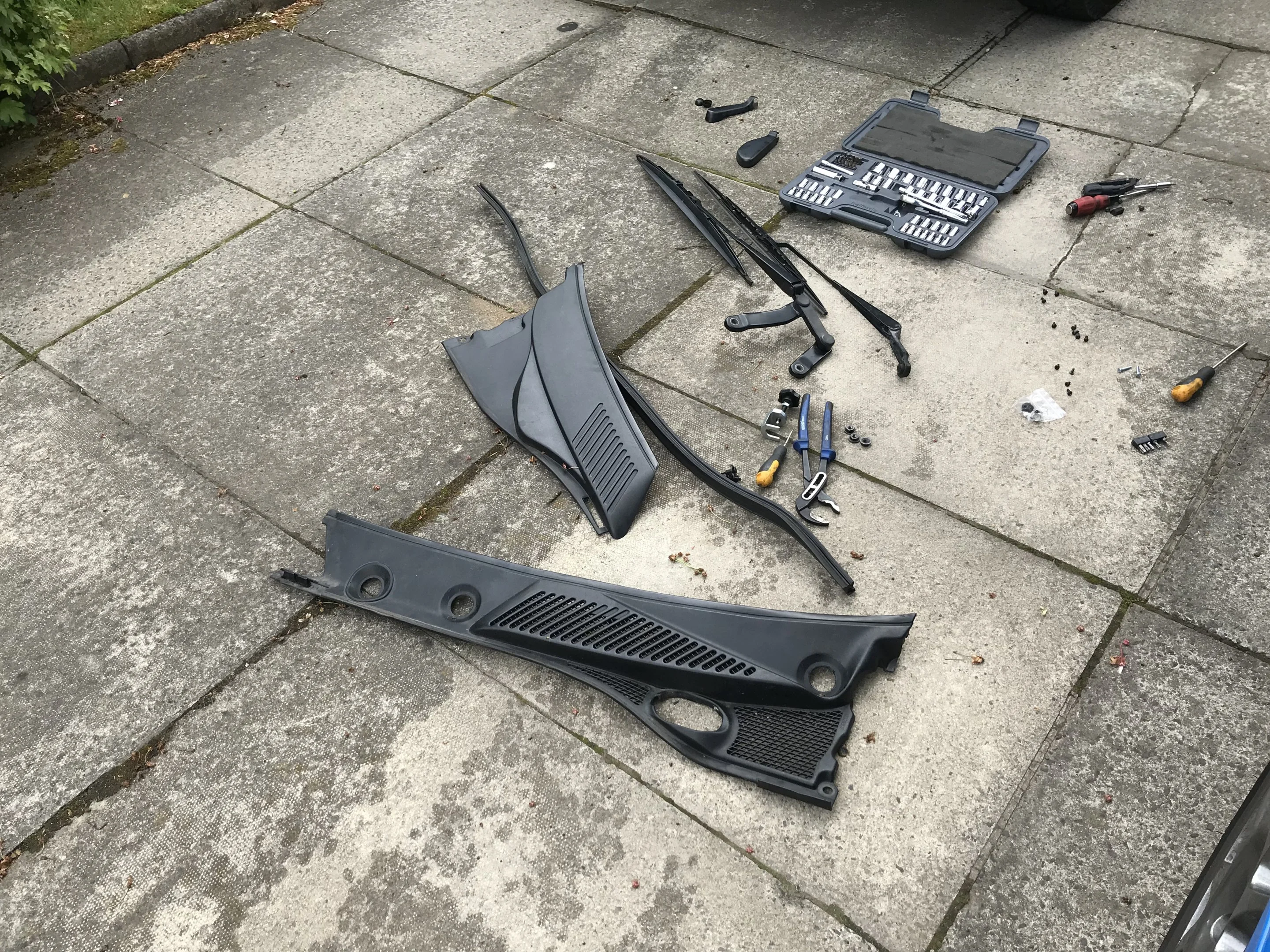

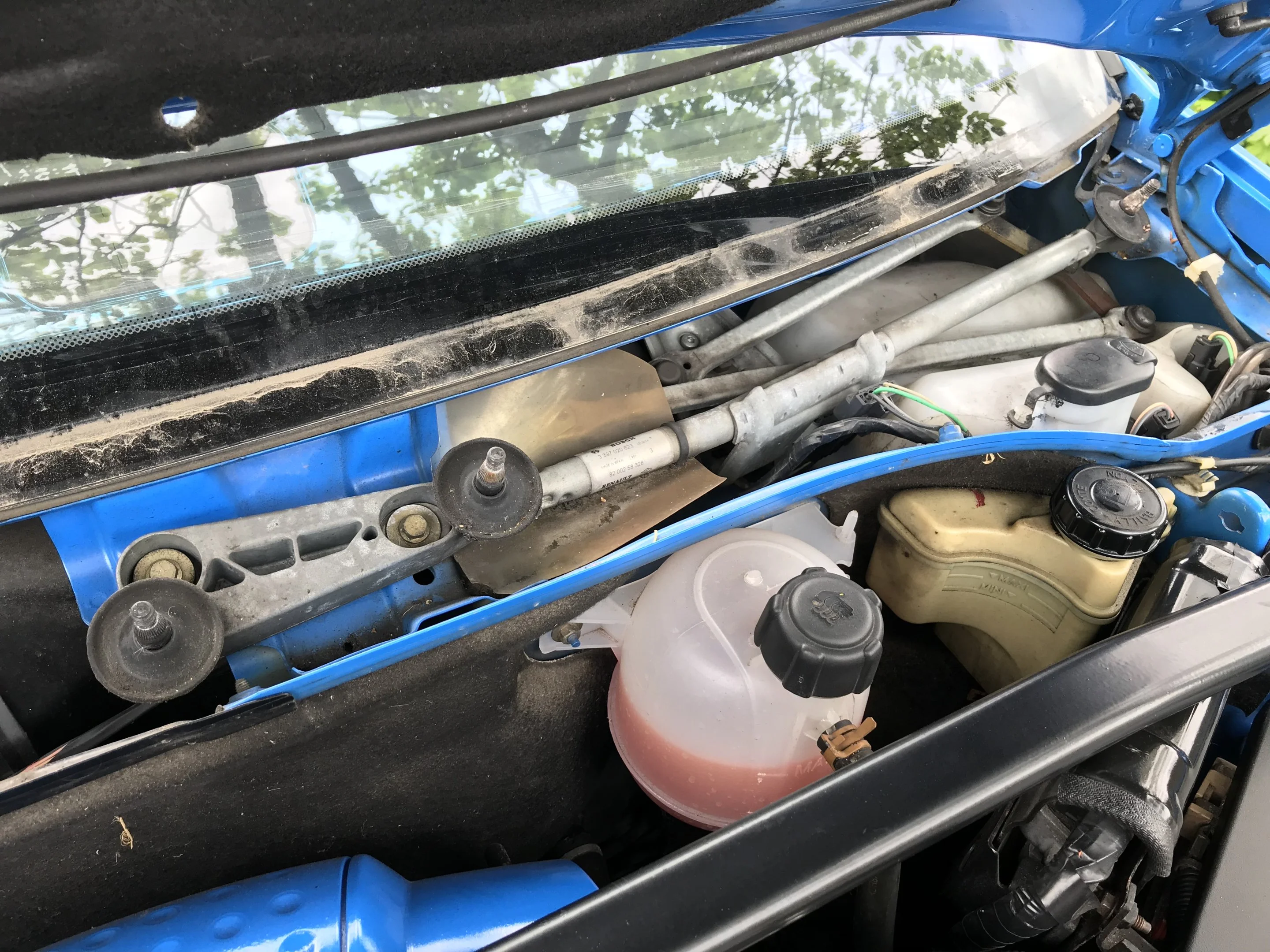

I also had a look at the squeaky wiper mechanism and that looks to be the motor not located properly....there’s a little locating peg that looks like it is not in position.
The N/S scuttle plastic is broken and does not sit flat at the end so l have ordered a good used one and will do the wipers when that part arrives.

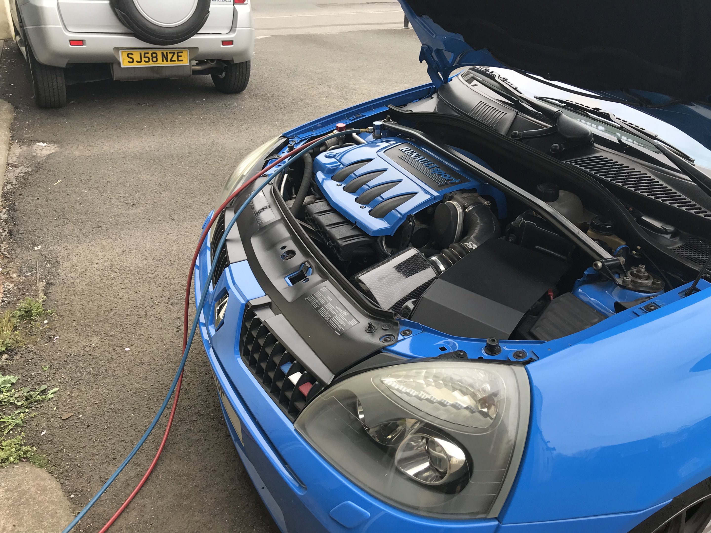

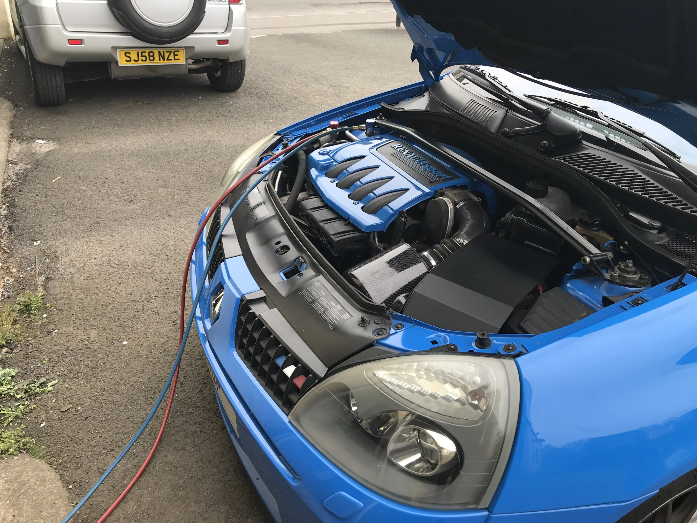

Aircon service and regas
Gas left in system 240g
So down to about 33% will see how it goes and get it repaired if it leaks out again.
Usually dried out seals.
I like to have working aircon.
He’s called Gary but l also have another one called Francis for aluminium Land Rover Defender panels as Gary doesn’t like them
The Clio is great with working aircon, climate control is much more effective and it’s great at set about 18 degrees where before it was always a bit warm, even though less heat came from the vents when you reduced the temperature.
£40 well spent.

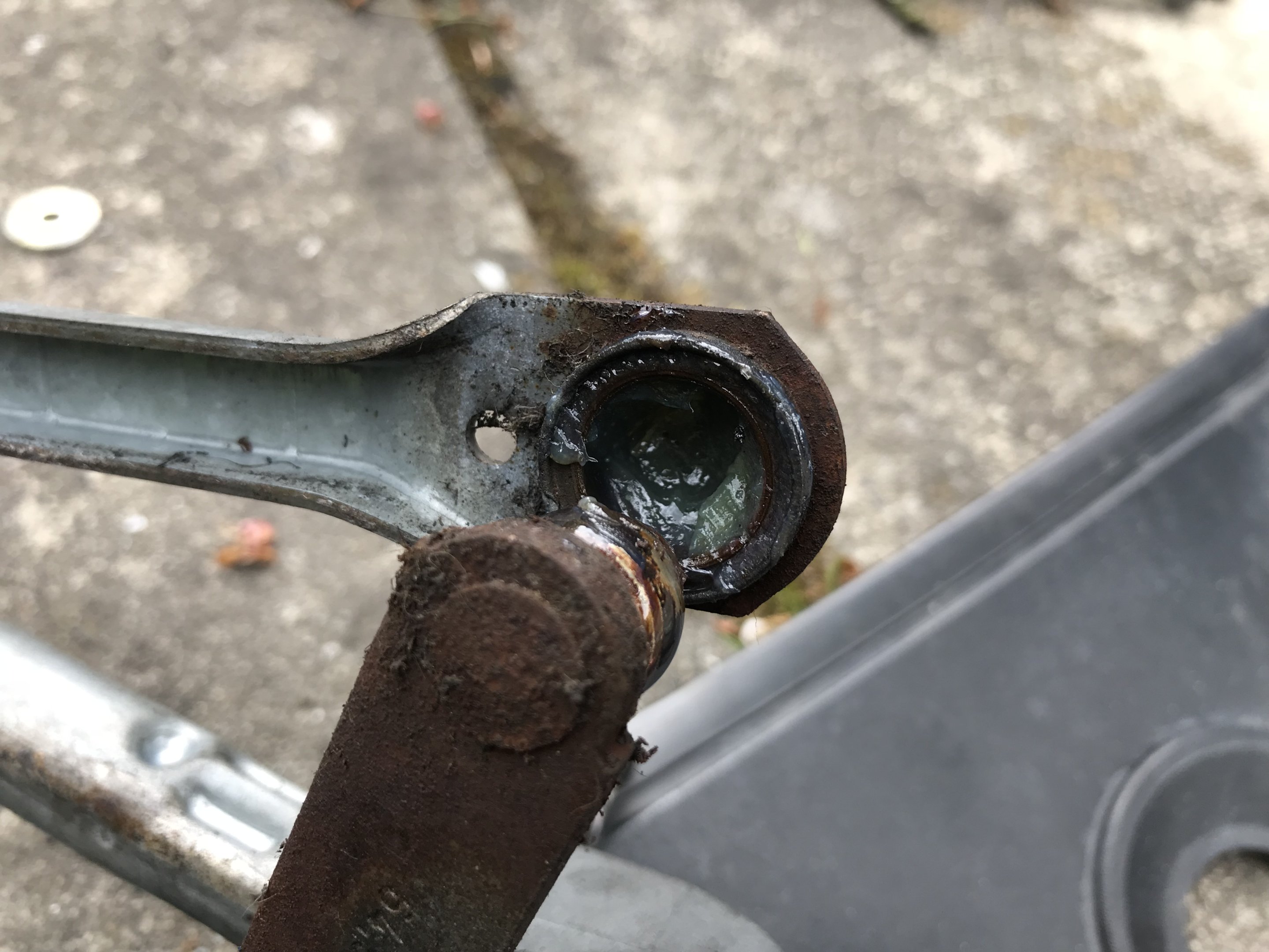

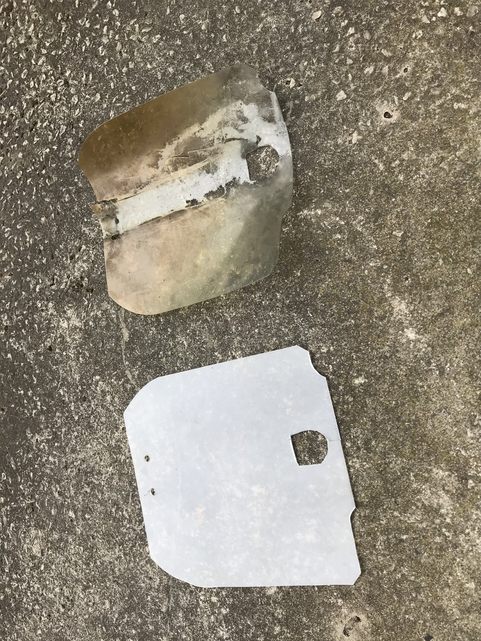

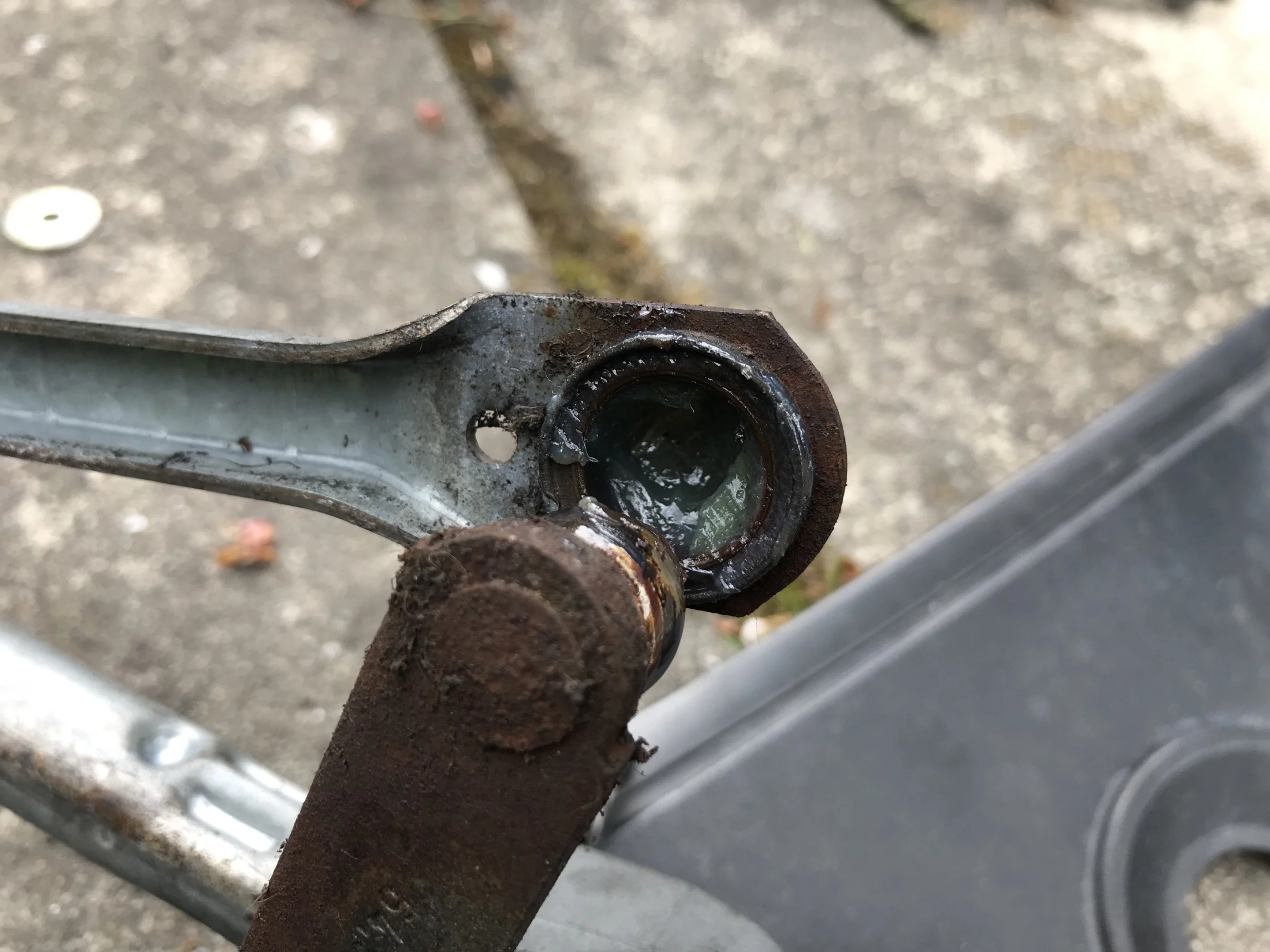

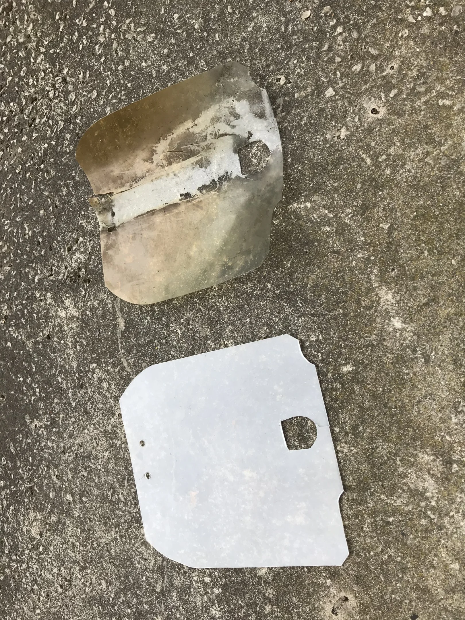

Had to make a new water deflector. And one of the ball joints was dry so l packed it with grease.
Wipers are now squeak free!

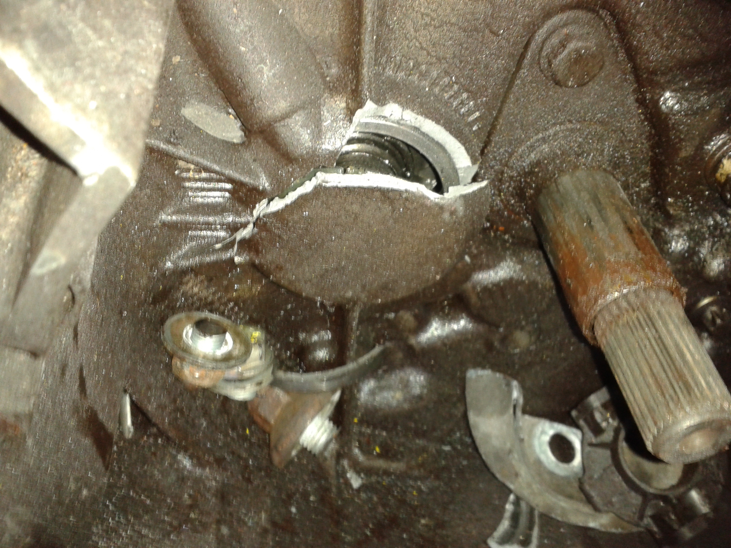

There are always niggly things that need doing, some you can ignore while concentrating on others. But yeah, what's happening with the gearbox?
The gearbox fault was clearly described in the advert, l had looked at a lot of these cars and even if a new gearbox was needed it would still be the best one l had viewed.
However, the noise from the gearbox is not obtrusive and has quietened since l did a long motorway journey in the car.
What l am going to do is get a recon box from the guy on here who does them, and store it until it is needed.
So if the fault does get worse l can get it repaired quickly.
Should it not be needed l can always sell it on.

Today’s job is to replace the plastic fuse box next to the air filter, as the clip is broken off meaning the lid is free to rattle around.
I got a mint used part from Ebay.
The mountings at the ends were broken so they sat proud of the screen at the corners. I could have stuck them down with silicone sealant
but a good used replacement set was only £20
I think somebody had tried to remove them to get to the wiper mechanism.
The fuse box lid had been cut down for some reason and the mounting clip was broken off, so l replaced the whole lot, again for next to nothing.
