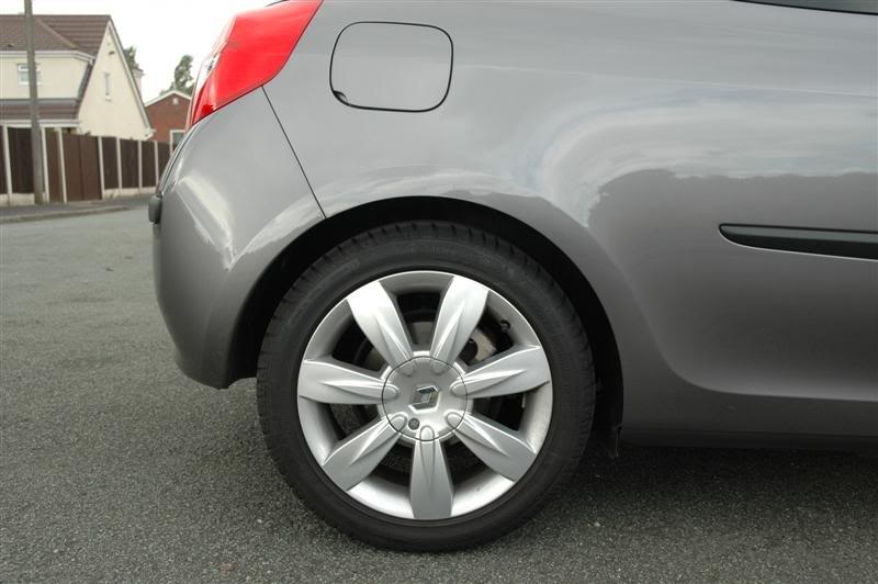

if you measure tommorow for me m8 id really appreciate to know the gap height between arch and wheel, will 40-45mm really be low enough for the rear arch to look decent ? looking at that image were only talking about 4cm off that height !
