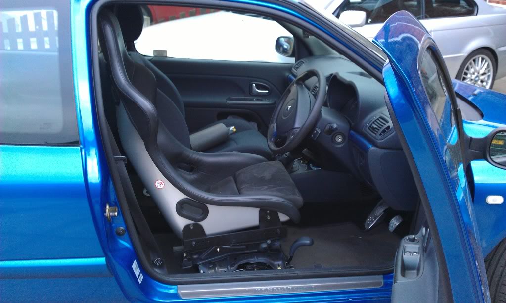

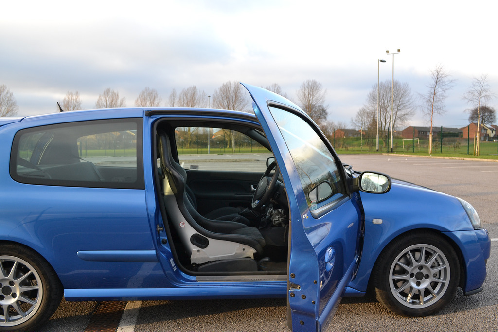

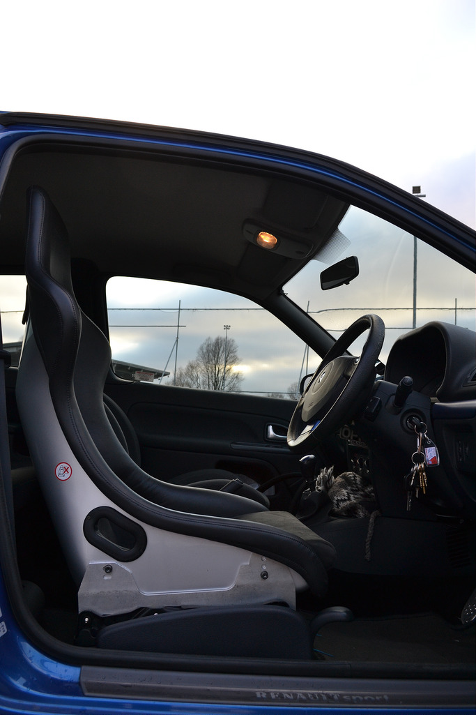

I bought a Recaro Pole position off JamesT87 a few weeks back and have spent the past couple of weekends getting it fitted.
It didn't fit well at first as it sat too high

Looks good. Lovely seats. Not seen them mounted on standard subframes before though. Did you have to drill holes?

Have my Dad and Bro to thank for the help with the subframe.

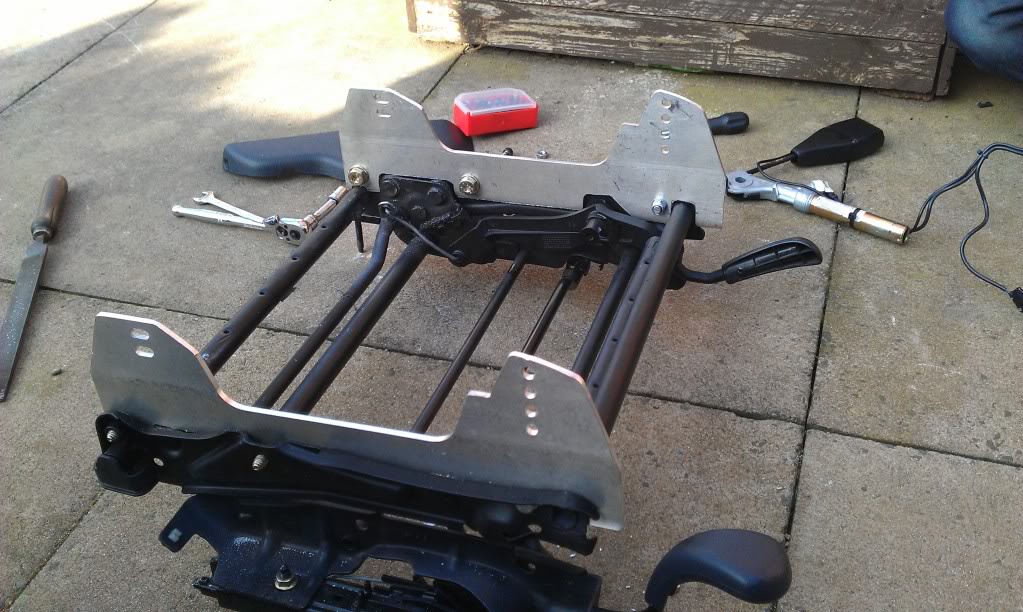

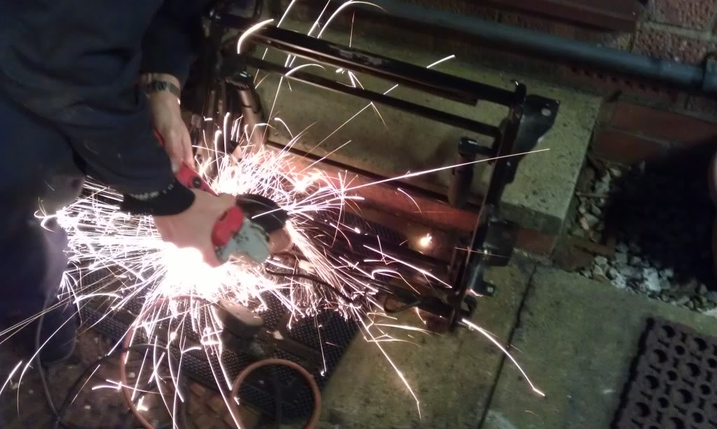

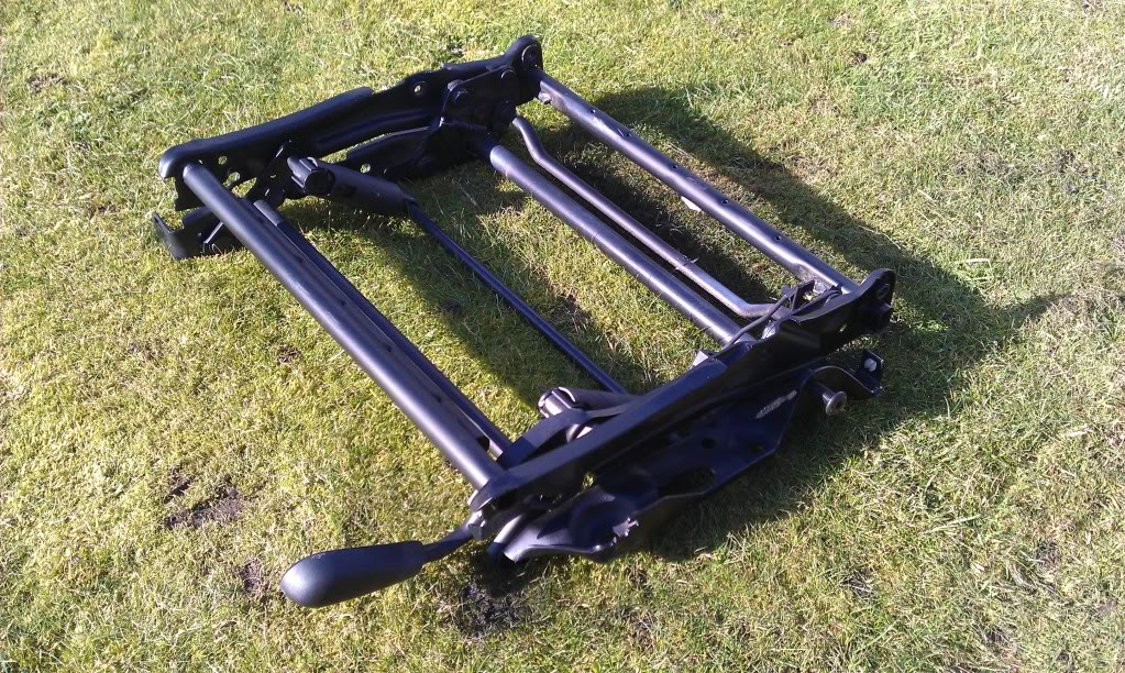

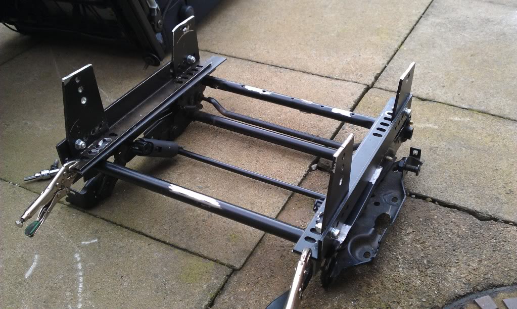

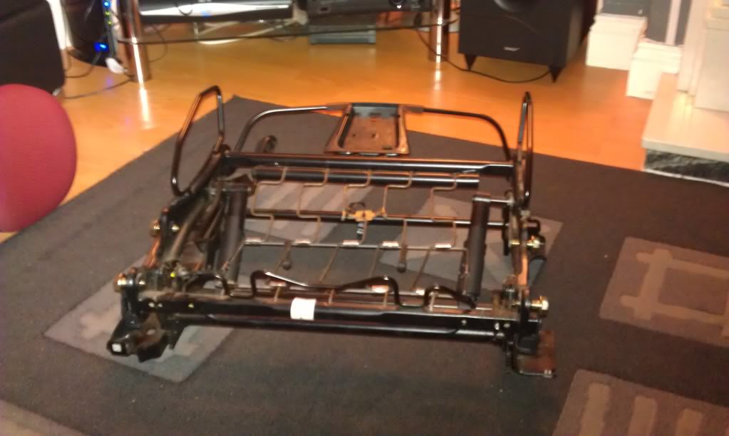

We started off with this...
Did a bit of this...
Tidied it up a bit resulting in...
Then added some sidemounts to it.
Proper seat.

£340 in total, that's buying the seat and then buying another clio seat to butcher.

Can fit people in the back with ease, slide functions as normal. Subframes were custom as above mate.

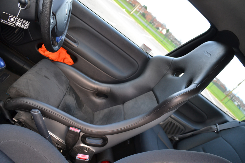

So am I right in thinking that fixed buckets are secured in on the side mount plates only and so it's just finding a way of getting the side mounts to bolt onto the Renault sliders?
Cheers mate. Where in Manc are you from? Will keep an eye out.
No worries, I'm from East Manchester (Middleton/Ashton-under-Lyne)
And yes, I started off with some sidemounts which mounted from the bottom, chopped the bottom part off and mounted them to the side using two original mounting points (the bronze bolts) and another bolt at the front of the seat. Infact I've got a template at home, it's pretty easy to be honest if you've got the tools for it.
This is how we originally worked it, but this sat the seat too high.

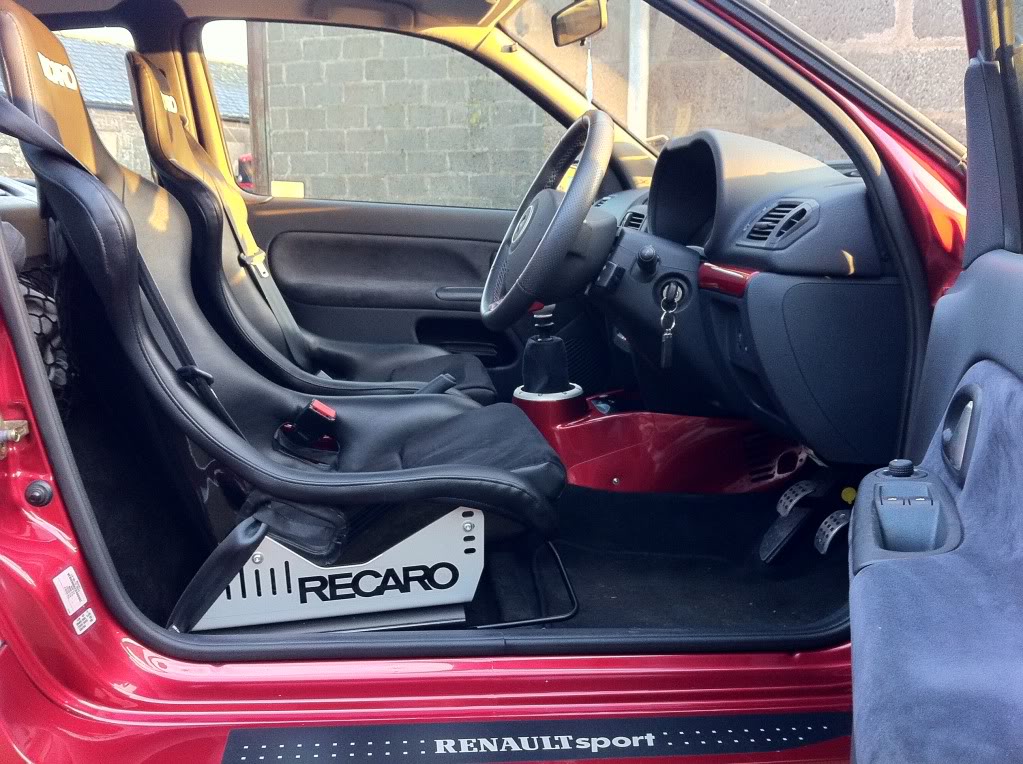

Lovely seats... Not sure on the frame set up though,
Mine have been lowered on custom frames and sit like this, the shoulder bolster is level with the top of the door card
