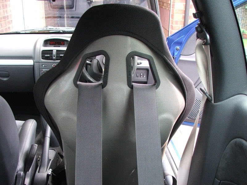

Fitted this last week, but just finally got the position sorted today. Seating is a lot lower and much more comfortable, car drives completley different. It feels as though there is loads more traction, but its just the fact that im not sliding around anymore!!!!!!!

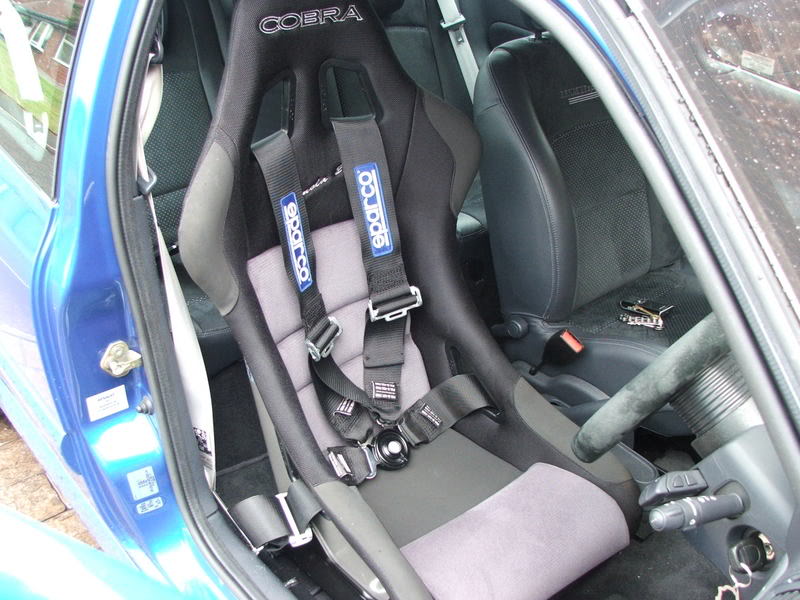

can you please post a pic of how you mounted the side mounts to the car ?

I have used a X-Low Cobra subframe that mounts through the 4 original seat holes and then you bolt the sidemounts to this subframe. It isn on runners etc, all bolted solid. X Low subframe is £75 from Cobra and they are sided and a b*****d to fit (need modifying).
Passenger side harness is mounted to the subframe (comes with harness mounts), drivers side is mounted to original lower seatbelt mount, rear has eyebolts bolted through the floor in new mounts in the back.

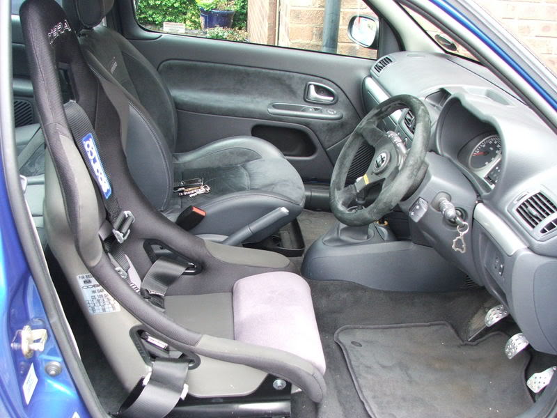

Can you post pics of the subframe/sidemount set-up fella?

Will get some pics up of the subframe etc when i get chance, not much to see really, just a subframe bolted flat across the floor, with cobra sidemounts bolted to it and the seat bolted between them.
