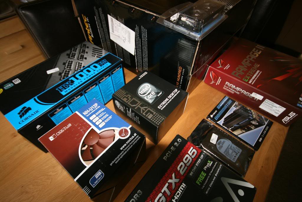

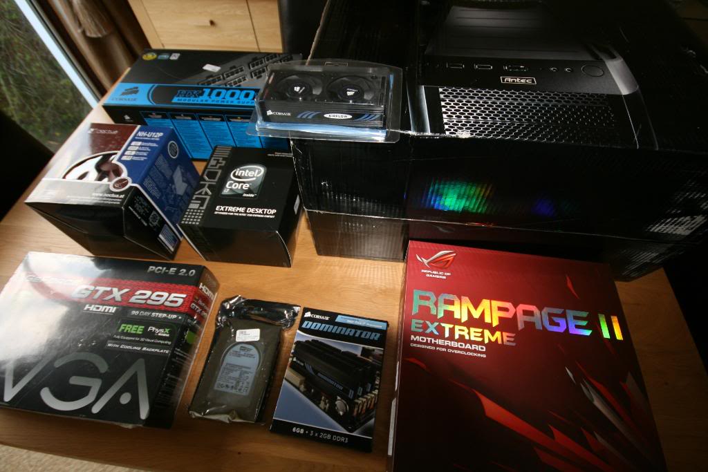

Parts arrived...
Unboxed...

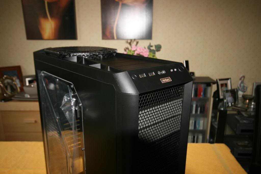

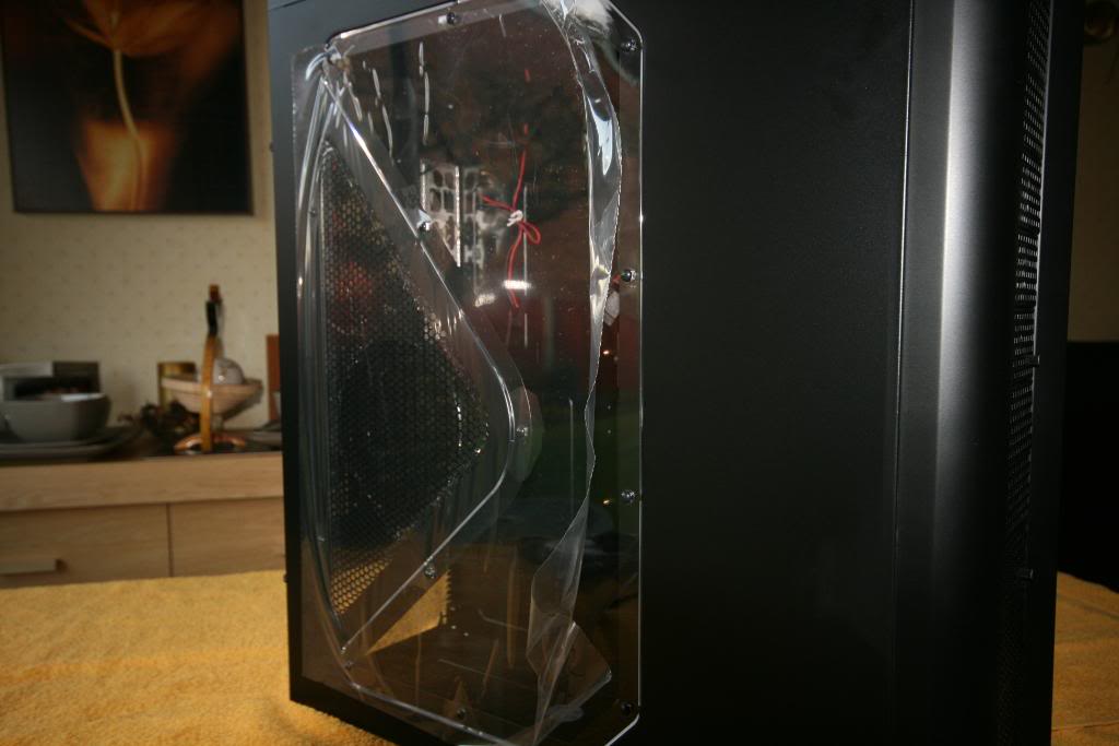

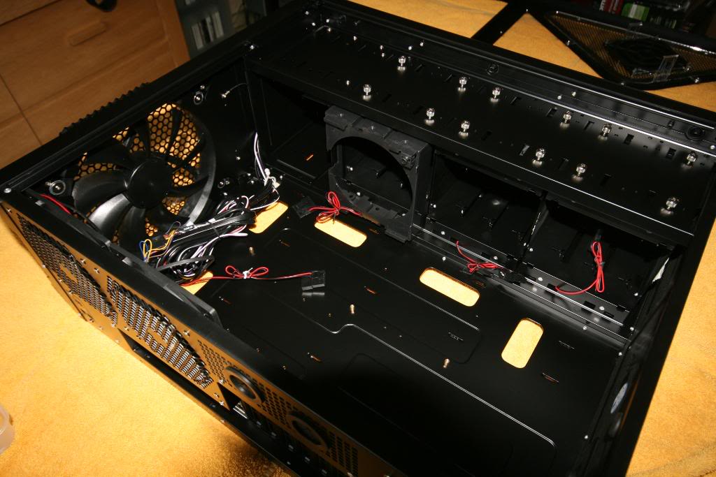

Case - Antec 1200 which is just f**king awesome lol...

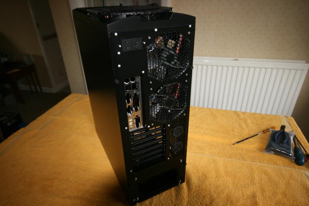

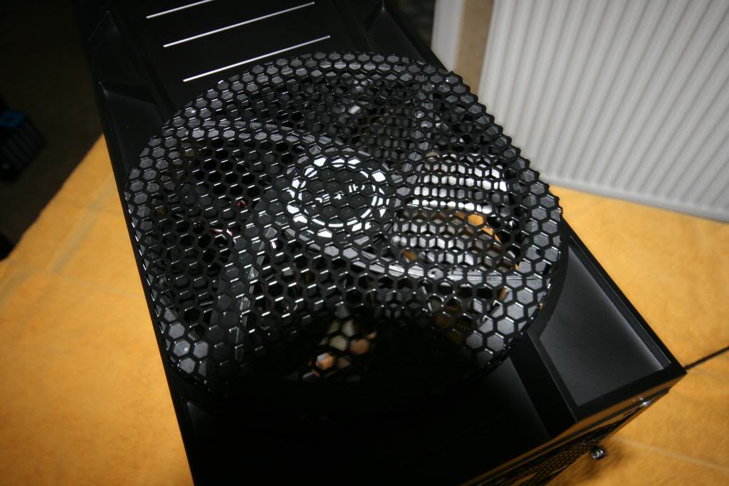

Massive exhaust fan...
Inside...

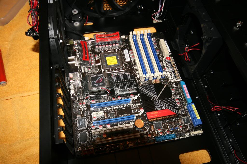

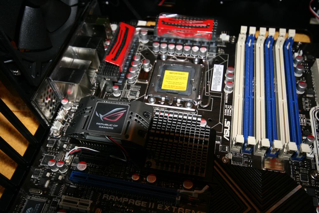

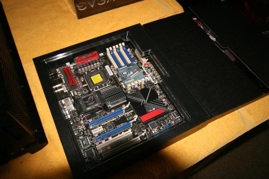

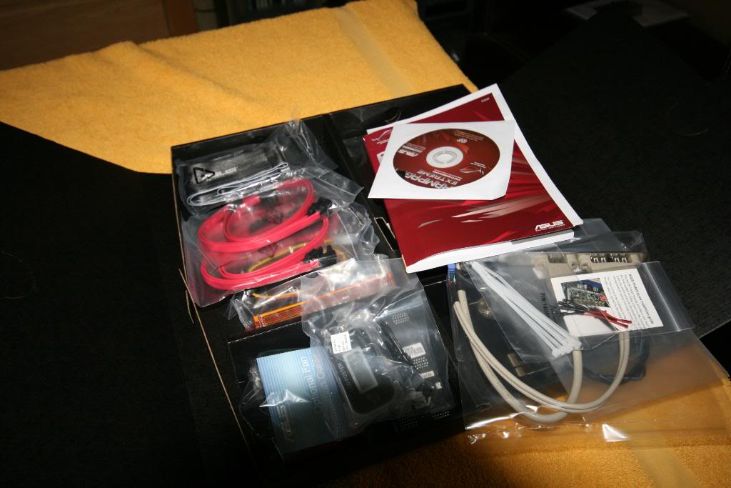

First look at the Asus Rampage II Extreme Mobo...
Mobo in case...

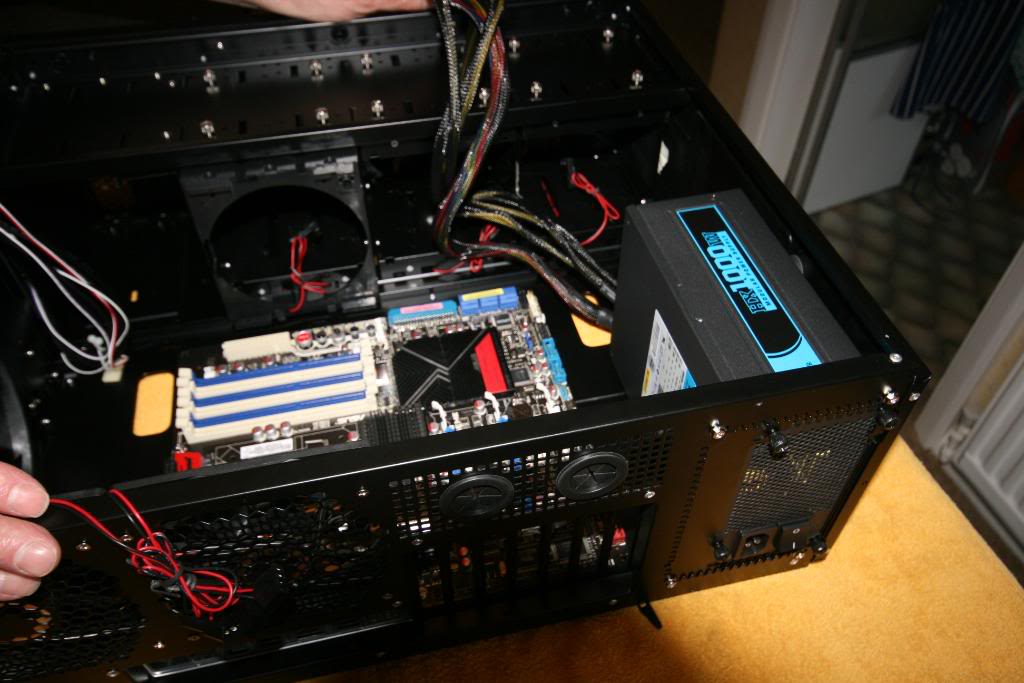

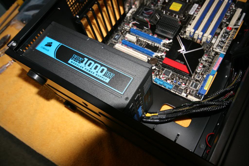

Corsair HX 1000W PSU...
This is the best PSU I have ever worked with. If you are after a new PSU then it has to be a Corsair :)

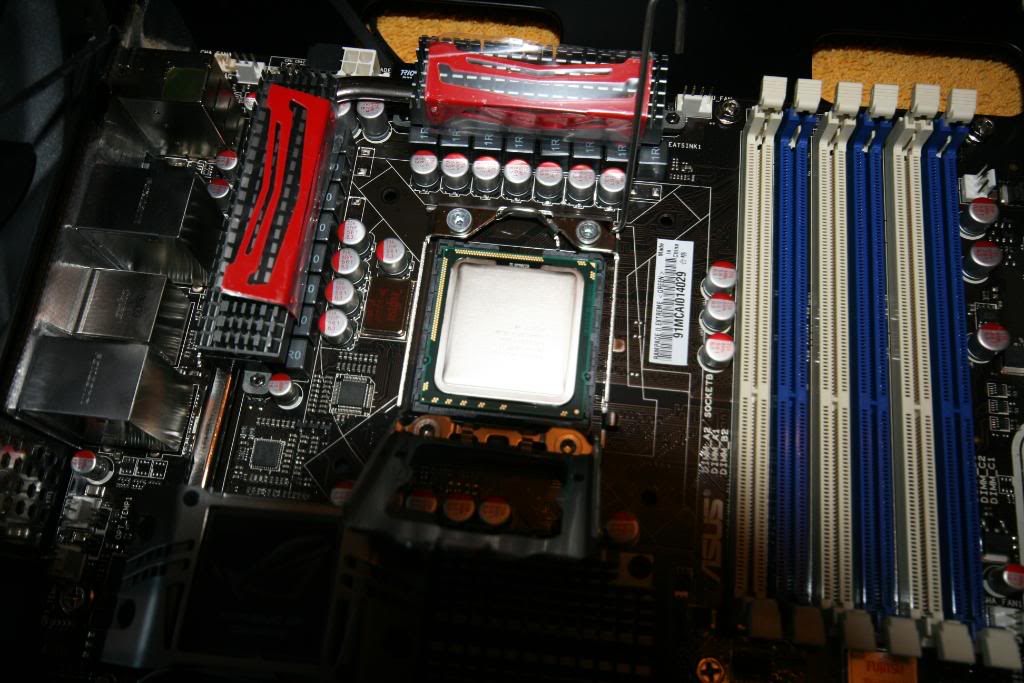

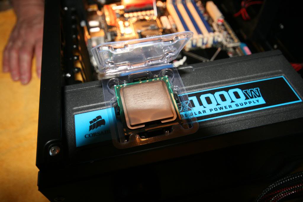

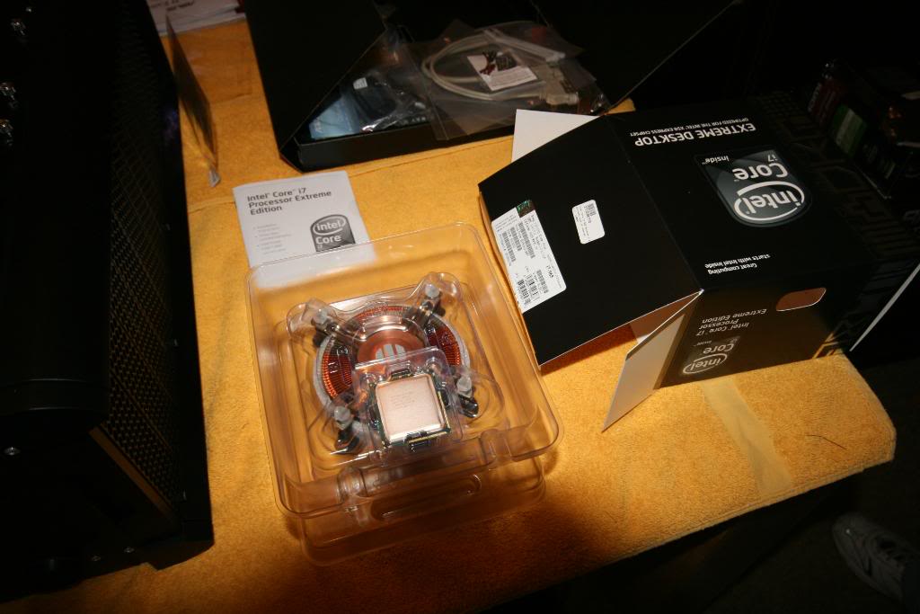

And here it is the Daddy - Intel Core i7 965 3.20Ghz (Nehalem) Extreme Edition ...
Getting very nervious at this stage lol...
Nightmare over lol...

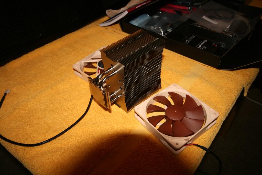

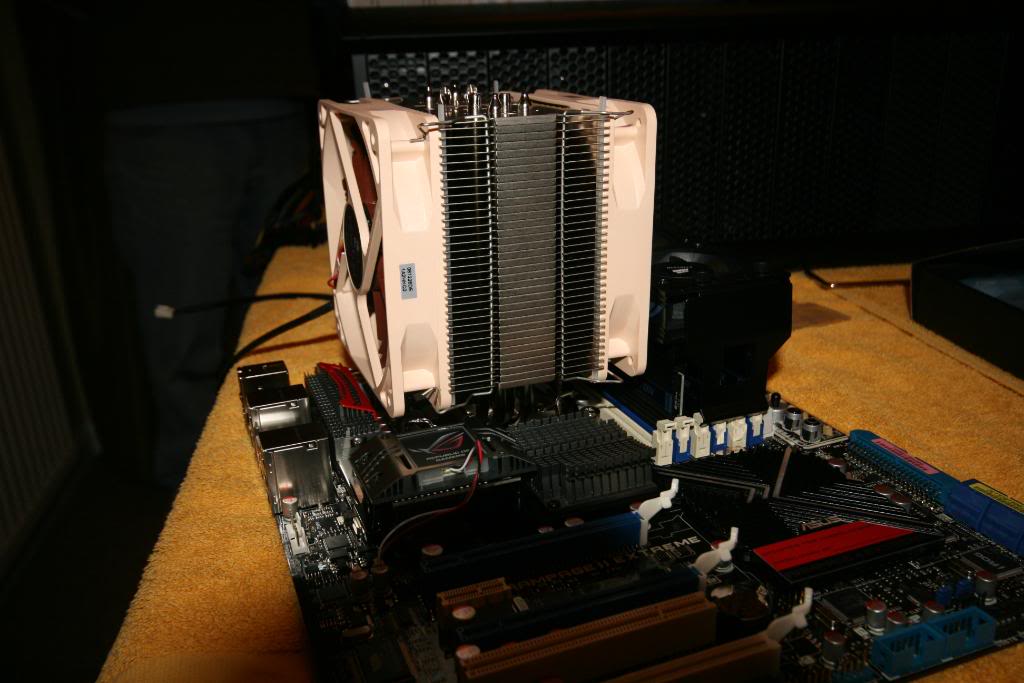

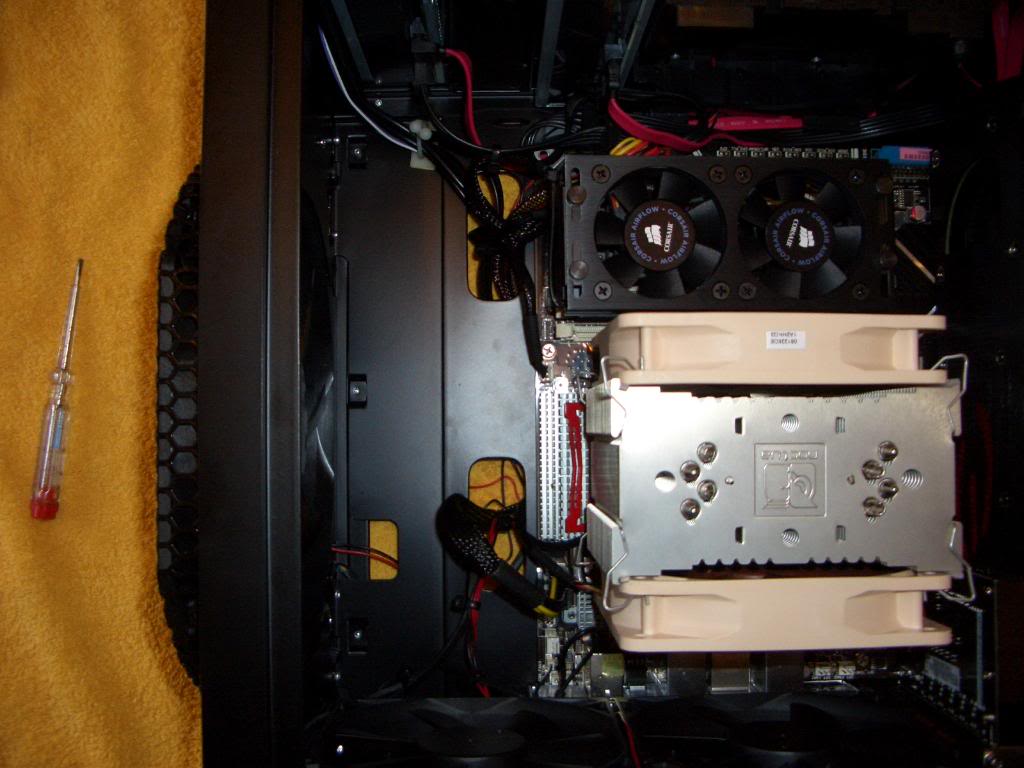

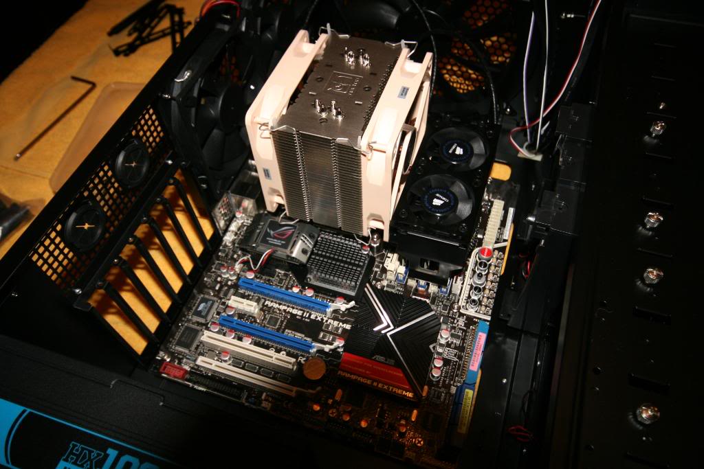

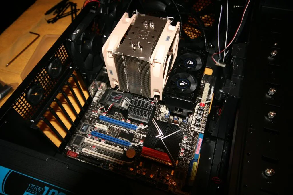

Noctua NH-U12P SE1366...
Slight issue here as the Heatsink needed a back plate so the Mobo had to come back out, no major issue :)...

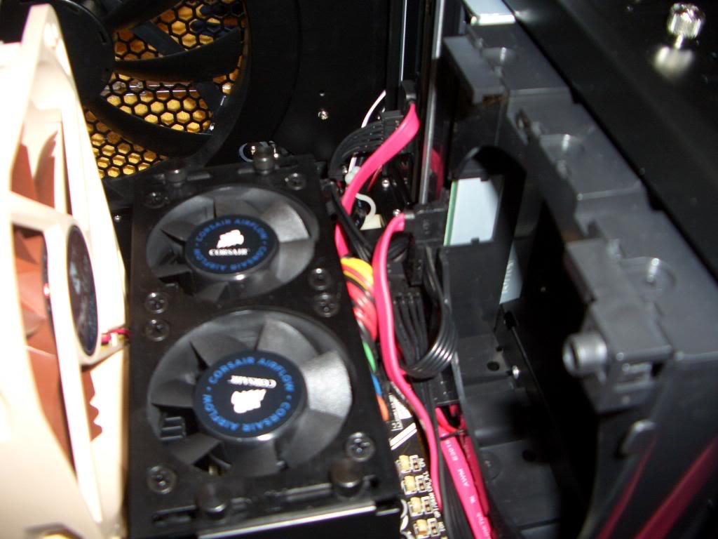

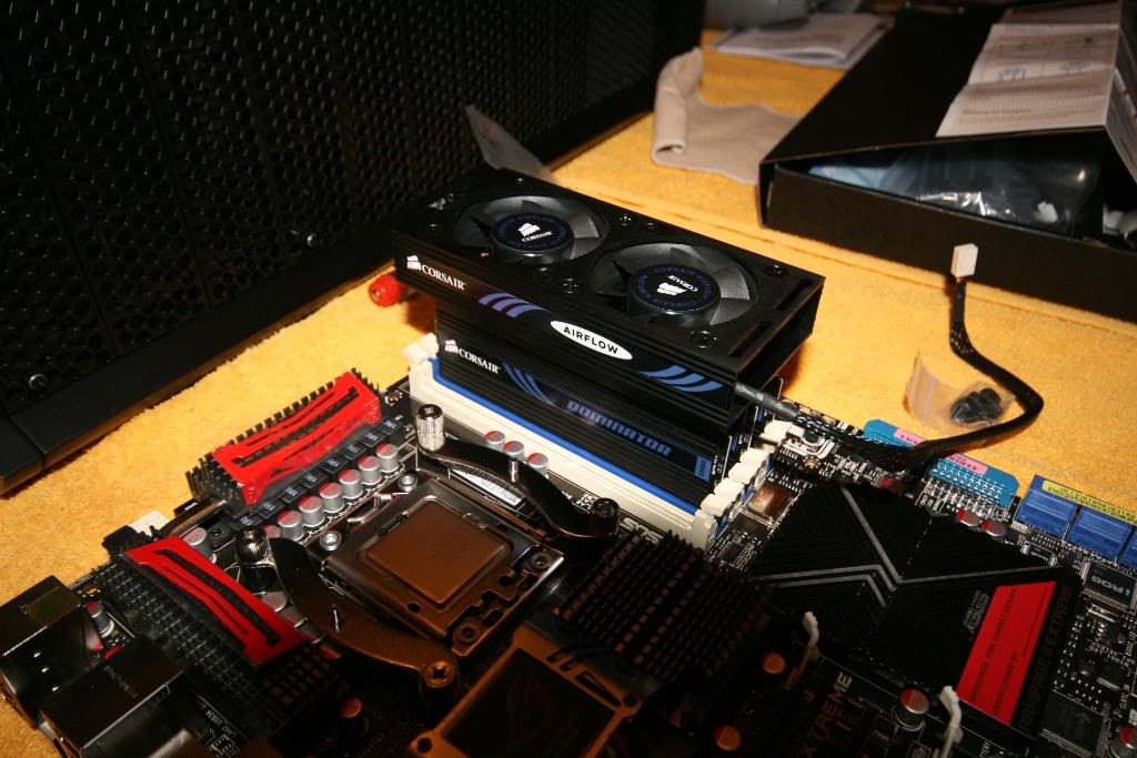

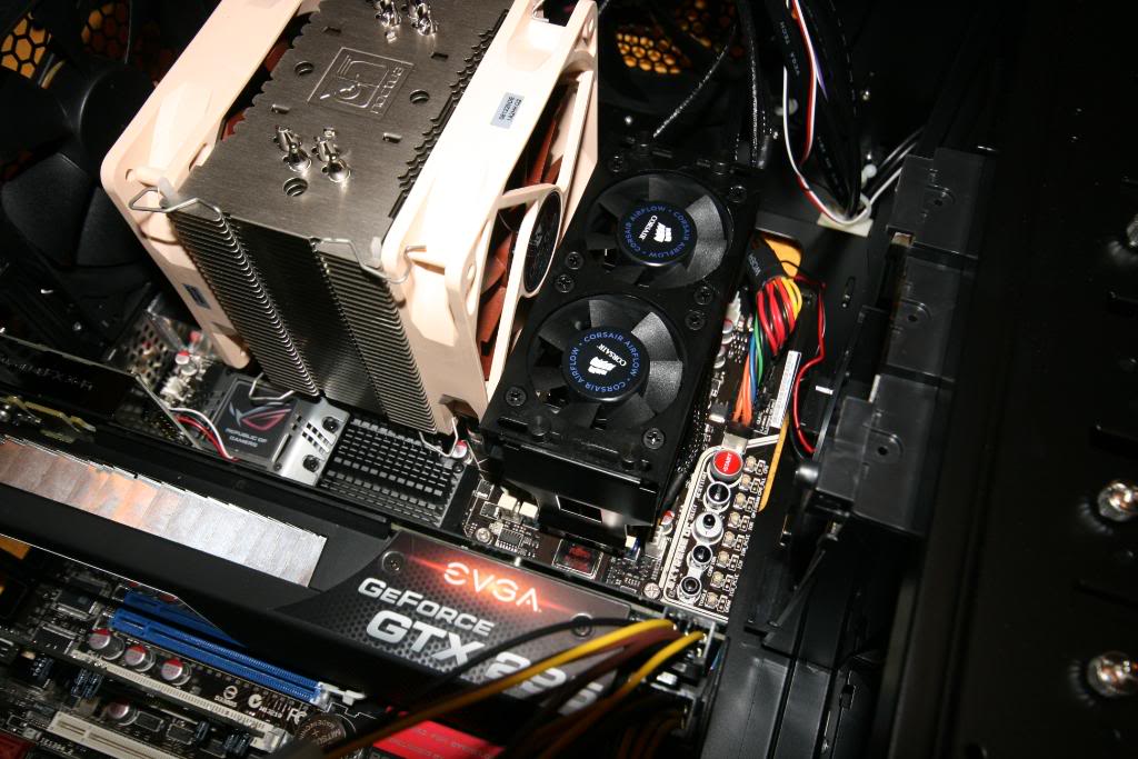

Memory - Corsair Dominator 6GB (3 X 2GB) DDR3 PC3-12800C8 (1600MHz) Tri-Channel with a Corsair Triple-Channel Airflow Fan...
Heatsink on...

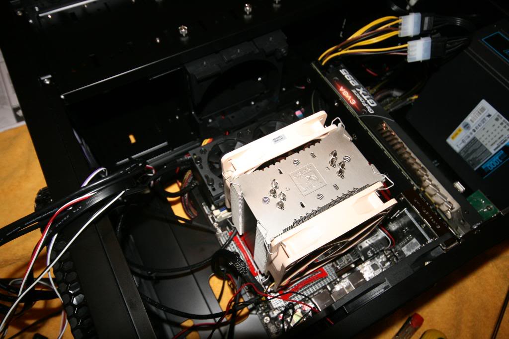

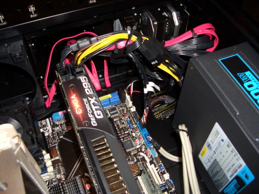

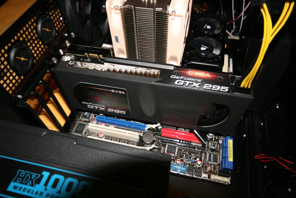

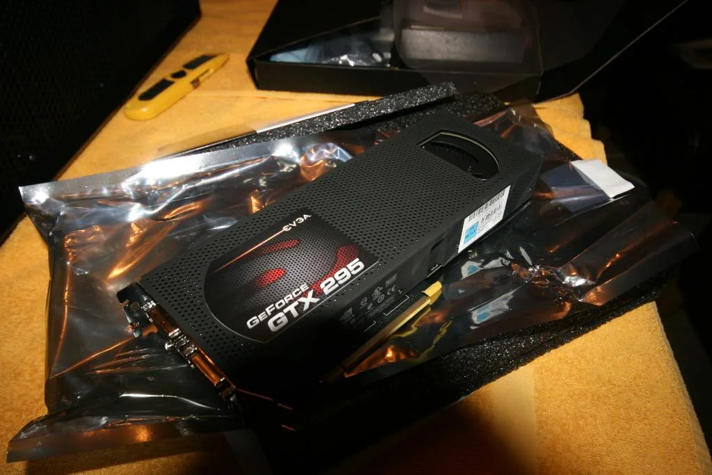

GPU - 1792MB EVGA GTX 295, PCI-E 2.0, 1998MHz GDDR3, GPU 576MHz, 480 Cores, 2x DL DVI-I/ HDMI w/ Backplate...
What a Beast lol...

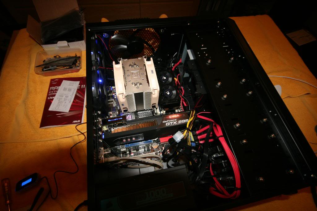

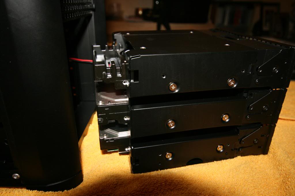

Inside shots...

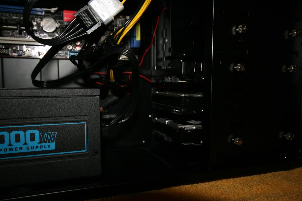

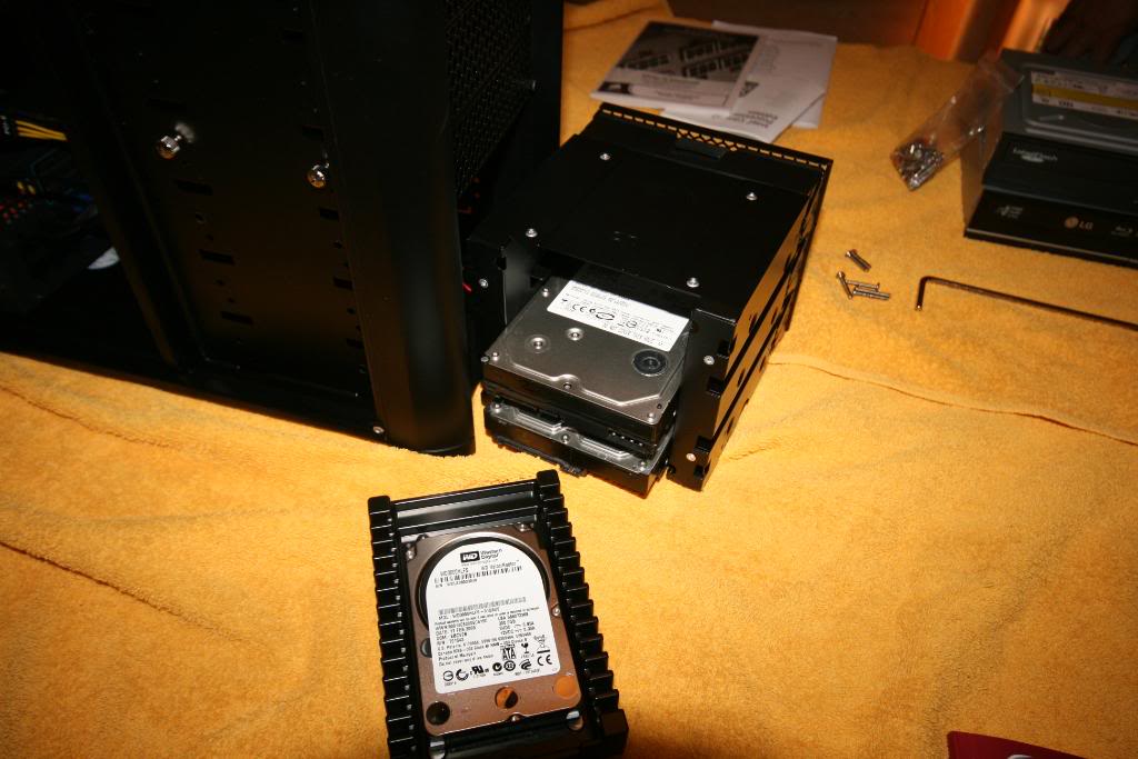

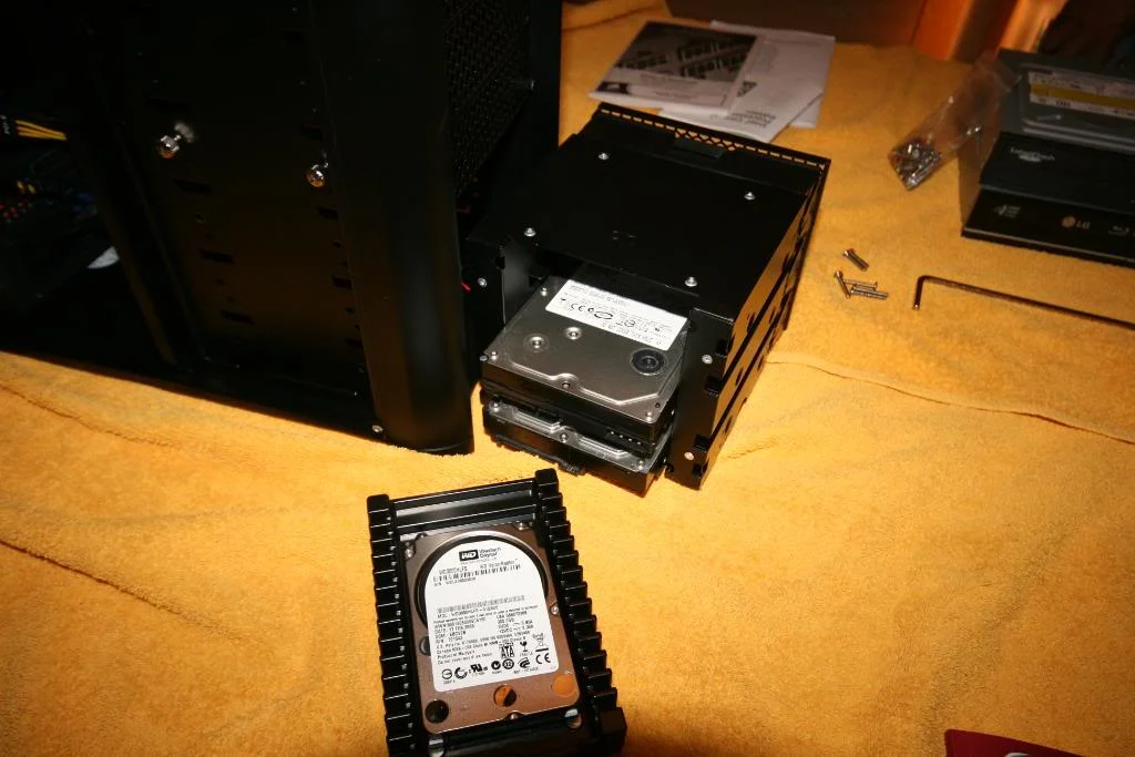

HDD's - 2x were existing SATA II drives but my OS is going on a new Western Digital VelociRaptor 300GB 10000RPM SATA-II 16MB...

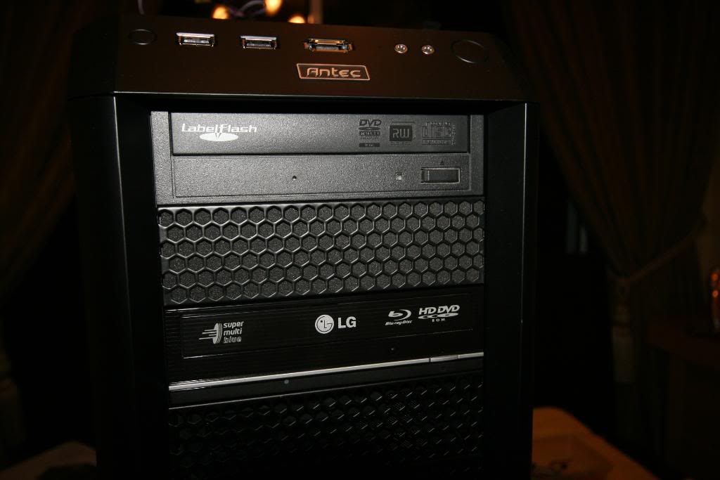

Optical Drives - Nothing new here. DVD Re-Writer and a BD Re-Writer...

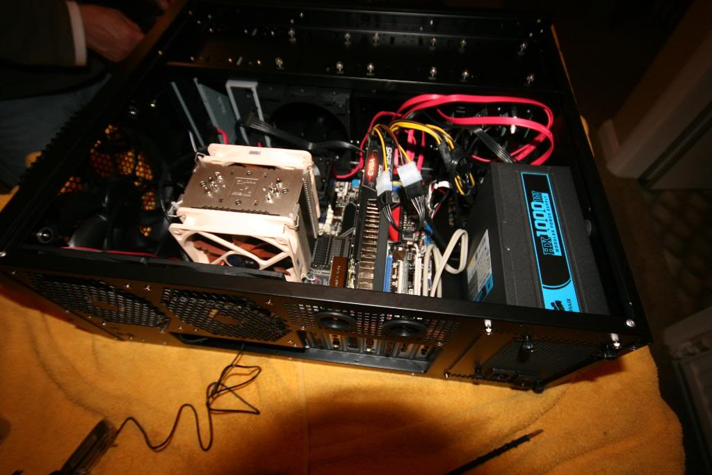

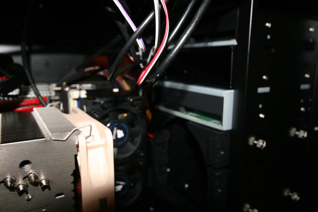

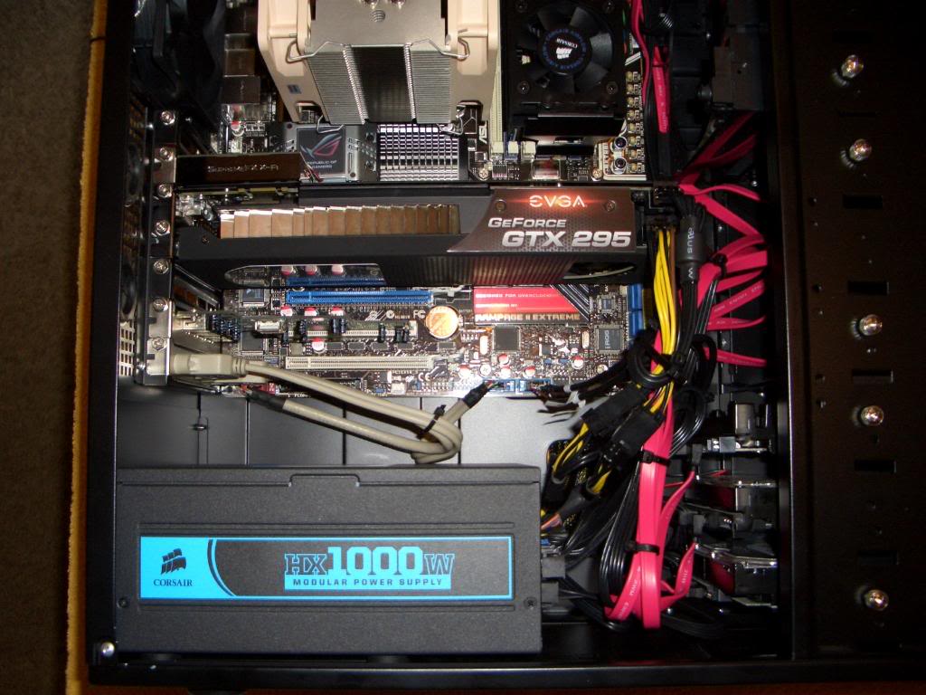

More inside shots, started to tidy up the cables...

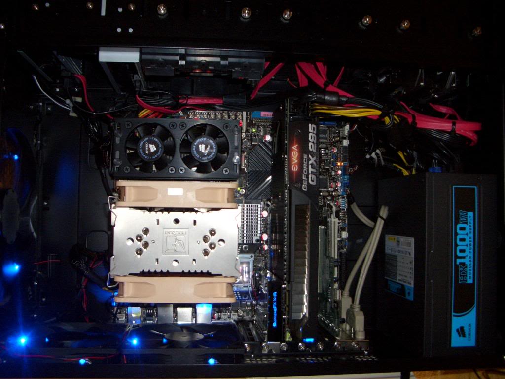

Good work man. Not too keen on that memory cooler though. Get gaming asap :approve:

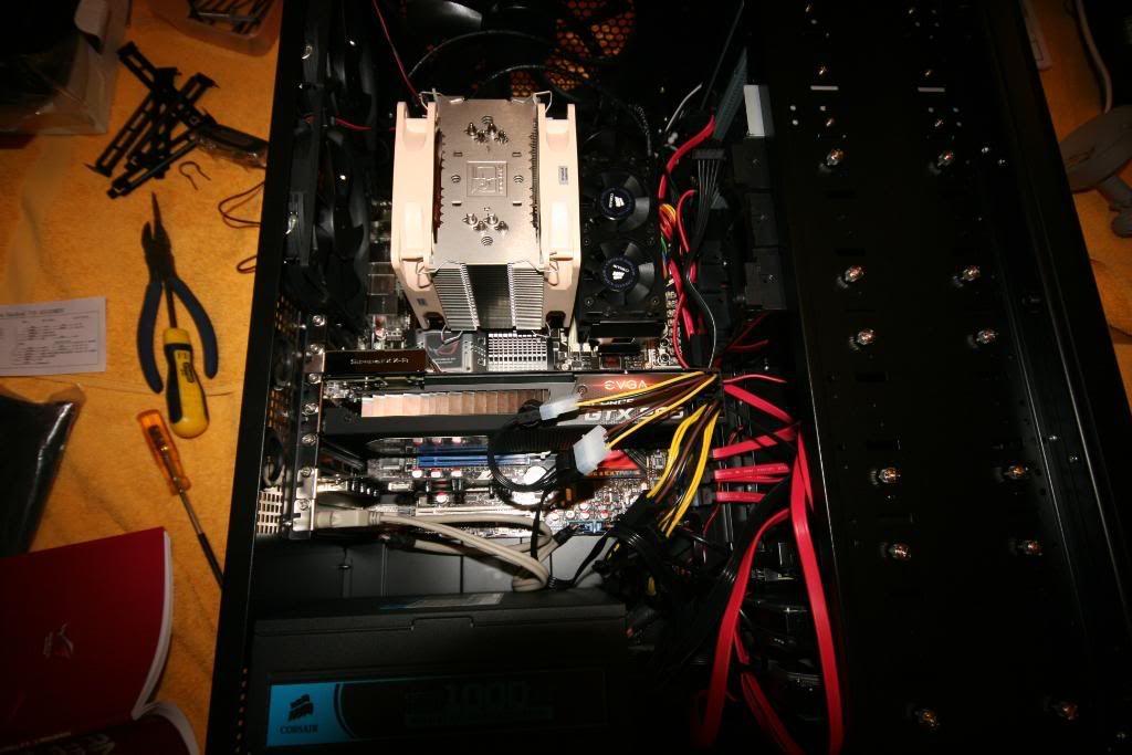

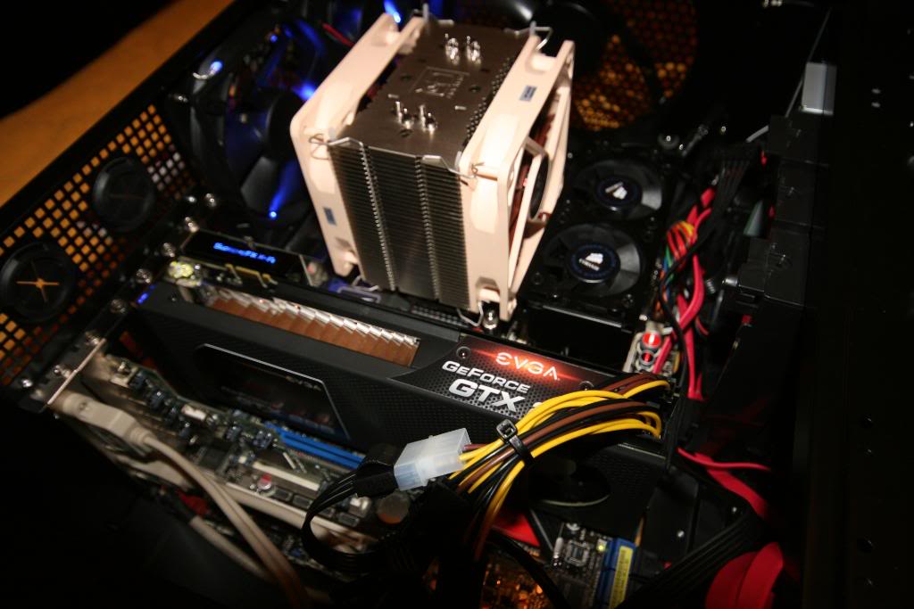

BTW why are you using those nasty molex to PCI-E leads? Does your PSU not have 6 & 8 pin PCI-E?

that look serious. nice built looks tidy and good way for cooling, not sure about the coolers on the memory, can't you just use a fan from the front of the case combined with the cpu fan (as an intake) to cool them, might produce better airflow.
same case me, very nice. that big one on the top really does help, took 5 degrees of my last case alone!
get coretemp up on that badboy and start monitoring, be good to find out what you're idling at etc.
I checked your PSU specs and it does have 6 & 8 pin PCI-E connectors. IMO you should really use these instead of the molex adaptors. If only for the reason that the wiring around the gfx will be far tidier. Not meaning to pick at your build, but it's definitely an obvious wiring error IMO.
Roy your completely right. Massive overlook by me on the PCI-E front :dapprove:.
First thing I will be doing tonight is getting that changed over, still cant beleieve I didnt even click when I was installing the GPU :eek:.

I will also see what my temps are and have a play around with benching with and without the Memory Cooler attached.
It may be an idea to pop a 120mm fan on the side pannel as this would be right on top of the memory anyway.

Fans are on low at present and I am happy with the noise level, going to monitor temps etc. The dust is better on the fan filters than inside the system. When I sell my old system I may look into Watercooling as I want to push the CPU/Mobo to around 4.1Ghz :)

Well I have yet to push the GPU yet as you know and esp making such a school boy error on the cable front that is the first thing I will be sorting out when I get back in.

GPU has now been sorted and did a bit more cable tidying :)...
