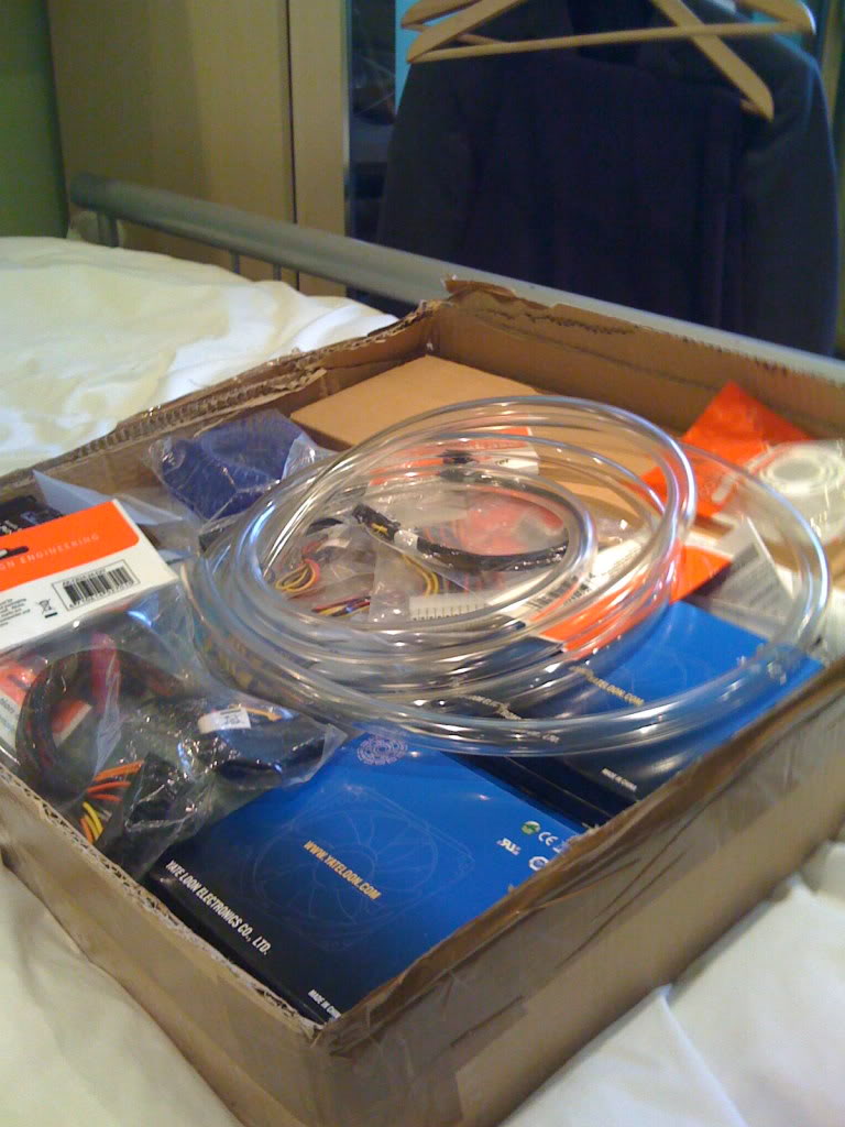

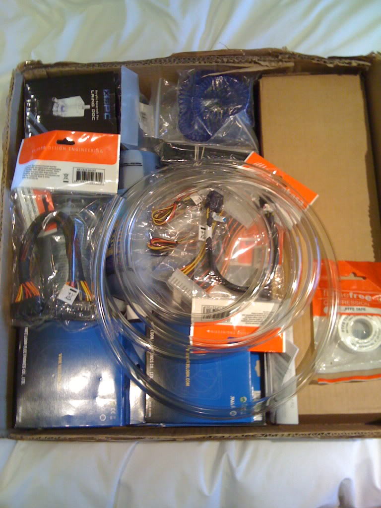

Nae bad cooling kit. Only thing is it seems you've got 8/10mm compression - I just had to redo my cooling loop (pump died, so whilst it was in bits I changed the hose and fluid) and if that's the really flexible stuff (Alphacool branded when it arrived) it was much thicker than any 8/10mm I've used previously and it made it difficult to get the compression fitting over the barb.
Other than that, all went well. I used the 2-bay XSPC reservoir/750l/hr pump, but I'm cooling graphics and CPU and plan to re-use this pump when I finally put together my dual GTX295 setup.
I have gone for Masterkleer 7/16" ID 5/8" OD tubing as it was highly recommended. I am using 1/2" barbs so it will be a squeeze but people say that works out better when it comes to leeks etc.
At this stage I really only plan the WC the CPU. Unless I get another 295 then I might have to get a bit more serious
BTW I did alot of research on various WC forums as I didn't have a clue when I started out and all the parts I have bought are highly recommended. Going to start putting it all together at the weekend, cant wait :clown:
