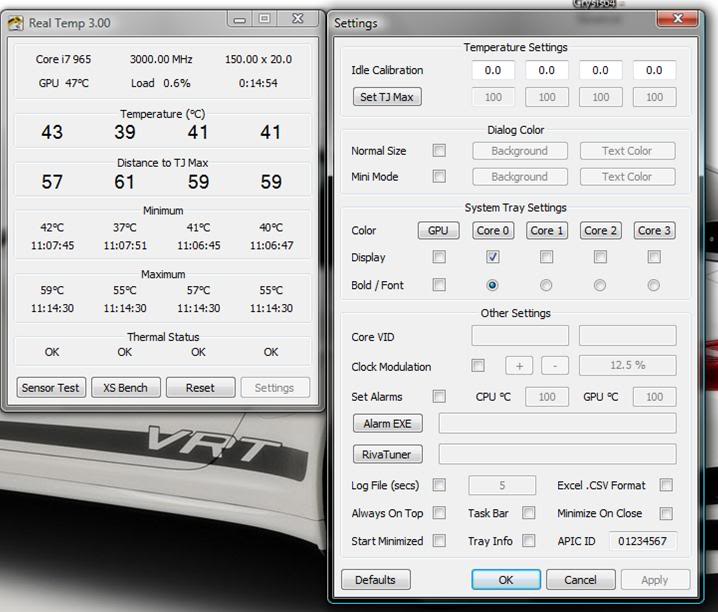

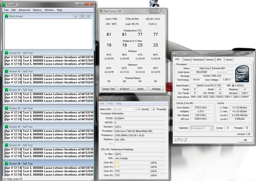

TBH I'm reading that i7 can run pretty damn hot. Most sources are saying keep it under 80. The tjmax is 100 btw. Set your tjmax to 100 in realtemp and monitor it for a while. It might take a few heat cycles for the paste to 'cook-in' anyway. What did you use? How much did you use? You only want the finest smear.
As far as cleaning goes - I always just use a piece of toilet paper to clean the old stuff off
I think I'm going to order a new HSF next week, and lap both the processor and the new HSF. I already know my QX will sail past 4Ghz as long as I can keep it cool enough.
Is the tjmax set correctly though? If not, then your readings will not be accurate. You need to be confident that the readings are as accurate as possible.
Yeah AS5 on quads should be the thin line with a slight twist once mated.
EDIT: ok. 85 is way too hot. Have you undervolted yet? You'd be surprised how much you can lower the vcore before it becomes unstable. Undervolting will massively reduce temps. Keep dropping it down - when it's too low you'll get core failures very early on in a Prime run. Then up it slightly until it's stable again.

Well, I'm no realtemp guru but AFAIK if the tjmax is set correctly, then that's accurate enough.
Definitely reduce the vcore until it starts failing in Prime95. Then, though, you may decide to overclock more...it's always a fine balancing act. Definitely not easy once you start getting involved in voltages.

BTW, the 'recommended' thermal spec for your CPU is max 68c. Under 80c you should be fine but, don't expect it to last 10 years 24/7 at those temps

Yeah. I would definitely try a reseat.
Have you got the vcore back at auto?
