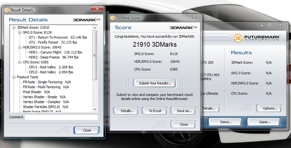

FYI I ran a very casual vantage the other day. It ran P19600. I expect yours to beat that by some margin. Don't get carried away with benches though IMO. It's a games machine, not a benching machine :)
I'll try it again on the ultimate run.

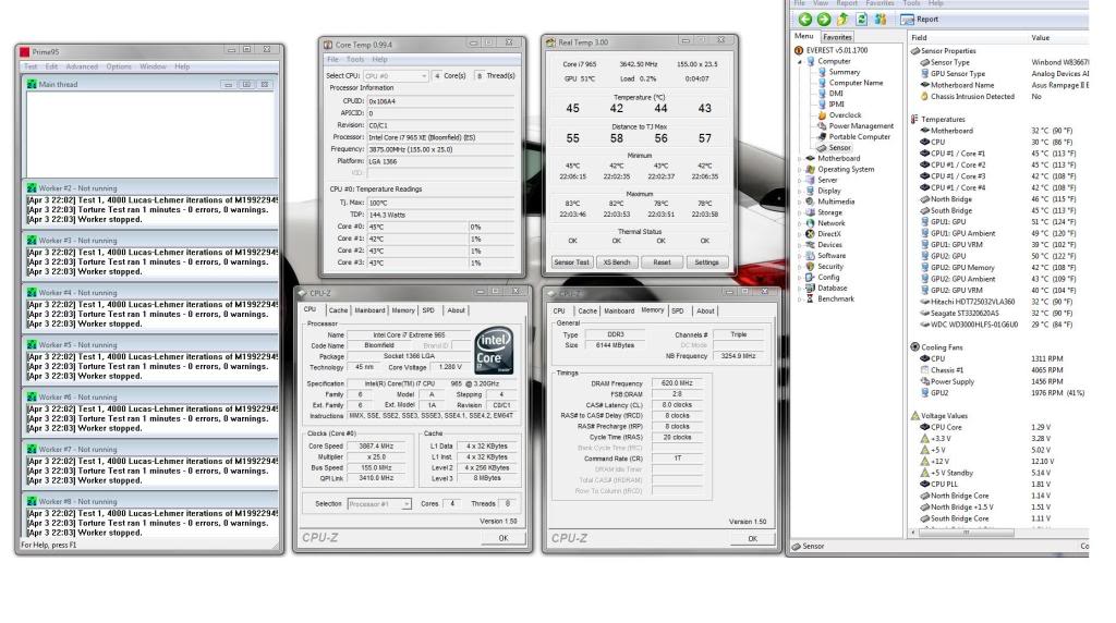

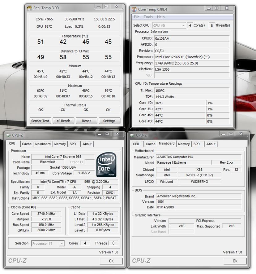

Well here is my first OC attempt.
POST and Windows boot was fine and I ran prime for around 30 mins..
The only issue is my temps mid 80's. Does this sound right?? or is it way to high?
Thanks
  Tesla MP3 2021
Sorry the screen shot was taken just after a 5 min run of prime. I forgot to do another during the main stress lol

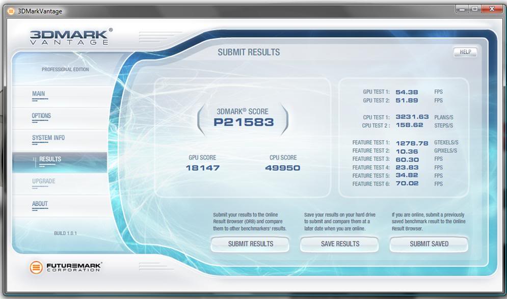

P21583 is good. I ran around P19610. Totally in keeping with what one would expect from that machine. I could try overclocking some more, and start OCing the GTX295, but TBH it's the games that matter.
You've got an epic rig there my man. Start playing the games :approve:
BTW your max temp is HIGH, and 5 minutes of Prime is not enough. You want to be stable for at least 12 hours IMO.

Sorry I ran Prime for around 30-35 mins, yes I know this still inst enough but I don't fancy running it for hours+ until I sort this temp issue out.
Firstly, make sure you find out the tjMax for that CPU and enter it into the settings of realtemp. If the tjmax is wrong, you can't rely on the readings.

Is that done via a sensor test?

t**t had it on the wrong tab on the 2nd CPU-Z screen. You can tell its 1am lol
