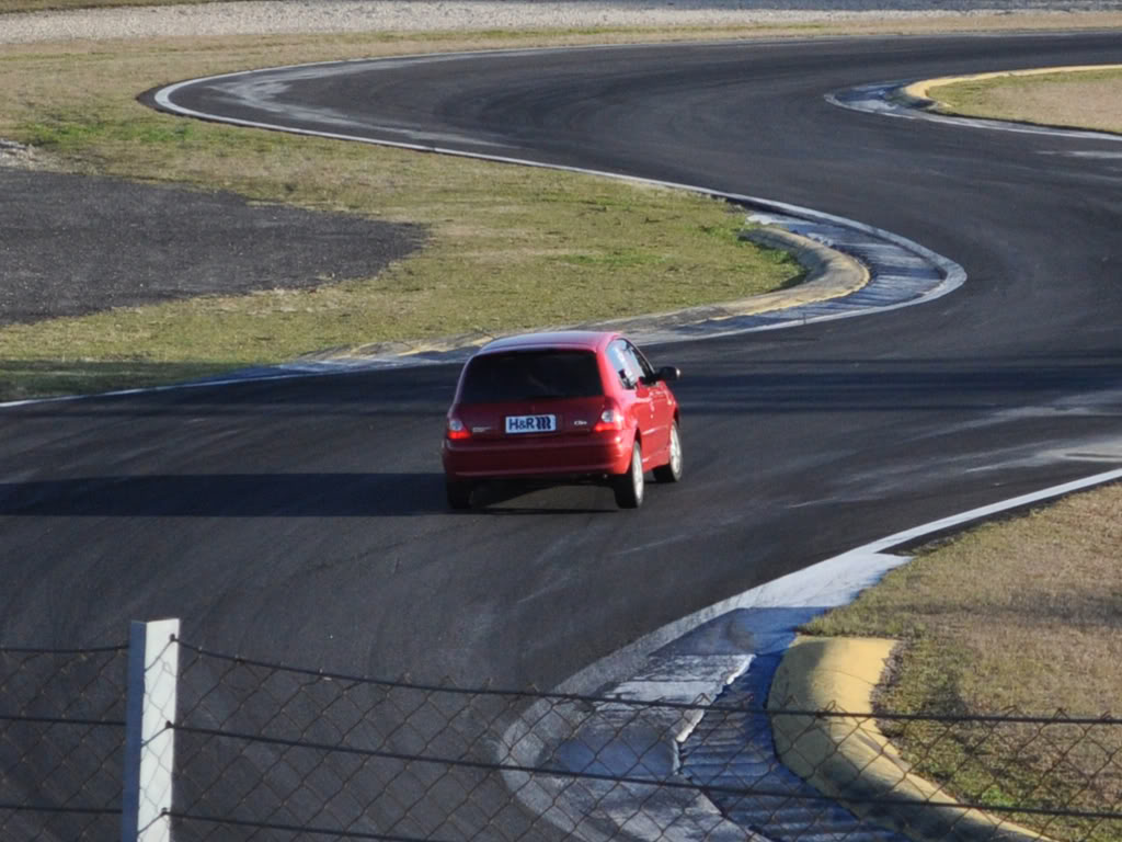

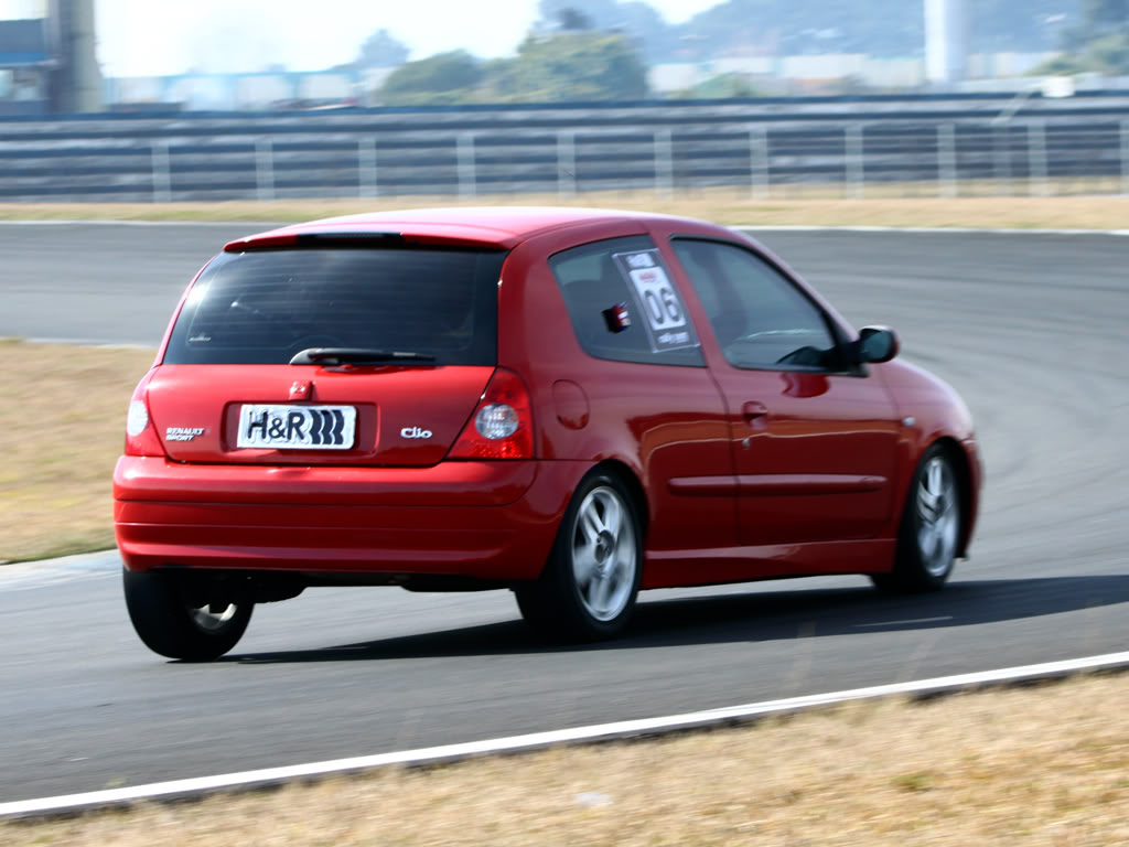

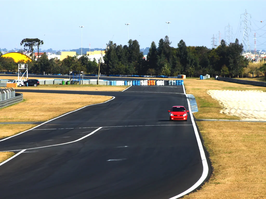

Hello everyone! Got some pic from the last trackday here in Curitiba, Brazil to share...
I am currently running Sportlines with uprated dampers on my Dynamique, but with slicks the body-roll seemed immense.. I am planning on getting Powerflex bushes and a Whiteline rear ARB. Do you guys think that'll be enough to keep the car planted or will I need to shell out some more for coilovers (note that none are for sale here in Brazil so I'd have to import them from the UK, paying costly freight charges and custom taxes)

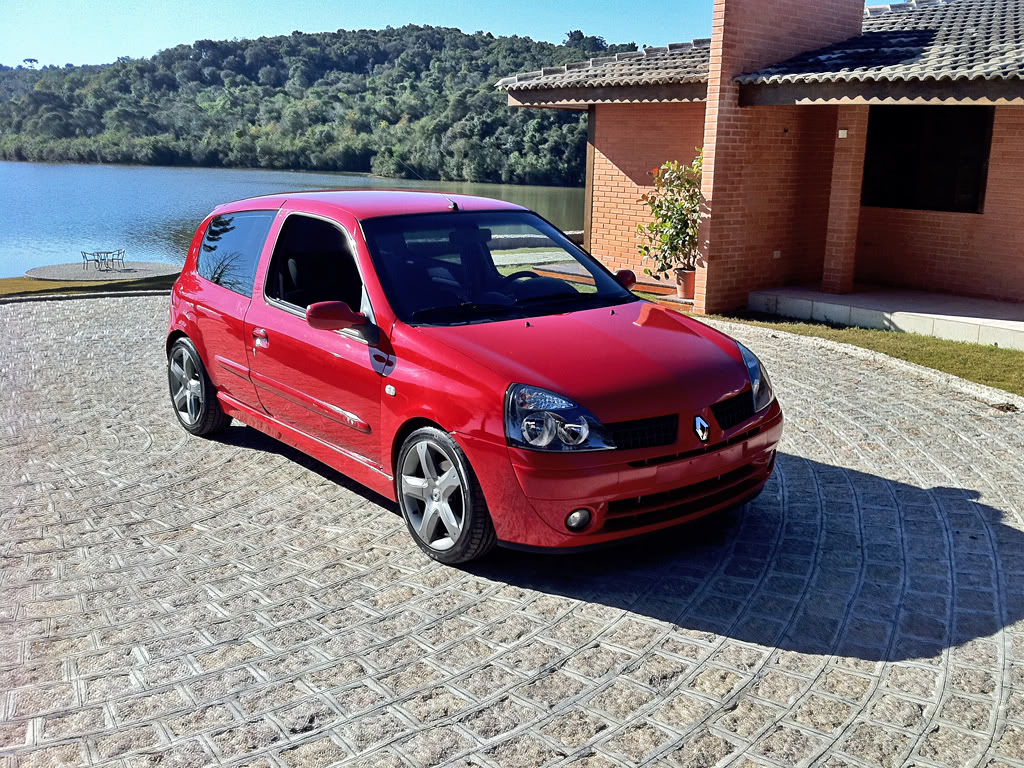

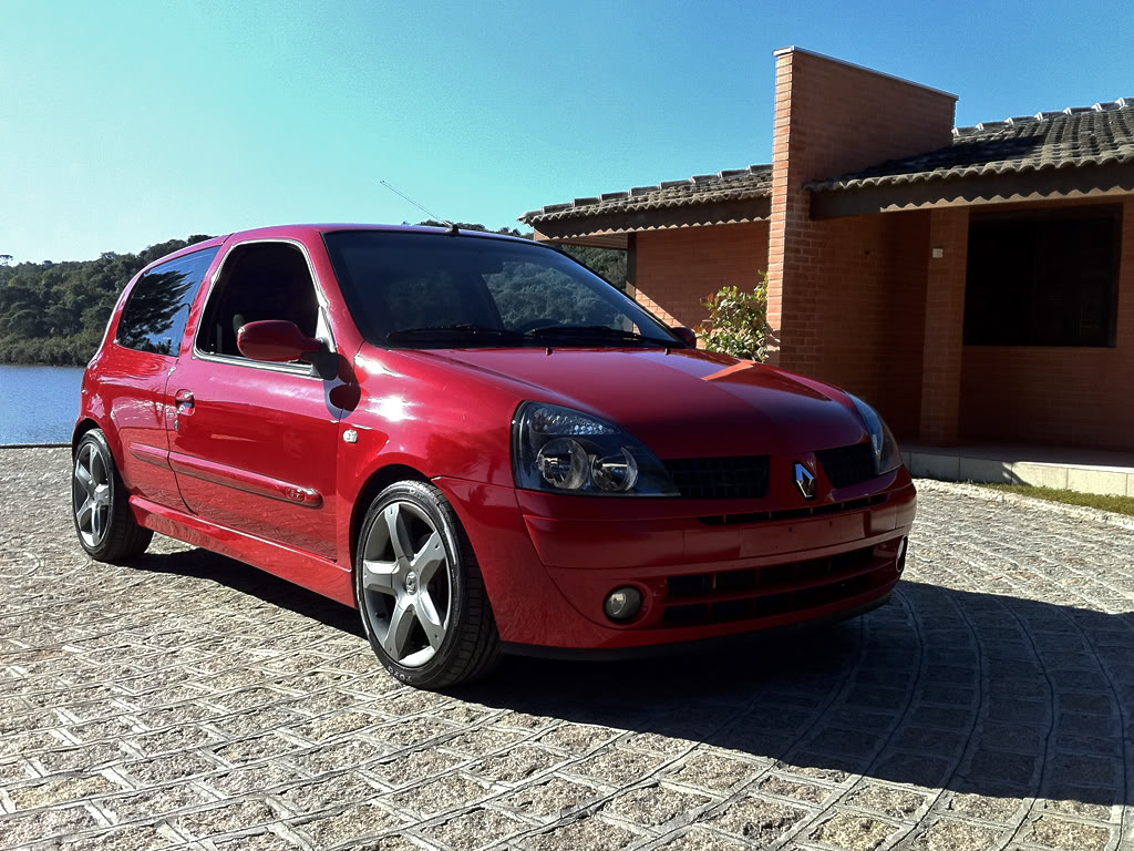

Hi. Some nice pictures right there and the car condition looks great. Sadly I do not like the skirts and the wheels.
Yeah I'm not the greatest fan of the skirts either, but since there is no RenaultSport down here there is no way to get ones like in the RS models. This was infact the OEM skirts that were supplied with the Dynamique here.. One day i'll try taking them off to see if it looks better..
Roll's not a bad thing! A whiteline is a good idea also.
You could always try extra camber on the front, should help with cornering without killing the outer edges of the tyres.
I've set camber to -1.5 (all I could do with the special bolts), but that is not nearly enough I guess.. Maybe a camber plate can help me with that..
get the front to about -3deg camber and maybe look at increasing the front track with spacers, stiffening up the rear as much as you can and polly bushing everything will help too.
if your still not happy then its time to look at a higher lbs front spring rate.
Thanks for the tips mat!
seems like i'm on the right track then.. Already purchased Powerflex bushes, and will get a Whiteline ARB to tighten up the rear.. Also I'm running 15mm Eibach Pro Spacers in the front and 25mm in the rear, so track is mostly OK. Maybe some ET38 rims for my slicks like my 16"s would give that extra edge..
Now I need to figure out how to achieve such a negative camber.. keeping in mind that modding parts for Clios here in Brazil are near impossible to find..
