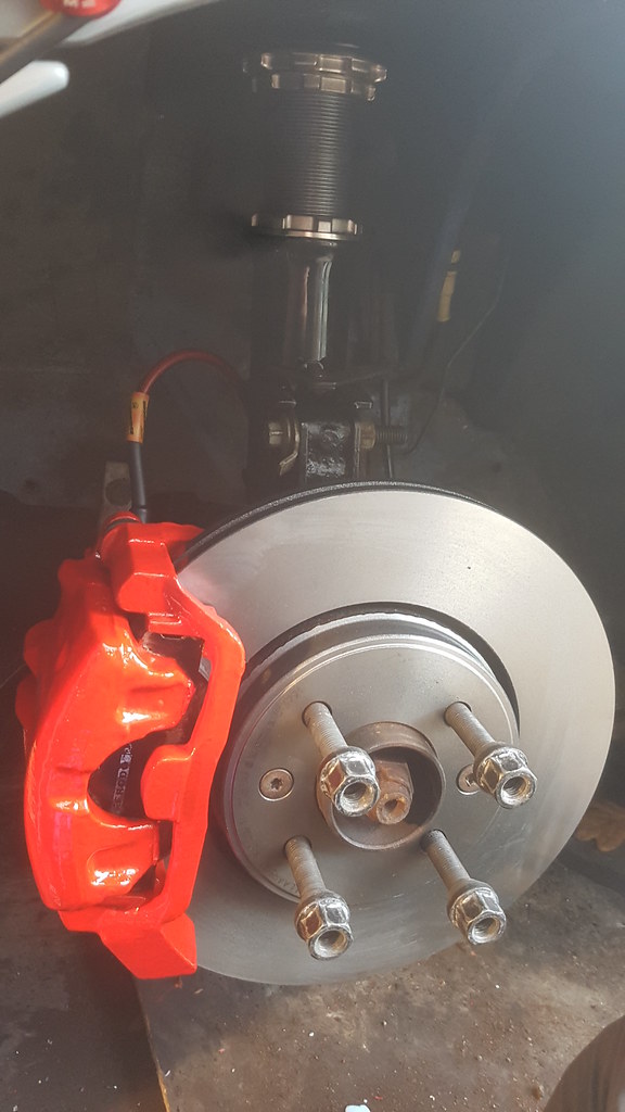

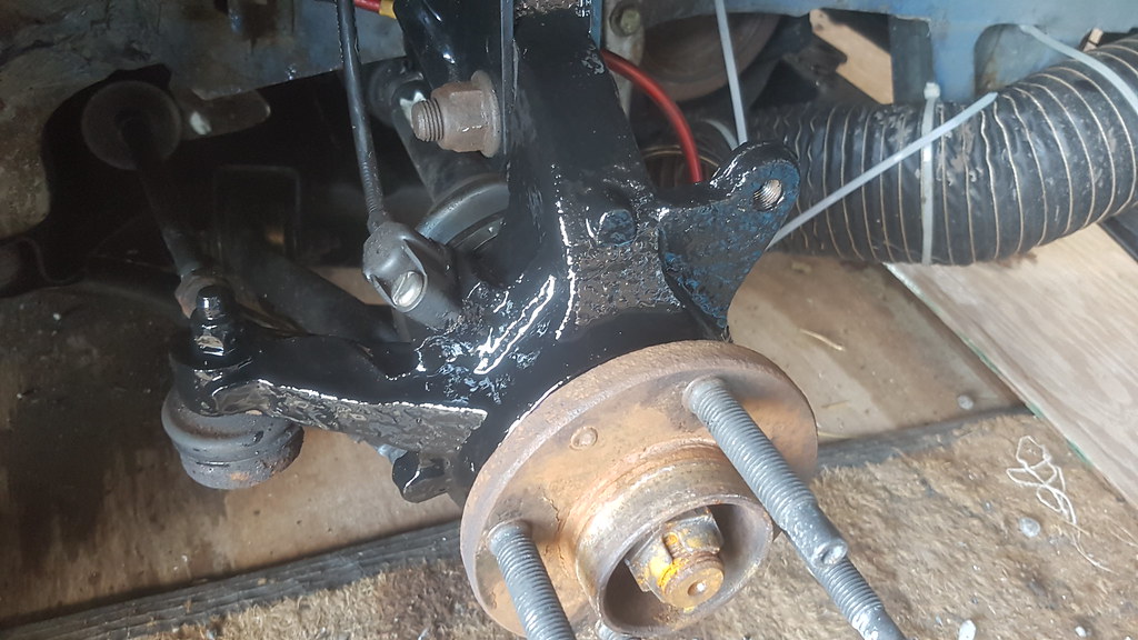

Removed the old front brakes, and while I was at it gave the hubs a wire brushing and coat of Hammerite as they were looking a little worse for wear.
Fitted the new front discs, DS1.11 pads and refurbed the callipers.

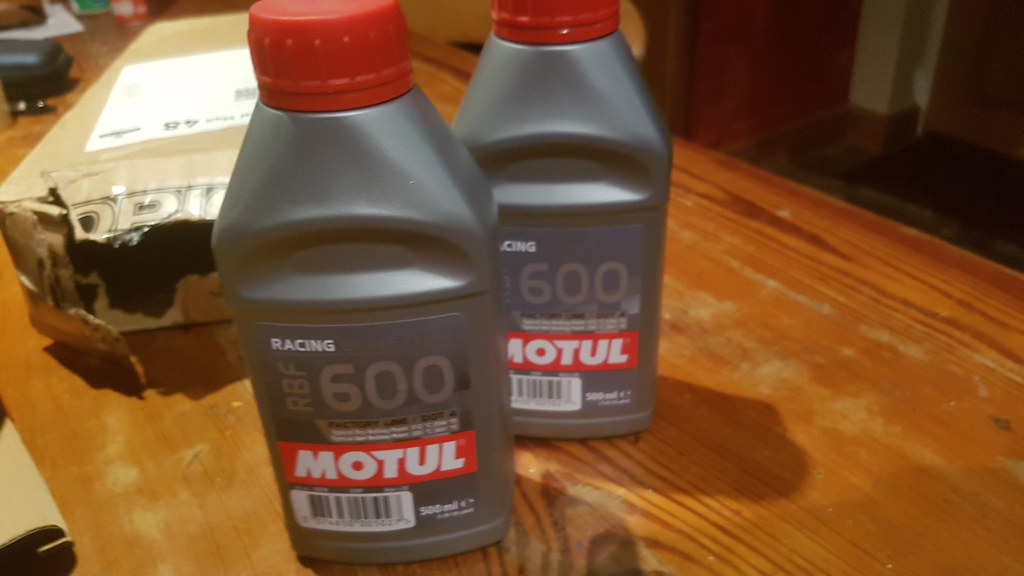

Gave the brake system a bleed with some fresh RBF600

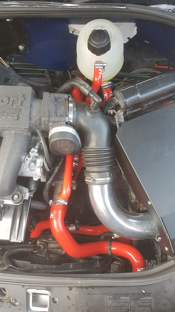

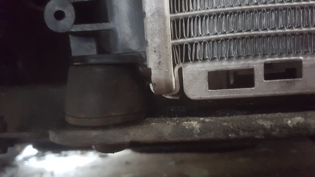

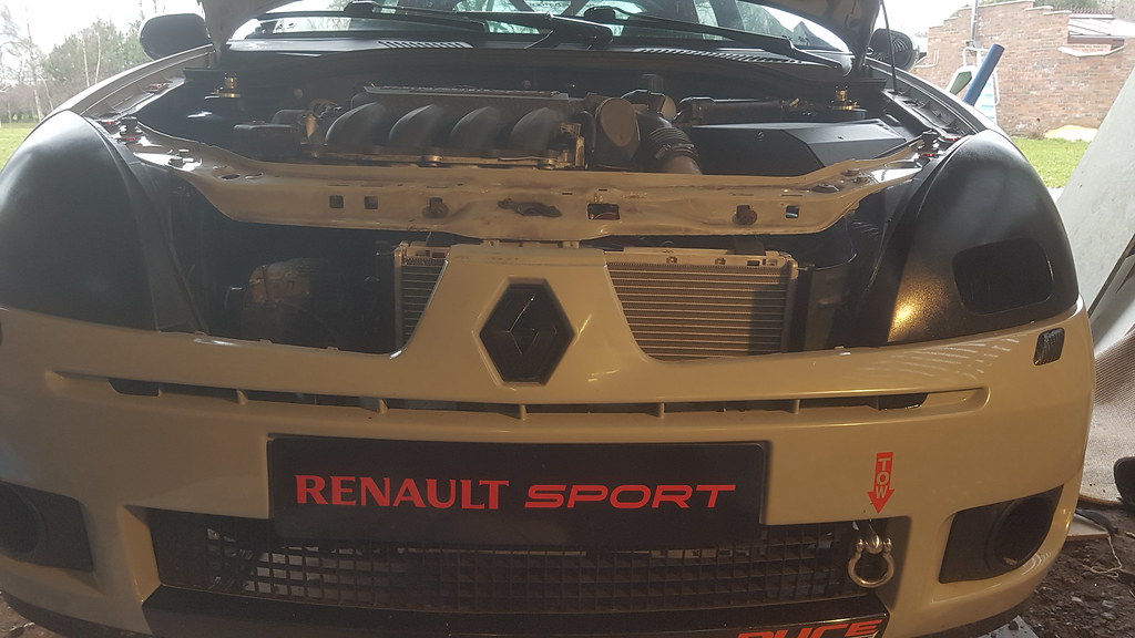

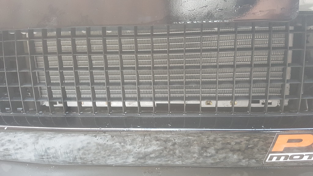

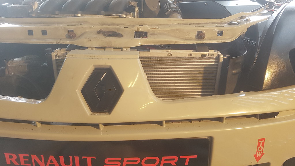

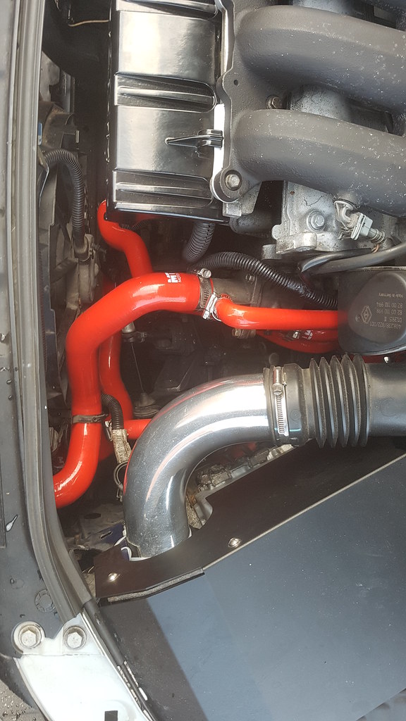

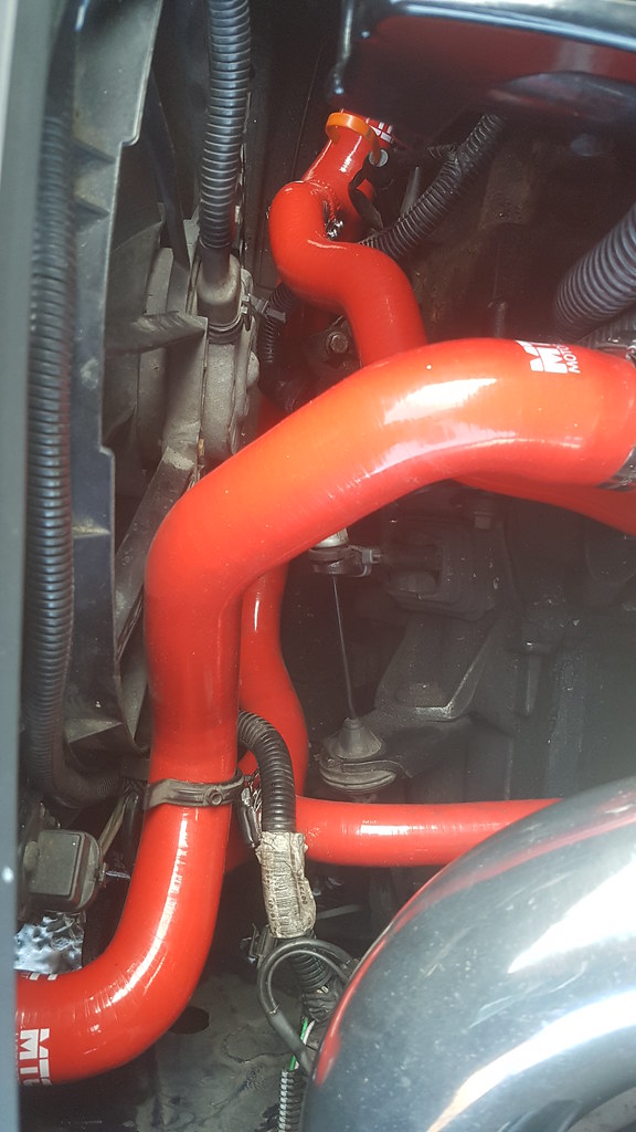

Fitted the new OE rad and silicon hose kit, due to the old rad dying on me
Sourced some rubber feet for the rad as I didn't have any previously
Hoses

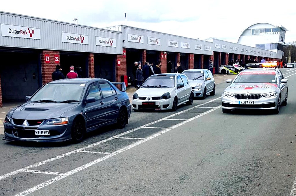

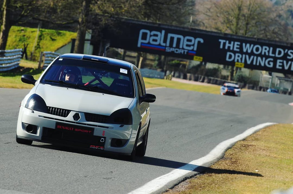

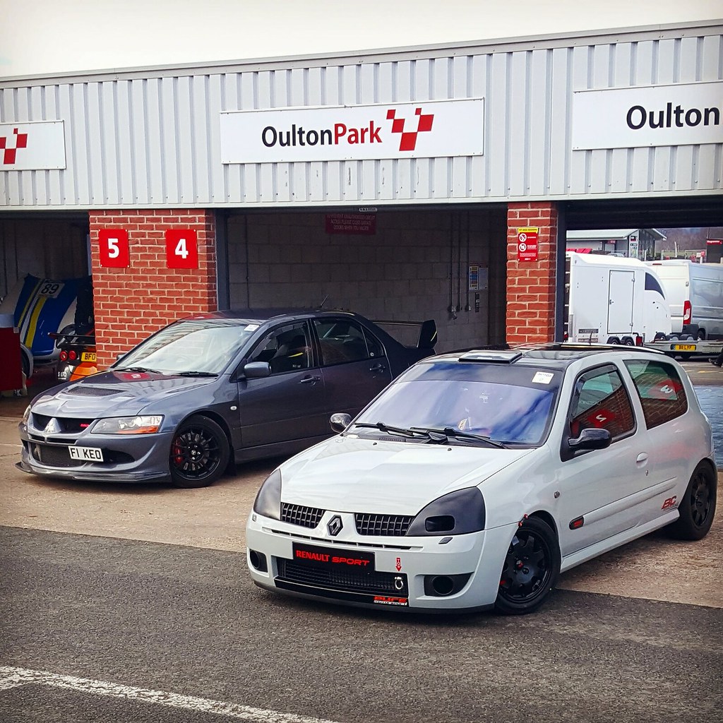

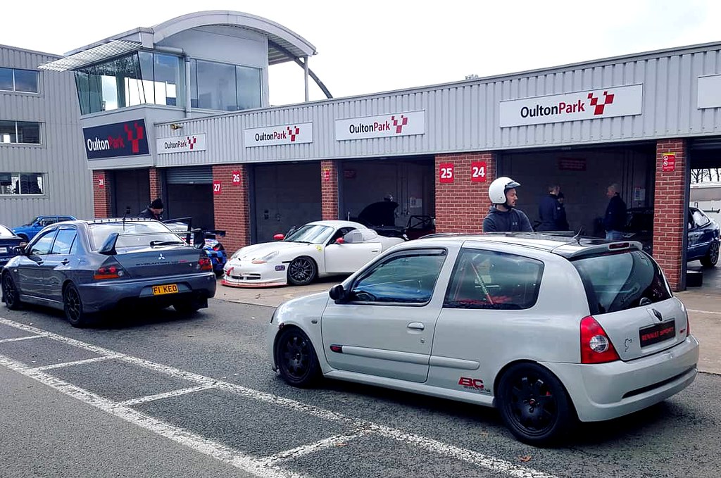

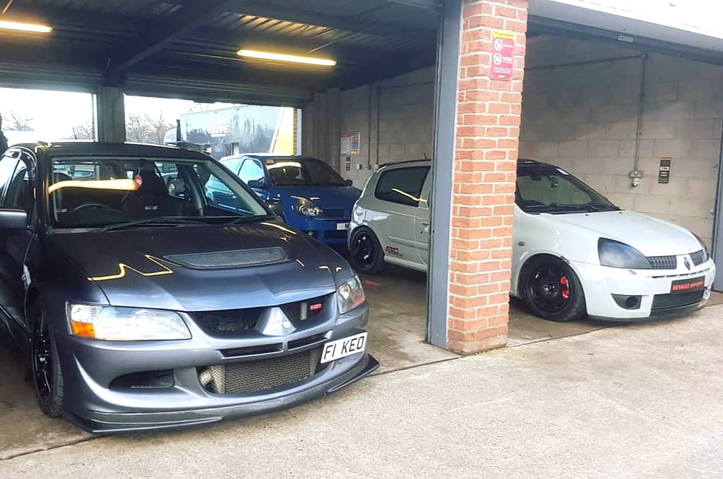

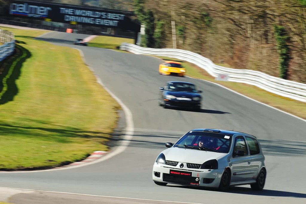

Managed to get everything sorted in time for a day at Oulton Park. Was there with a couple of mates, one in an Evo 8 FQ340 MR and the other in an RB 182.

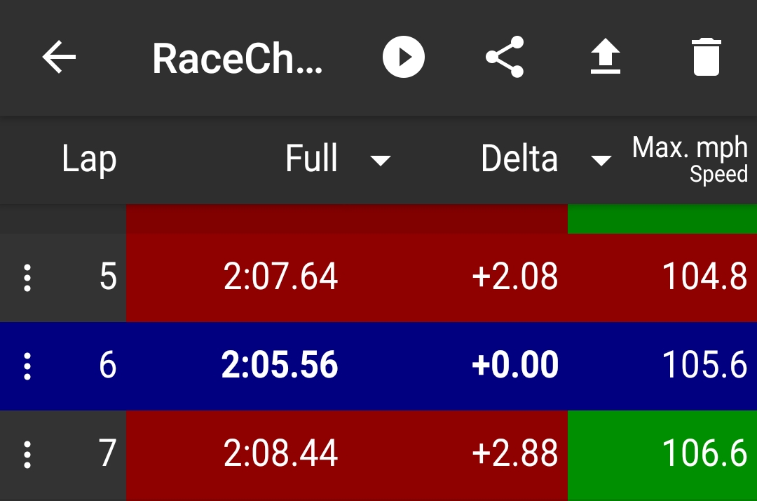

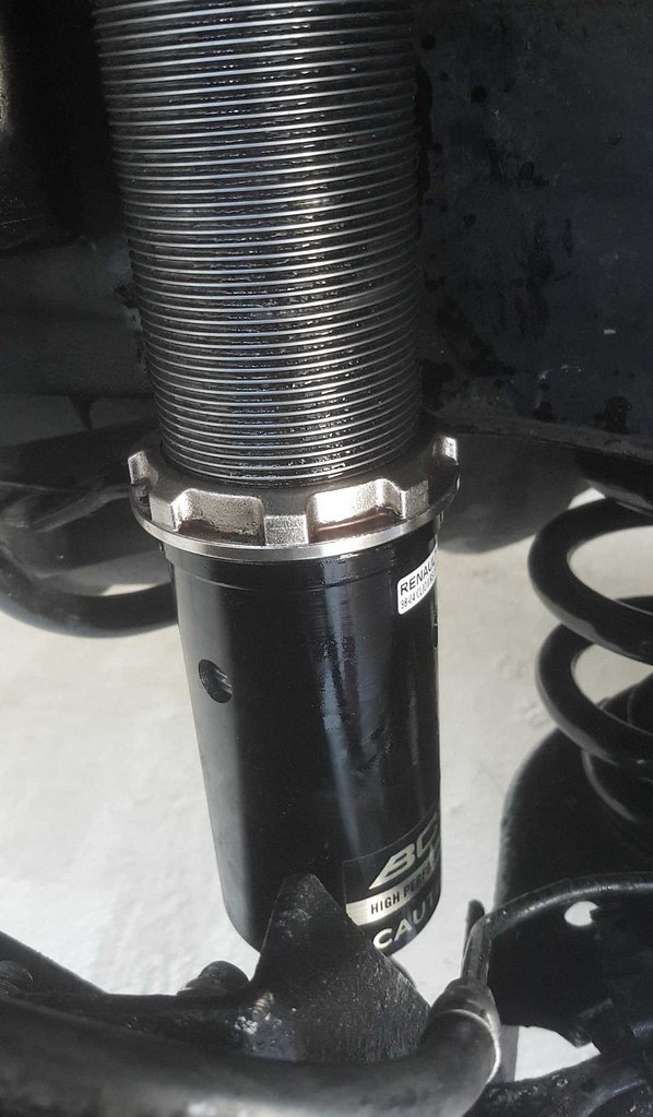

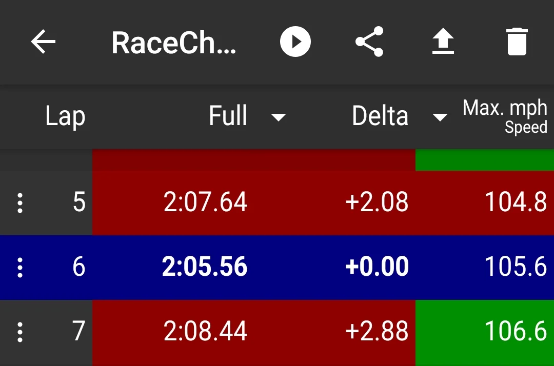

Was a mega day, the coilovers and more aggressive camber have transformed the car. Quickest lap of the day was a 2:05 which I was chuffed with, which is a massive improvement over the old setup.
Awesome write up, I really like how you took what was already a unique car and built upon it, the spec is impressive, what do you have planned next?
Looks great! Was that a 2.05 around the full Oulton circuit? That's extremely good if it is. The only Clios in my race series doing those times are very lightweight and running cams and ITBs at least! If it is you need to come racing!
Yes mate, that was the full circuit. I was happy with that time, Im confident I can take a bit off that once Ive sorted this arch rubbing issue as it was very off putting. With slicks and a diff Id like to go quicker again!

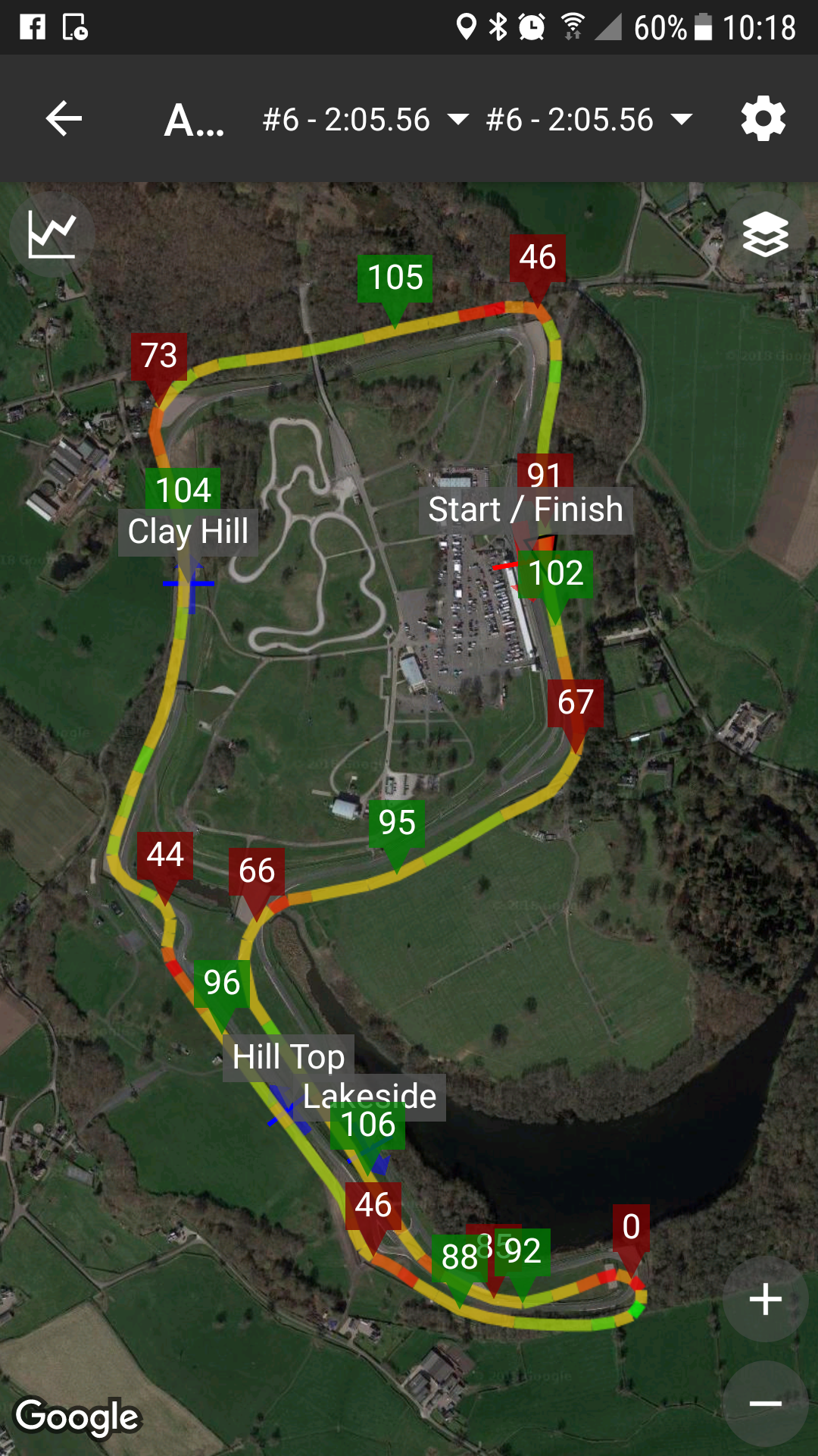

View attachment 1359492 View attachment 1359493
Very good. I've only been to Oulton once (not racing) and my best time was a 2.08 so it's interesting to compare the telemetry. You're just a couple of mph faster in most areas which makes all the difference. It looks like you know the circuit too!

You could’ve just replaced the rad, but you’ve chosen to upgrade the pipe work too. Things like this are great to see!
Also... software for track! What the hell os this awesome bit of kit!

Appreciate the kind comments. Yes I thought it made sense to replace the hoses at the same time, as they are original, and could easily fail on a trackday and ruin the day. Same goes when removing old bolts, I like to replace with new.
The software is an app called racechrono, its a free download on android, but I think its 18 quid on iPhone! Either way its brilliant, gives you live lap times when youre on track - best, current and previous. (I know youre not meant to time but ah well)

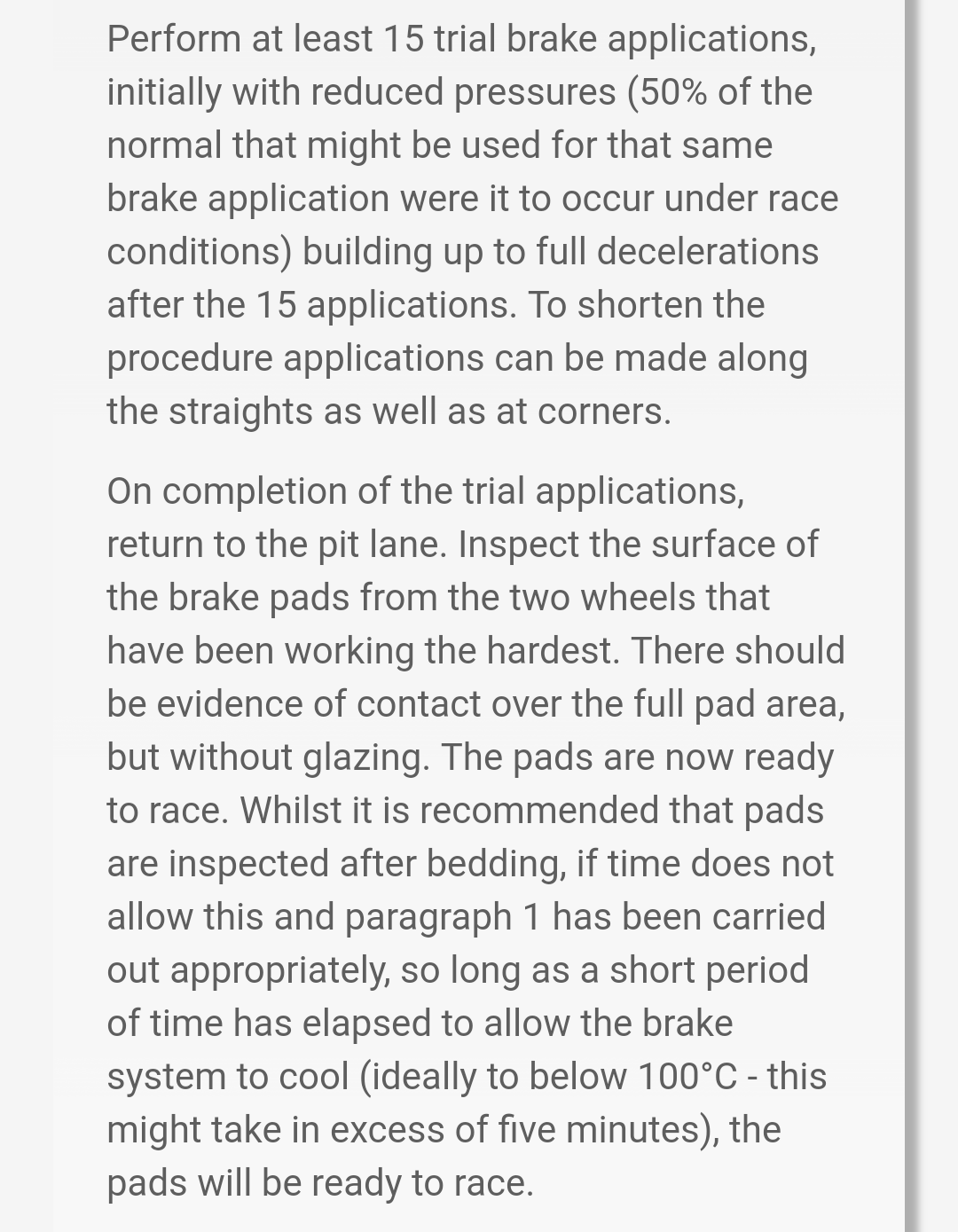

How did you get on with the DS1.11s and how did you get them bedded in? It seems like you need to get them unbelievably hot as part of the bedding in!
The ds1.11s are epic mate, cant recommend them enough. Only thing I would say is be conscious of your session time on track. You wont get any fade but I found that the discs took a beating.
Bedding in wise, this is the process to follow

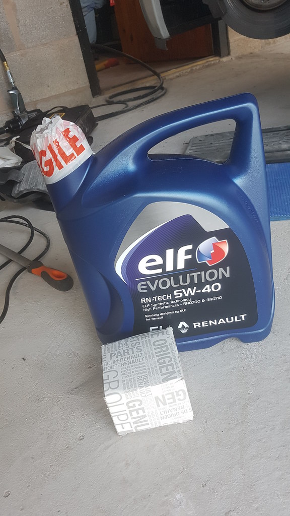

Gave the car a service in sub zero temperatures, but needed to be done

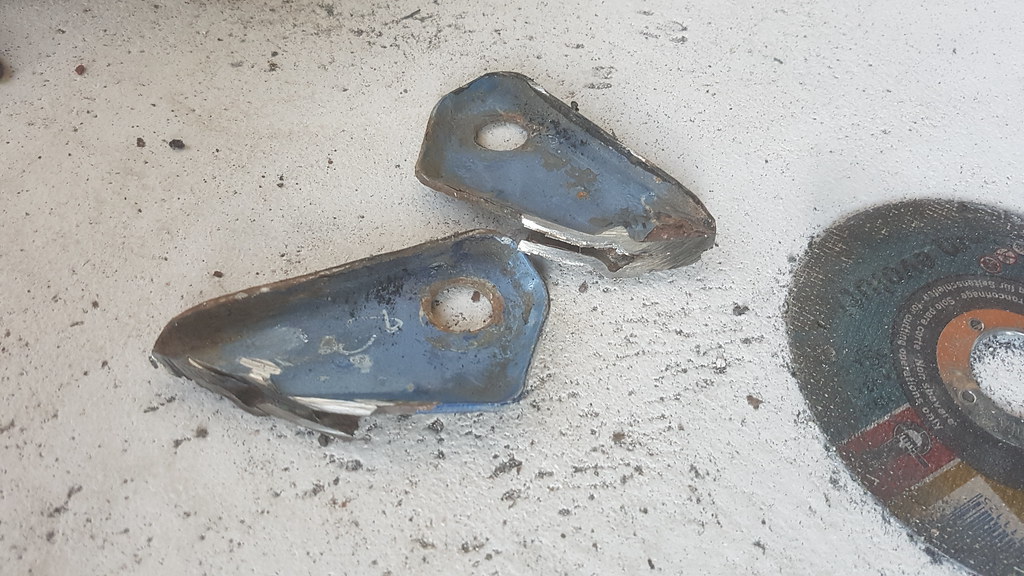

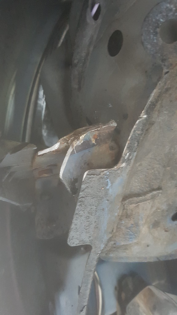

Found that with the car on coilovers I was getting a lot of catching under hard load, so out came the angle grinder, and off came the bumper brackets
Then painted with hammerite to prevent the formation of any rust.

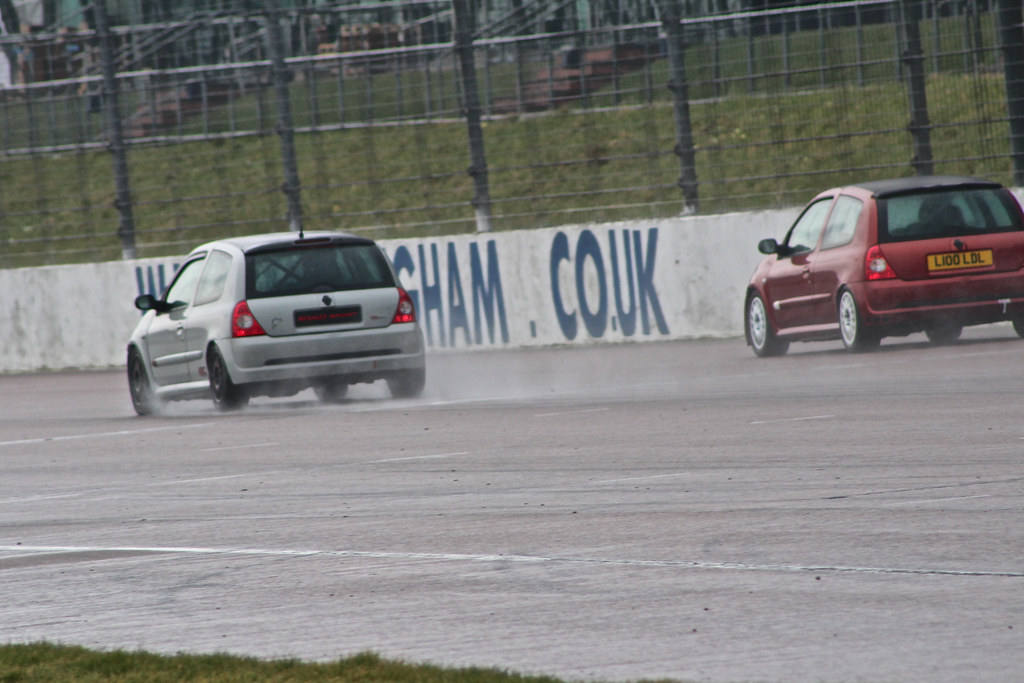

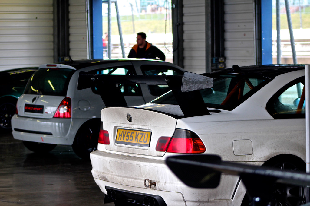

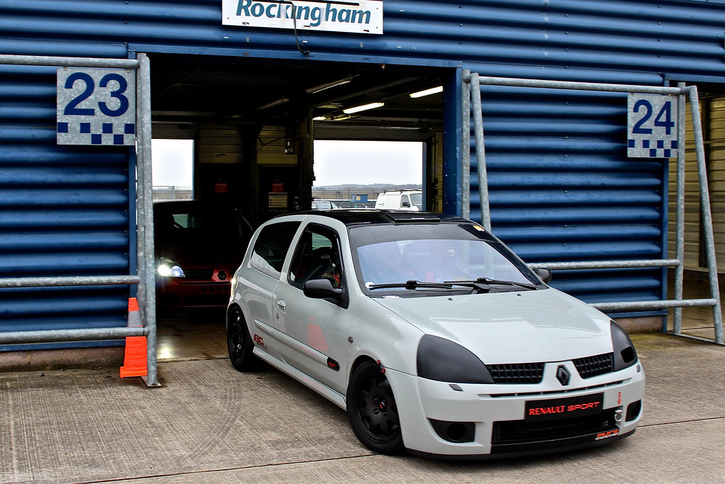

Then we were at Rockingham, which was my first time there so wasn't really sure what to expect. The day was organised by an instagram group called #TrackAddict, and there were some seriously modified cars there!

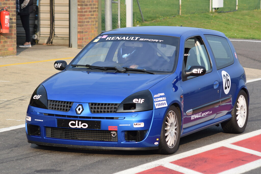

Met a fellow clio owner @Luigid1984 with a very nice Flamer, and we had some mega battles.
Rockingham turned out to be the best day Ive ever had on track, lots of sideways action in the morning as it was super greasy, and then dried up in the afternoon to put in some quicker laps. Plenty of cars to play with too. Was the first time out on the R1Rs in the wet too and was very impressed.
