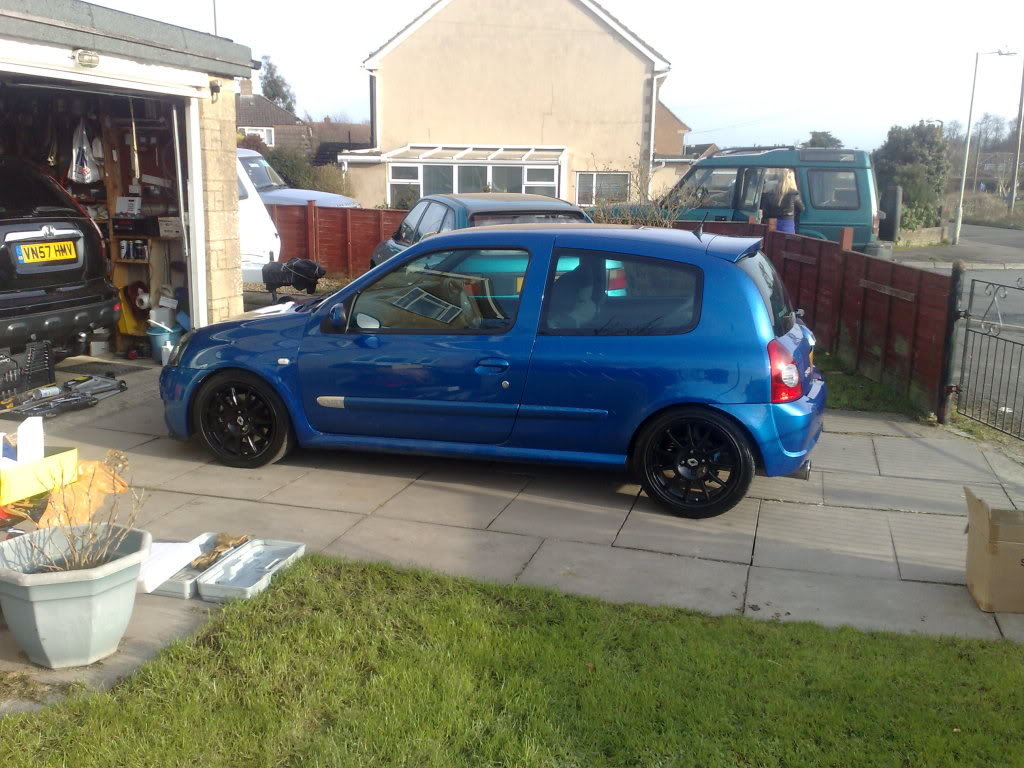

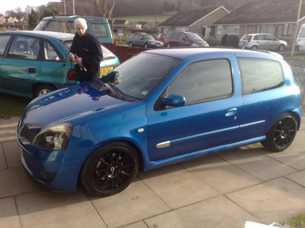

well did mine today along with a new set of front strut mounts heres 2 pics as it just came off the jacks ill get some more later when settled and clean lol
Anyway, my experience is you get what you pay for! They will be ok, do what it says on the tin!
But the difference will be like between a michelin and a nankang tyre!
Just leave them be mate. They will do what it says on the tin end of, and for how long... who knows... but for that price does it even matter.
No one should start hassling K-tec or any other company for that matter, they don't need to justify anything. They are not a charity and re-branding another manufacturers products is not a conspiracy.
They are cheap that is for sure. £90.00 trade for a set of height & damping adjustable coilovers... if it's too good to be true... that's barely material cost if you ask me.
  Megane 225 Cup
top mounts were free lol my mate bought somre before he sold his v6
(yes they are the same as mine)
and to replace them was no extra time as it had to come off anyway
also i now no longer get the creak from the top mounts that most clios suffer from
