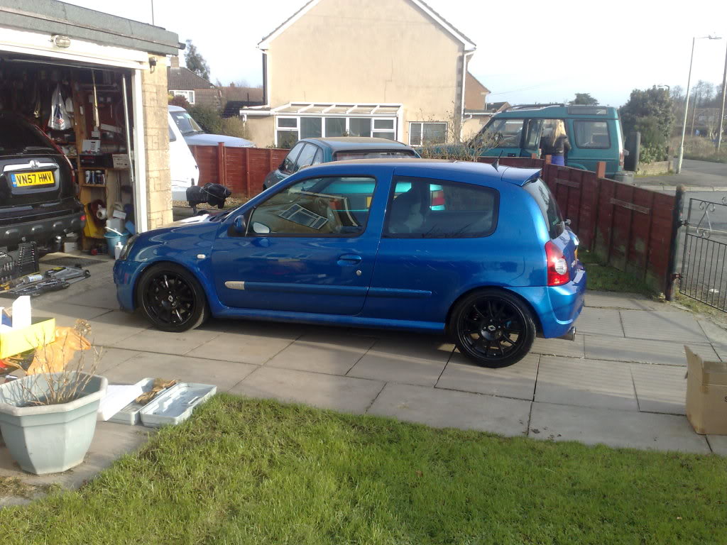

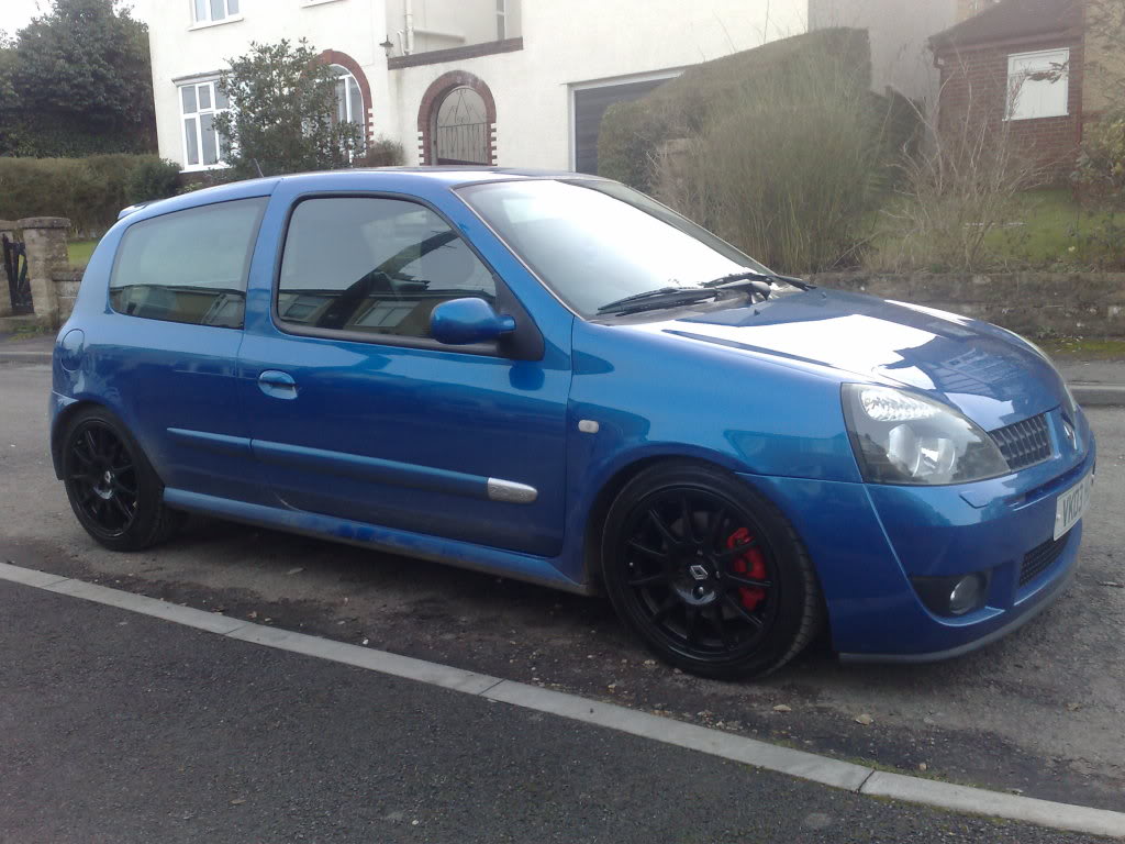

well did mine today along with a new set of front strut mounts heres 2 pics as it just came off the jacks ill get some more later when settled and clean lol
Looks very nice that. Personally I'd have mine set very slightly lower at the back, but as you said they haven't settled yet so once they do it'll probably drop a little bit more anyway.

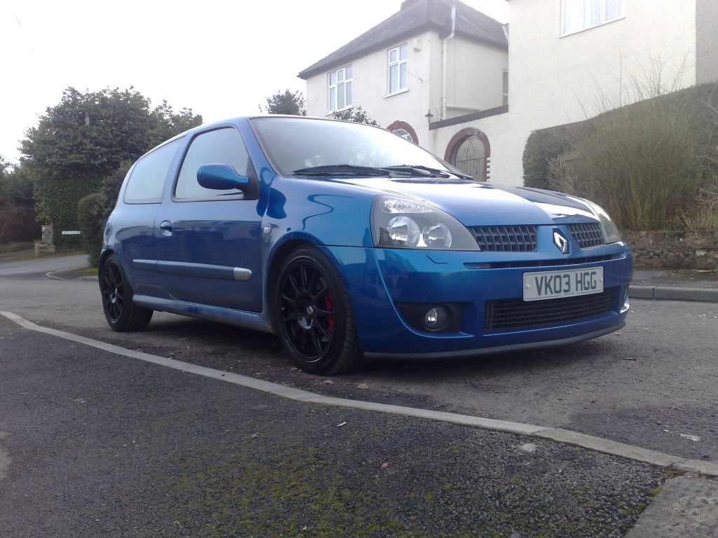

Yes its dirty (had teh camber and tracking done today and it really feels like it handles beter (could be in my head )
i wanted the original nose down stance asn this is how it is

10cm from bottom adjuster to the bracket with the thread in it (fronts)
rear all the way down adjusters still in
  Megane 225 Cup
i tightened teh camber bolt to as positive as it would go then a smidge back negative , but i had my car lazer alligned today before i did any speed around corners
it handles beter than my eibach pros (standered dampers)

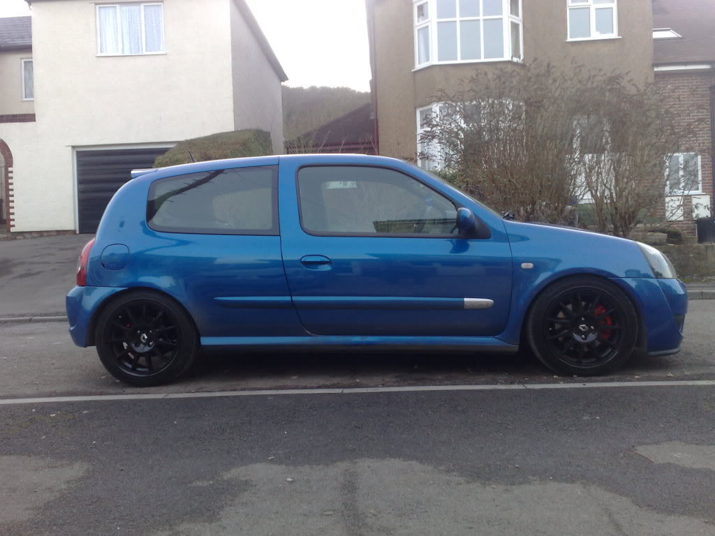

After a few days use, I raised the front of mine half an inch again last night to eliminate the rubbing. Rears are still set to minimum.
  172, Tiguan
Not trimming anything, I'm not selling the car in a year or so with holes bits of plastic.
I've just raised it to the point where it's not catching there.
