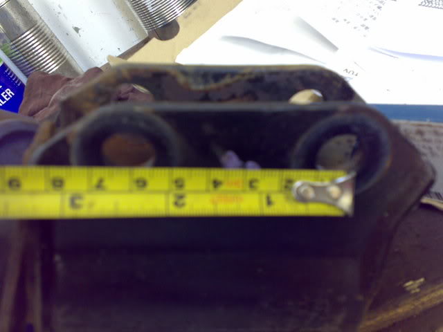

If you do want to get technical or 100% sure remove a front wheel and measure the bolt spacing on the hub. Cup suspension is 54mm IIRC.

Sure fire way is to measure the bolt holes where the strut bolts to the hub. Should read 60mm. Will have to whip a front wheel off though.

Just jack it up, squeeze under and measure the distance like the picture above, or get it on a ramp..
