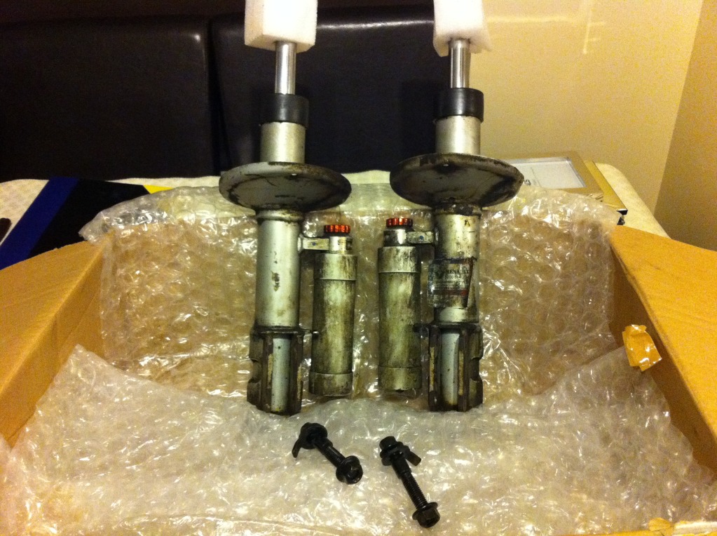

Started collecting bits for the 182's full suspension refresh... ;)
Trophy Sachs front dampers and Eibach camber bolts. The sachs need a rebuild but they'll be sent off at payday to BG motorsport to be refreshed and depinned, also collecting a brand new set of Koni adjustable rears off Sir_Dave tomorrow. So half way there with regards to the parts, will gradually have the rest by the end of March if things go to plan.
