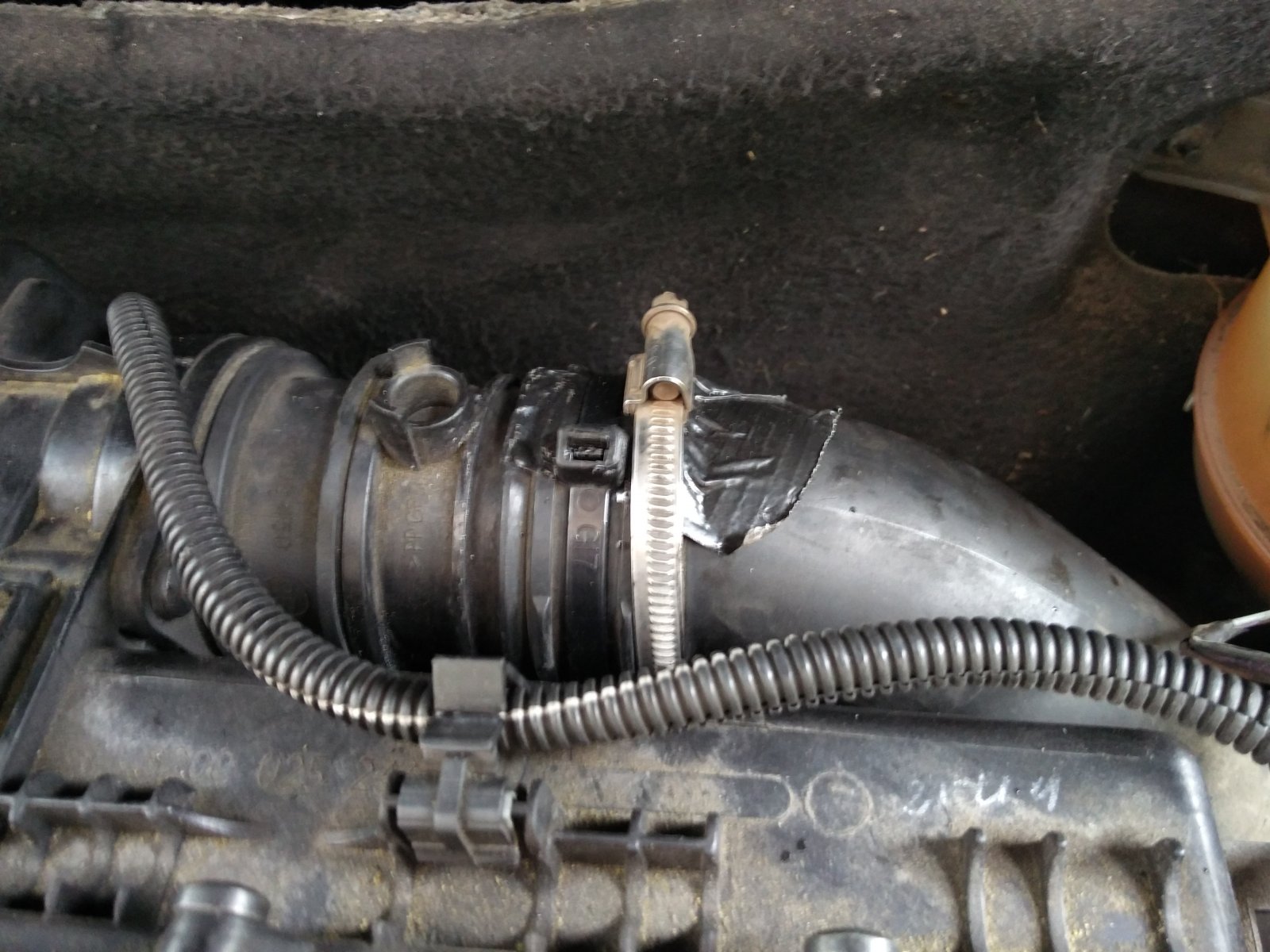

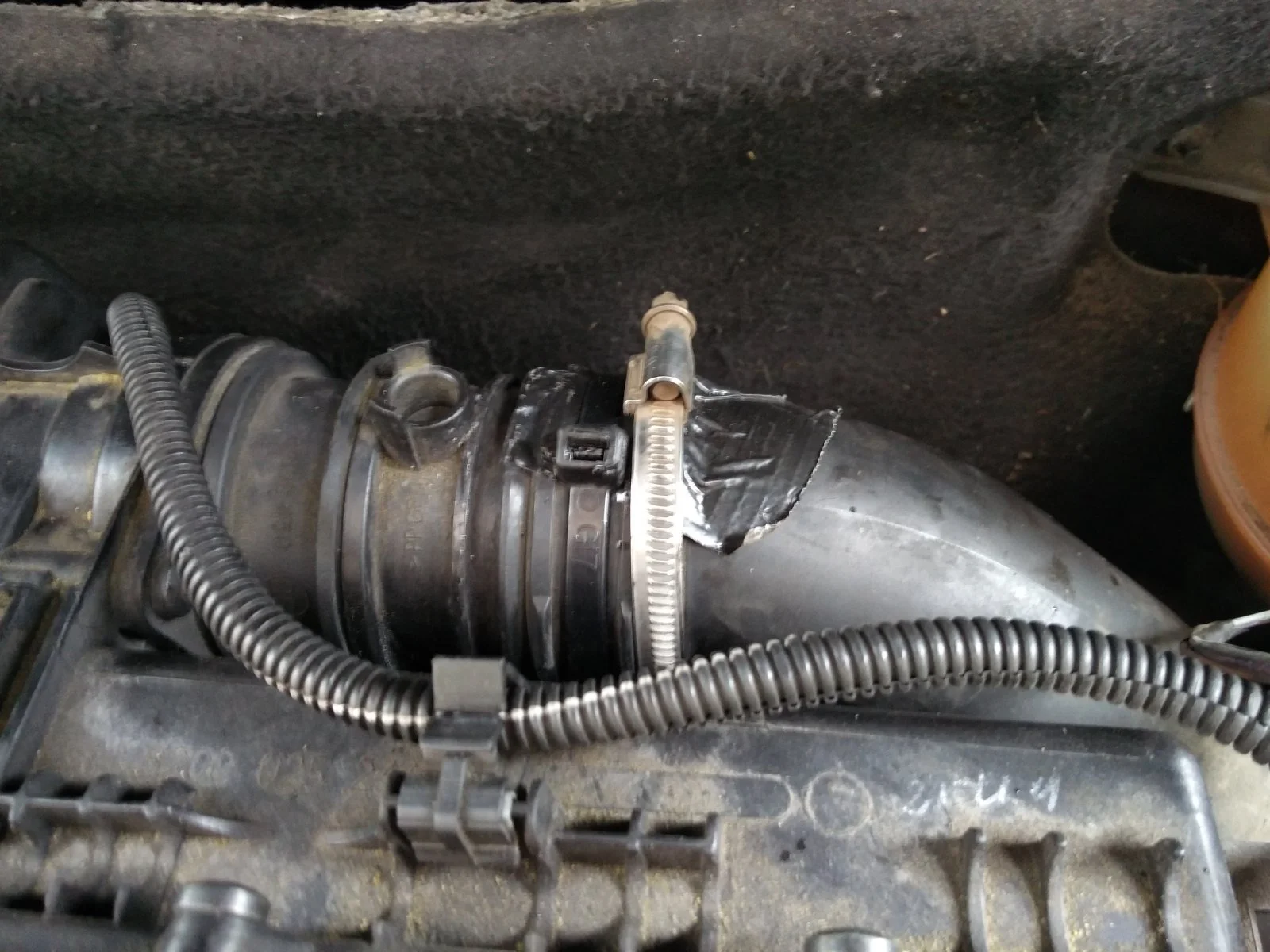

The silver fastner thingy, should there be one on either side of pipe? Or just at the top? It might not be it but it was loose and at the bottom. The top has been secured with a cable tie oh and the tape is as there was a split there (trying to temporarily problem solve!!)

Should only be one jubilee clip as the other side screws into the airbox. A split certainly won't help, and from memory shouldn't there be a sensor in the hole to the left of jubilee/tape temp repair.
I'll have a look at the mrs dci when she gets home to double check for you
Never had a sensor there, if there should be one, it hasn't made much difference since owning it from 2010! Have removed the cable tie and tightened the jubilee clip, it's mad a tiny bit of difference but will try and get it to the garage as soon as I can.

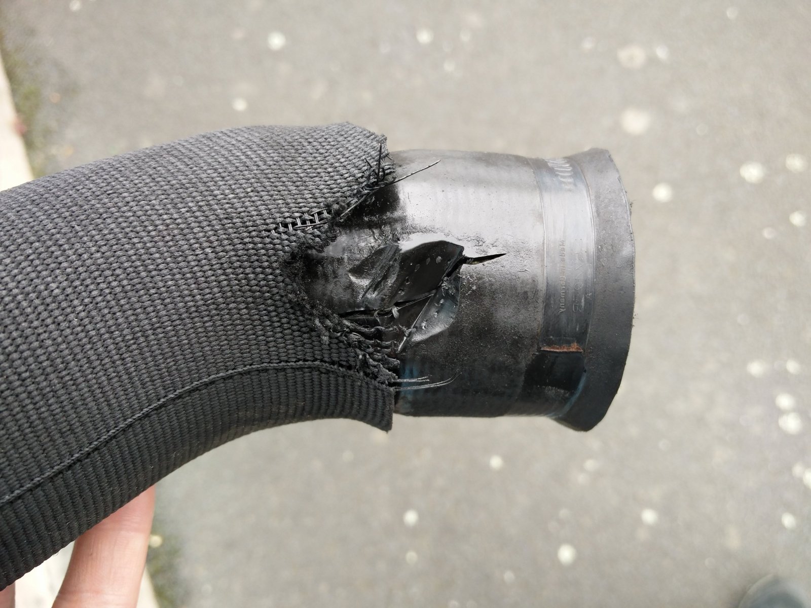

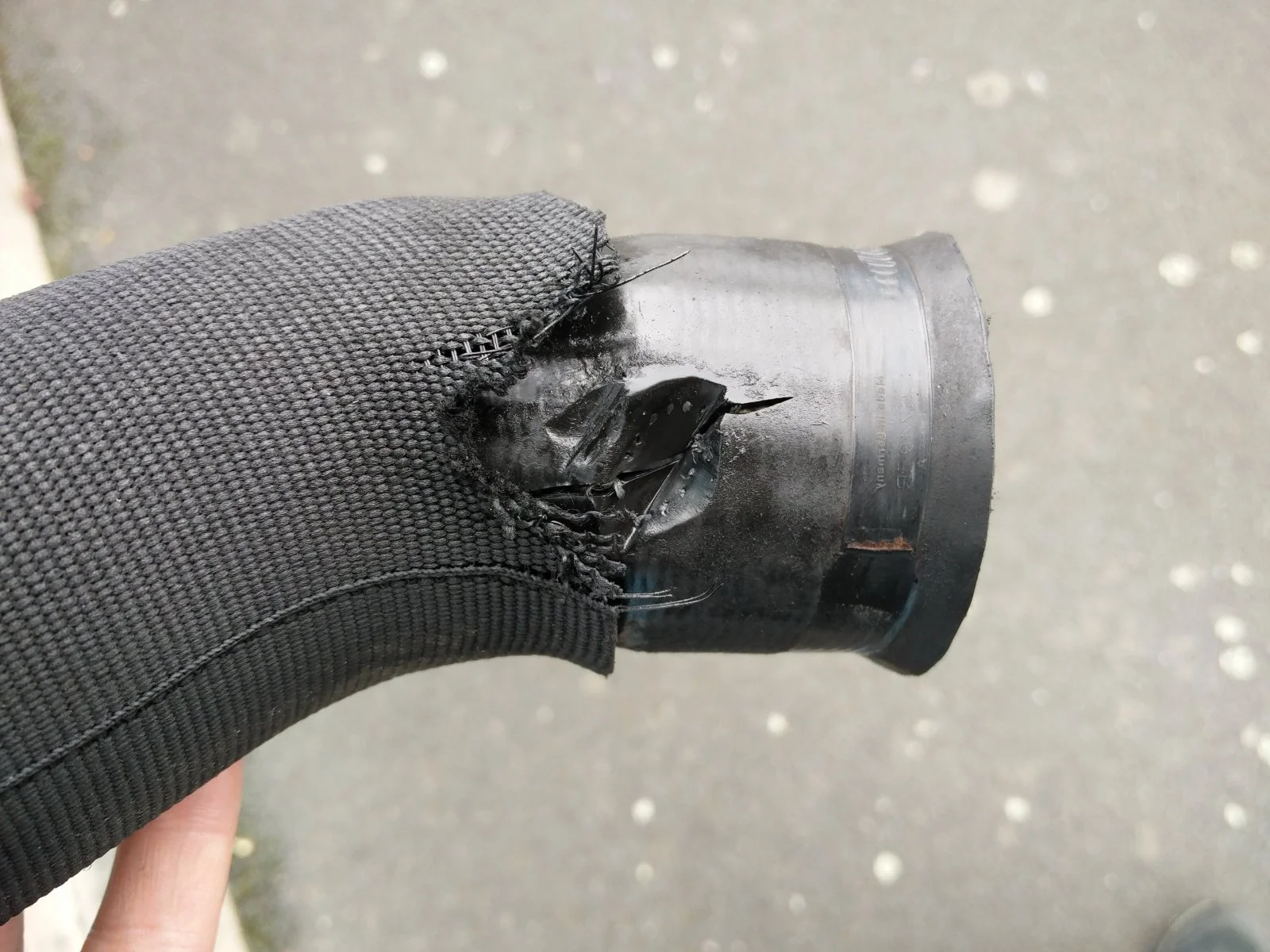

Found the problem, the radiator had come loose and rubbed against the pipe causing a split pipe. The parthas a 10-day wait so it was been bodged with a similar sized pipe until I can get my hands on another one. They tightened up the radiator and all Cost £40 incl. Labour. It does actually run fine now though. So might just leave it.

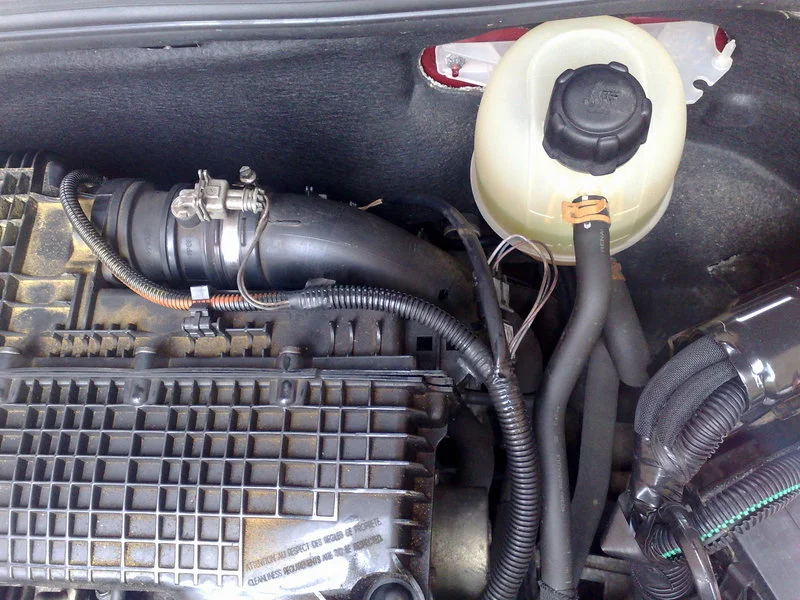

just searched for a photo of my 65 as my 80 definitely has a senor there, found one, my 65 had it too!
