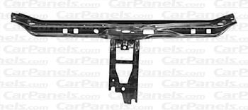

Bumper off & remove front crossmember.

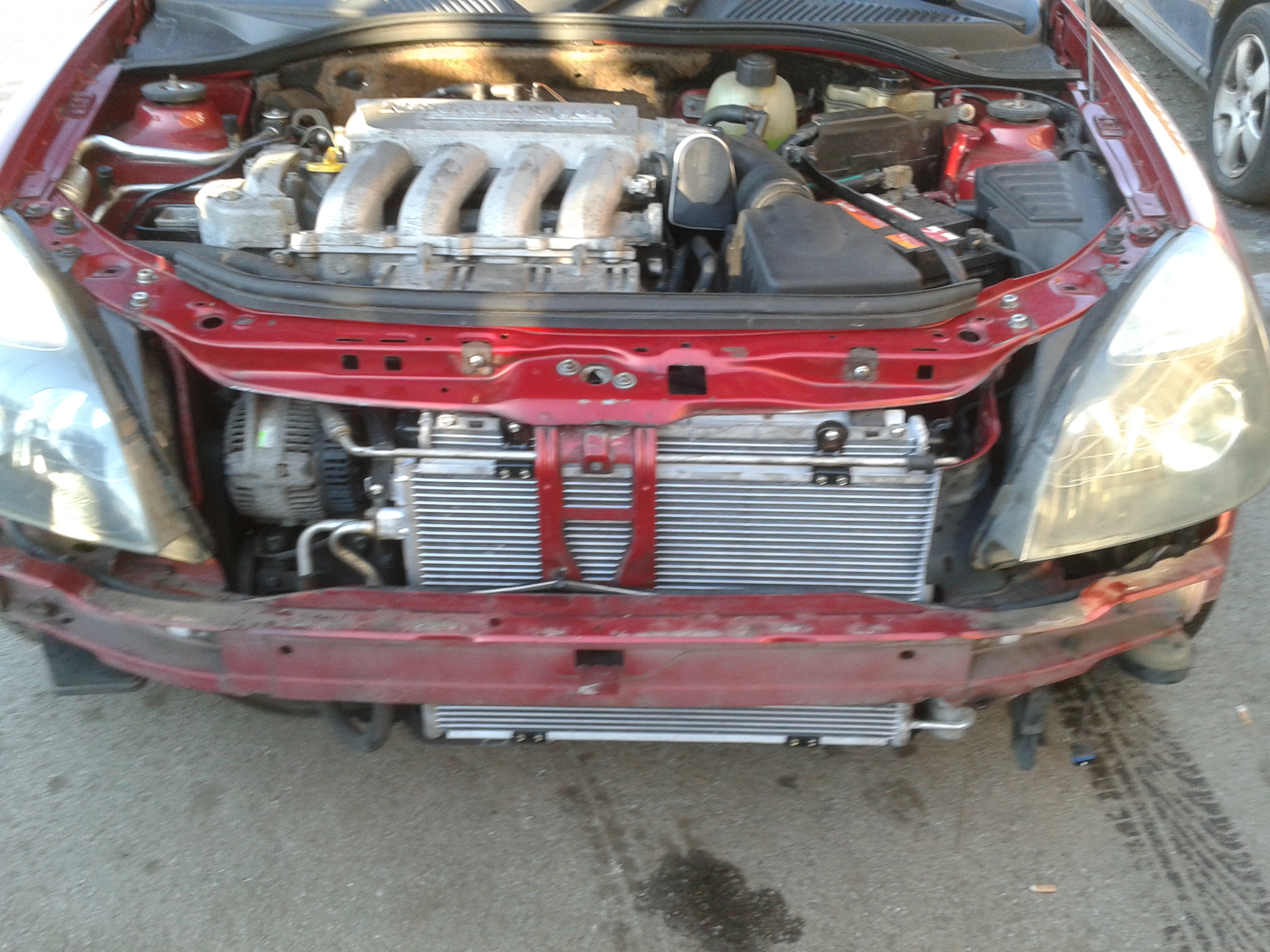

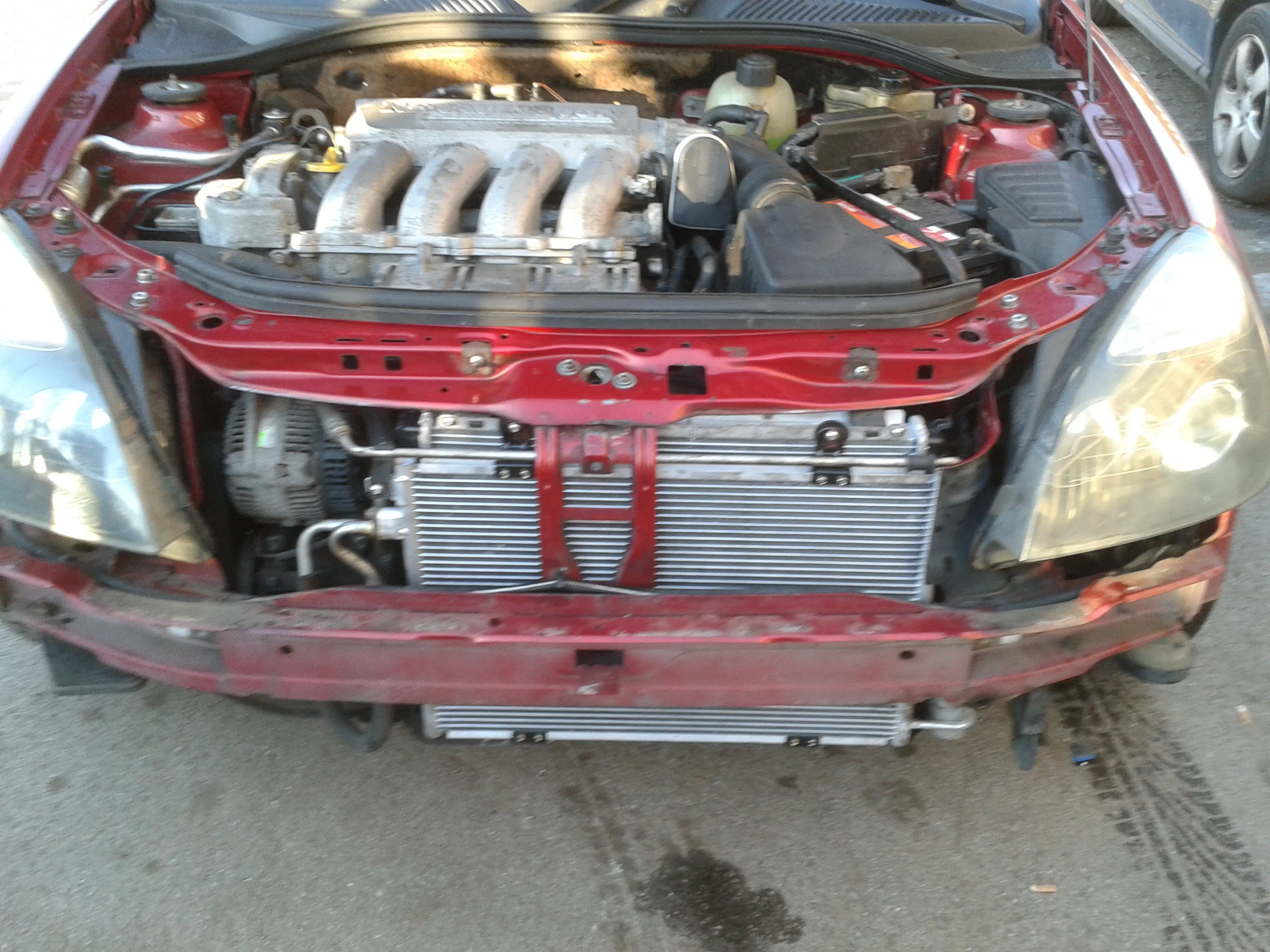

Bumper is off, but the alternator isn't fouling on cross member. Its hitting the lower aircon pipe if i bring it forward, or the edge of the mounting bracket if i go up.
You will have to give the dowels a tap to loosen off the bottom pivot so you can lift the alternator out the way,& FFS disconnect the battery.

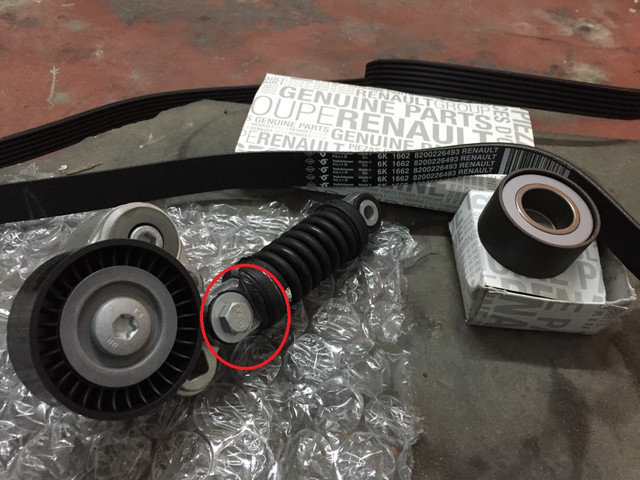

Should the bolt at the bottom of the tensioner spring be tightened once all positioned?
It looks like it should be left loose to allow it to pivot when needed. (Not talking about the hex head)

I don't care if its a stupid question - but should the bolt circled red be tightened when all refitted?
Its loose when delivered, but dont know if that is for fitting (to split the part) or to allow it to pivot.
Easy to do you do not need to remove bumper and so on. Just remove the big metal block under/next to engine mounting. Adjust engine height until tensioner comes out. Can be a bit fiddly but they come out and go back in fine.

What about the picture above, do you tighten that bolt Mike?
If you tighten the bolt before installing tensioner you won' be able to fit it in place.
Once tensioner is fitted and belt on tighten bolt.

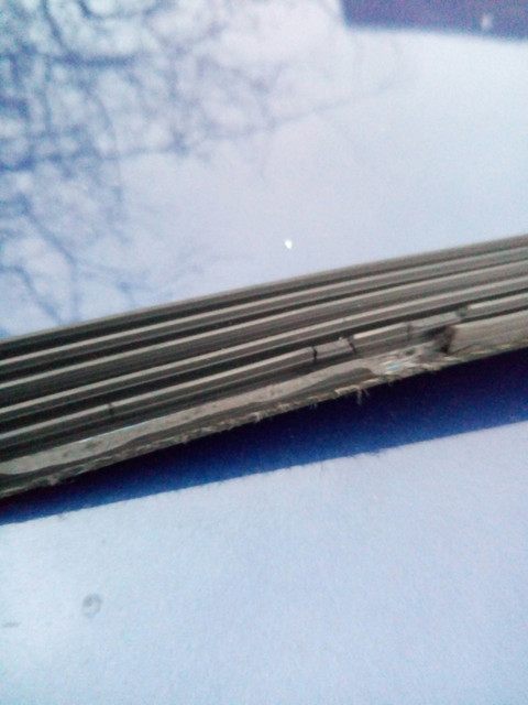

By the look of the old belt, i got there just in time.
