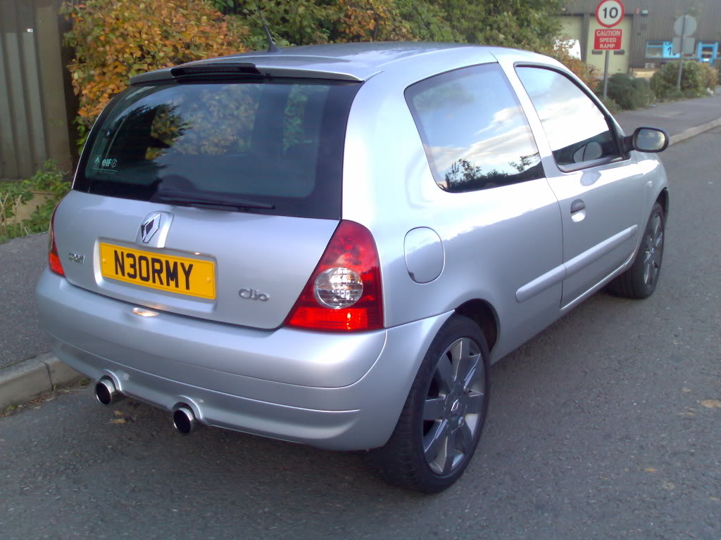

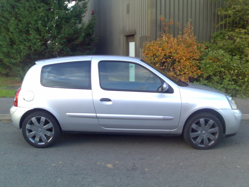

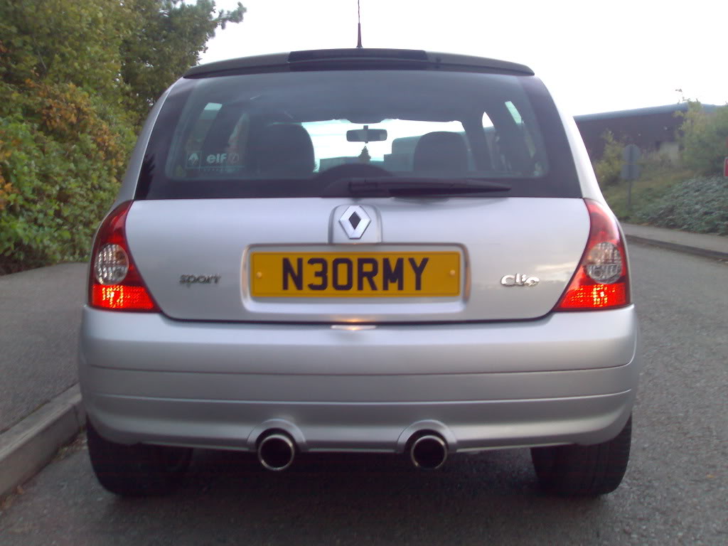

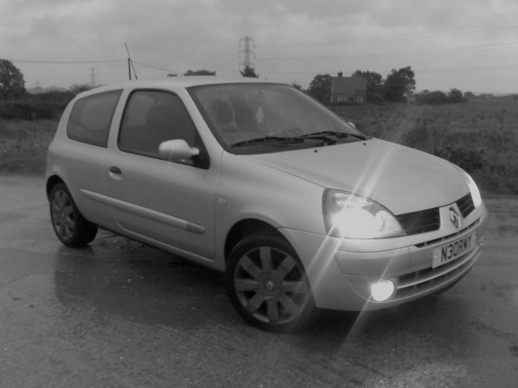

Well, its been a long time coming, but finally its been lowered.
No more driving around 4x4 stylee!
Lowered about 40mm on Eibach pros and 5mm spacers on the rear.
Nothing too low, but i notice the difference in both cosmetic and handling side of things! :approve:
Before:

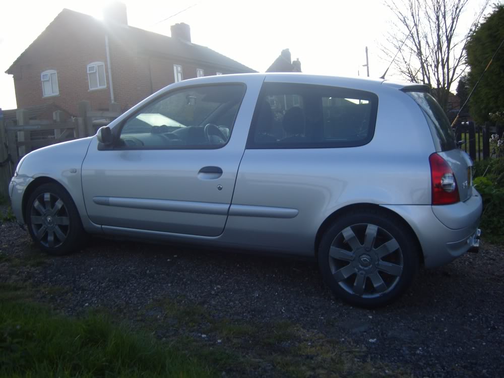

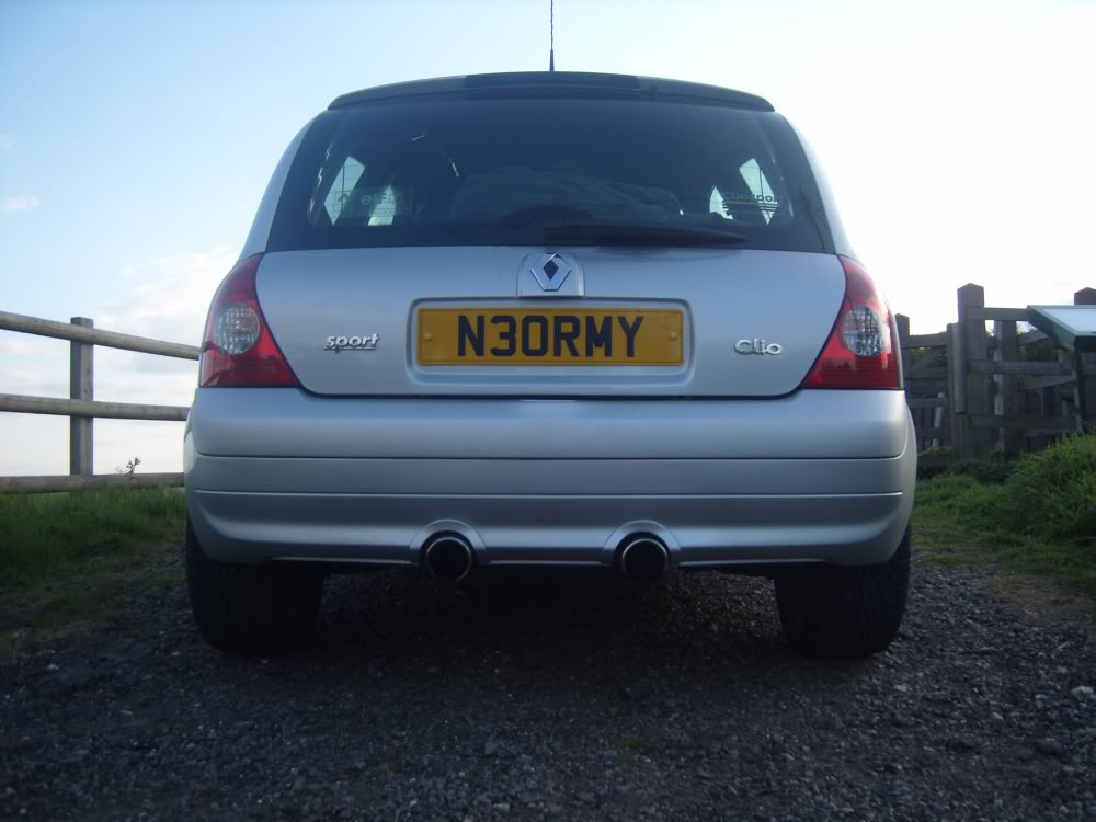

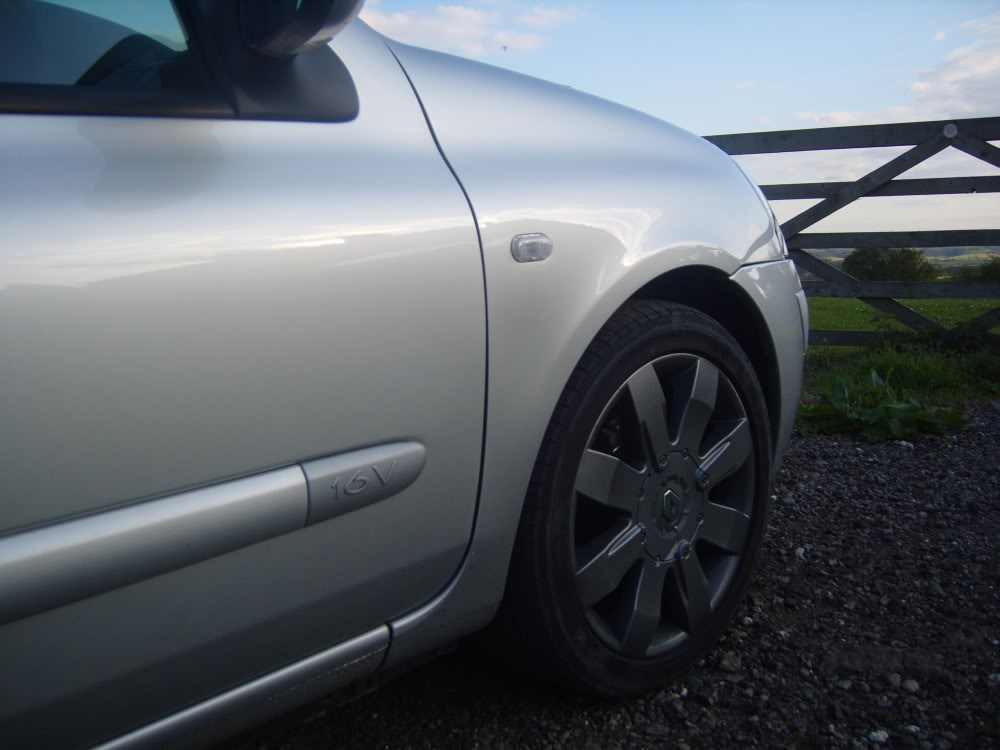

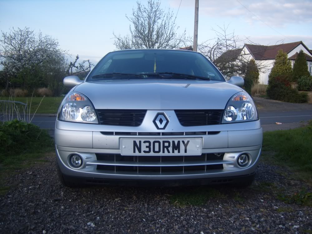

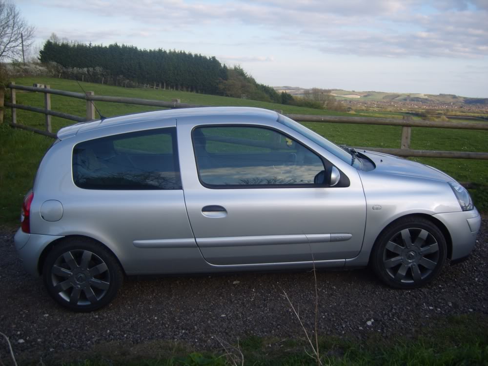

And After, using my new camera too! :D :
  RB 197 fatty
yeah just looking at them now iv realised they still look quite high in the pics there. they have actually gone lower now. should this have happened?
pics were taken 2 days ago just after they were fitted. does it take time for them to settle right?
look better now. will get some more photos
  Was a 197
might find the rear will sit down after a while as they settle in. when u go for a first run on new springs a good idea is to go over some potholes on purpose to help this process along

pot holes lol. just take your car for blitz around a few rounderbouts mate, give them a good week to settle.

yeah they do look alot better after 300 miles now. and i do live in the tinyest village ever with roads made out of potholes, so its is better now.
will update pics soon!

well as far as handling goes on a 1.2, quite alot actually! before i used to get that horrible roll feel as i went around corners like it was gonna topple over, but now it just seems more rigid and stuck to the road with minimal roll.
Also the 5mm spacers have stopped the wheels rubbing on the arch liners so that good too.
The only tiny downside is the ride is now alot harder and feel the bumps that little bit more, but it was expected and its not really that noticeable.
So overall.... a recommended mod from me!

needs lowerin...;) lol, nice dude, RS grill n silver visions! ur sorted then

think it all depends on the model of car/wheelcombo. if i had standard the standard 15's that came on the car i wouldnt need them i dont think no. but i got the 16's which are obviously bigger, wider so they rubbed on the small arch liner. so i had to use spacers.

Prolines only lower the car 15mm at most, not really worth it IMO unless your standard springs have snapped (Most do).

yeah brett its only a 1.2. it had settled alot more after these pics were taken. and looked good in the end actually. I just wanted it back to looking kinda standard but with those wheels not the lowered look. it worked!

Big no!! Exhasut very unsure, SPORT badge lose it!! Umm Prolines possible wont lower it that much as dave said but RS grill and Silvertecs

and actually i gotta say over the 3 years almost, its the first proper bit of negative feedback iv had on the exhaust!
th sport badge actually came on the car from new! iv had this argument before but ppl usualy fail to believe me. i think theres others out there that got them too. whether or not it was factory fitted or by the dealer.... it wasnt me, and it was brand new! ... and even though it is only a 1.2... it does say sport on the documents!
