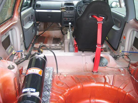

get a highpower wizards kit as pictured in matt blacks clio with a digital progressive controller.

matt - whats the third pulsoid for in your picture on the right hand side?? a purge kit? radiator cooler?
Purge valve mate
