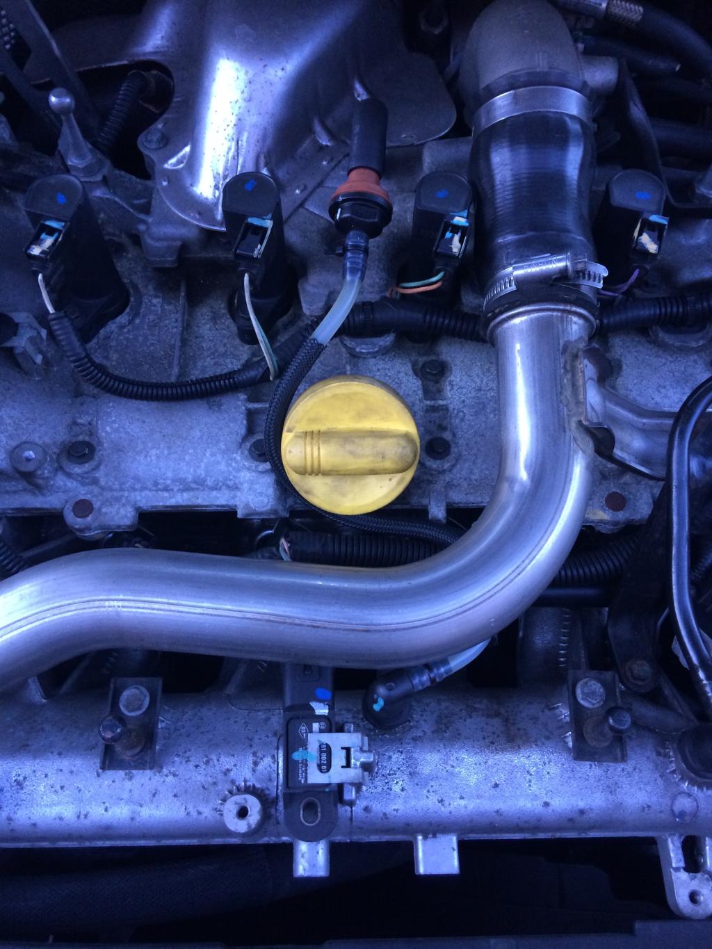

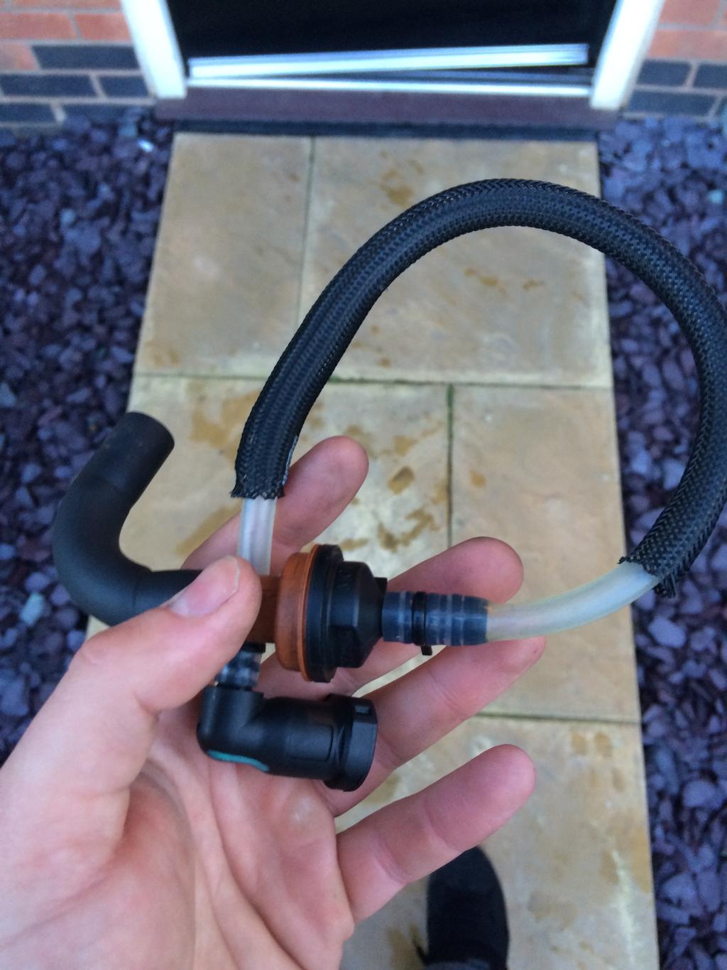

So due to me not being able to leave nothing alone today whilst I was at work I thought I'd whip the breather pipe off between the top of the rocker cover and top of the inlet manifold (one with brown and black valve in).
Basically when it was running I could hear a whistling noise (kind of like an air leak) coming from the valve at idle.

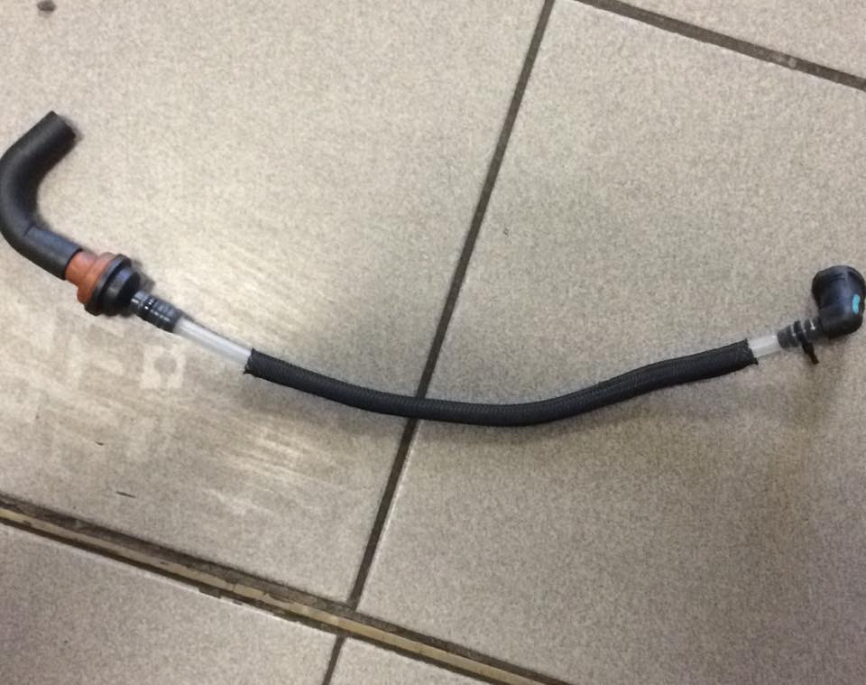

So I thought I'd whip it off and pressurise it on the bench at work. Unfortunately whilst removing I broke the brittle solid pipe that goes between.
So I spent this morning looking around work for some pipe I could use to limp me home and after much swearing I came up with this
It's heat shrunk on and zip tied at both ends but it's only got to do 6 miles
Ordered a new one off ads for 28 quid, but to add insult the one way valve was perfectly operational and that noise it generates was just air passing through!

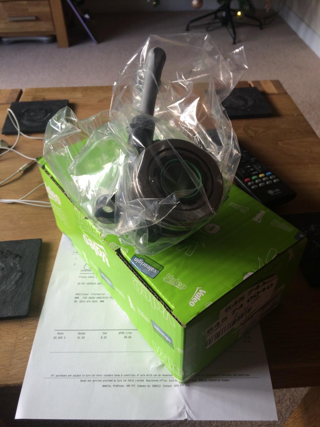

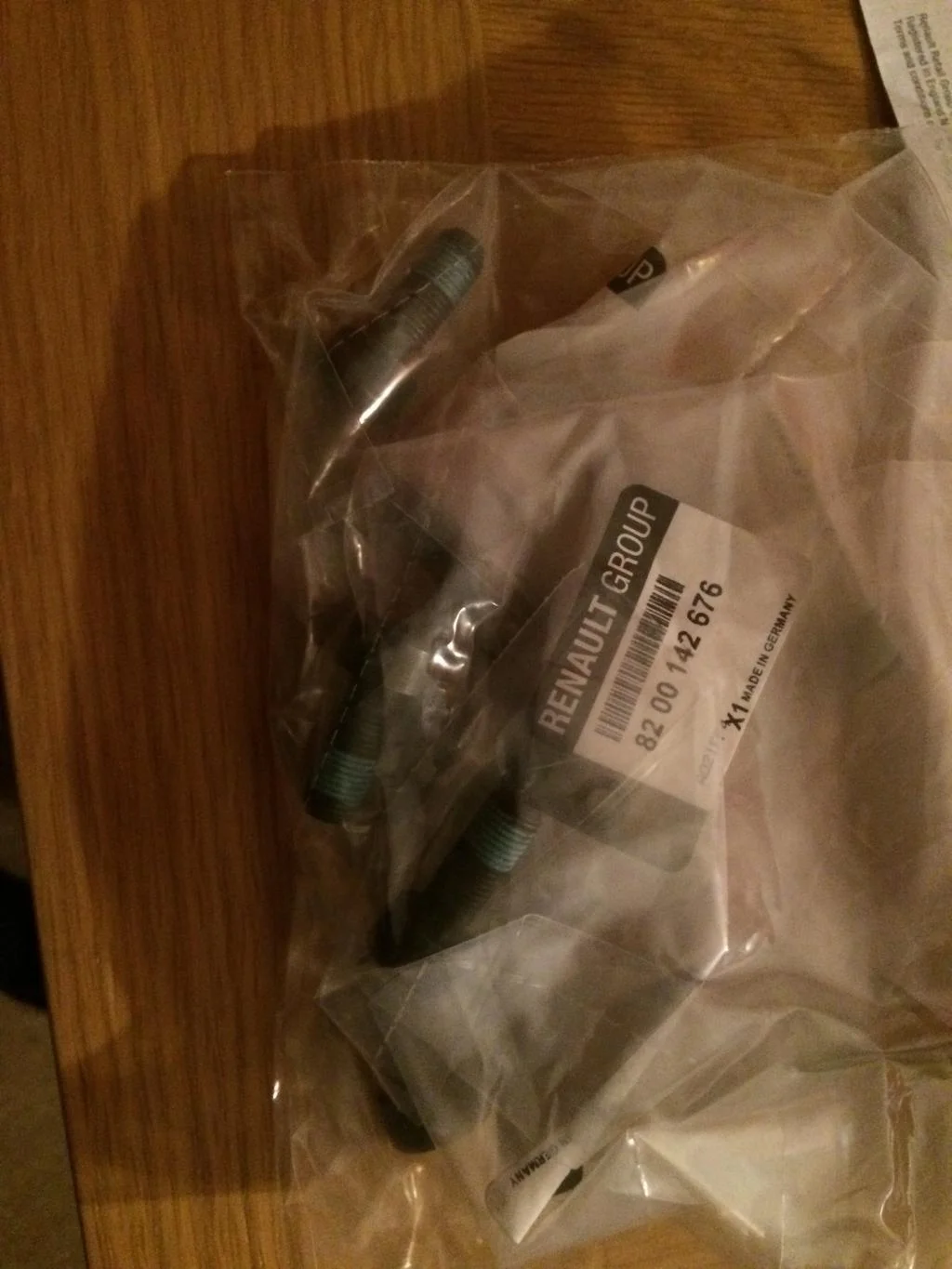

Well another day another delivery, this time in the shape of a valeo slave cylinder to go with that new clutch and flywheel.
Now just for the flywheel bolts that's should be here tomorrow and that breather pipe so I can get back to boosting and less tickling

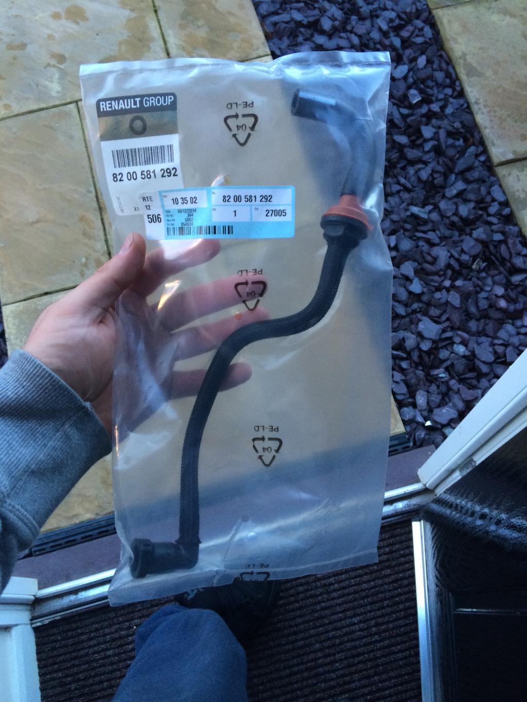

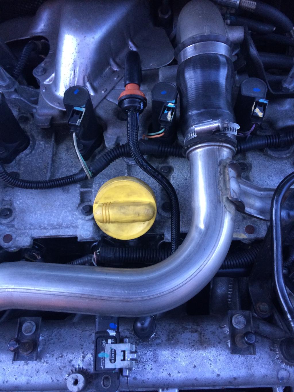

Well the said breather turned up today, had this from ads and Wolverhampton Renault and really can't recommend him enough for his knowledge and customer service.
So I removed the quick dessert repair
Popped in the new one and bobs your uncle
The new pipe seemed much more flexible then the old one that had clearly gone brittle over years after all the heat exposure
Saved the old pipe as you never know could be of use one day ha

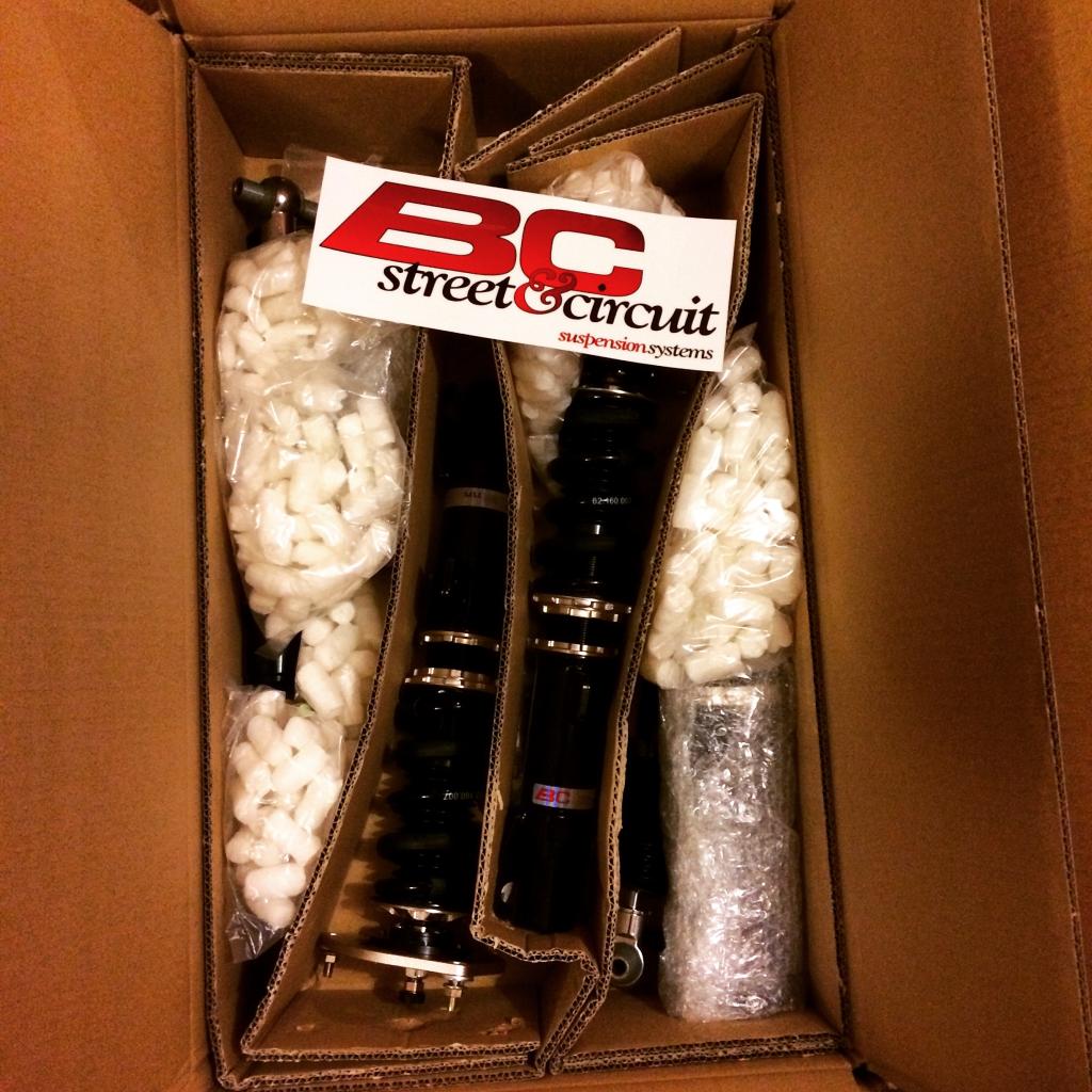

So finally picked up a set of these little beauties
BC racing BR series coilovers, a few friends have used these on various cars and always been happy with handling and finish and how durable they are so thought I'd buy a set, they also come with pillow ball camber top mounts
  Megane r26
That'll do nicely on the road. Stiffer at the rear for the track for definite though I'd say. Fronts might need upping as well though. Best advice - try it and adjust it if you feel it's necessary.
The trackday kit comes with 7kg front and rear.
Tbh there springs are fairly reasonably priced to and the delivery is really quick!
