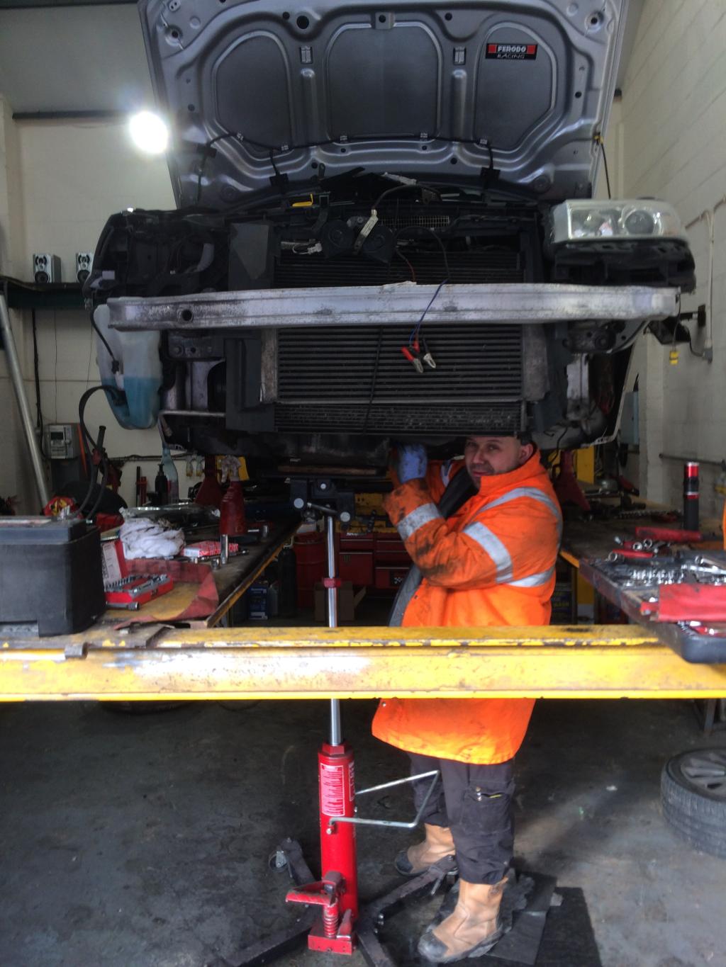

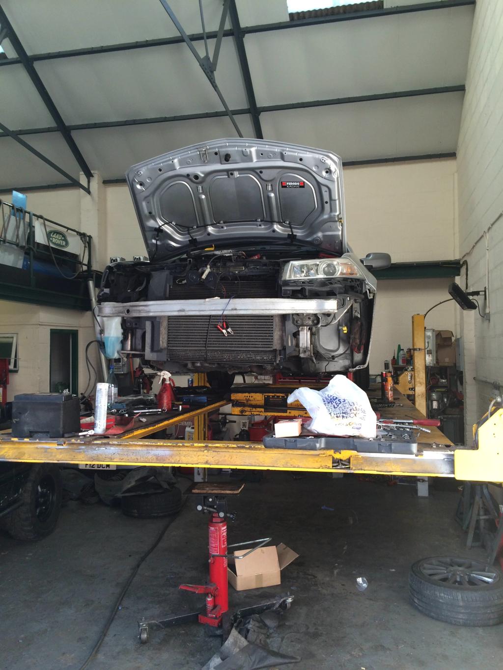

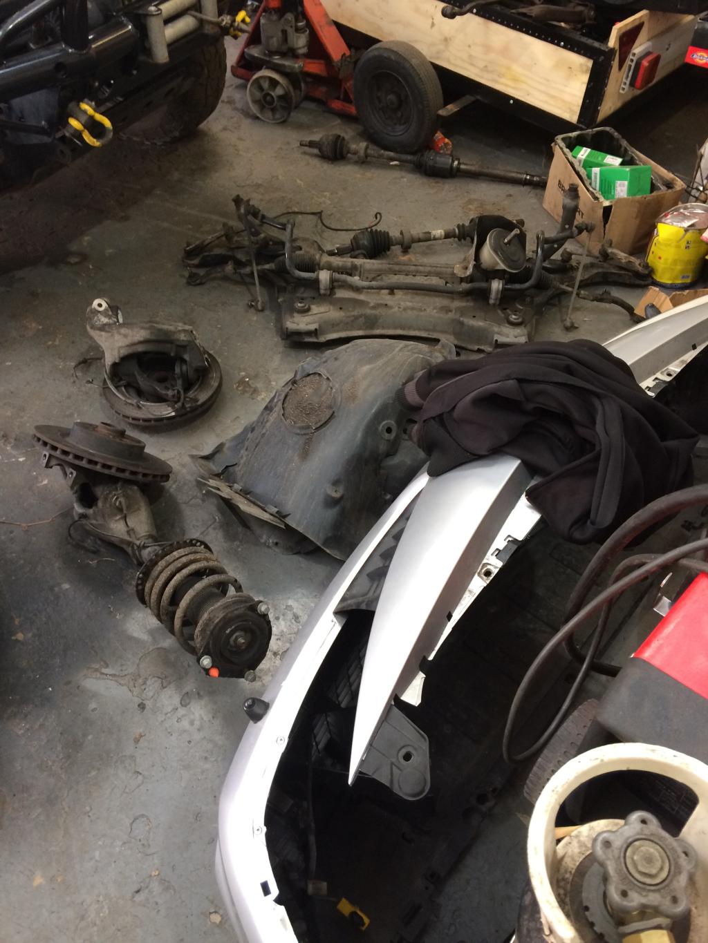

Are you dropping the lot down dan? As in engine, box, subframe etc
All I've got to do is locate an engine crane that doesn't f**king leak!! Then it's all coming out.Subframe (more of a cross member tbh) with the steering rack still attached as it seems easiest way. I'll leave the lower arms attached too and just undo the 3 bolts on bottom of hub.
I'll then swap lower arms on the floor, then I'll just take the whole leg's off and swap coilovers then.

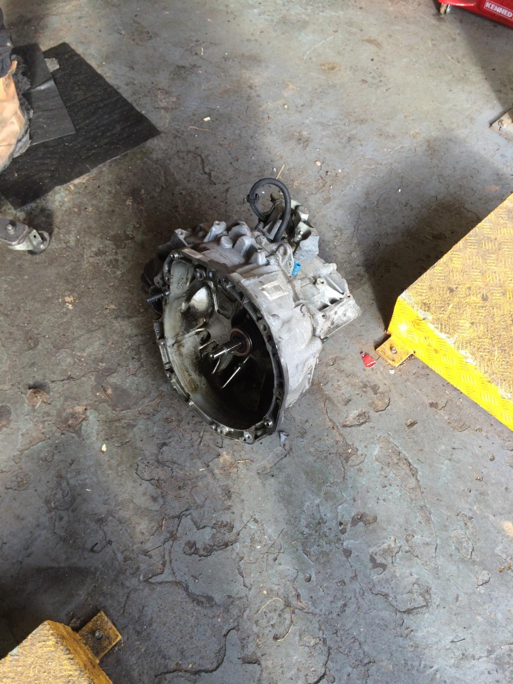

I'll leave engine in and out support across the top no doubt and swap clutch, flywheel and slave then I'll fit the decat whilst it's all out the way as there awkward at best of time

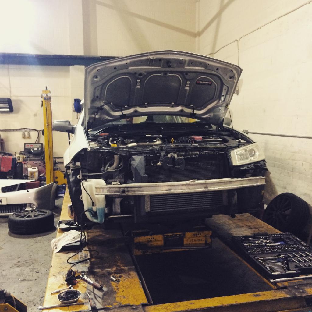

Tracking done?Well sorry for lack of pictures but it's been rather busy past few days with a few wedding plans and the car.

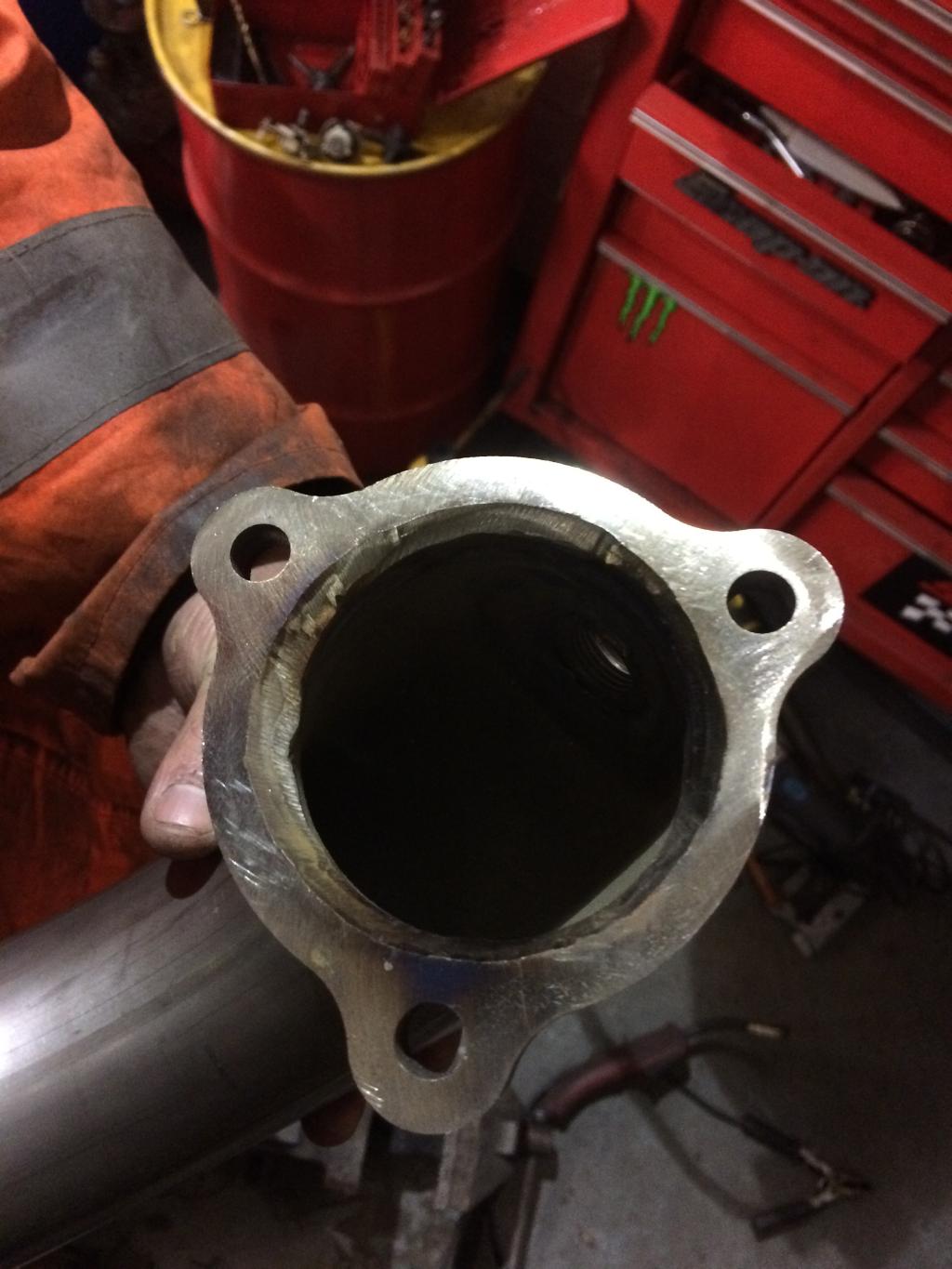

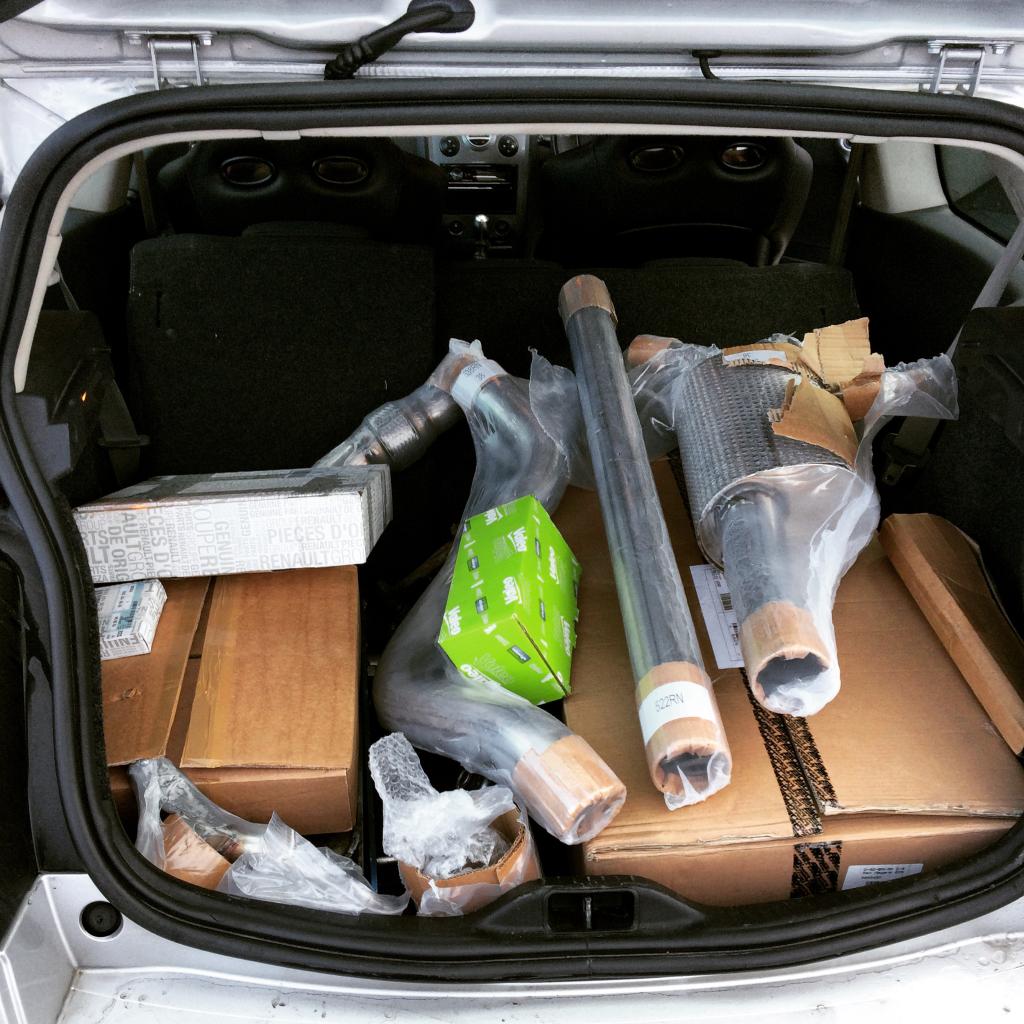

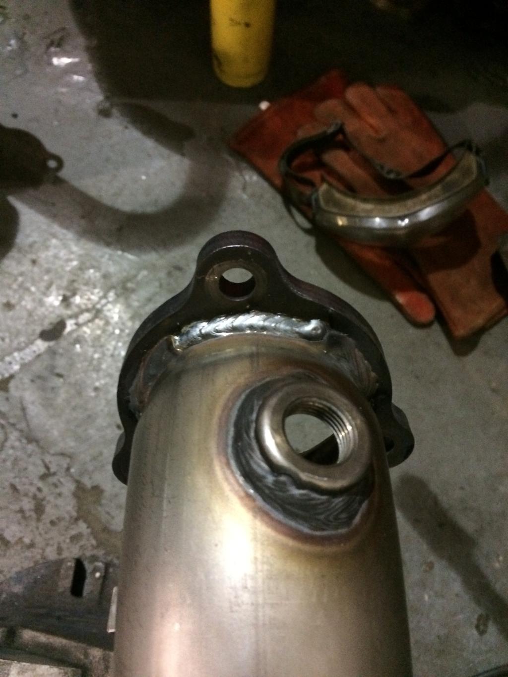

So it's finally back together, biggest issue that slowed the job up was just how poor the exhaust fitted but it's at a point where I'm happy now and just the odd tweak once it's all settled.
So for an few pictures I did take

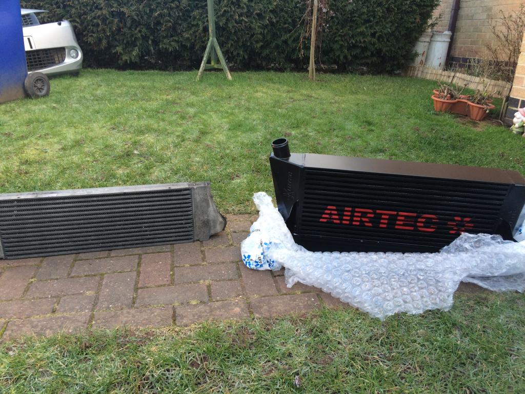

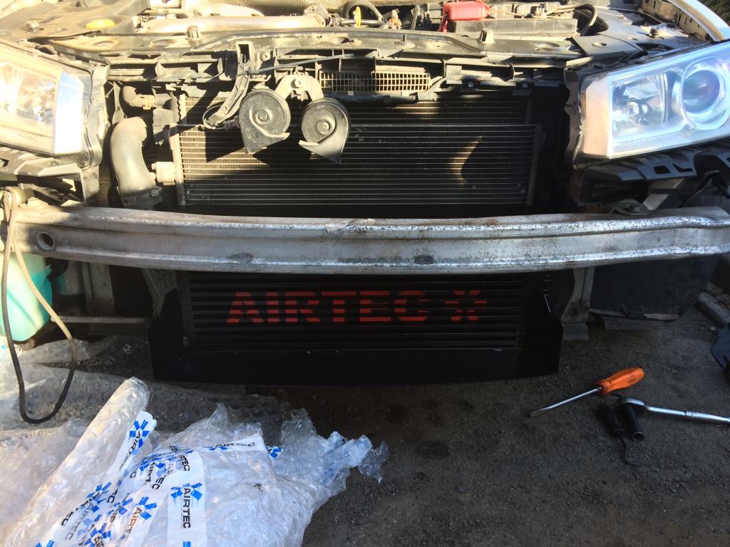

First off the new airtec intercooler
Pretty straight forward to fit and it's brought the intake temps down lovely especially after extended hard driving :wink:

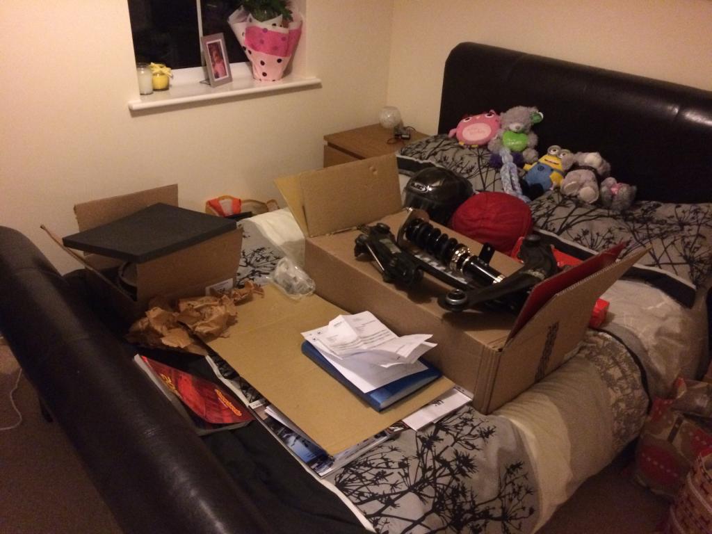

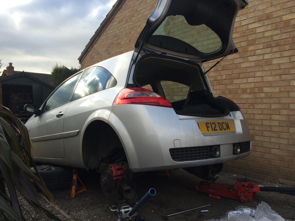

Then all I had to do was fit the rear coilovers, again can't fault the BC's for there quality and fitment was bang on

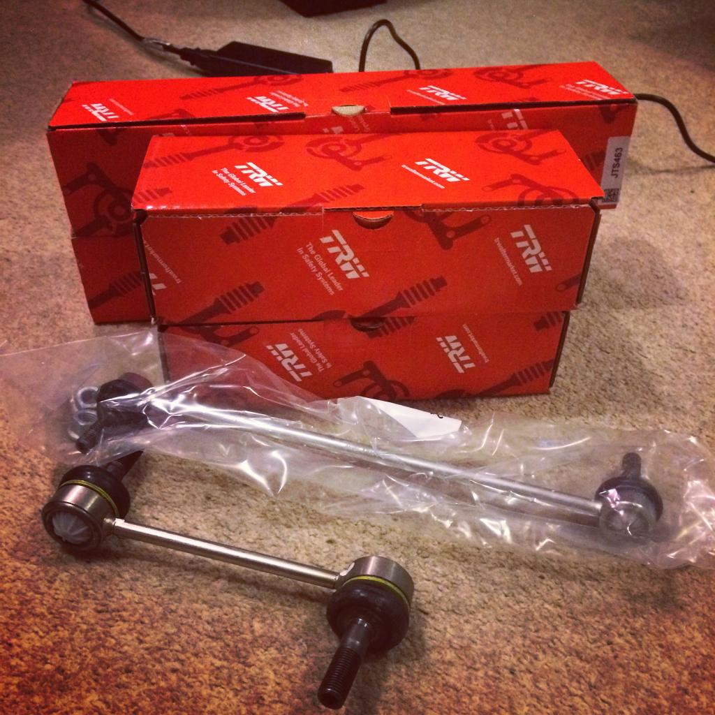

New lower arms and all links replaced
BC coilovers fitted

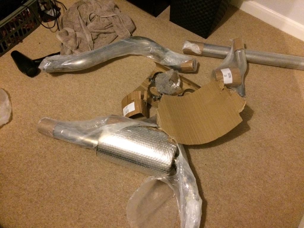

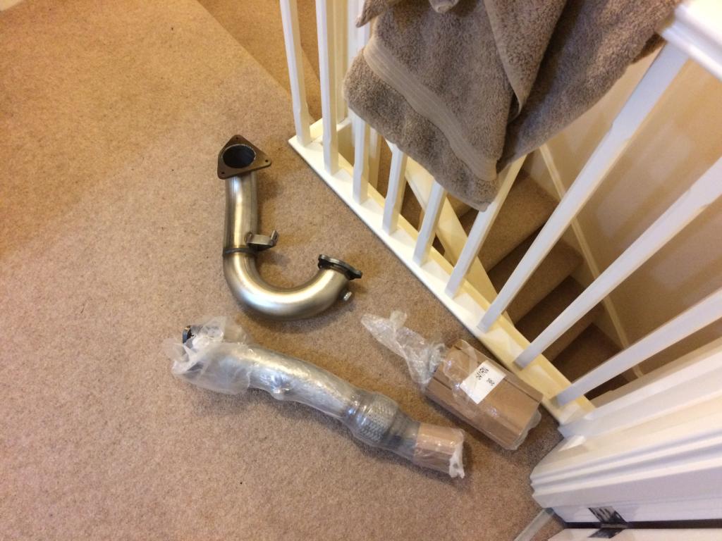

Scorpion rs240 3 inch turbo back with decat fitted
