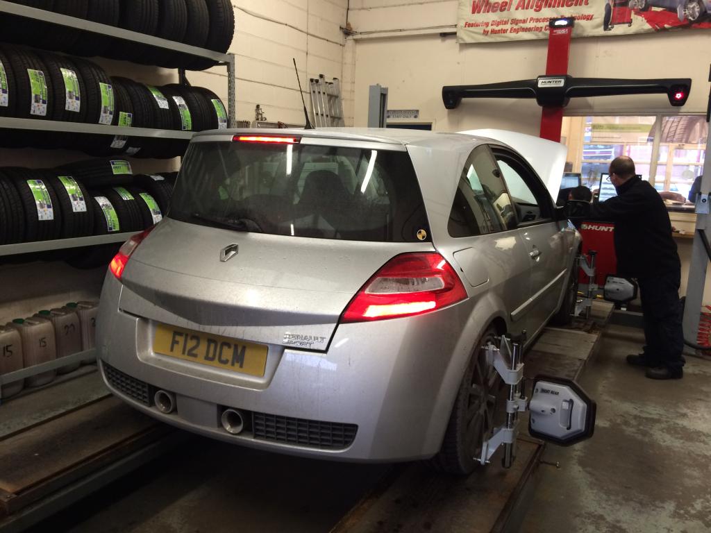

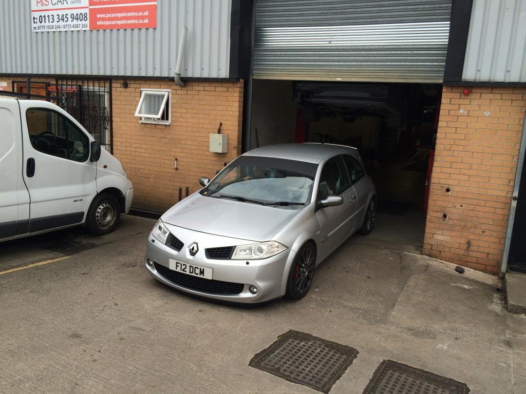

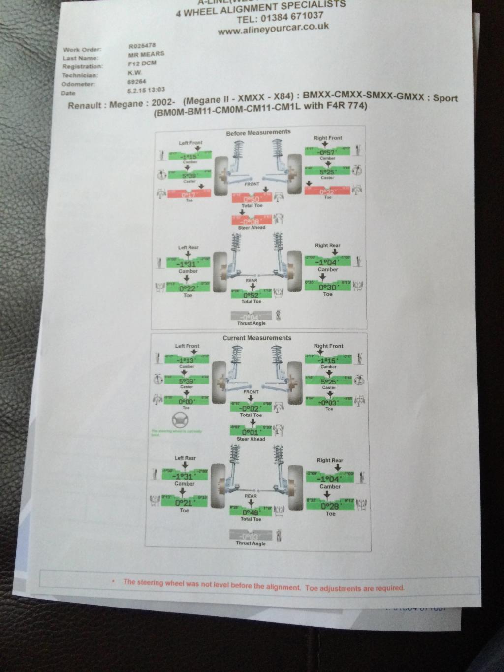

So earlier today I was in a bit of a hurry to get the geo done with being back at work and not knowing when is next get chance.
I usually use the assistance of @NorthloopCup or me mate Pete at centre of gravity but with me being in a hurry I didn't want to be putting folk out.
So after speaking to a few pals in the drift community and hearing good things off @MrBurns I headed off to A line in Dudley.
http://www.alineyourcar.co.uk
These guys use the latest hunter equipment and will happily dial in any setup you want and also advise on setup.
Anyway we discussed setup and that I do I aim to do a handful of trackdays but it's still predominantly a road car so still had to retain decent tyre wear.
So we set the toe to standard manufacturers spec and the camber to the maximum negative angle but still with in manufacturers tolerance so will still get decent tyre wear.
He even said that if I found that on track I could do with a little more or that the tyres were wearing great he'd happily dial in some more for sod all as my setup is now saved on there system.
Haven't had chance to push it yet but felt better as it wasn't pulling all over the road. The dampers are still set to soft but can't wait to wind them up on a dry day and push on ;)

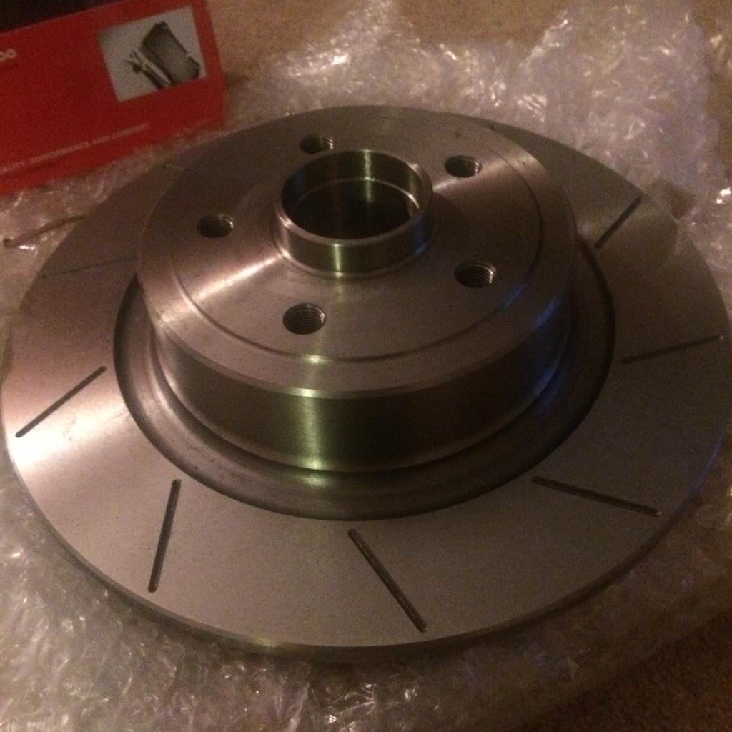

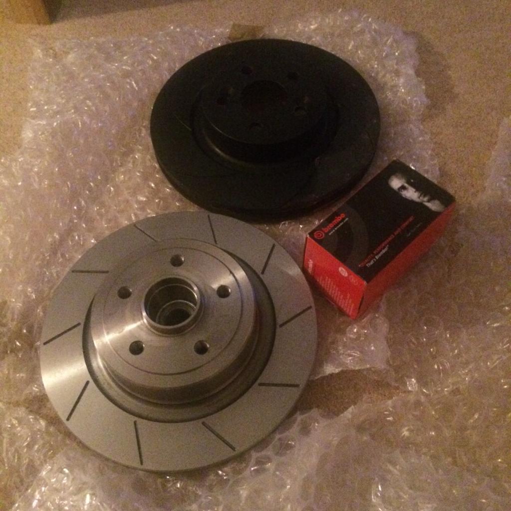

So little parcel arrived today. The rear brakes had really seen better days when I bought the car especially the discs anyway.
So after reading a few reviews online and speaking to some friends I bought the rear discs from MTEC performance sport brake discs.
These came with bearings and grooved and for 175 quid I got a set of discs, a set of brembo pads and the abs rings built in.
So await my review on here for these but so far they seem a good quality product.

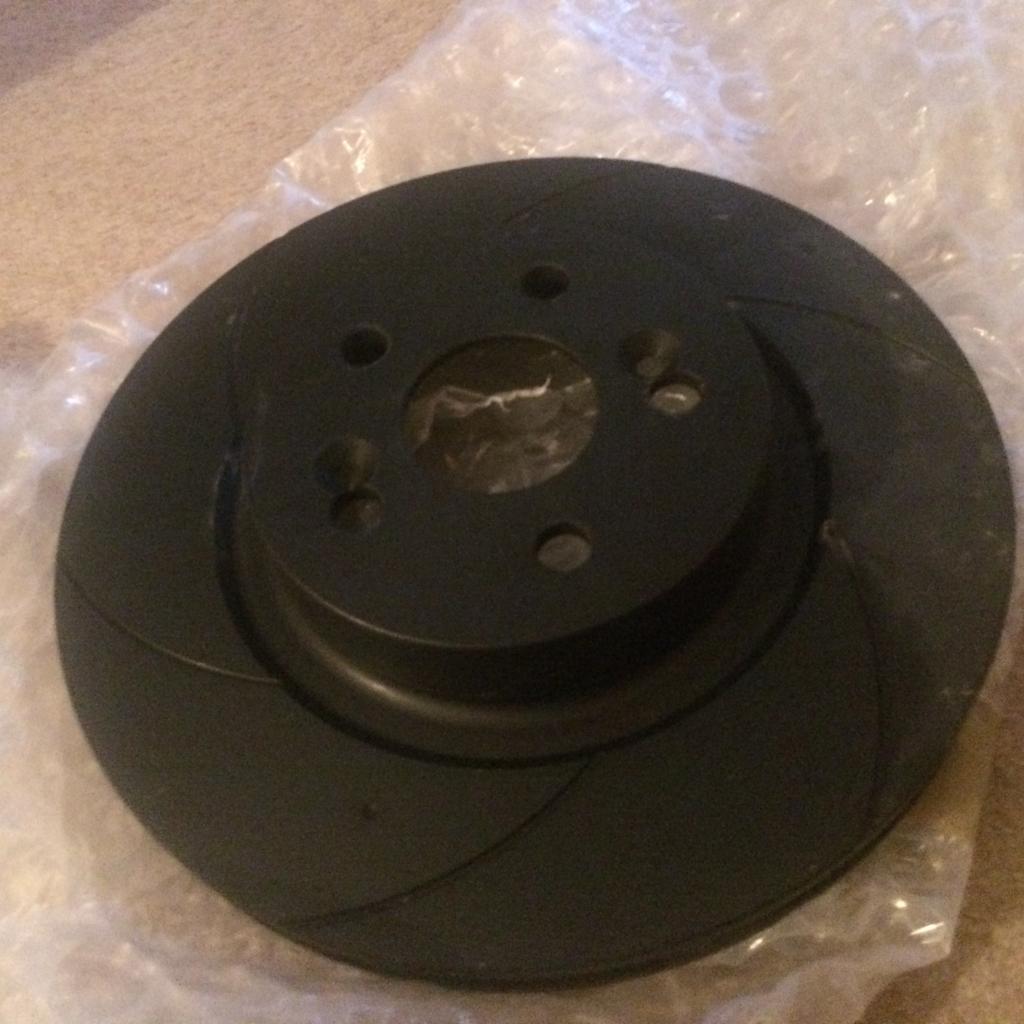

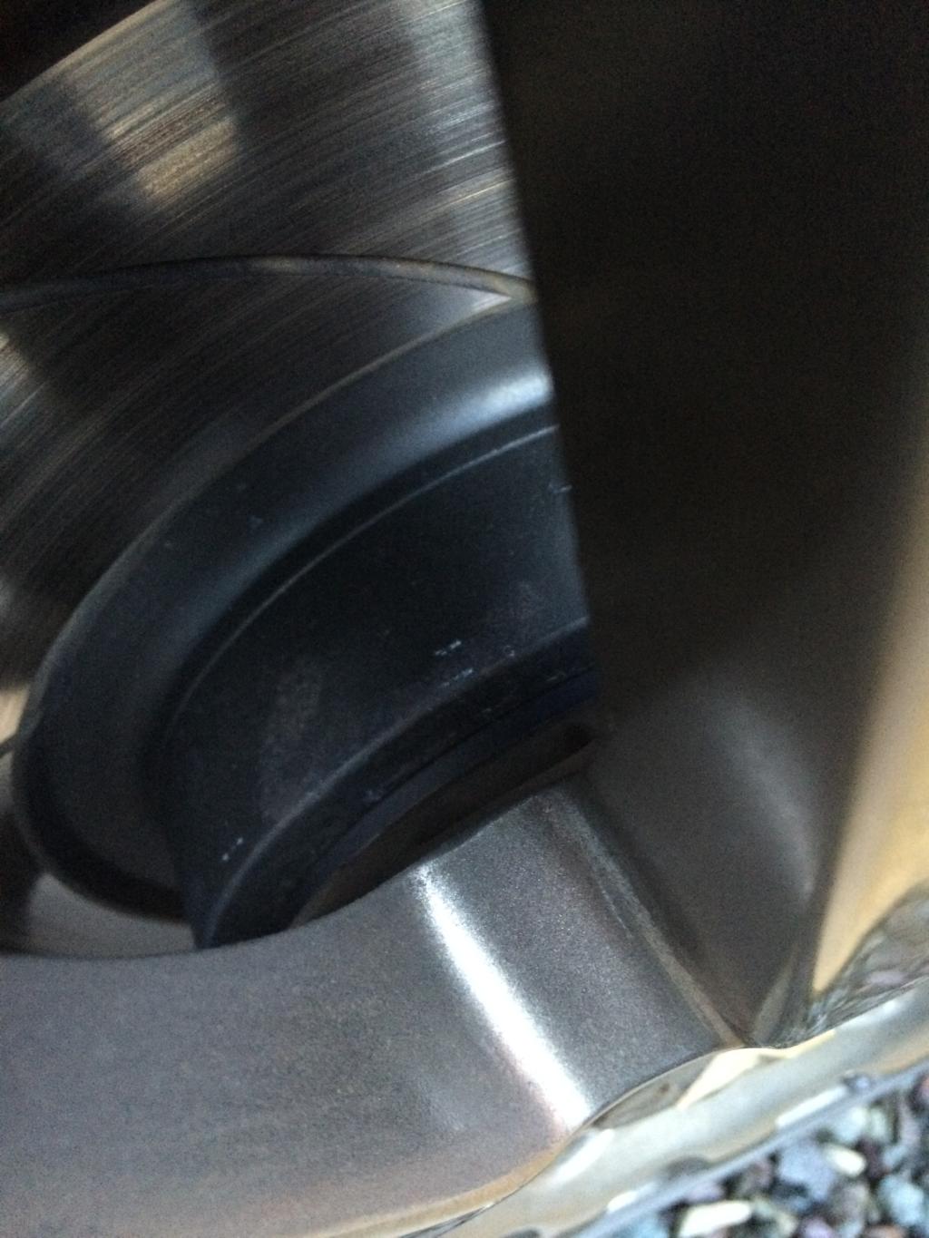

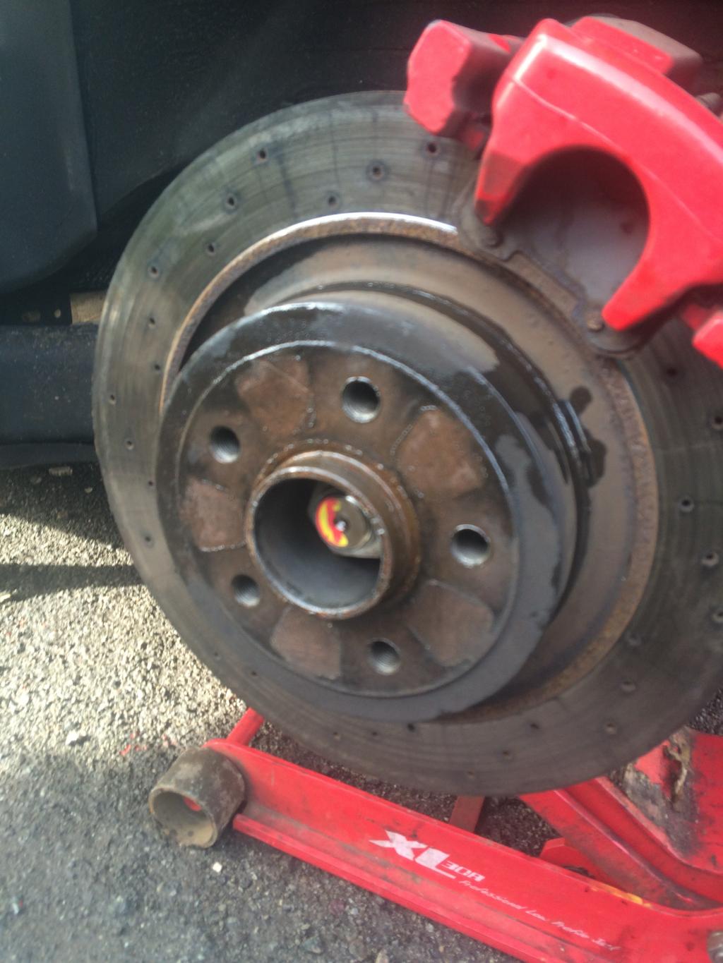

Now onto the other disc you see, basically when stripping the car last week during the mass overhaul I noticed the inner pad on the drivers side was a little more worn.
On closer inspection it appears to be a little sticky in the caliper so coupled with the heat it's clear to see that it's been sticking and worn the inner of the disc something terrible.
So reluctant to pay for OE discs due to the fact the DS1.11 pads seem very hard and that coupled with track days could turn out a tad expensive I hit the Internet. Anyway I ended up on ktec racing site (a site I rarely use now days as there usually expensive) and I found these on offer
There grooved, claim to be H/C and up to uprated pads and track work so thought I'd give them ago.
As always ordered Friday here today, usual ktec service which has always been good

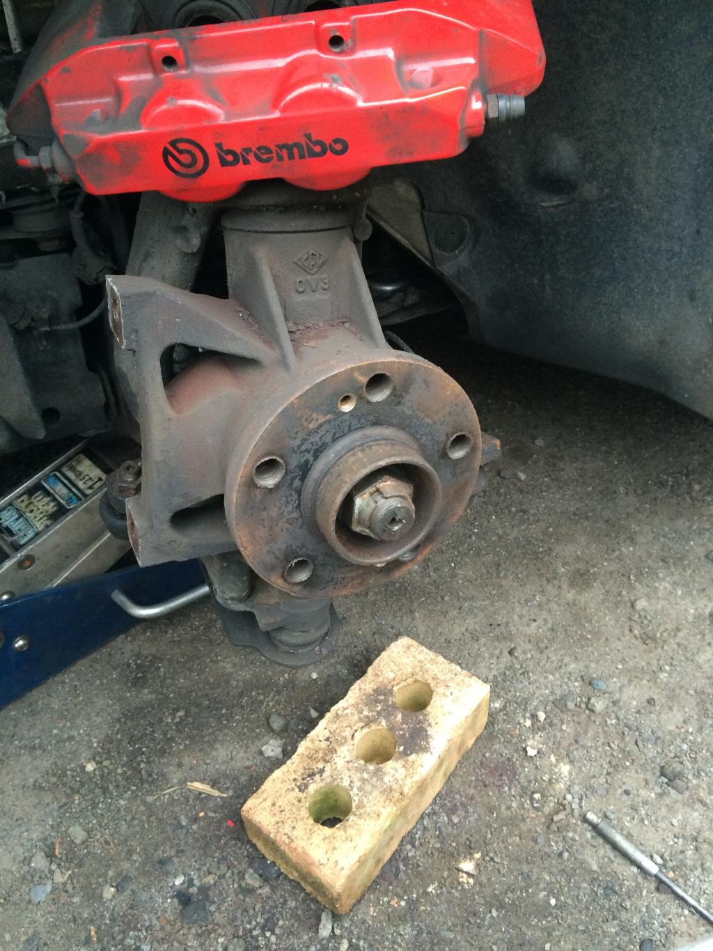

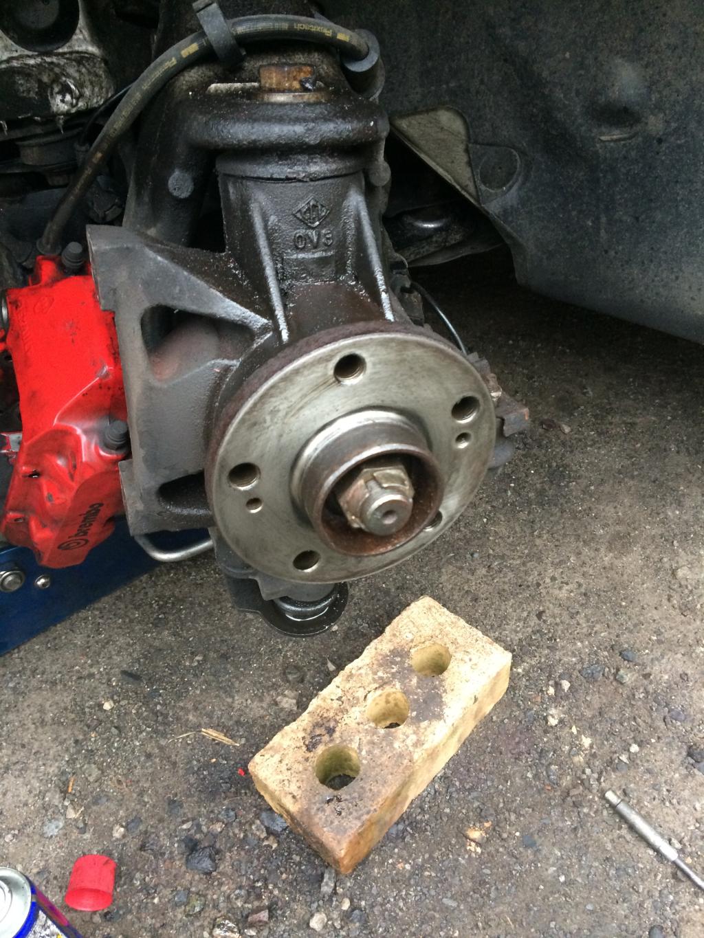

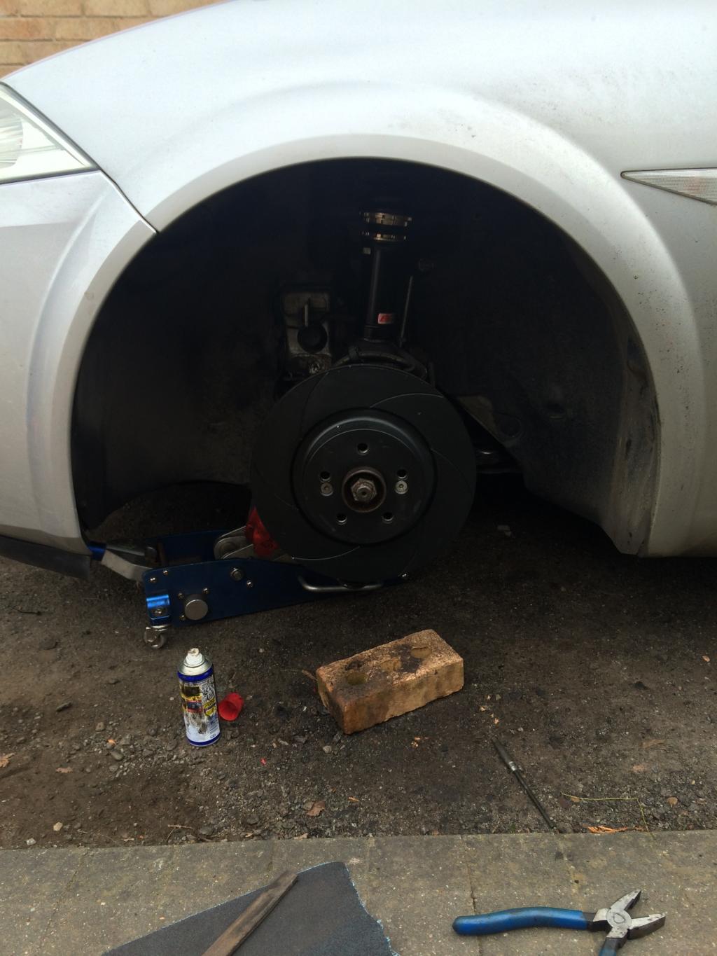

So first off I got round to replacing the front discs
Soon stripped the old knackers off
Gave the hub a bit of a clean
New disc in
And all went well other side and are nicely bedded in now.

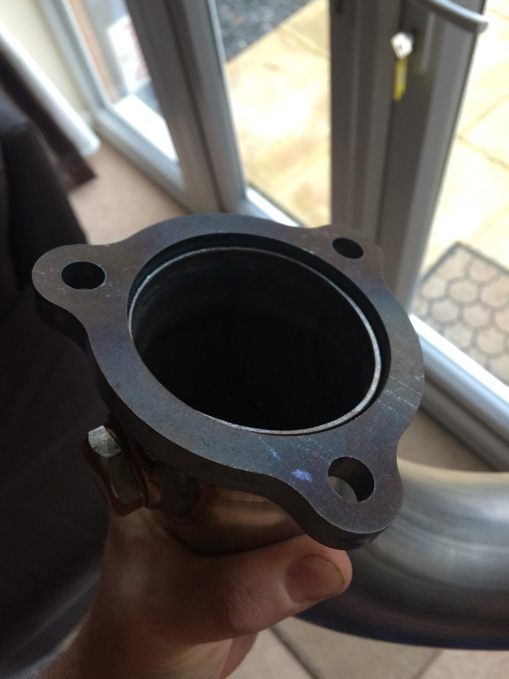

If you remember the trouble I had with the downpipe of having to grind out excess weld and re-weld it from the rear to fit.
Well I got onto Whybee and they said they had a new modified downpipe which they happily sent out, can't fault there service and I will fit this sooner or later
As you can see the lip for the turbo is there now

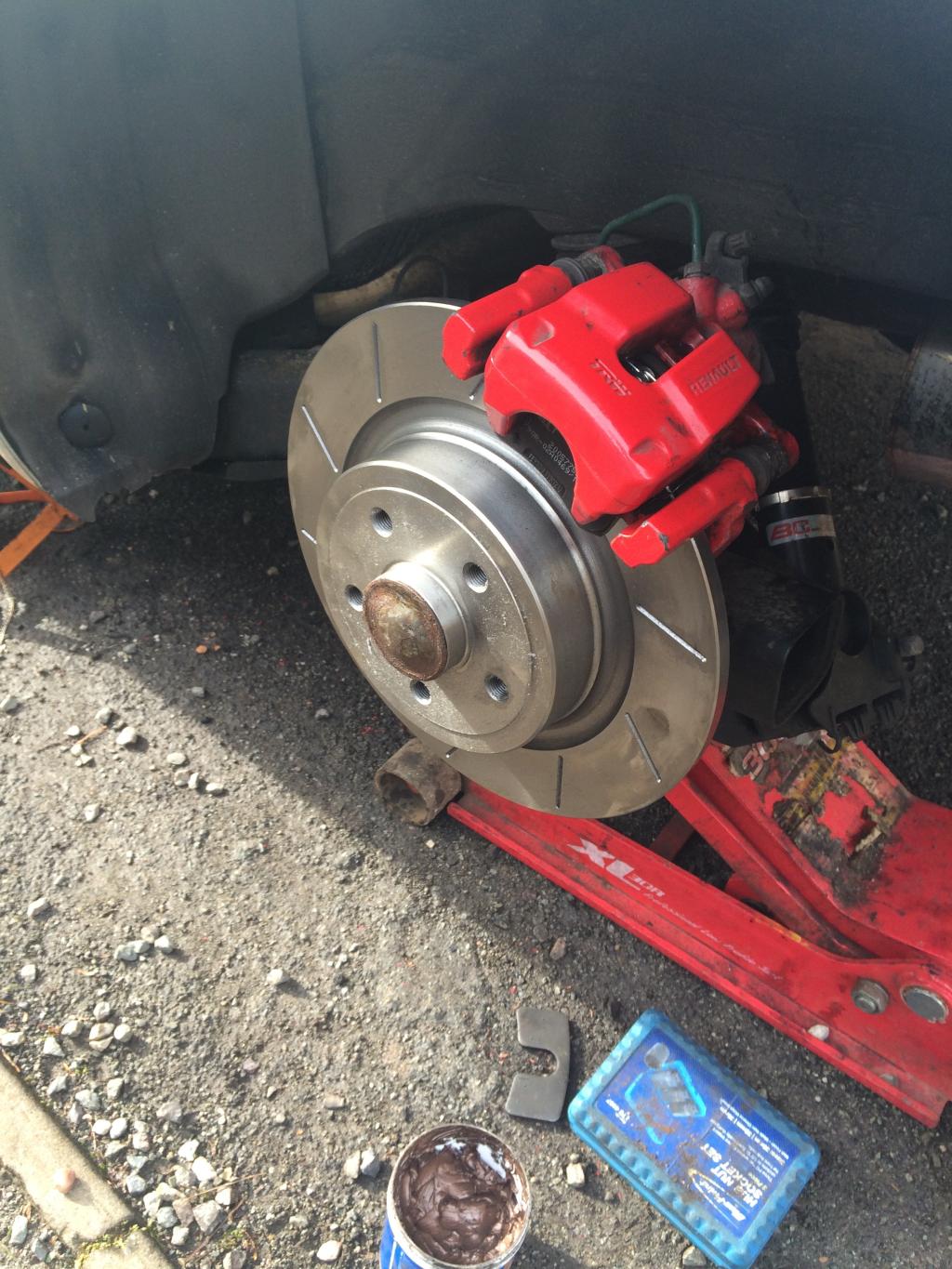

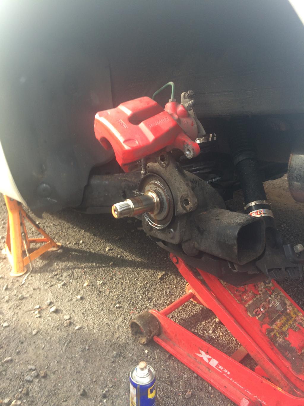

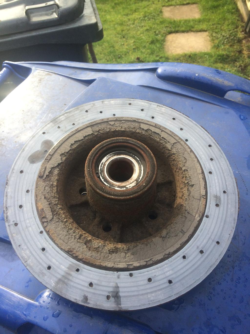

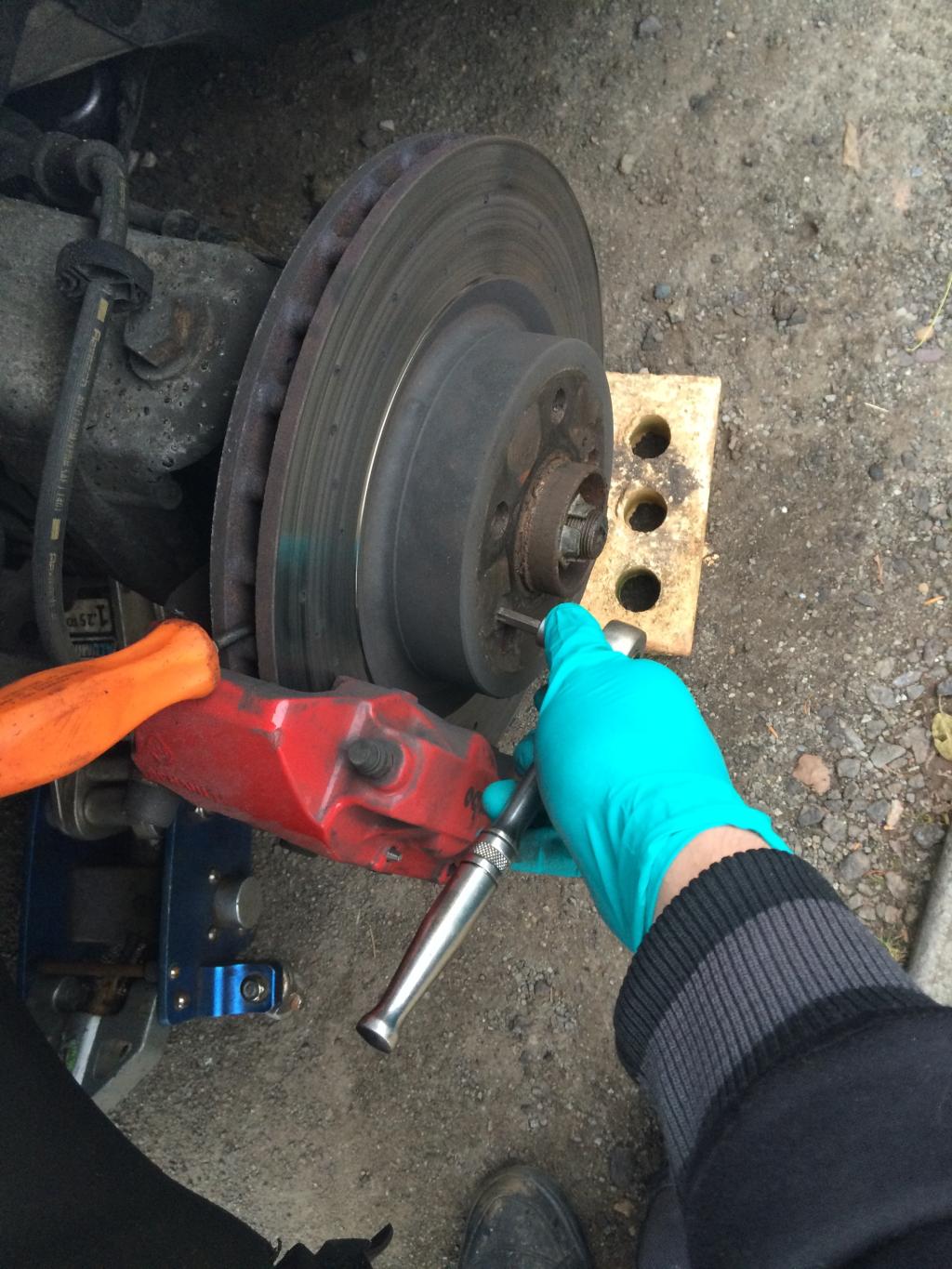

Then on to the rear brakes
Old setup
Stripped
Old discs well past it

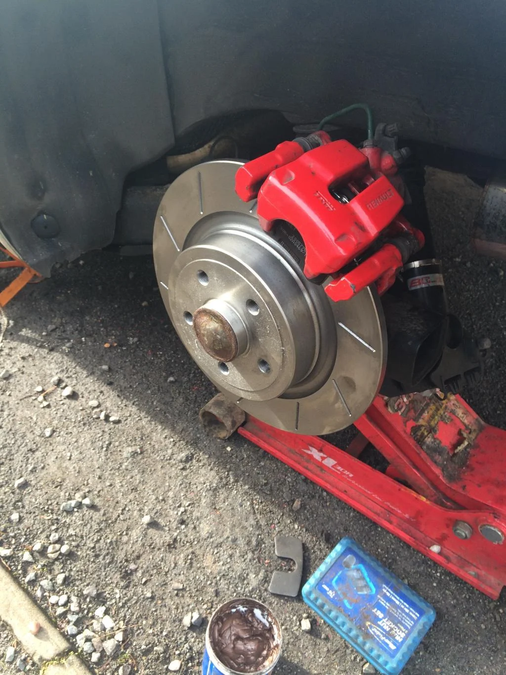

New setup all fitted and looking much healthier

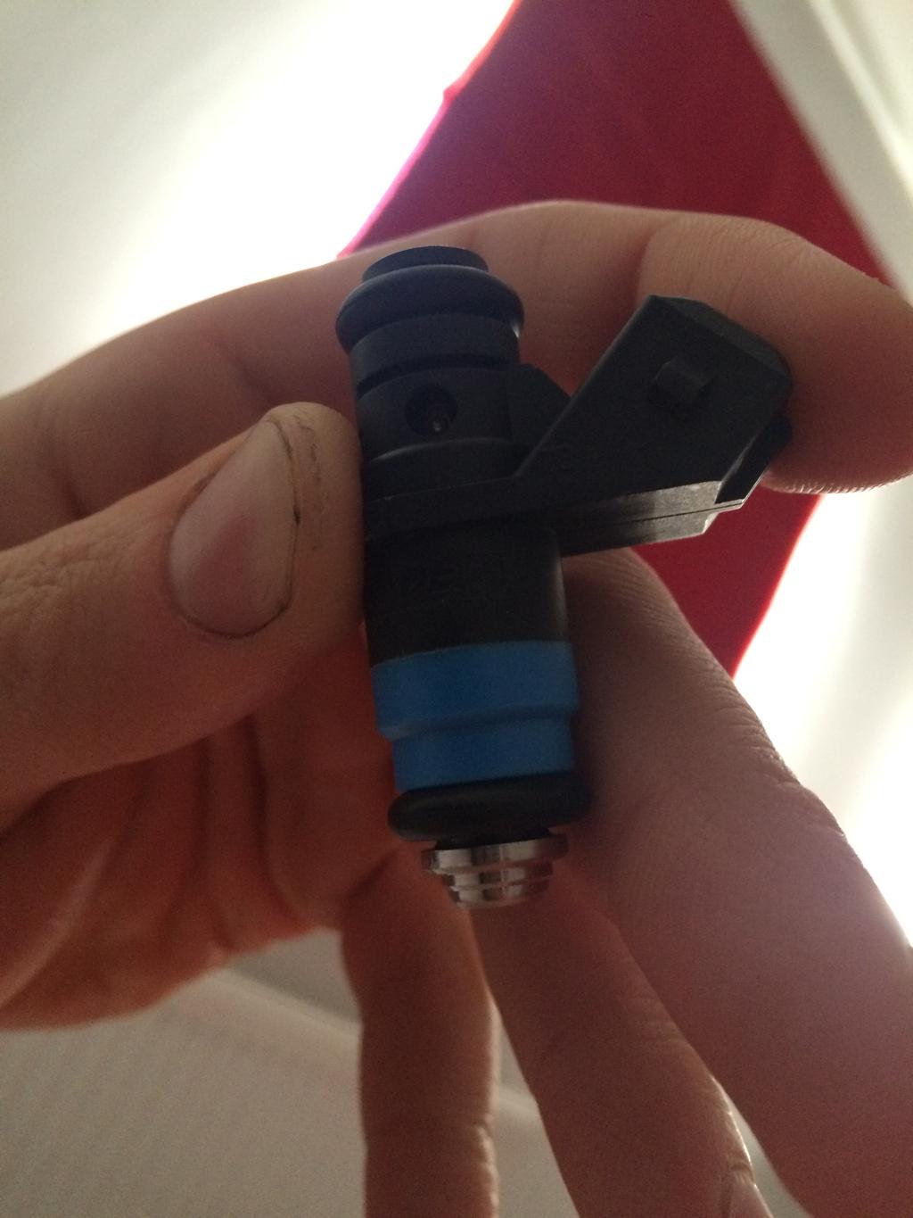

Then yesterday the final piece to the puzzle finally arrived
Siemens Deka 630cc injectors
Is booked in with Paul at RS tuning on 5th of March for mapping, hopefully see around 285bhp and torque limited to 300

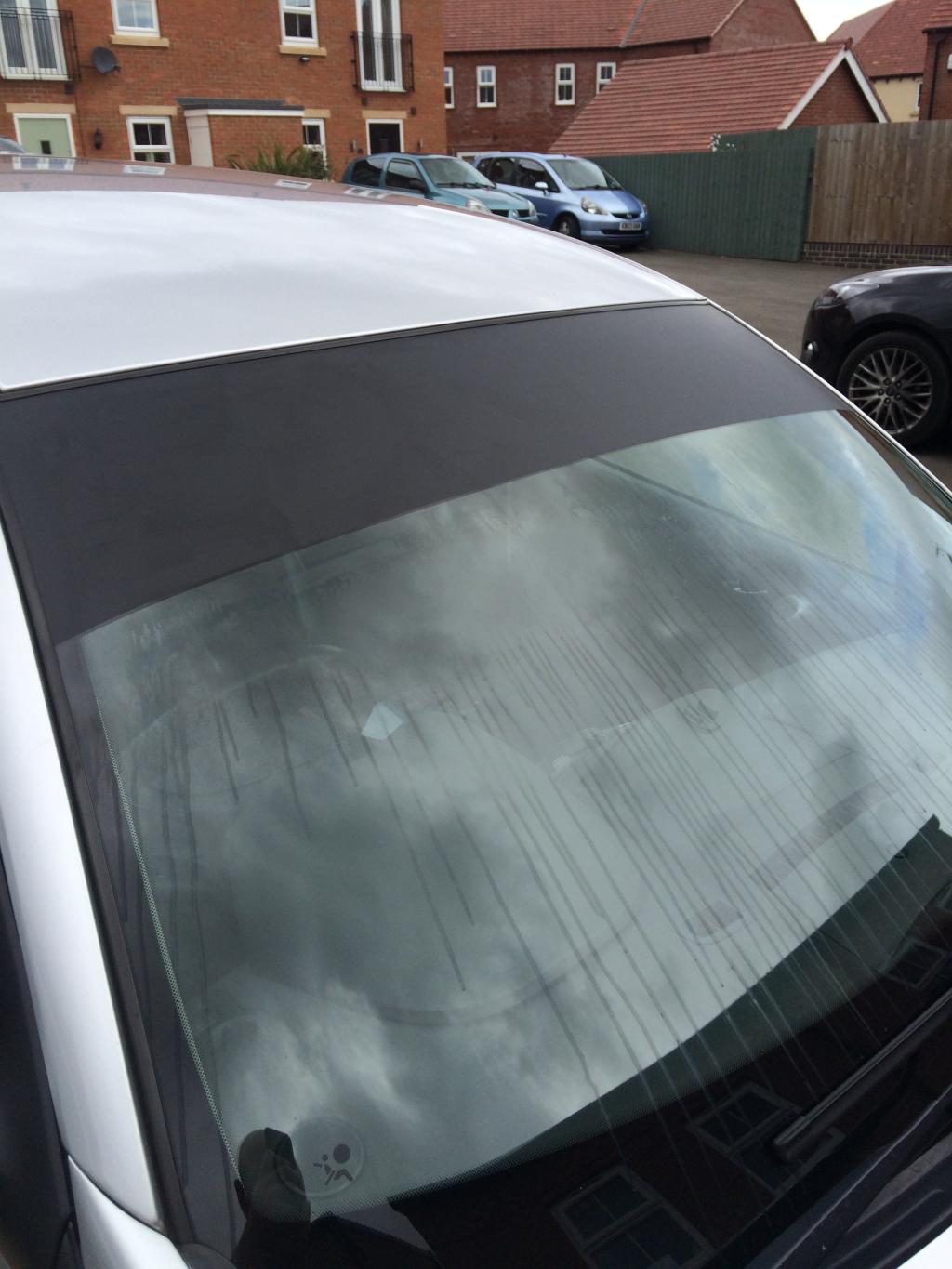

So at the weekend I thought I'd bang me matte black sunstrip on.
I dunno why but I like the look of these and the makes them look a little more racey ;) also I hate having sun visors down!
Here's the out come
No bubbles, creasing or swearing which judging my track record is pretty good. Also brimmed it with Vpower today ready for the trip to RS tuning in thursday!

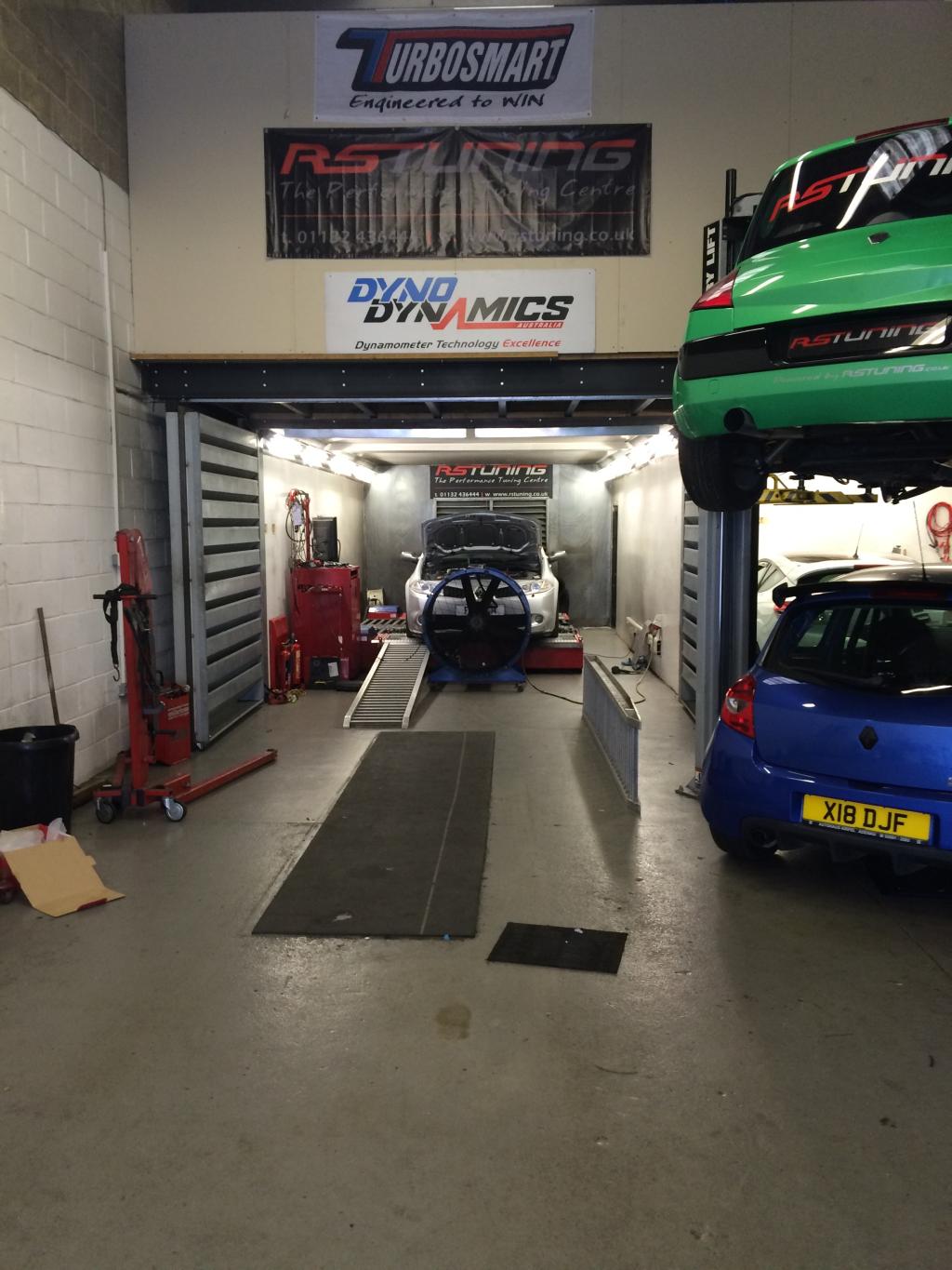

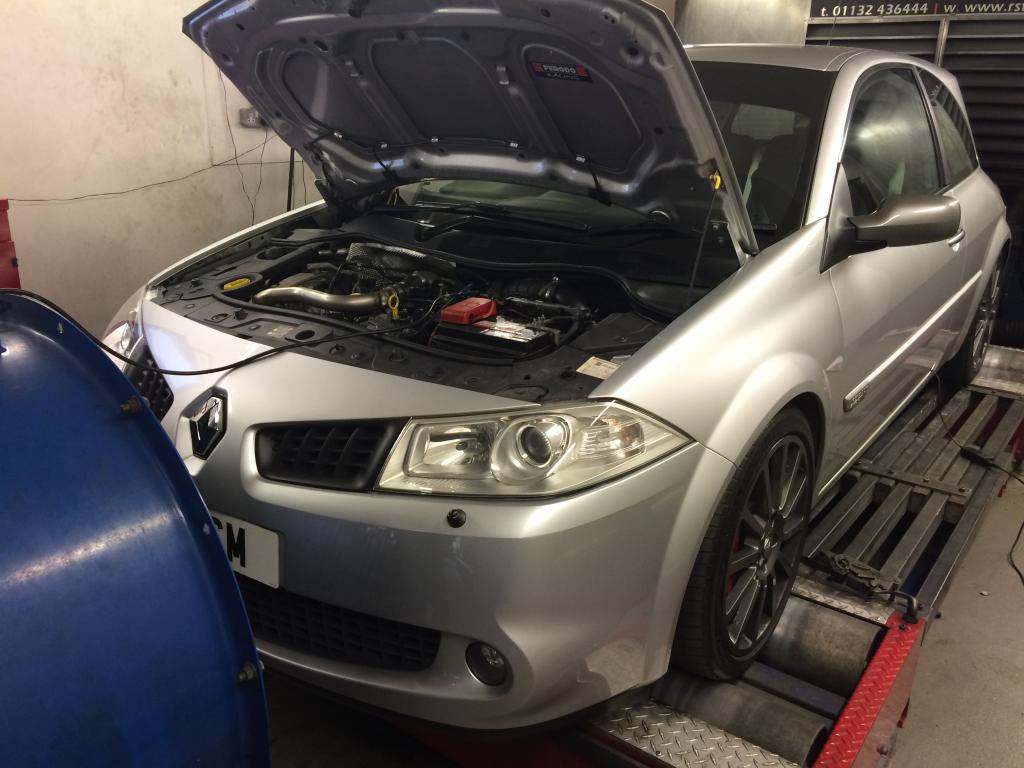

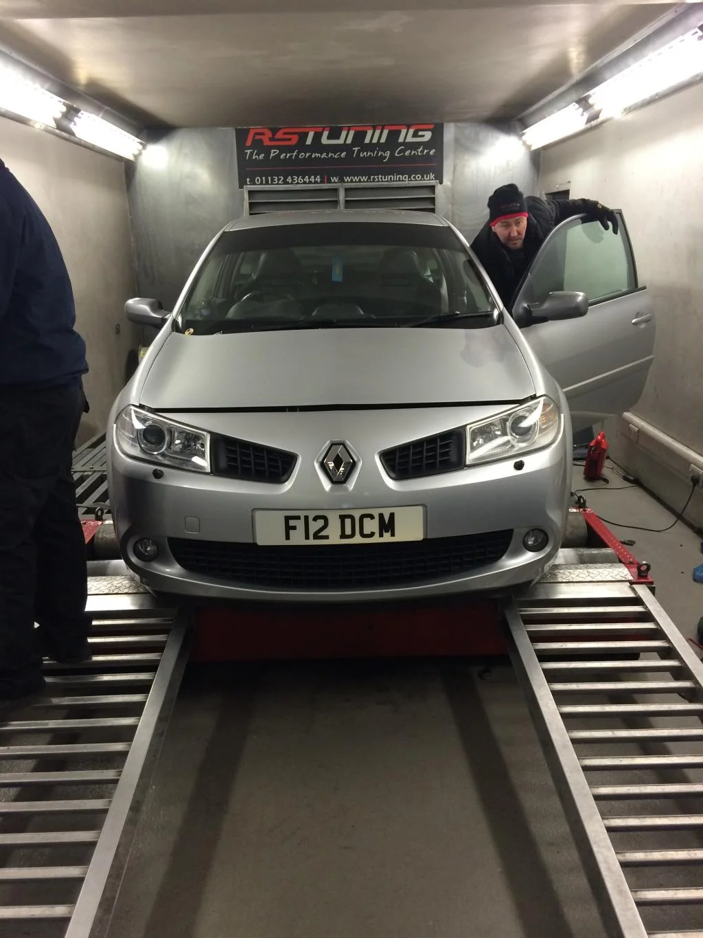

So headed off to RS tuning this morning after a night shift.
Steady drive up thanks to the 50mph average speed on the M1.
So got there and the guys were a little behind but the banter kept us entertained.

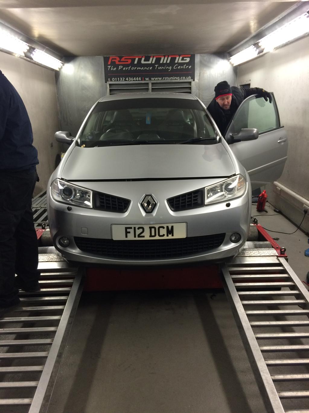

So Paul got the car on the rollers and we got the injectors swapped over and Paul set to work.
Slight clearance issues haha
Speccky doing a spot of photo bombing
And the proof is in the pudding

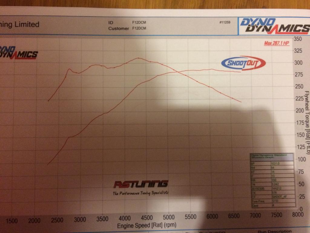

287.1bhp and 312ftlb by looks of the graph.
Transformed the car and the way it drives, proper savage and a load of fun!

Nice results! Thought you were limiting the torque to 300, what happened there lol? Mines 320 and I'm concerned, do I need to be? Who knows....
  Megane r26
Paul took me keys and worked his magic, even left the missus in the car until he had to put laptop on the seat haha
  535d / t5 caravelle
From what I gather he keeps it around that mark, I wouldn't get overly hung up on it matey.
Cheers mate, it's not overly interesting haha
i try not to, but it's always something in the back of my mind, I've only had the car 3 weeks, but it's ran this spec for 2.5years so I guess I should just chill
