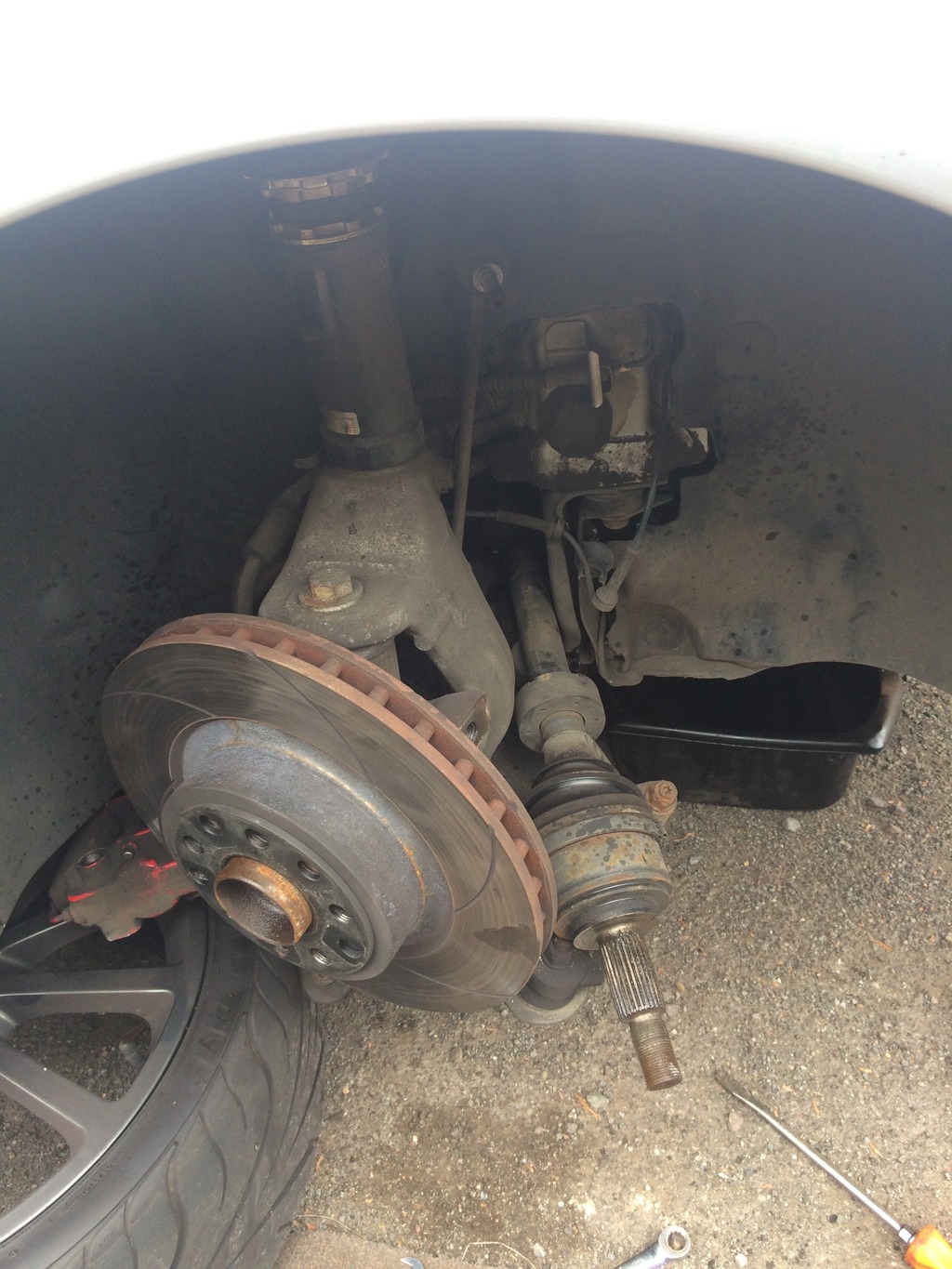

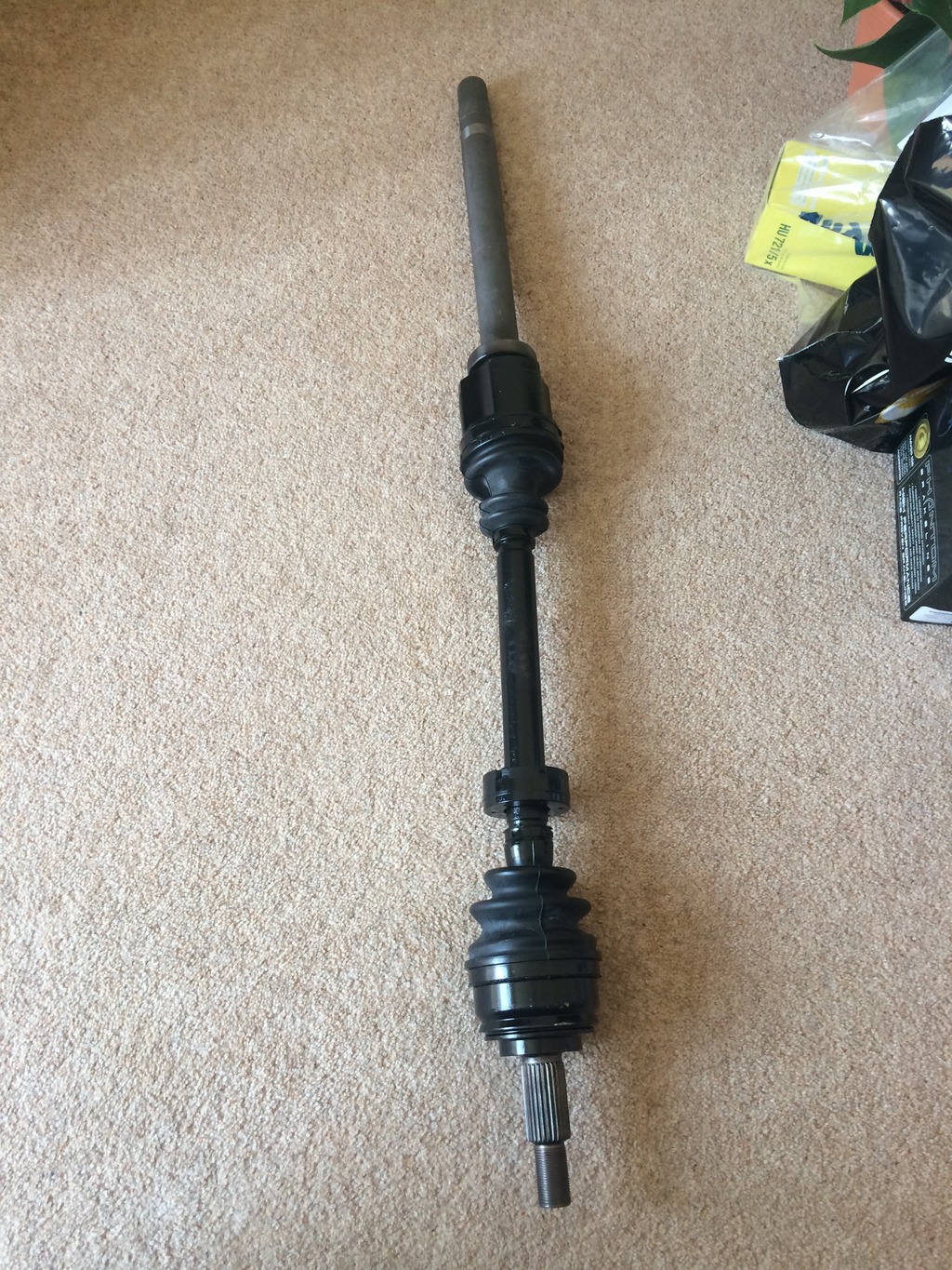

Few bits to update swapped the driveshaft out on the drivers side, came out in two bits!
Also gave it a bit of a service in prep for the big trip.

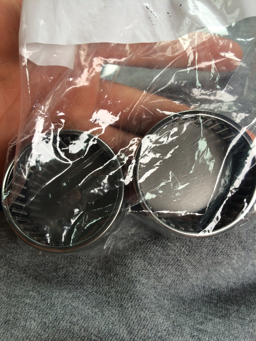

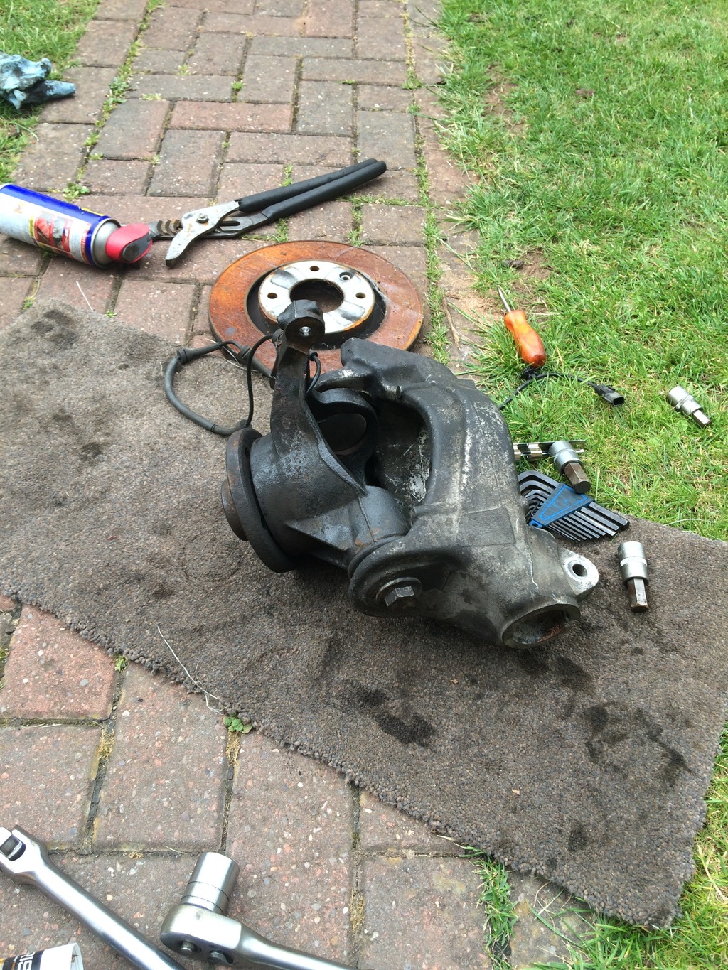

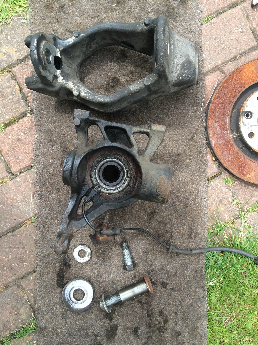

Then I stripped and rebuilt me hubs today with some new bearings from Derby bearings.
People seem to be afraid of these hubs but the job really is a piece of cake and can be done with basic tools.

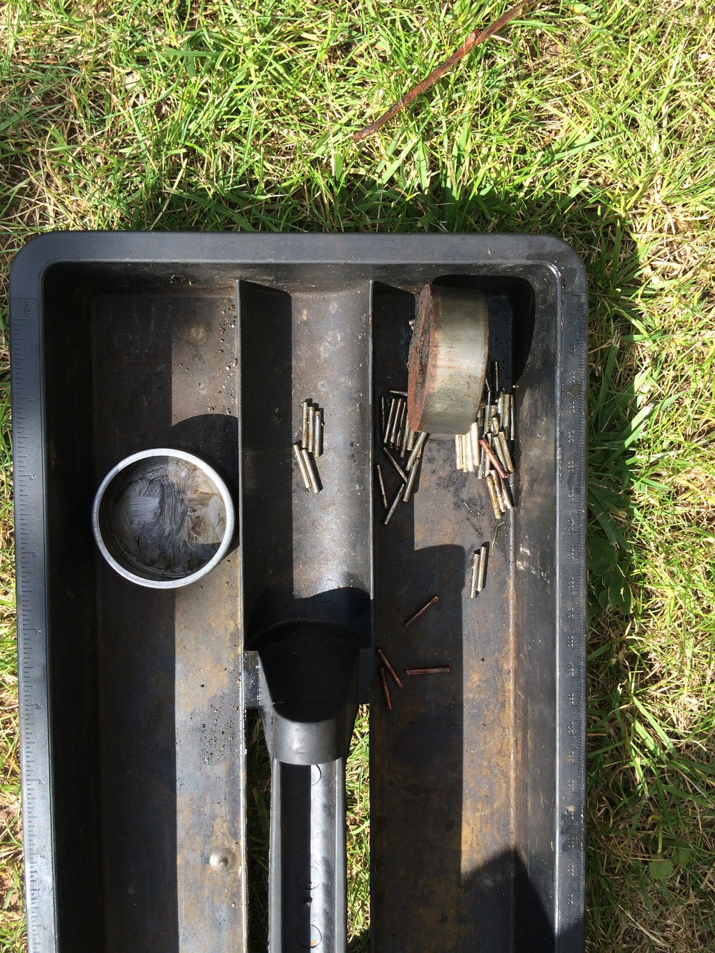

New bearings, quality skf items
Hub stripped
Old bearings
All built up
Really is an easy job and even though mine weren't in such a bad state it really has improved the drivability and doesn't seem to wander so much

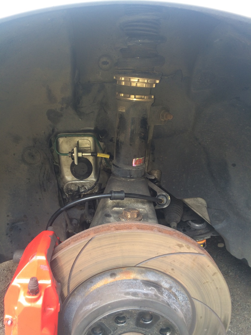

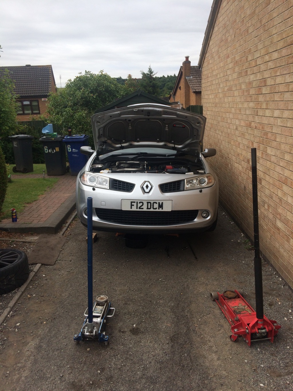

So today I spent a couple of hours swapping the brakes lines for the braided goodridge ones earlier in the thread and giving the car its final once over before the trip to the ring Friday
Anyone pics of front hoses
Also changed the brake fluid for rbf 660 race fluid, all bits for JJC with discount [emoji106]
Pedal feels seems much more positive now especially coming down from high speeds.

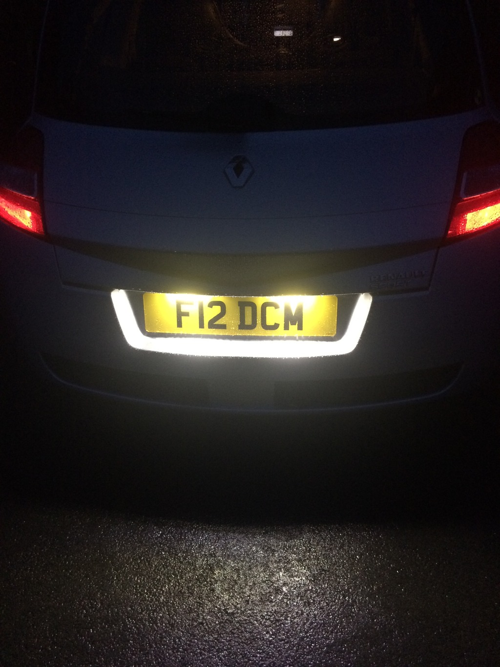

Also few weeks ago replaced the knackered boot wiring loom and fitted some new smd number plate light units
In my opinion it's a little cheap touch which makes them look a little more premier lol
