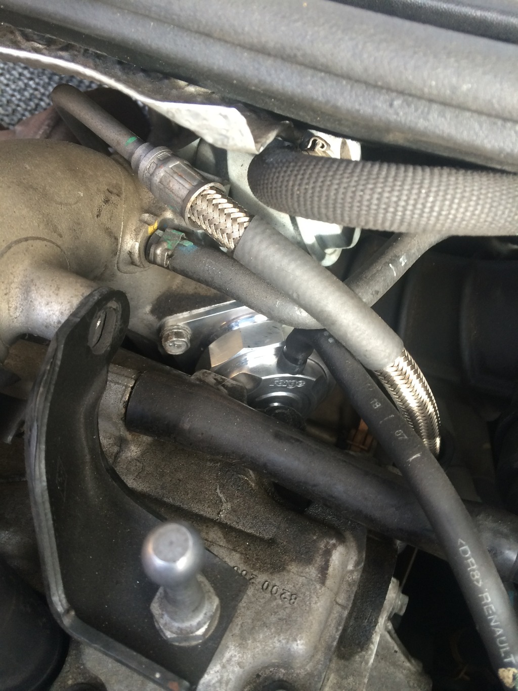

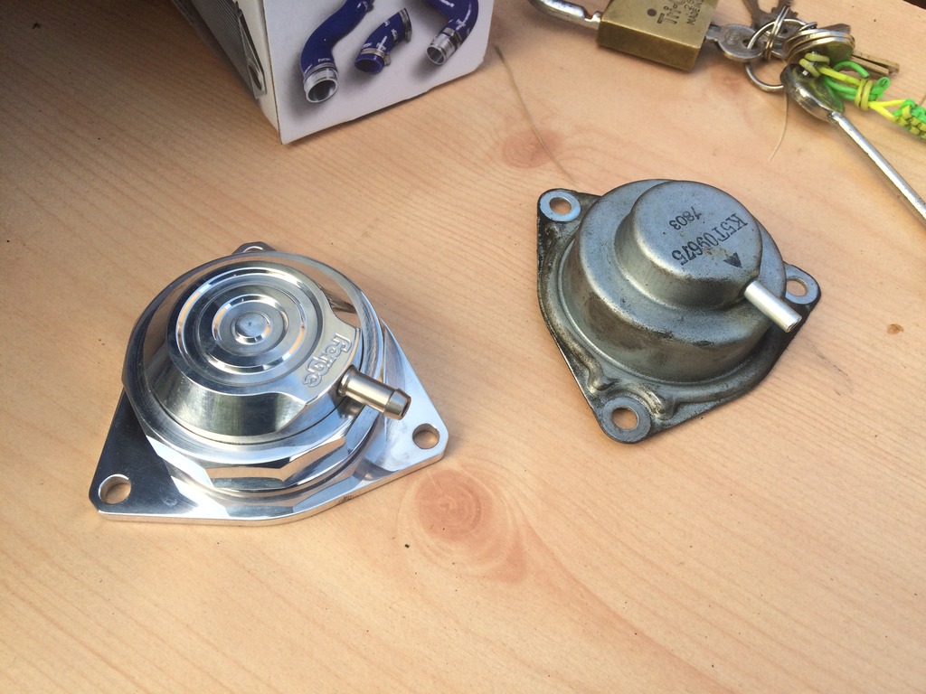

So woke up this morning, one job on the to do list.... Fit me forge recirc valve.
So popped down to me old mans as all me tools are there and got cracking.

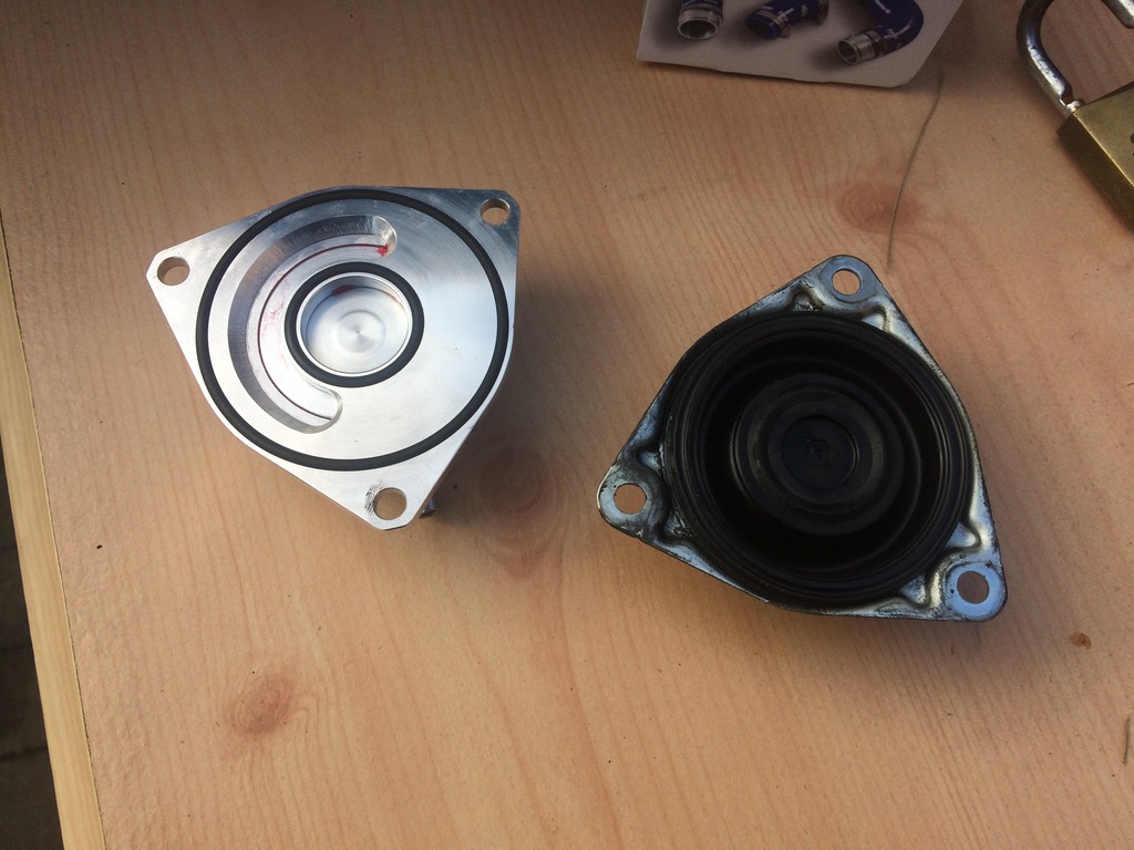

Old valve compared to new one
Stripped the forge item and applied a little grease to the threads before fitting in just incase I ever need to get into it and to prevent any corrosion
New valve fitted
New valve fitted
They're fun to fit, aren't they ;)

Took you 25 mins, you must have hands like a new born baby, it's an ass of a job.
Did you remove the inlet?
  Megane r26
Yeah pulled the intake pipe off, the only bolt that was a tad fidderly was the one between the valve and the rocker which I stuck magnet to so I didn't have to worry about dropping it.
I have normal size hands I think, I'm a time served volvo tech and now work on trains where most jobs are awkward haha

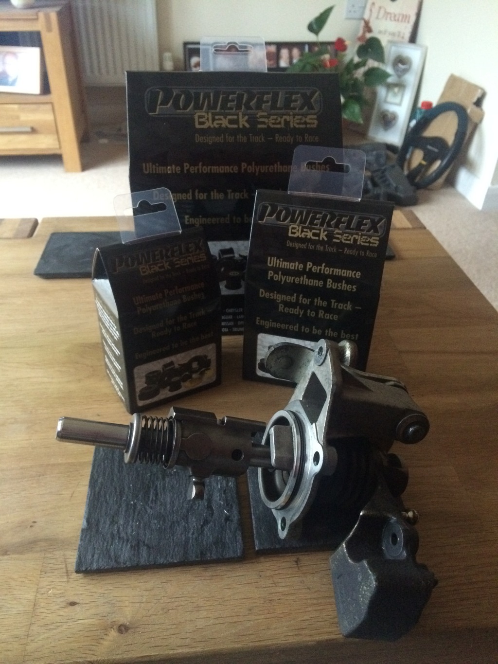

Received my powerflex black series and my short shifter
So I'll be getting busy getting these fitted and the car ready for Oulton on Tuesday.

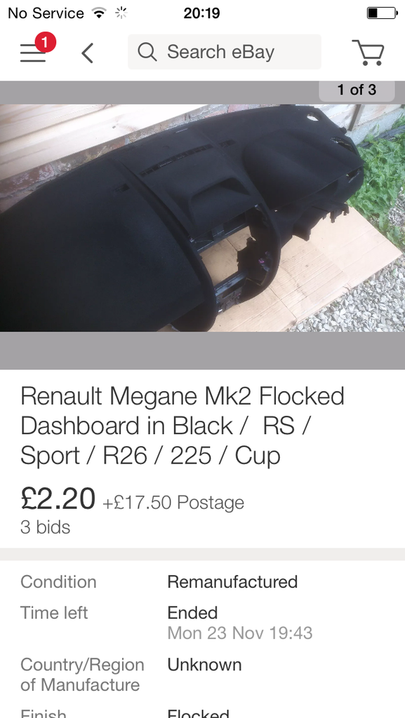

So had a text from a neighbour today, went a bit ebay in the pub and got this.
Flocked speedo binacle, start of the flocking as the find the dash reflects bad and it looks epic if done well.
Looking at a few daft but cheap dailys, old imprezas are flavour of the day atm
