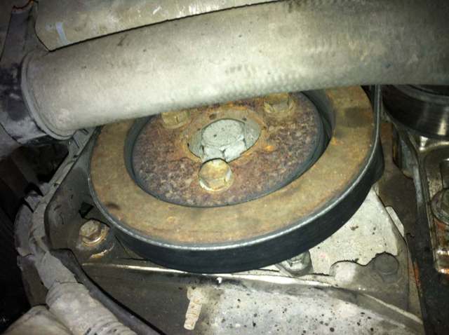

Went for a spin after resolving most of the niggles and could smell burning rubber or plastic. And the suspected clutch noise was getting worse! It didn't seem to matter whether the clutch was in or out either!
Popped the bonnet with the engine running and saw the crank shaft pulley on the pi$$! It was all over the place and had pushed the alternator belt into the plastic crank casing. It was happily sawing it in half as we stood there in silence.
At least it wasn't the clutch! Whoop.
Bad news is I need a new crank pulley damper wheel thing.
I think it has a rubber centre which has perished. So the inner wheel is just spinning and the outer one is doing what it wants.
At least it didn't happen on track.

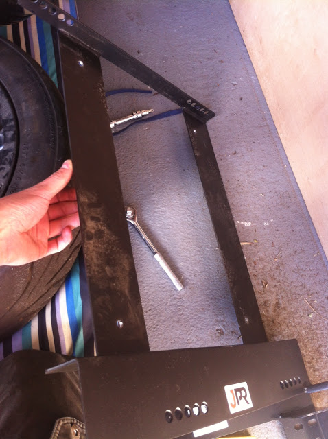

But I felt as if I was sitting too high and so then sold the old seat + the OMP frame and got a custom low frame from the saxp forum.
And now I know how Len_beach feels whenever he drives.
The frame didn't come with holes to mount the seat on, so I measured up and had a bash and drilling through steel. After shattering a drill bit, I decided to give that a rest and enlisted the old man to use the proper equipment. So I now need some decent drill bits.

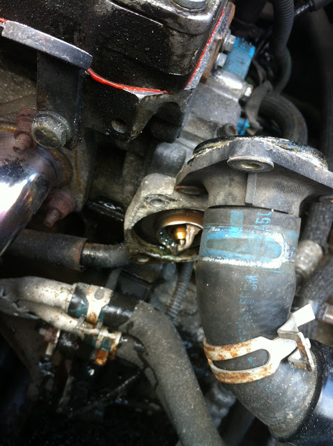

The last track event was marred by a fluctuating temp gauge/air lock and pissing water out when it felt like it. I purchased an 82 degree thermostat from 106 parts and bled the system on the drive.
At first, the gauge was fluctuating, so I used a 2 litre coke bottle to expand the range of the header bottle and bled the highest point first. Then the 2nd bleed nipple on the thermo housing, finishing with the bleed on the radiator. There was no fluctuating and the thermo opened on cue - and so did the fan. Hopefully that has cured it.

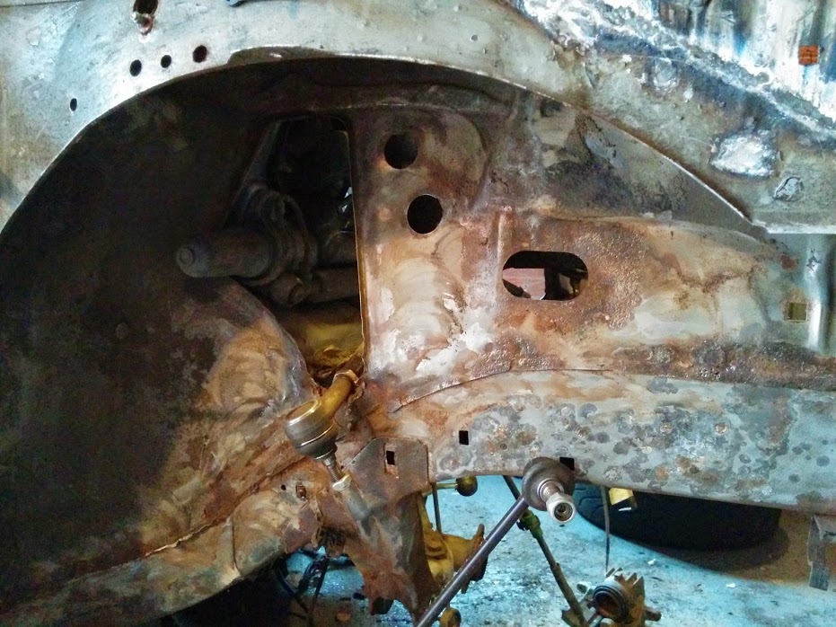

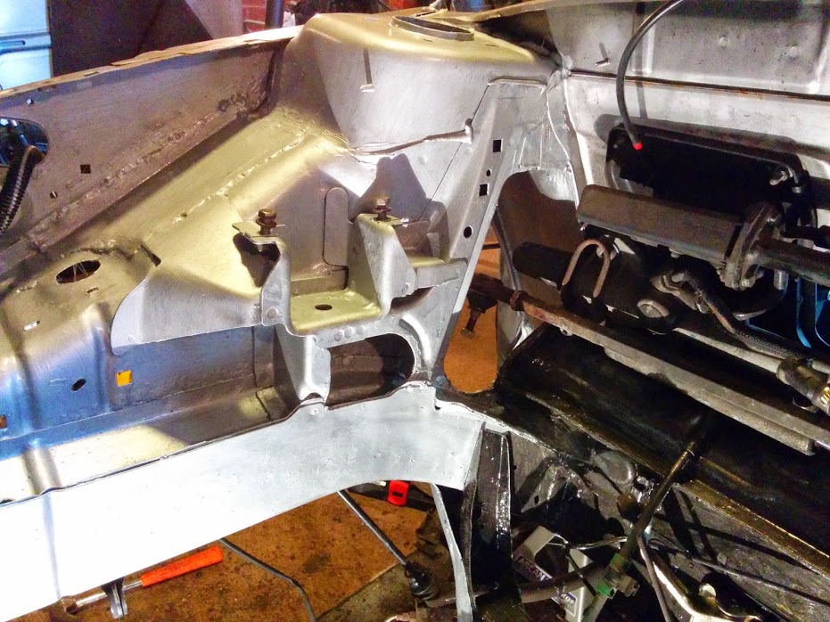

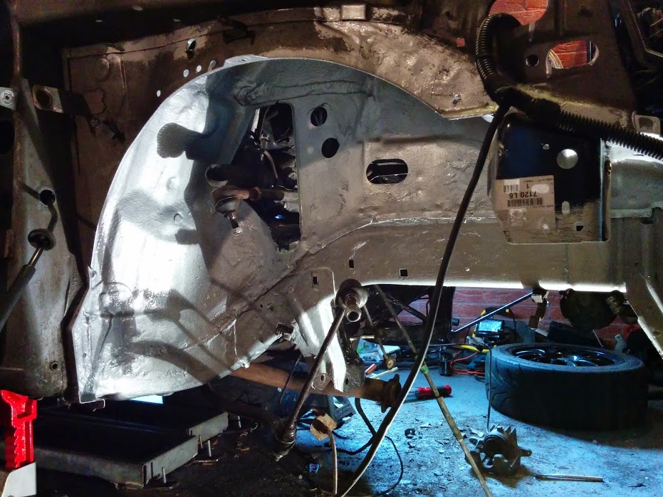

- Wire wheeled the entire front end pretty much, cut out the rot and plated up.
Before:
After:
The bumper hanger 'wings' had to be replaced - you can see them in the picture above (with the sticker on).
Plate welded in (same at other side):
Common place for rot, unfortunately, but its done now.

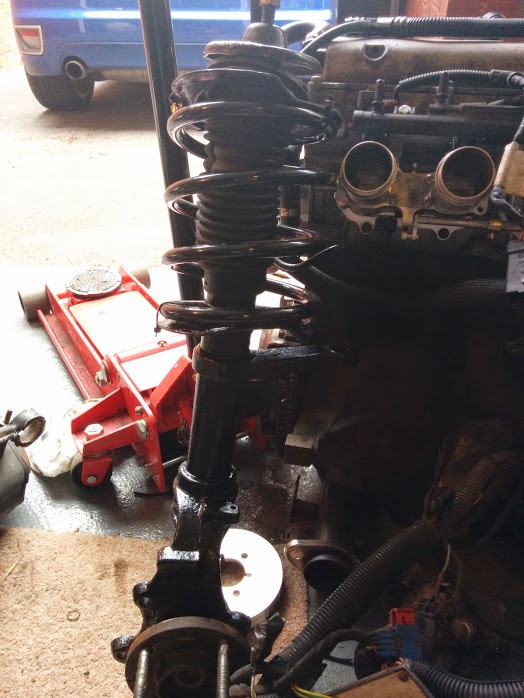

Had some more custom springs made up from Faulkner, as the last set were a bit too tall (but perfect lb rating).
- New wheel bearings
- New ball joints
- New top mounts
- Bit of paint on the struts

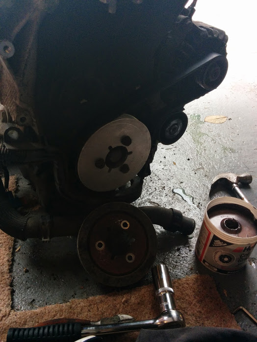

Also my mate machined that solid crank pulley seen on the floor below, so that's gone on as well.

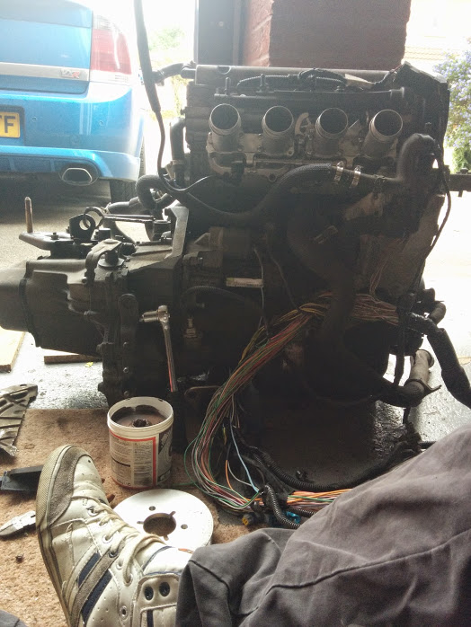

Series 1 Rallye 1.3 Gearbox installed with lightened flywheel and relatively new clutch.

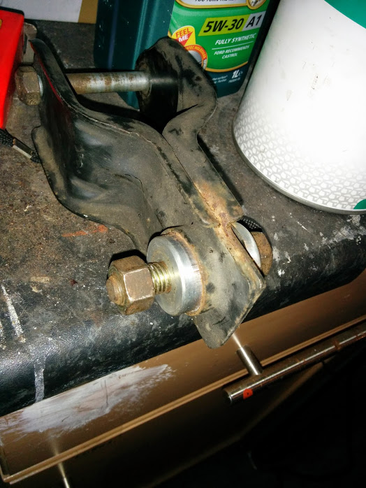

My pal welded up a clutch arm too - so its now double the thickness (after being donated by RickyP)
Not sure you can see it too well in this picture.
- New gear link rods purchased from KAM racing to compliment it

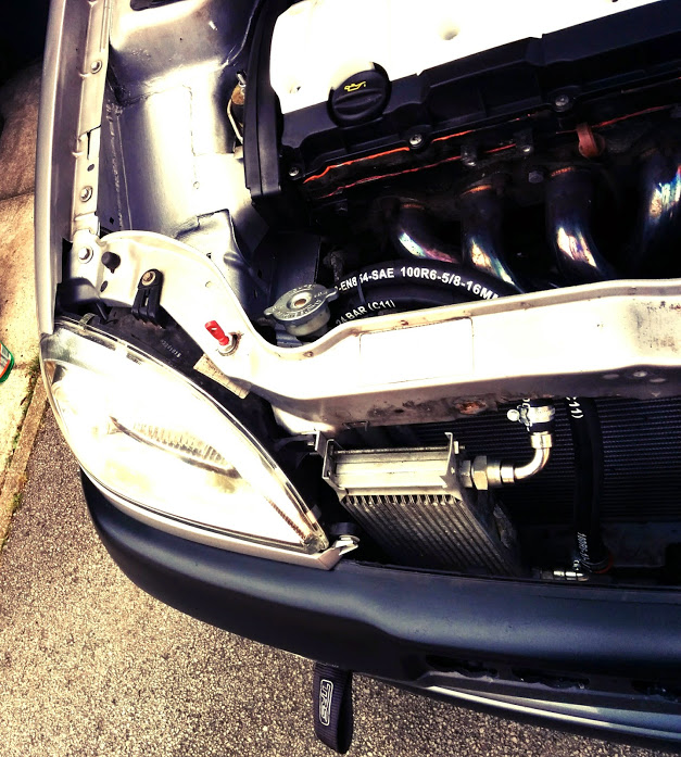

You might also see the water pipe above with two jubilee clips attached? That was what ran for the heater matrix, so joined that up and added a restrictor.
JP4 covers installed, they were a free gift.

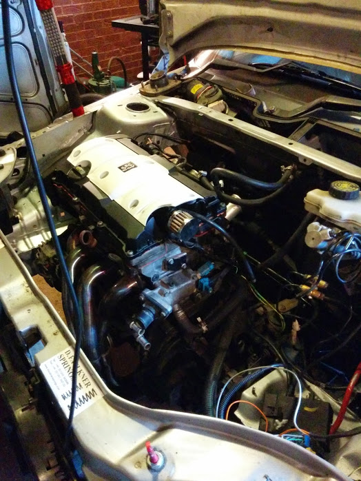

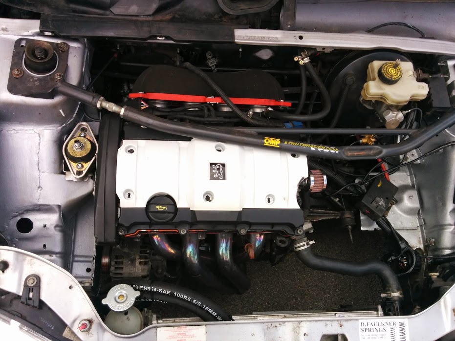

I trimmed the loom down and with assistance put the engine and box back in.
Started to put it back together with:
- New top hose to thermostat (taken from 106 gti which didn't run the oil/water heat exchanger)
- Mocal oil cooler

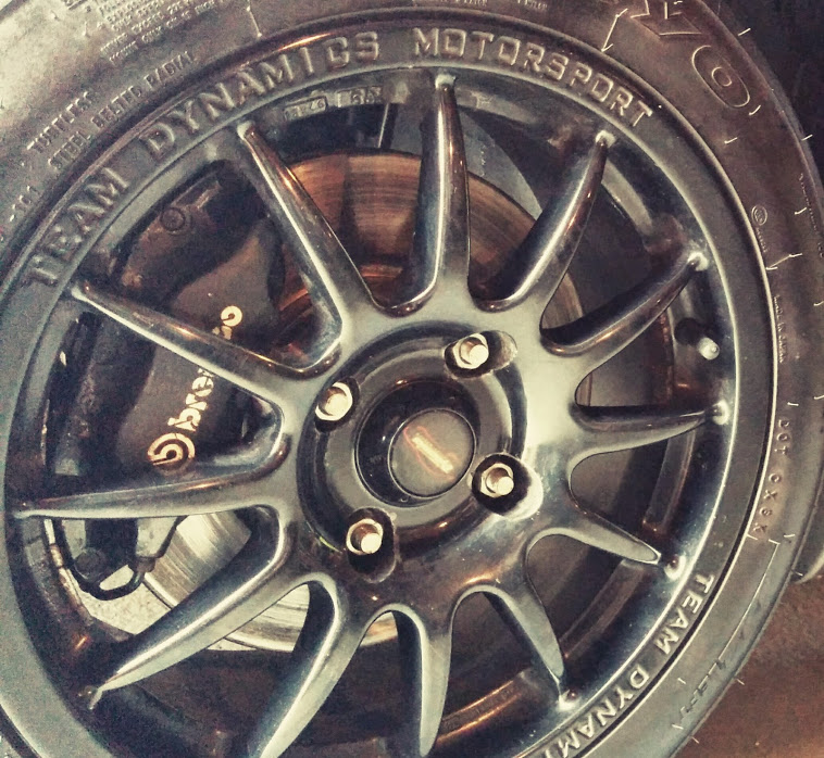

- 406 Brembo calipers
- Baker-BM engine mount (already had the gearbox group N one)
- New drivers side drive shaft (found the vibration!! it was the carrier bearing on this shaft)
- New high-temp grease deployed in both shafts
Oil cooler as mentioned.
Not much under there now.
Brembos - DS3000 pads
