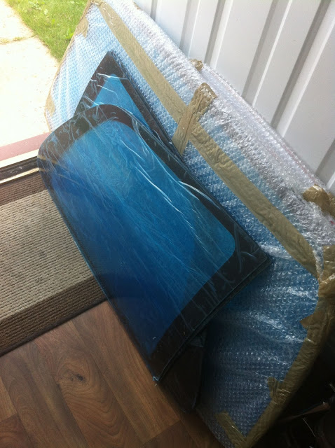

Poly windows have arrived - but didn't get chance to fit them for this outing.

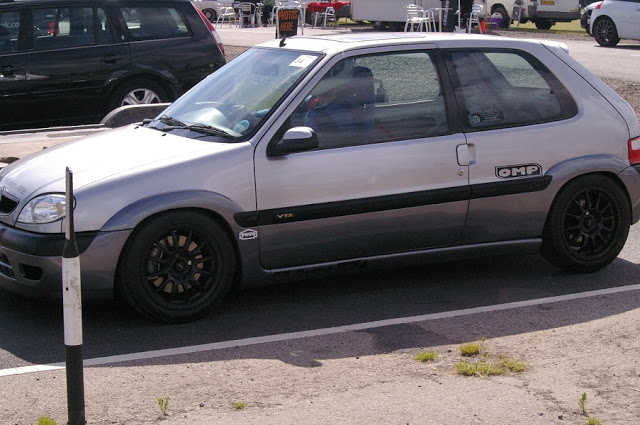

Anyway, the track day was great. 5 of us took cars and it was a great day out comparing performance and driving ability. I'm pleased to say that the saxo felt as strong as ever - now with a new radiator, the temps stayed low. With upgraded brakes I had to re-learn the braking points but KenH on the forum had us down at over a second quicker than our last time out. I also managed to remove a bit more weight from inside (on 10kg or so) and the weight + power gained from the stainless steel 4-2-1 was also of benefit.

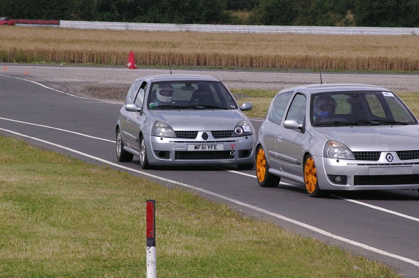

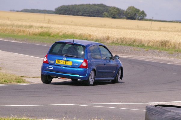

Dan spent most of his time on 3 wheels tbf - the clio cup went pretty well though.
Len had new suspension but still couldn't get past the fancy colour 182.

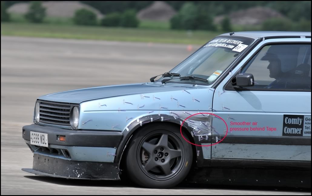

The other Dan in the group had issues with his saxo - basically running mis-matched front dampers caused instability in corners and he is steering into the slide here.

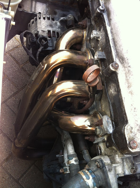

Ps that manifold looks nice! Did you not consider heat wrapping?
Considered, but then read about some of them cracking? So didn't bother. As its only a toyosport job (not exactly renowned for quality - albeit this one does look nice and well put together) I was a bit worried tbh.
Could still do it now though? just be a bit fiddly!?
leeds_182
North Yorkshire & Humber
Yeah, proper fiddly. I've never bothered on mine.
Mani does look sweet! Do you find it makes a nice (albeit subtle!) difference?
Never bothered with heat wrapping mine and never had any issues with hot temps in the bay or components withering away lol. Wrappings a faff and looks messy IMO.
When heat wrapping falls in bits, which it inevitably will do over time, it goes into little fibres and any oil or water leaks there are it will stick to it. It is a b*****d to clean off as well.

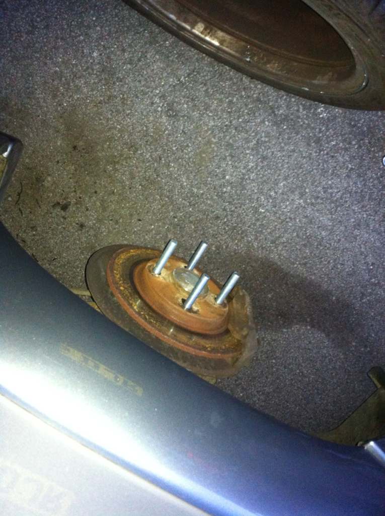

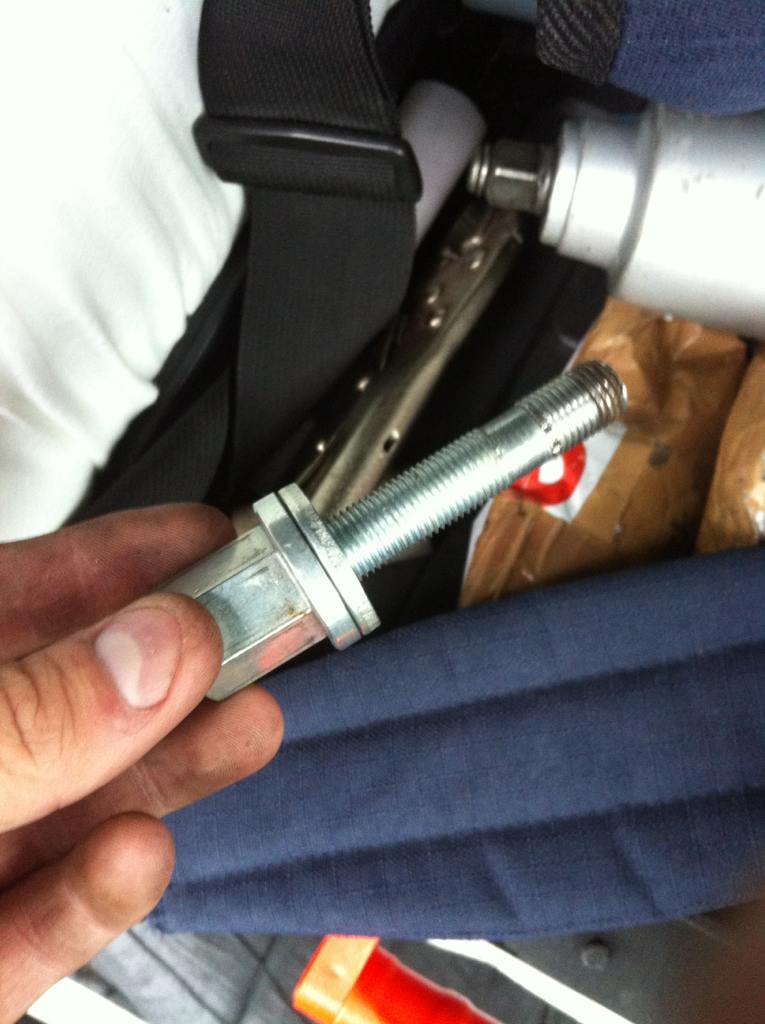

Got in about an hour ago from fitting the stud and nut conversion. What a faff.
The fckin spigots had melted to the hub (plastic ftl) and how the fck do you know when to stop tightening! Had to get the spirit level out to see if they lined up about right.
Stuck a bit of loctite on them too, but ran out of day light and so only one side is done! Slow progress.

LOL at how do you know when to stop tightening! Measure depth of thread, wind in that far, done.
I got 80mm threads and had 60mm extended bolts before. I got to the 60mm and the fookers kept going. I've just put my faith in the loctite. What's the worst that can happen?
Caldwell a week today :) nom nom, tasty Armco.
Donny_Dog
  Jim's rejects
Probably because your hubs are drilled all the way through. If nothing's catching and you've gone in as deep as the hub is you're fine.
When I die, my parents will hold you responsible.
Heard about dan. Omg.
If you kept screwing too far they will touch the hub and the wheel won't turn. I'd definitely measure it, they might not be locked but they could be a mm off touching.
Donny_Dog
  Jim's rejects
They're not that far in dude! I was just wondering how far you should go - I've done it to the collar but wasn't ultimately sure if that was good enough. Lolz.
