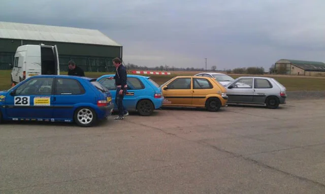

Believe that's you at Blyton? Was there with my mate in his Megane and got that shot which Facebook proceeded to screw.
Lolz yeah that's me. My old man had a few goes as well. What megane were you in? Post a picture up.

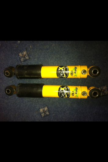

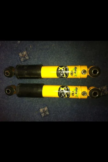

First up is a set of spax adjustable rear dampers. £29. They are spax psx jobs and look pretty new!

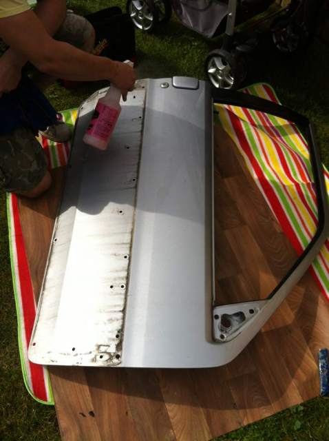

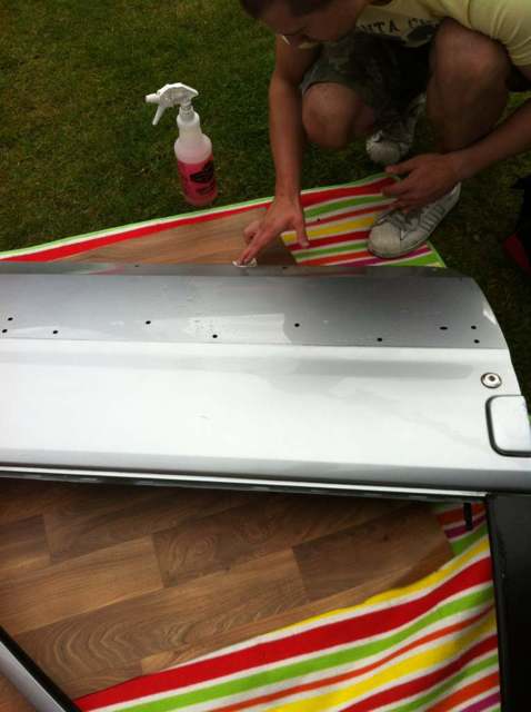

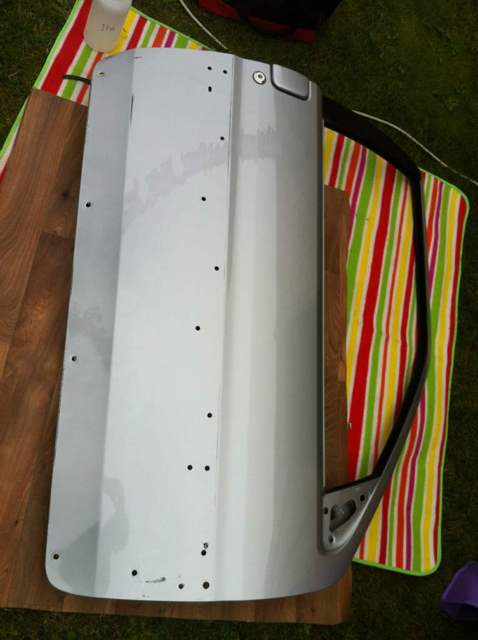

The spare door (to replace the gashed drivers one) arrived too, so I stripped it down last night and the neighbour prep'd it for me:
Clayed, polished and the top half waxed.
Mint!
Just need to extract the key barrel and handle - will hopefully have the door swapped at the weekend in any case.

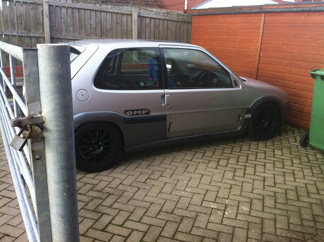

I went round to see the car after it had been sat for a bit. I started first time though. The remains of stripping the door down before swapping it are clearly visible.

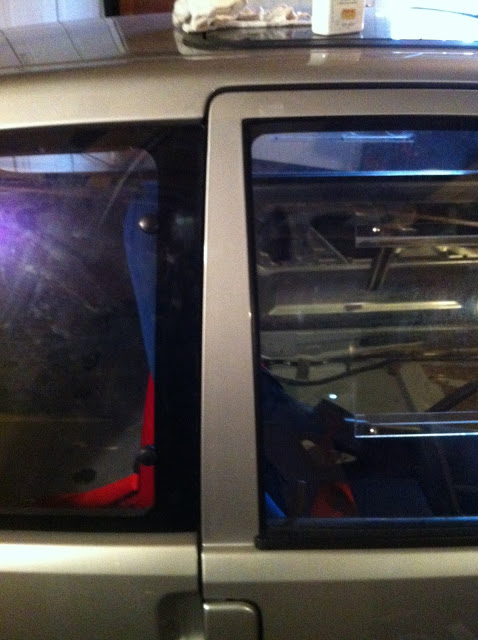

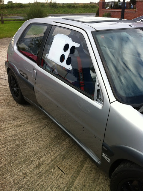

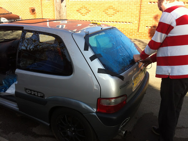

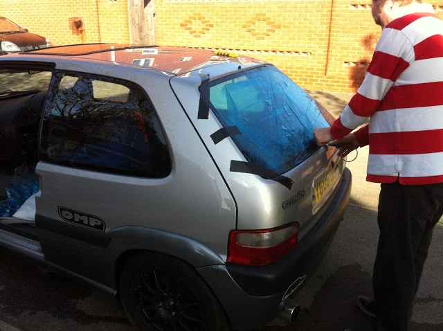

I purchased a door for £20 and me and the old man installed the poly and mounted it.
No more dent. Got the neighbour to run over it with the polishing thing and the trim is now back on as well.

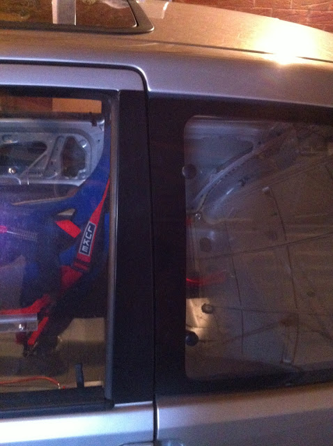

Rear quarters and rear window polys also installed.
I had won some adjustable rear dampers on ebay for £29. Appears they were cheap for a reason - one of them would not compress. I was 2 days over the claim period on EBay :( so they came off.

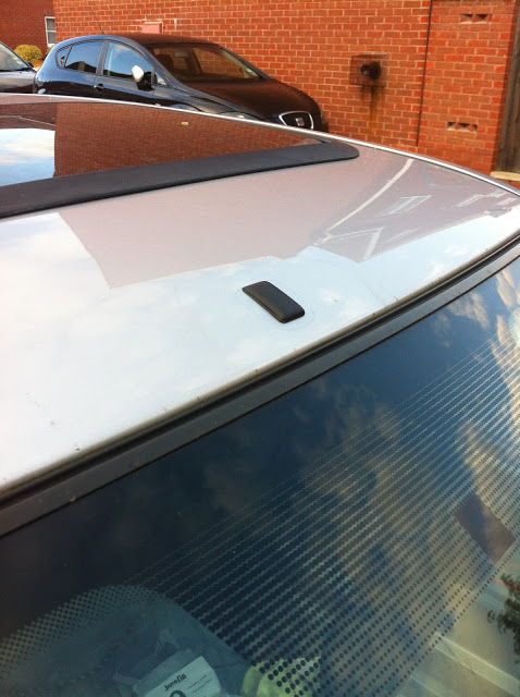

Aerial blank installed - just a gimmick thing really, but allowed the wiring etc to come out.

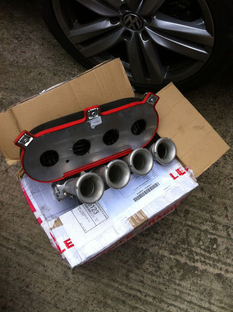

A few weeks ago, I went a bit mad. The following parts were collated after a short search:
- AT Power Throttle bodies
- 708 cat-cams
- Standard ECU unlocked and mapped for the above bodies and cams + 421 and decat

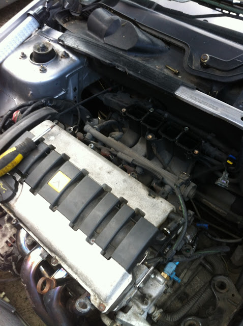

Top taken off, ready for removing the standard inlet arrangement.
AT power kit ready to go on, but cams and belts first:

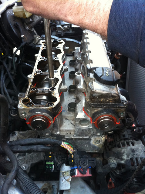

standard cams in place - ready for removal:

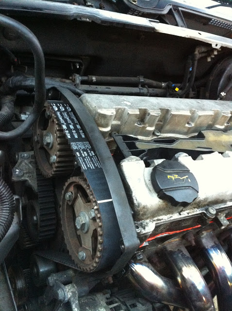

Belts and pulleys off, new cams in. Tightening the ladders

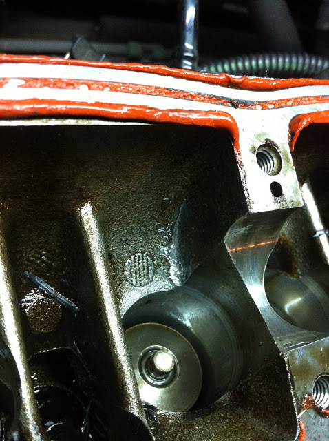

Unaware that the inlet cam wouldn't rotate fully at this point :(
Belts back on, timed and ready :)
Only to manually crank the engine and it locked :(

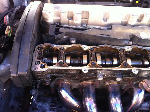

Turns out the inlet cam was scoring the casting. Out came the dremel.
..and the resident mechanic!

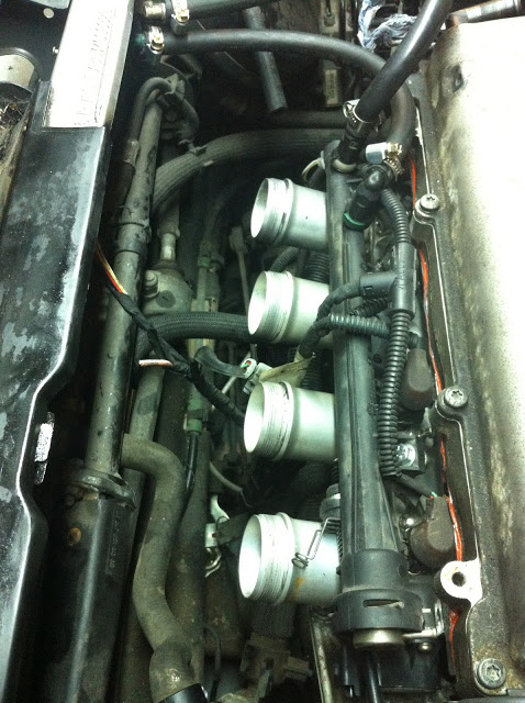

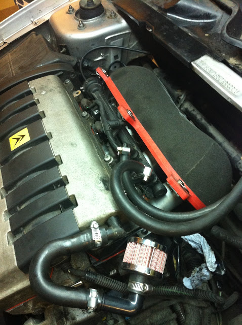

With the cams in place and rotating freely, the belts back on and everyting sealed, it was throttle body time
The AT power unit uses the standard throttle cable (although you have to trim it + mine was missing a brass nipple which allows you to trim and then re-fit the cable at the desired length), injectors and fuel rail, FPR, air mass and the OEM throttle position sensor - although wires need extending for that. After a day to sort some connectors and the throttle nipple, the only remaining issue was the vaccum line to aid braking - the normal one wouldn't fit, so need to source one ASAP.
Although a bit fiddly (for the old man - I was watching for most of it!) the bodies went on and the air filter to boot.
Found a bit of rot starting under the ECU tray - seems common on these. Slapped a boat load of grease on there, to try halt it for this year.
ECU isntalled (after unlocking my old one by pulling out the immobiliser when it was running LOL - these cars are really simple) and the moment of truth was in the key turn.
She fired up first time - Idling was a bit rough to start, but the oil got round and the cold start map switched (at least I think it was mapped for a cold start by chipwizards...) and off she went.

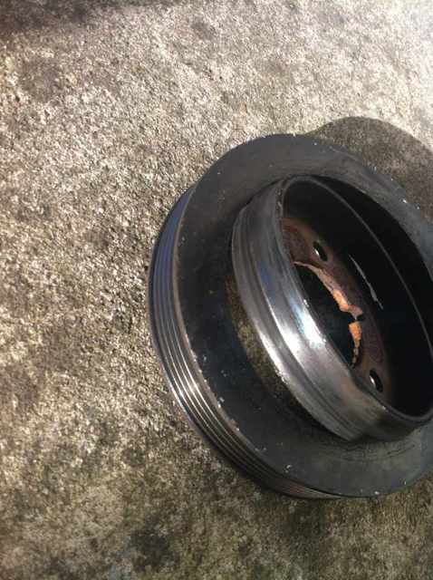

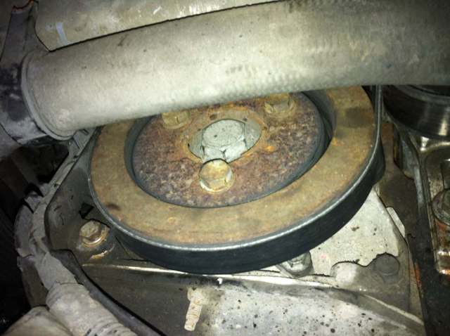

Went for a spin after resolving most of the niggles and could smell burning rubber or plastic. And the suspected clutch noise was getting worse! It didn't seem to matter whether the clutch was in or out either!
Popped the bonnet with the engine running and saw the crank shaft pulley on the pi$$! It was all over the place and had pushed the alternator belt into the plastic crank casing. It was happily sawing it in half as we stood there in silence.
At least it wasn't the clutch! Whoop.
Bad news is I need a new crank pulley damper wheel thing.
I think it has a rubber centre which has perished. So the inner wheel is just spinning and the outer one is doing what it wants.
At least it didn't happen on track.

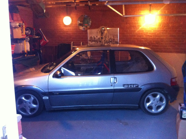

We moved house the week before xmas and so the Saxo came too - I finally got a garage, whoop.
The car sat there for most of January - whilst we moved in and got settled. I then started buying the odd bit off EBay in anticipation of this years track calendar.
Just as it was getting comfy in the garage, the 'fogged off' track day was re-scheduled for February and I thought I should pull my finger out.

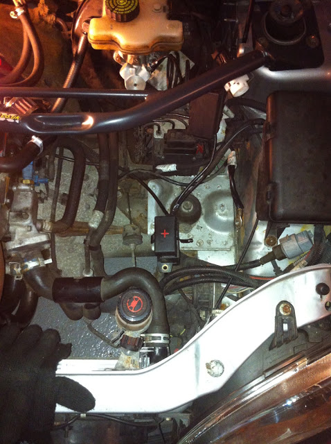

Len_beach was very kind and bought me a little cage thing for my Odessey battery that I bought last year. I was a bit worried that the little thing wouldn't be worth pi$$ing on, but after a slow charge it registered enough voltage to rise a smile and I started on the relocation.
Removed old battery + tray (the thing was massive and very heavy) - then replaced the old connectors with one from a BMW: Ebay FTW.

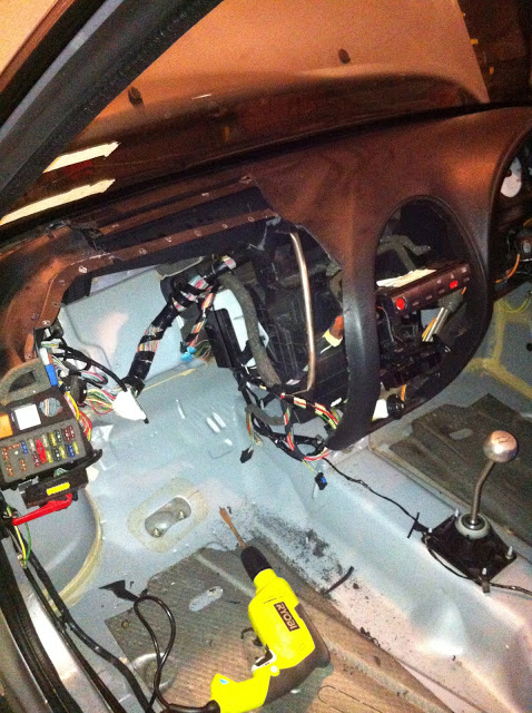

The dash was getting in the way, so cut half of that out. Will do the rest when a cage is purchased.
Could also get better access to the loom + alarm etc, so removed them as well. Drilled a hole for the new battery cable and put the new battery just where the rear of the passenger front seat would be. After a worrying few days of the car not starting (ffs), I traced the issue to a crap gearbox to chassis earth and then she was alive.

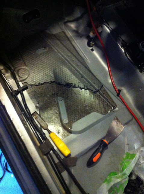

Borrowed Len's heat gun to get rid of the footwell tar (1.5kg in total).

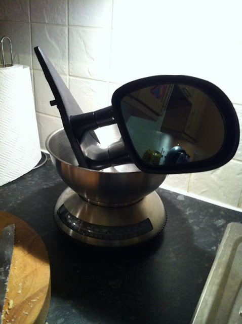

I also took off the old wing mirrors for some 'M3' style plastic EBay efforts from Taiwan!
Scientifically weighed them against the old mirrors from Citroen and saved 3Kg in total. Not bad, even if they are sh!t.

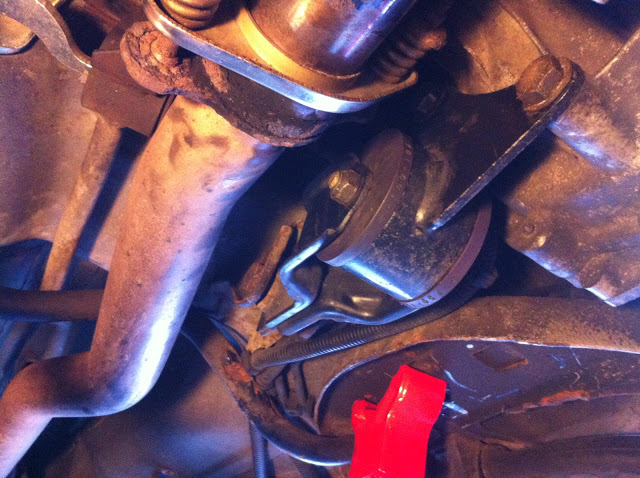

Then I managed to strike a deal with a chap on the saxo forum for the following:

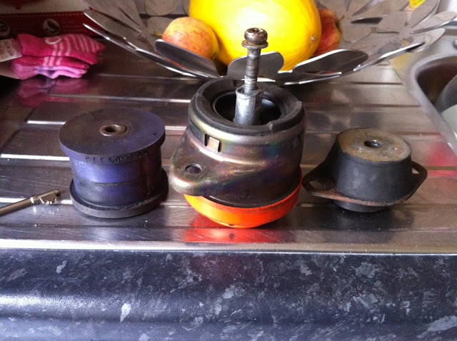

- Powerflex lower gearbox mount
- Group N top gearbox mount
- Group N top engine mount

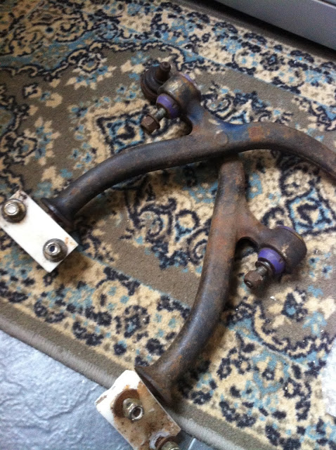

- Wishbones with solid nylon rear bushes and powerflex front bushes
Here are the first 3:
And the wishbones:

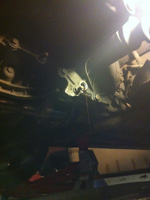

Ball joints were shagged, so bought some new ones and had a local garage press them in + press out the old lower gearbox mount.
New lower gearbox mount in:
Dropped the gearbox oil out whilst I was in that region. Didn't look like it had been changed since new. 12 years ago.
Fitted the wishbones around helping Len get his car fixed. Bloody wreck.
