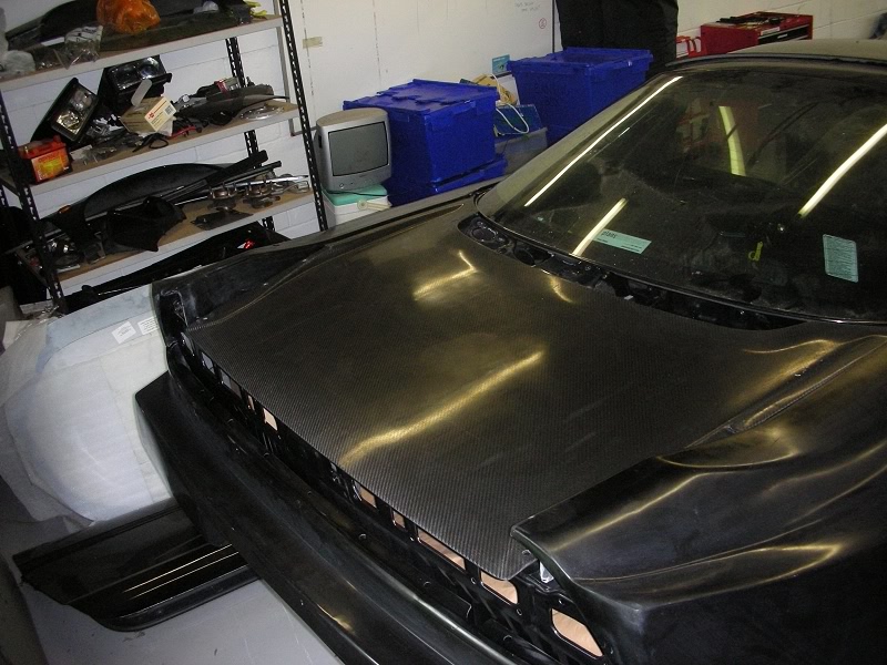

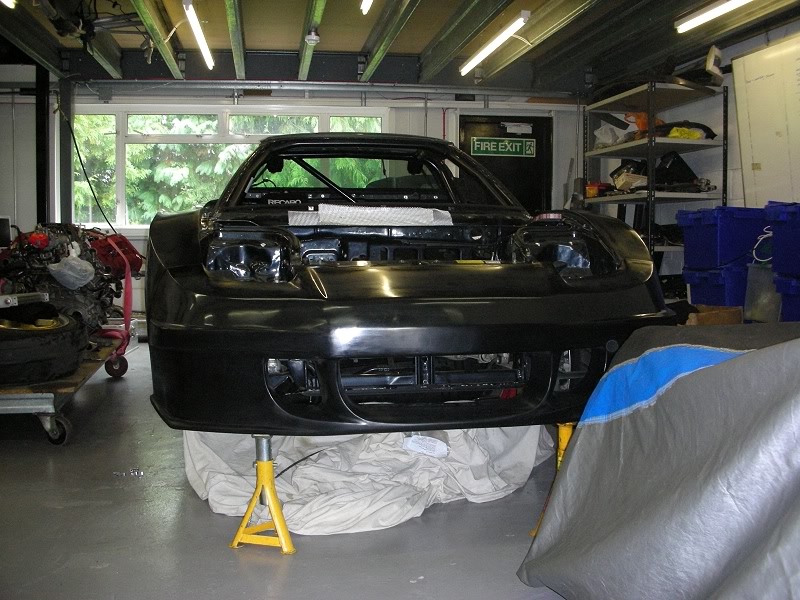

I would start one of these project threads if it wasn't so glacier like, but after 5 months of waiting for the bodykit for the NSX has finally arrived! Some may remember i was starting to worry if i'd actually ever get it, so to say i'm happy is a gross understatement!
As you will see in the pictures the kit makes the car much wider, so the next job is to fabricate some new wishbones. Currently awaiting a quote for inboard suspension compared to a conventional setup, but either way will incorporate centre lock wheels which will be cool...
Note the width of the arch!

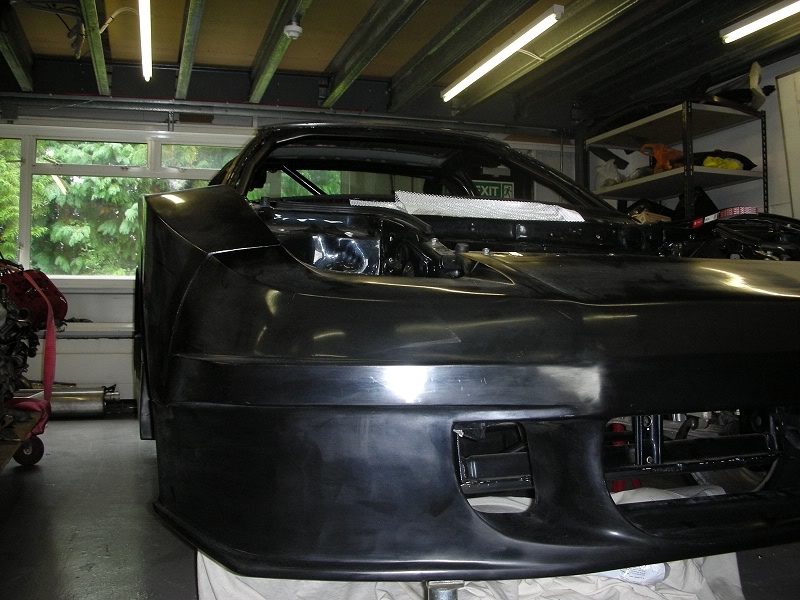

Close up

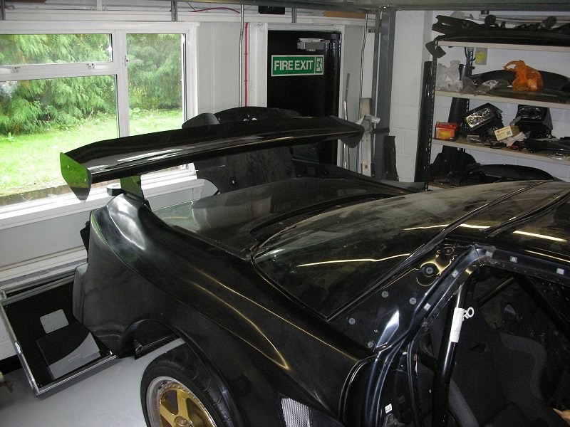

Rear wing

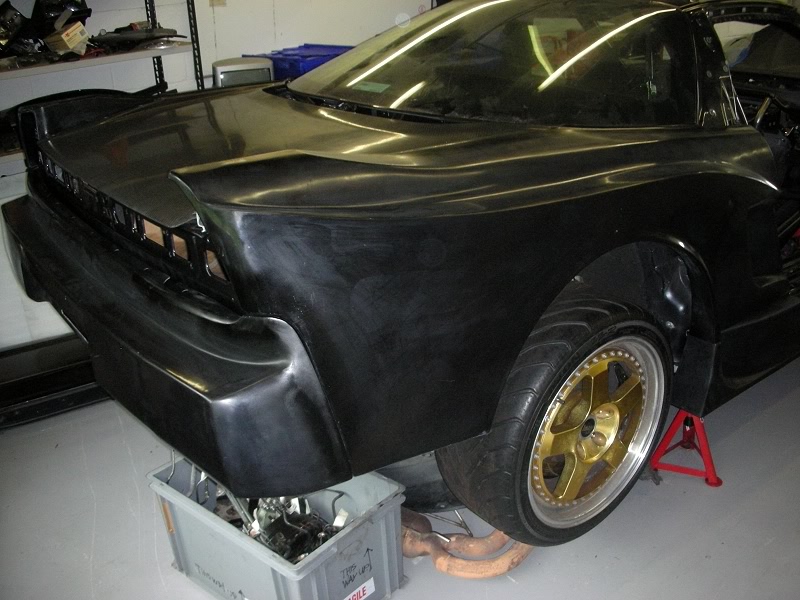

Rear arch
Dry carbon boot, almost cost as much as the fibreglass kit!
From the pics it seems to fit well but it will be getting modified for aero purposes then re-made in carbon. I also need to source some new shape lights for it!

what kit is it? what wheels u gonna put on there?? or havent you chosen a make yet?
edit bottom pic your wheel is on the wrong side lol
