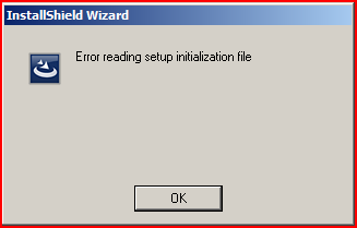

Well it arrived. "This is a bad sign" I thought...
Oh well, who needs readme files anyway... apparently I do

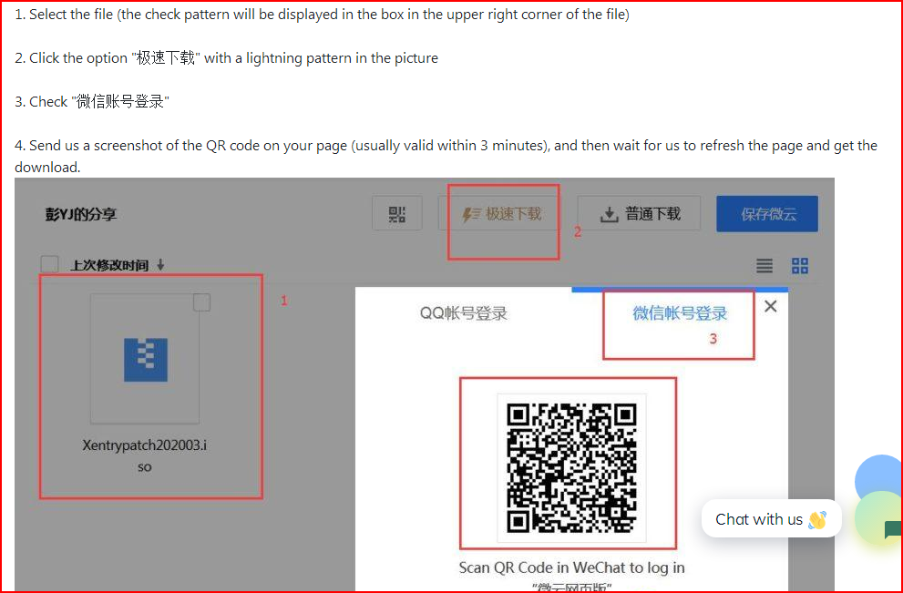

Well at least there's a download link on the product page, I'll try that. Oh ffs.
Emailed support late at night and had an English download link in my inbox the next morning.
