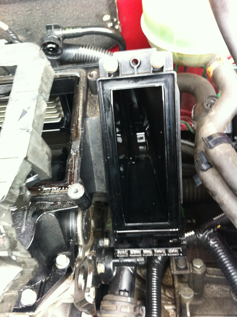

While fitting the clutch I accidentally caught the air box with my elbow and doing so I ripped the studs out. So since it was half off anyway I thought I'd give the air filter a quick check. To my horror i found the filter was saturated in oil, to the point where it was dripping from it. So ofcourse seeing this, bad thoughts start going through my head about headgaskets etc etc.
After a quick search it seems to be fairly common on my engine(DAF) but I'm still not too happy about it. So today I took the inlet manifold off. Under it in the little tray where the air is sucked in was full of oil. So using a syringe I drained it and cleaned the residue up with rags. In total I drained 260ml of oil out plus the stuff on the rags. It's still off just now and I'll look at it again on Monday.

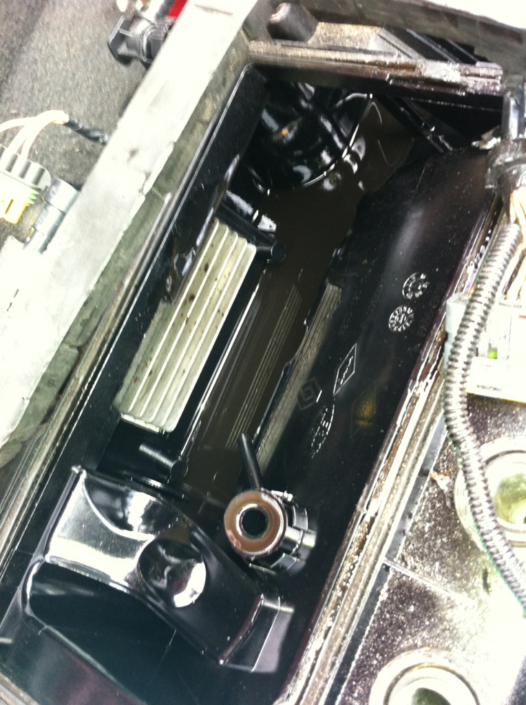

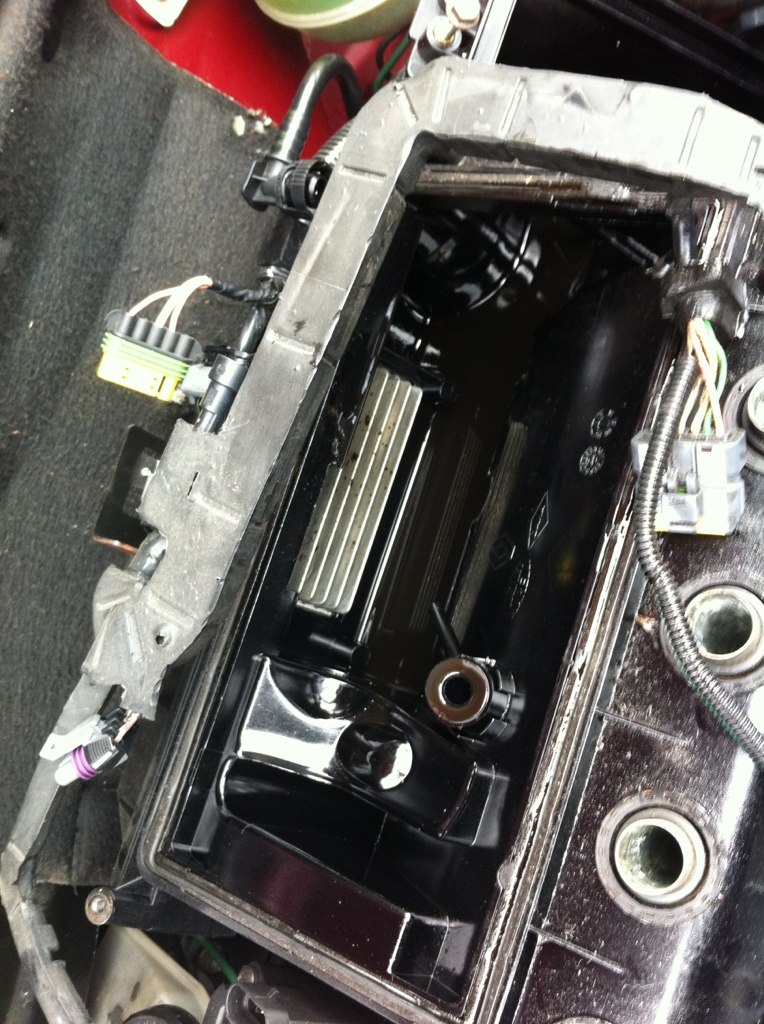

Pictures(sorry there from my iPhone so not the best)

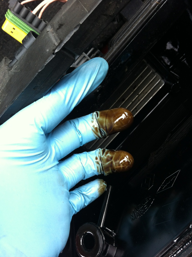

I put my fingers in to see the level of oil aswell
I had a little bit in my airbox (no where near as much as you), i just assumed it was due to the crankcase breather or something..
That's what makes me think it's been over filled at one point. Could have been years ago and since the inlet manis not been opened up no one would be any the wiser.
If its not been over filled what could it be?
Also does the plastic tray come off? I assume this is the cam cover? Id like to remove that aswell to have a look.
Going to whip the cam cover/Rocker cover off tomorrow and have a look.
What kind of gasket is it? Rubber hopefully
id go with overfilled at some point!
however reading that thread, it might be worth trying a new rocker cover!
Yes I'll clean mine completely and put it all back together then in a month or so I'll whip it off again to check over. If full again I'll try a new one or a good one from a scrappies.
